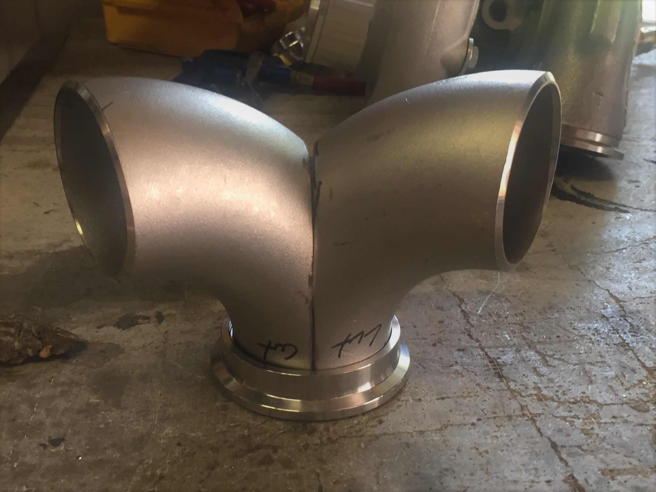

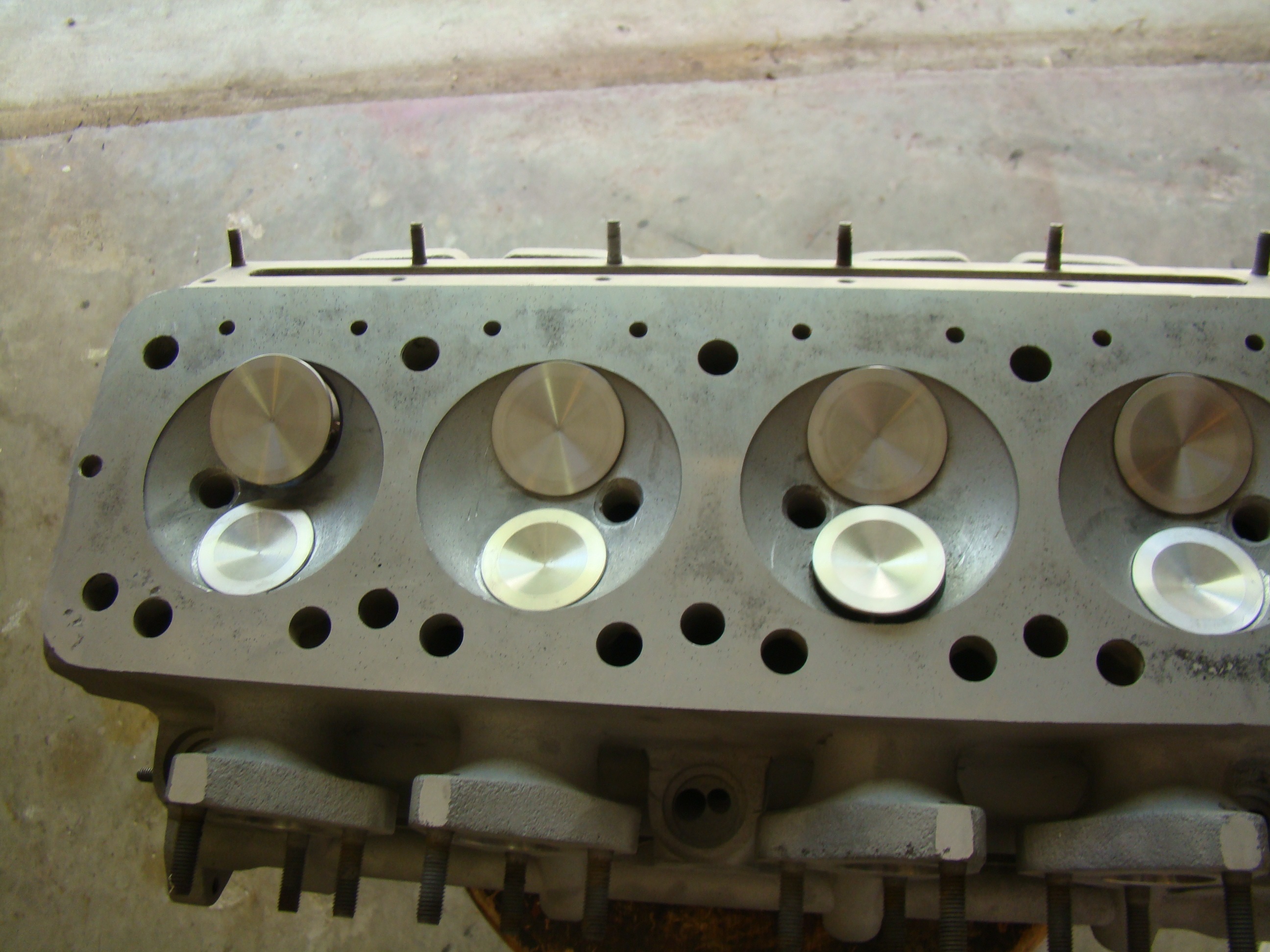

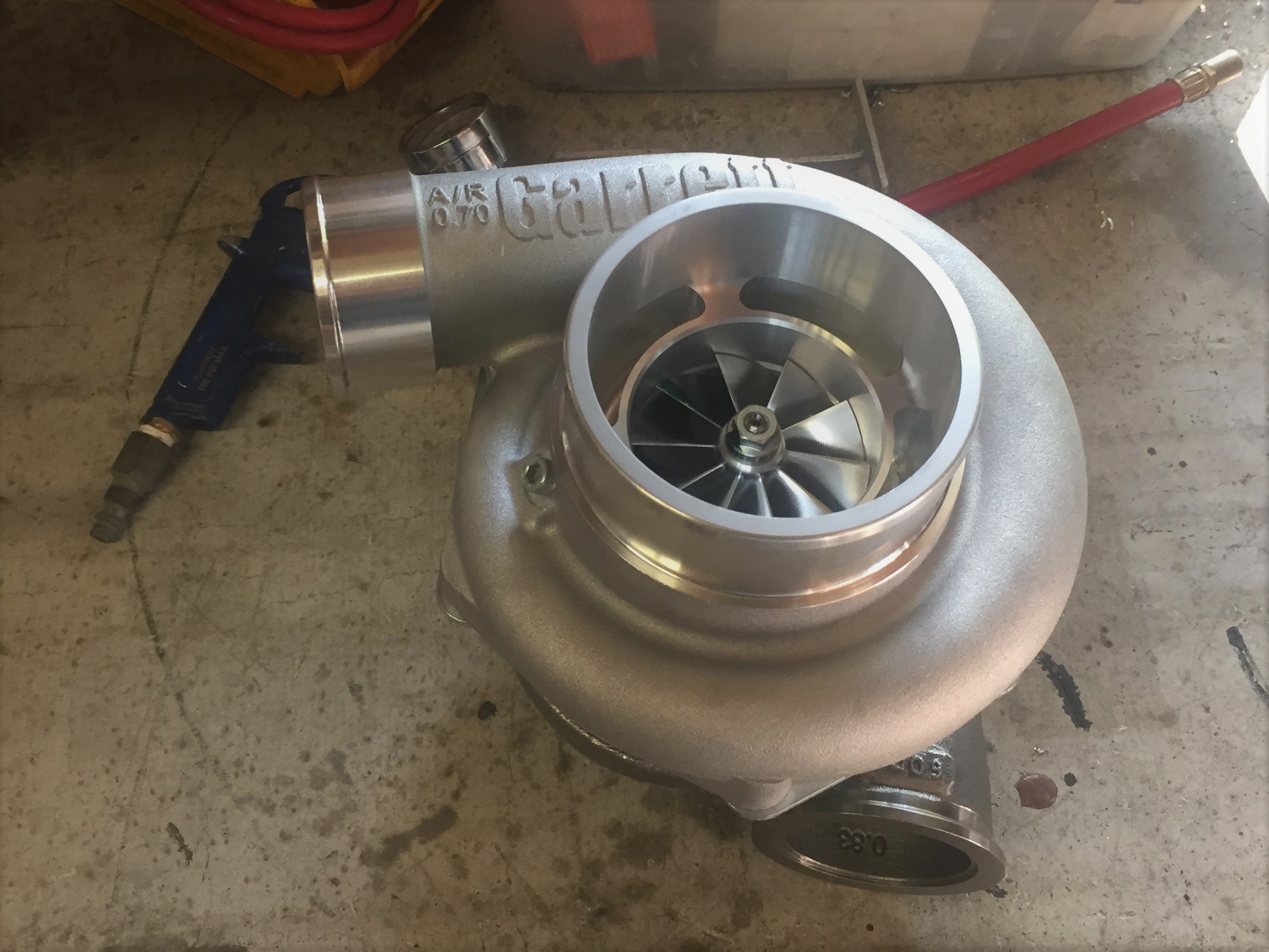

Hi everyone,. I am new to this forum but had my Jalpa since 2011. I am in the process of trying to build the worlds fastest Jalpa. My goal is to hit 200 mph in the Texas mile. Reading Kerplops post really motivated me to get with it and do this. Kudos to him. I plan on posting lots of pics of the process and maybe create a roadmap for anyone wishing to do the same. My motor has been completely rebuilt with ARP head studs and rod bolts. The heads had larger valves made by manley and the heads were extensively ported. They flow about 25% more than stock. I built stainless headers out of schedule 10 weld els and had the rods worked and bronze bushings installed. I bought a Garrett 3582 reverse rotation turbo rated from 450 to 850 Hp. I am planning to make 600 HP on pump gas and well above that with race gas. I am currently fabricating the intakes and exhaust routing to the turbo. Pictures to be posted later . I hope everyone enjoys. Lee
