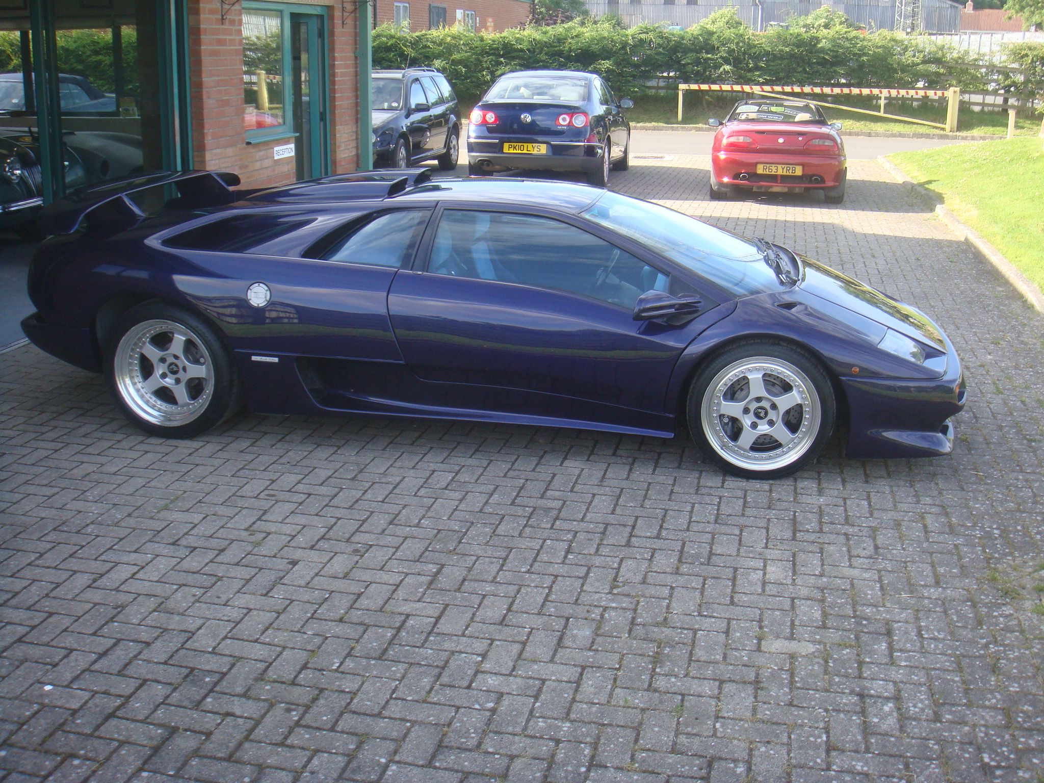

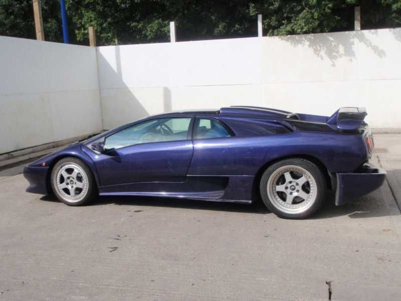

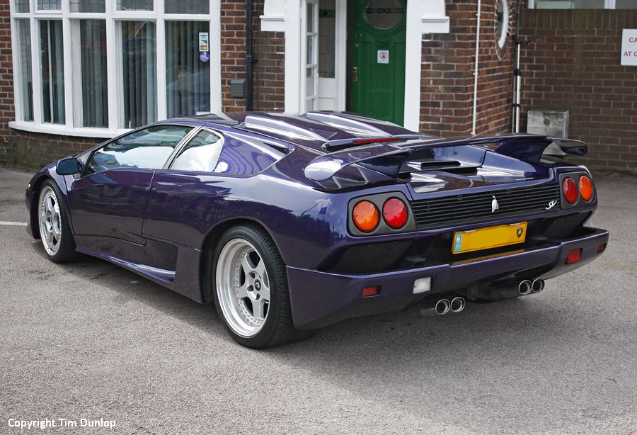

Davo456 Report post Posted October 17, 2014 I purchased a RHD 99 SV last year (one of 9 fixed headlight cars in the UK), and I thought I'd document a little of the history and what I've had done to it here. Here's the car in 2008 photographed by Tim Dunlop: note the VT style front bumper and lack of the top headlight cover strip (to hide the Nissan word on the headlights). re. the front bumper - I'm informed by Mike Pullen (Diablo expert in the UK, that back in the day you could order anything with anything - hence we see now VTs with SV engine lids/air ducting, SVs with leather interiors etc. Quote Share this post Link to post Share on other sites More sharing options...

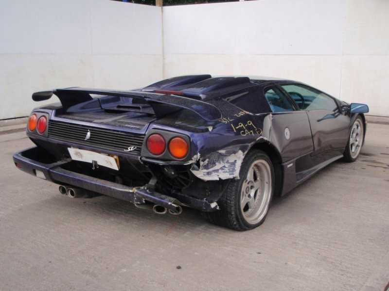

Davo456 Report post Posted October 17, 2014 Unfortunately in 2009, it suffered an accident, and the insurance company thought it was not financially worth repairing at the time - cost of parts and labour Vs value in 2009. Reputedly (I've yet to confirm it), the car was stationary at traffic lights and a lorry clipped the back of it. Quote Share this post Link to post Share on other sites More sharing options...

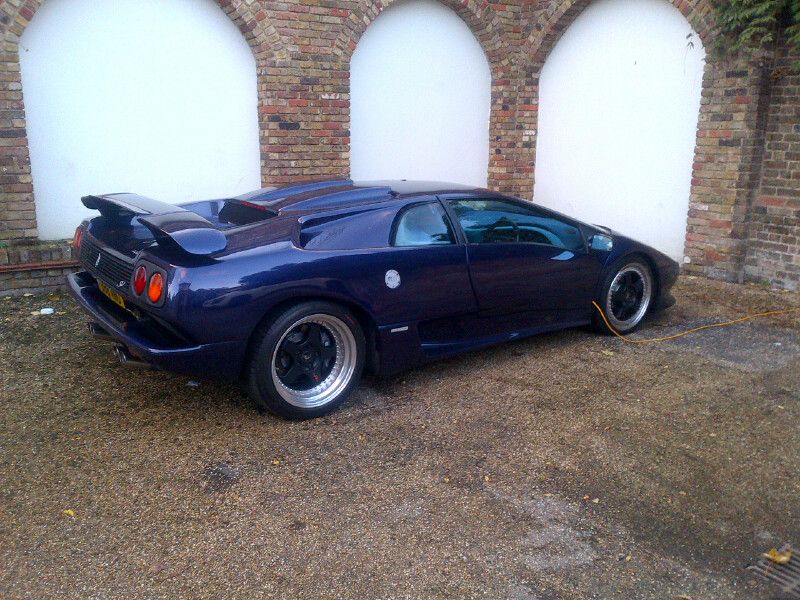

Davo456 Report post Posted October 17, 2014 So the 5th owner had it repaired and sold it to the 6th owner, and I first saw the car in June 2011, like this... Note the changed wheels (they were replaced in 2010 to black ones from a 2008? car) The car had quite a lot of mechanical work done on it, with receipts to back it up from 2010 to 2013. Quote Share this post Link to post Share on other sites More sharing options...

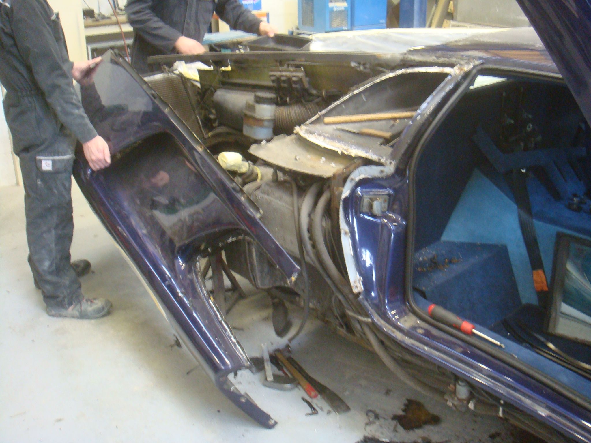

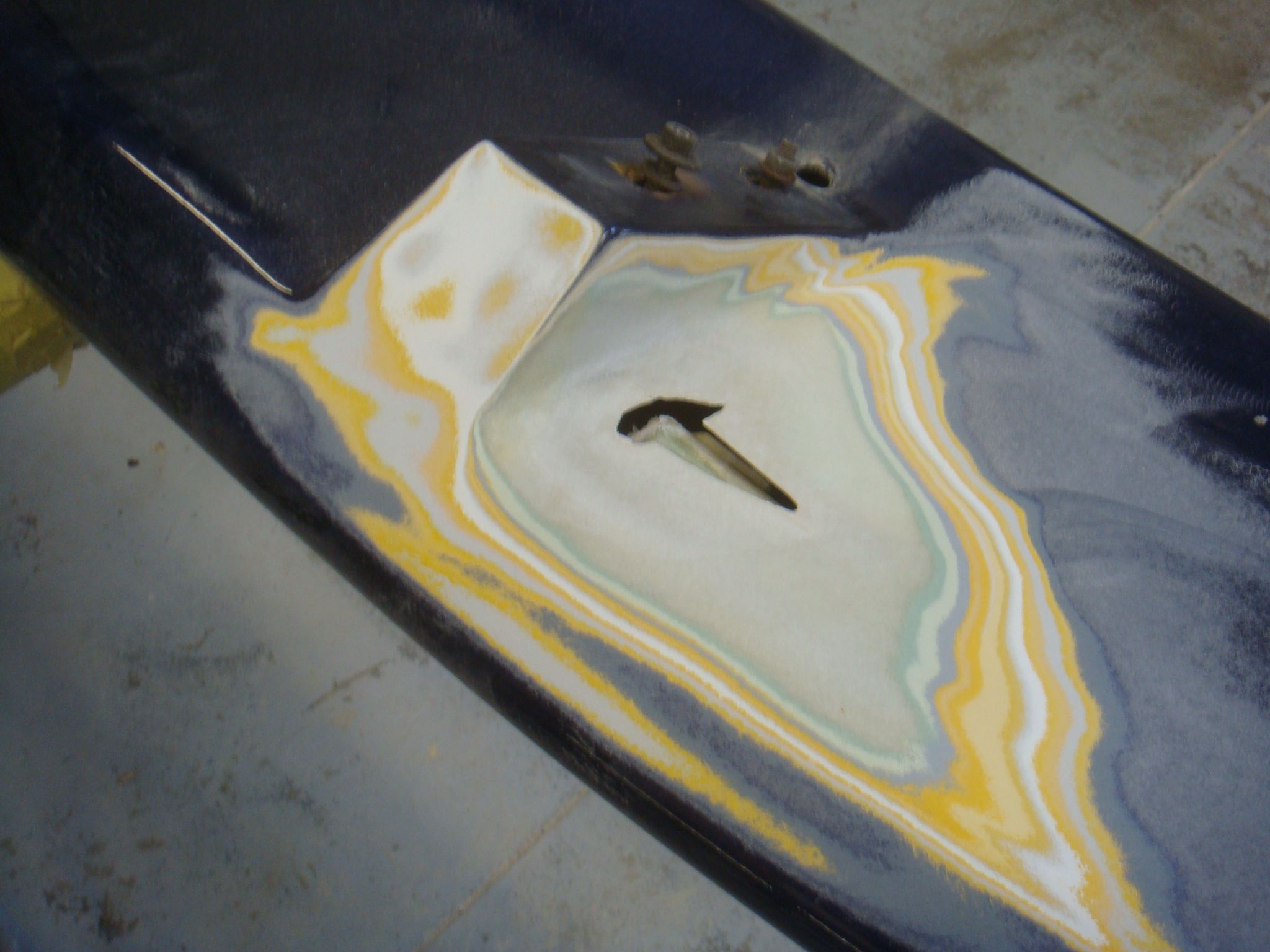

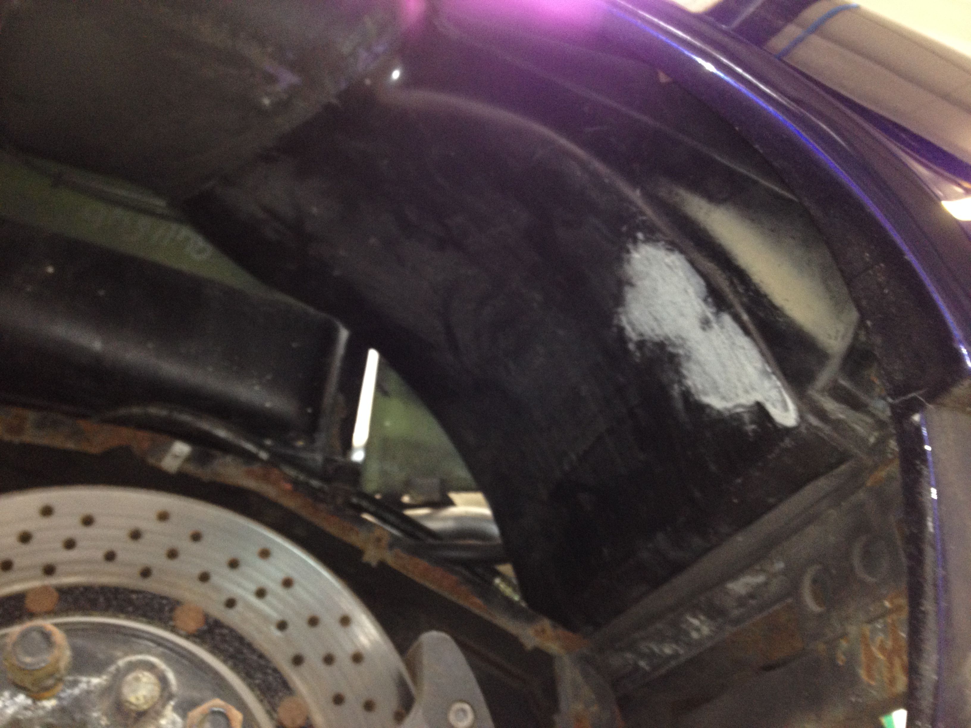

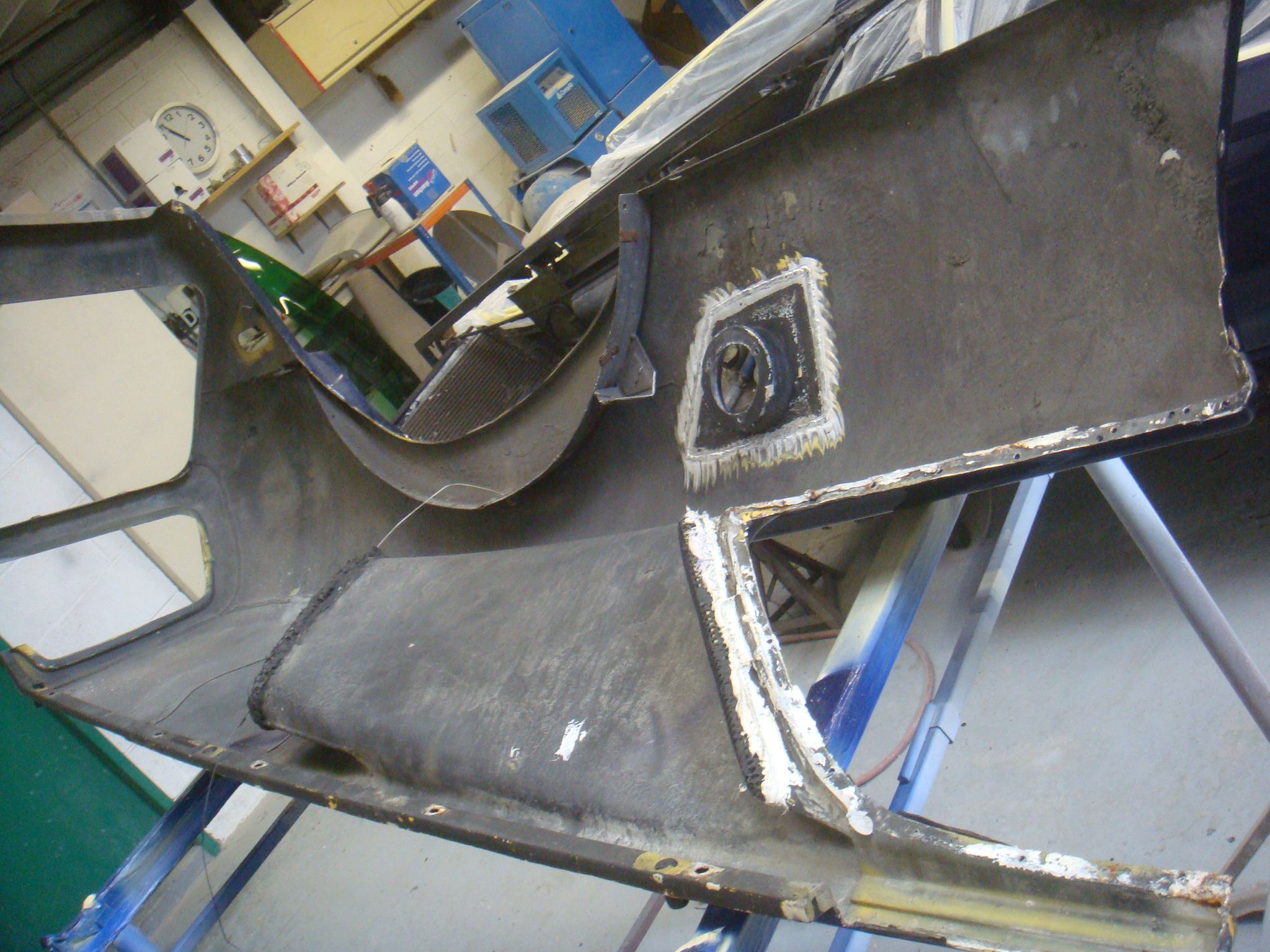

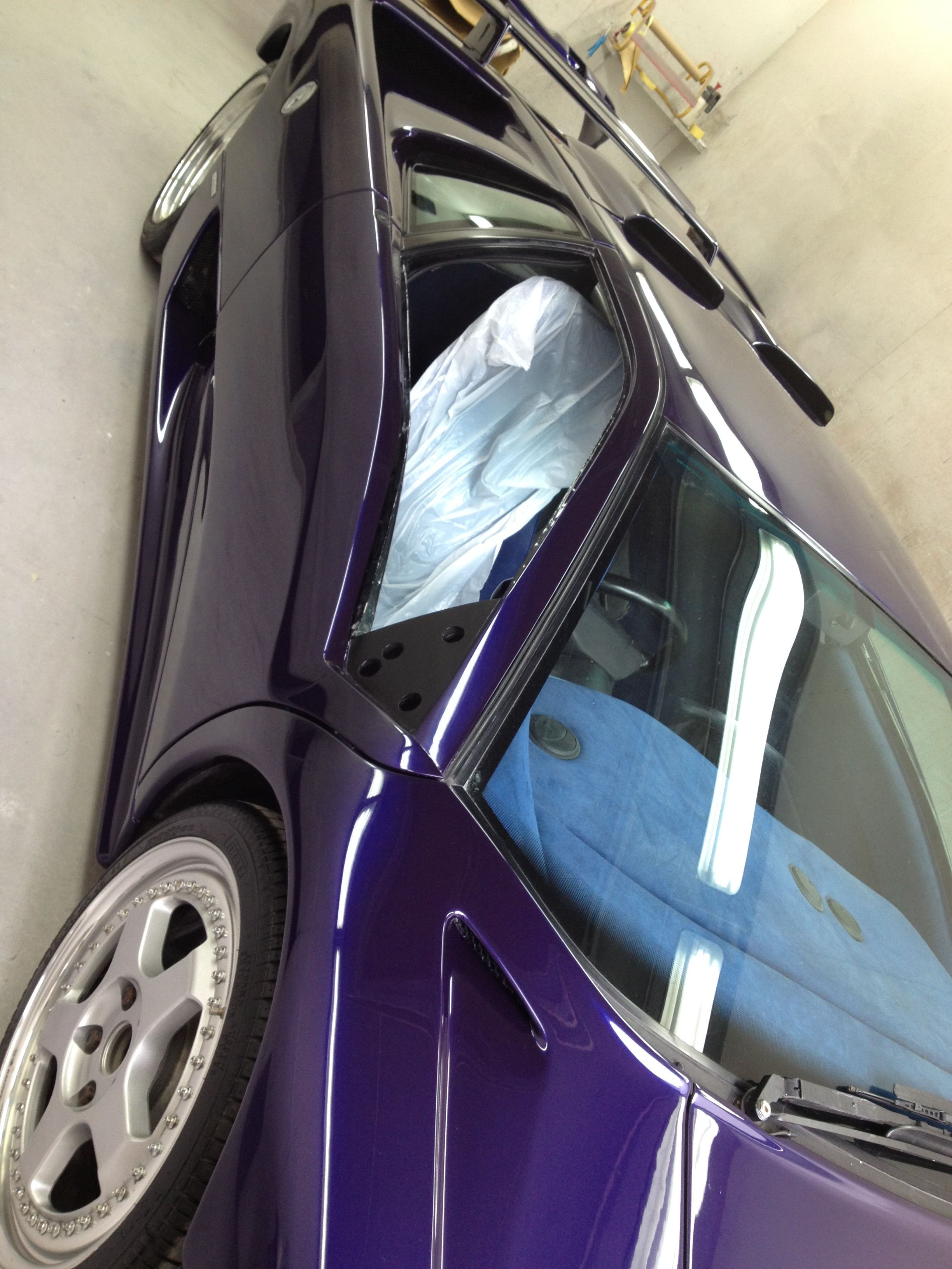

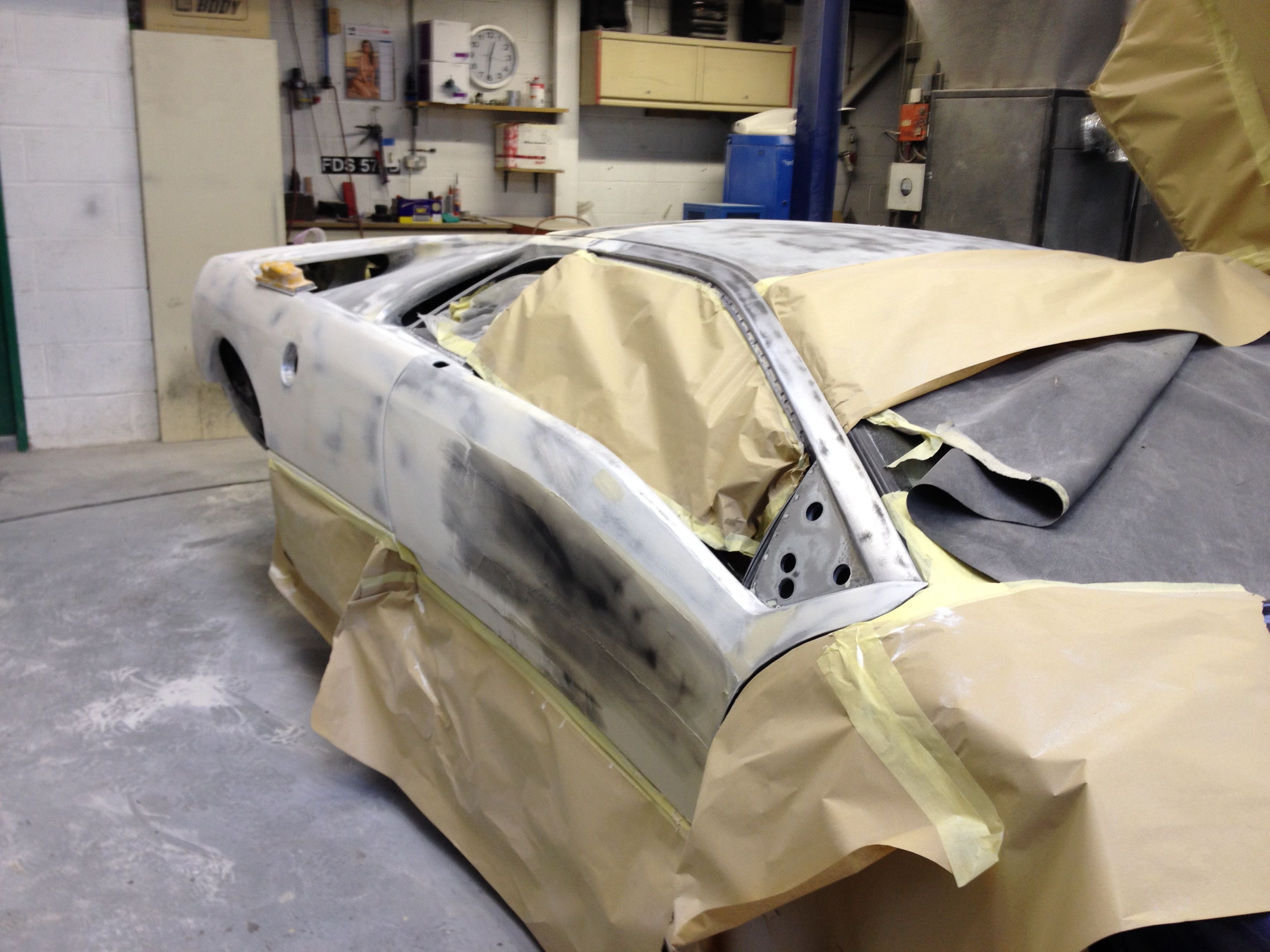

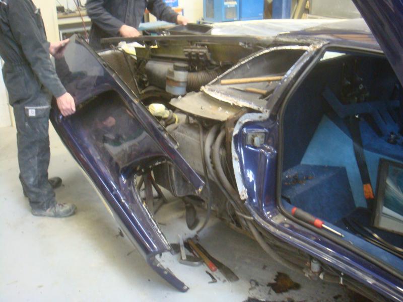

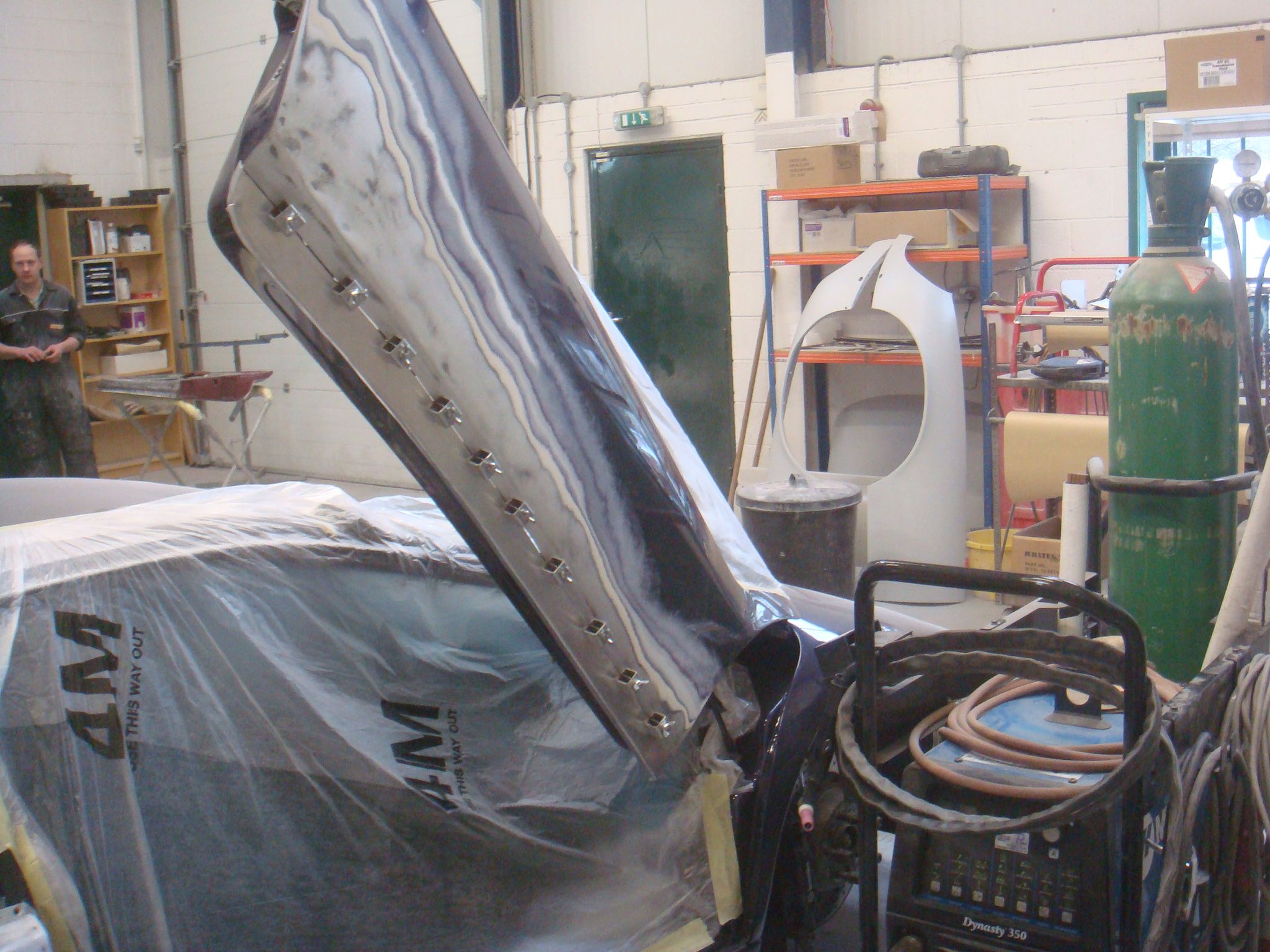

Davo456 Report post Posted October 17, 2014 After owning the car for several months, and getting a Workshop Manual, and learning about the car more, I realised things weren't quite to my liking with the repairs that had taken place. basically there was something wrong with the paint on the rear wing - the Blu Scuro colour looks purple in certain lights, but the offside rear (OSR) wing, never changed from Blue. I took this into my local body shop and we started to look into it more: Basically the OSR wing was misshaped, and needed realigning It was a second hand wing that had been fitted from a yellow non SV car (with fuel filler cap) and had the SV fuel panel welded in - this was starting to fall out. Inside the wing was also missing the carbon fibre funnel for guiding the air from the air intake to the radiator (other side vent shown here): The rear bumper was also from the same yellow car, and had a hole in it, which had filled it with water (quite a common issue I've been told since) - according to the guys, it weighed a lot when they took it off full of water! The bottom of the drivers door was also corroding at the front (another common issue), and required new metal fitting in: However, more investigation revealed a far more serious problem, the floors were starting to corrode badly Quote Share this post Link to post Share on other sites More sharing options...

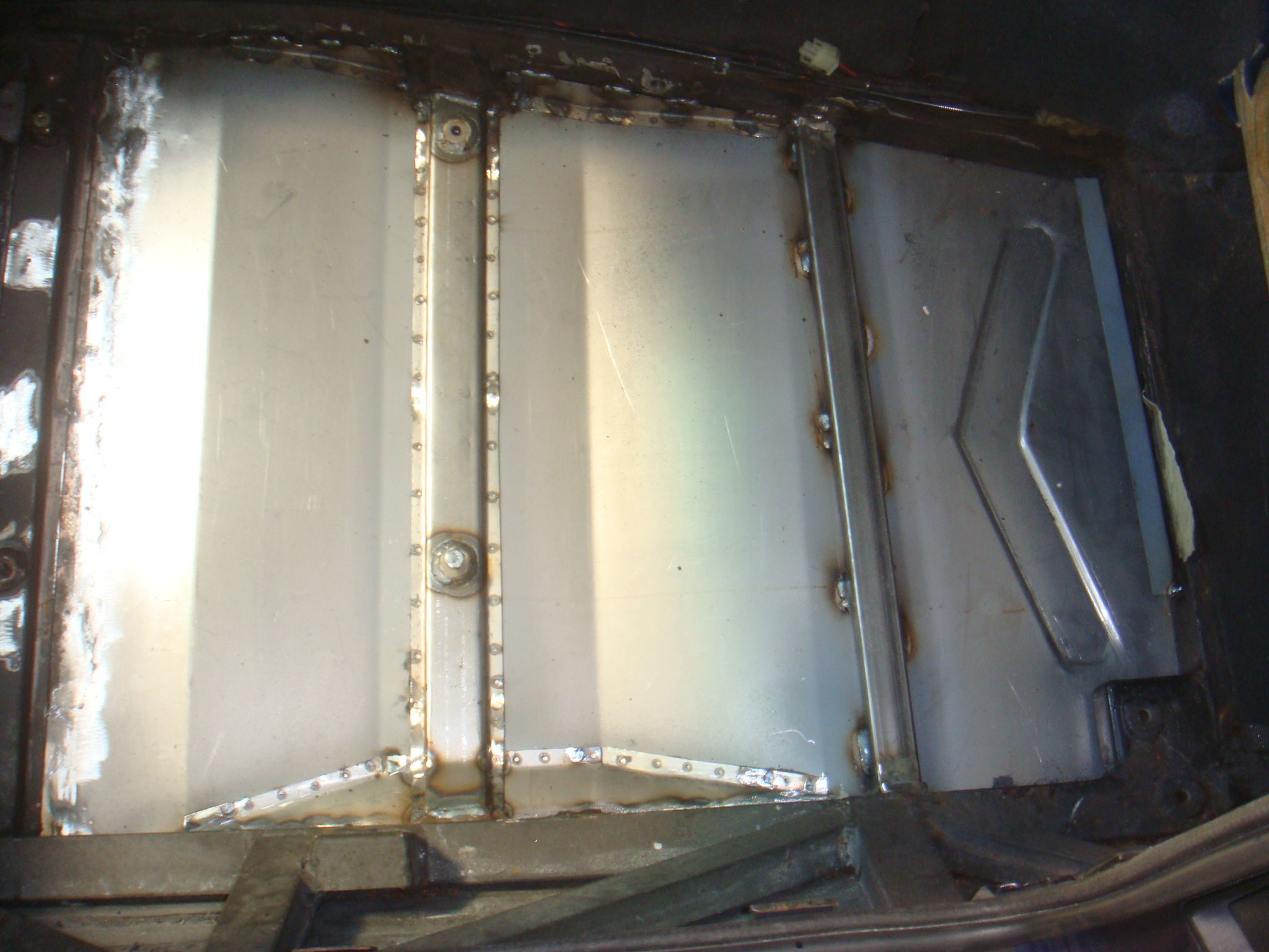

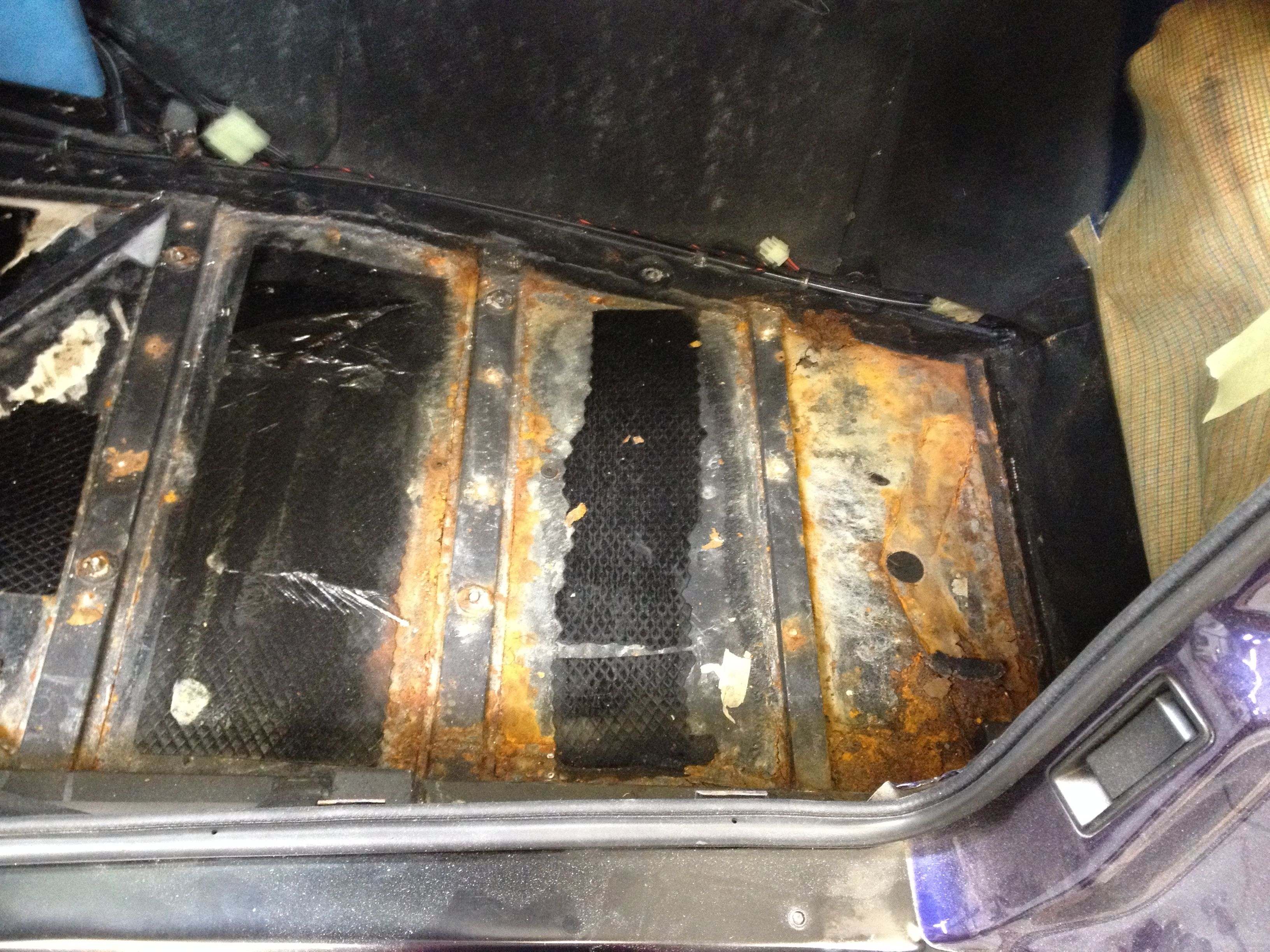

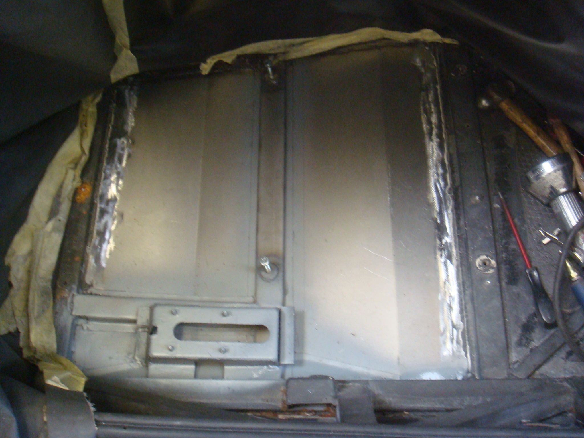

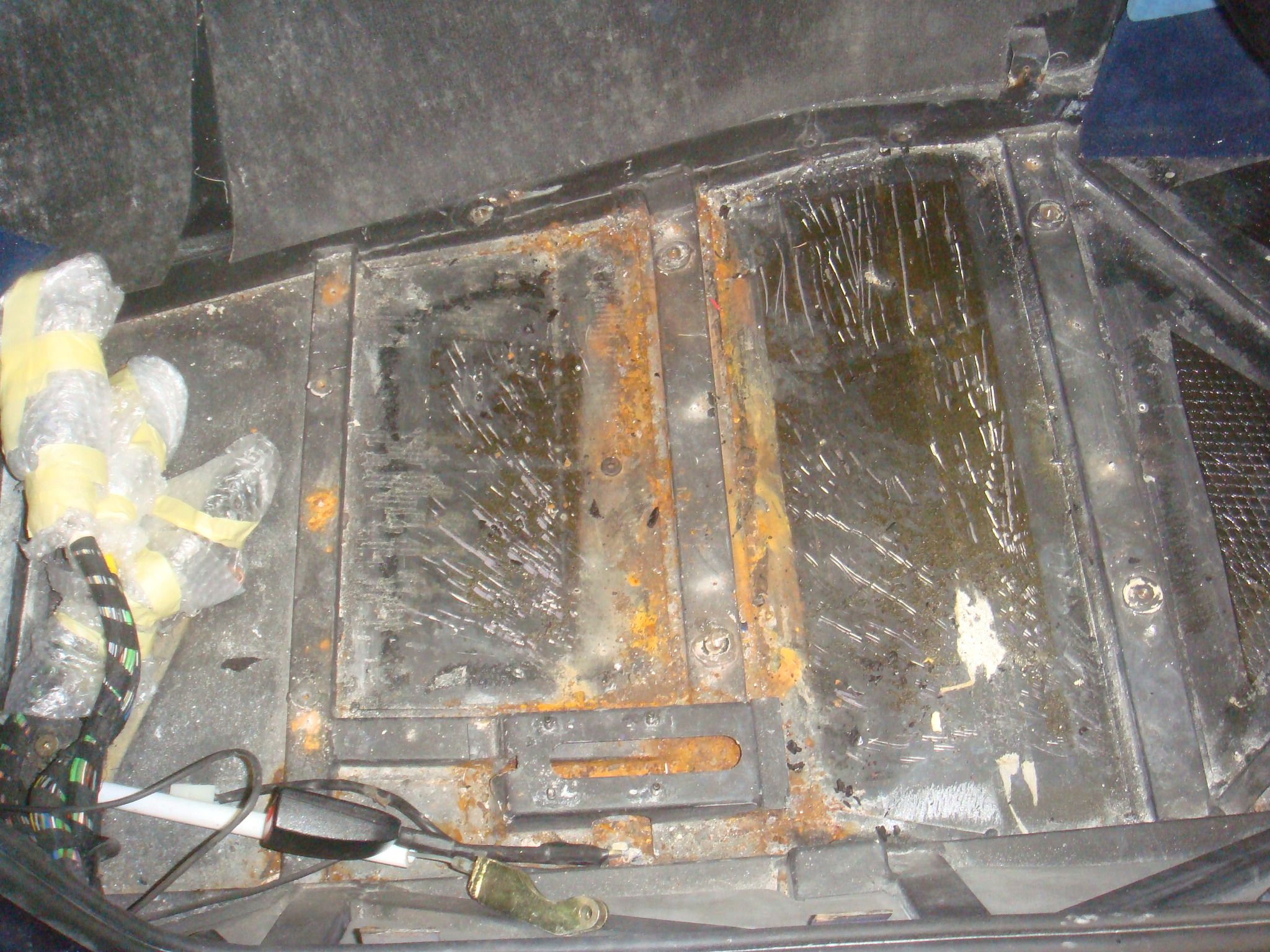

Davo456 Report post Posted October 17, 2014 The floors were fabricated and fitted: Quote Share this post Link to post Share on other sites More sharing options...

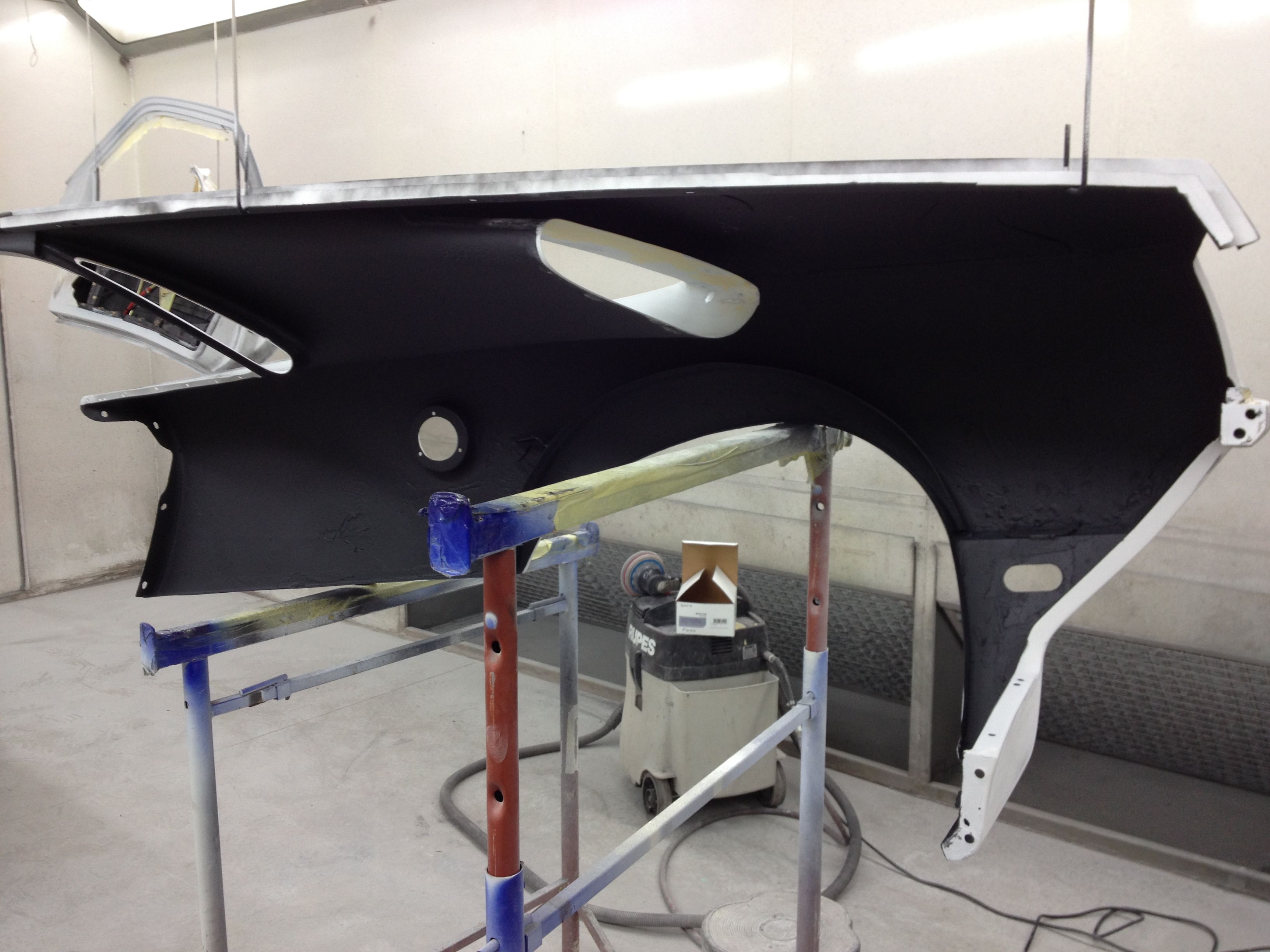

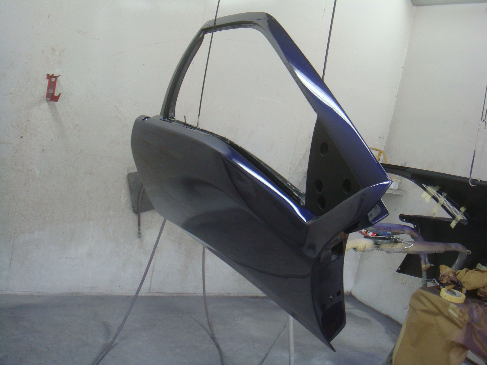

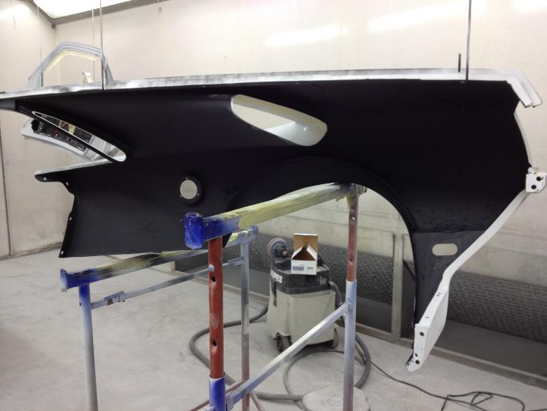

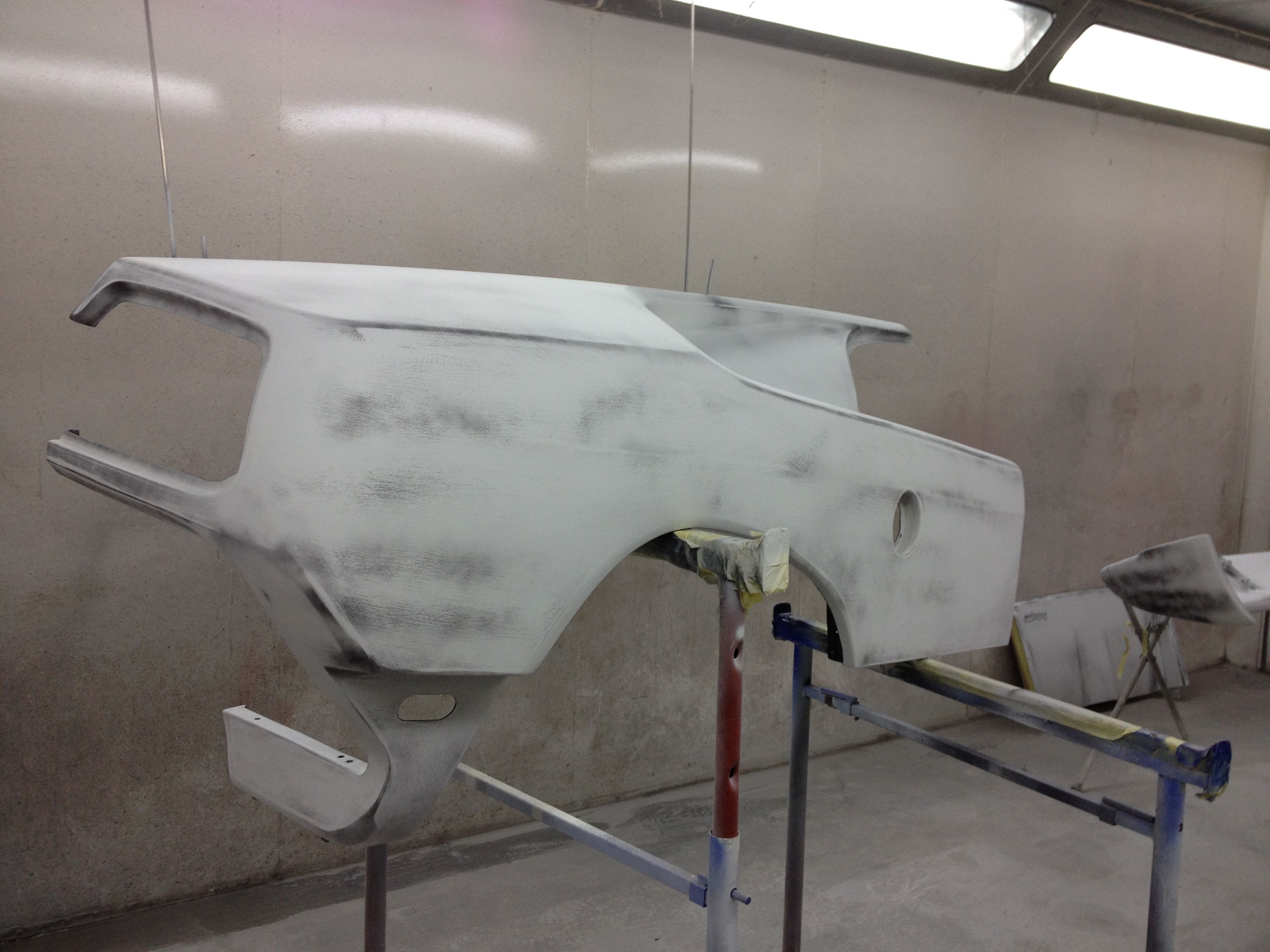

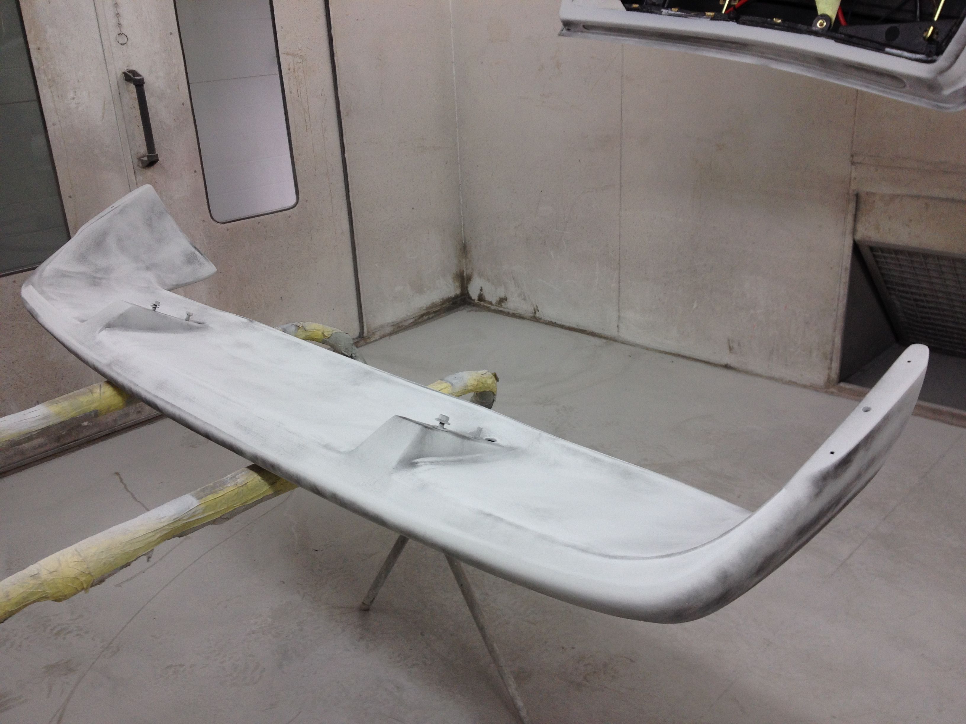

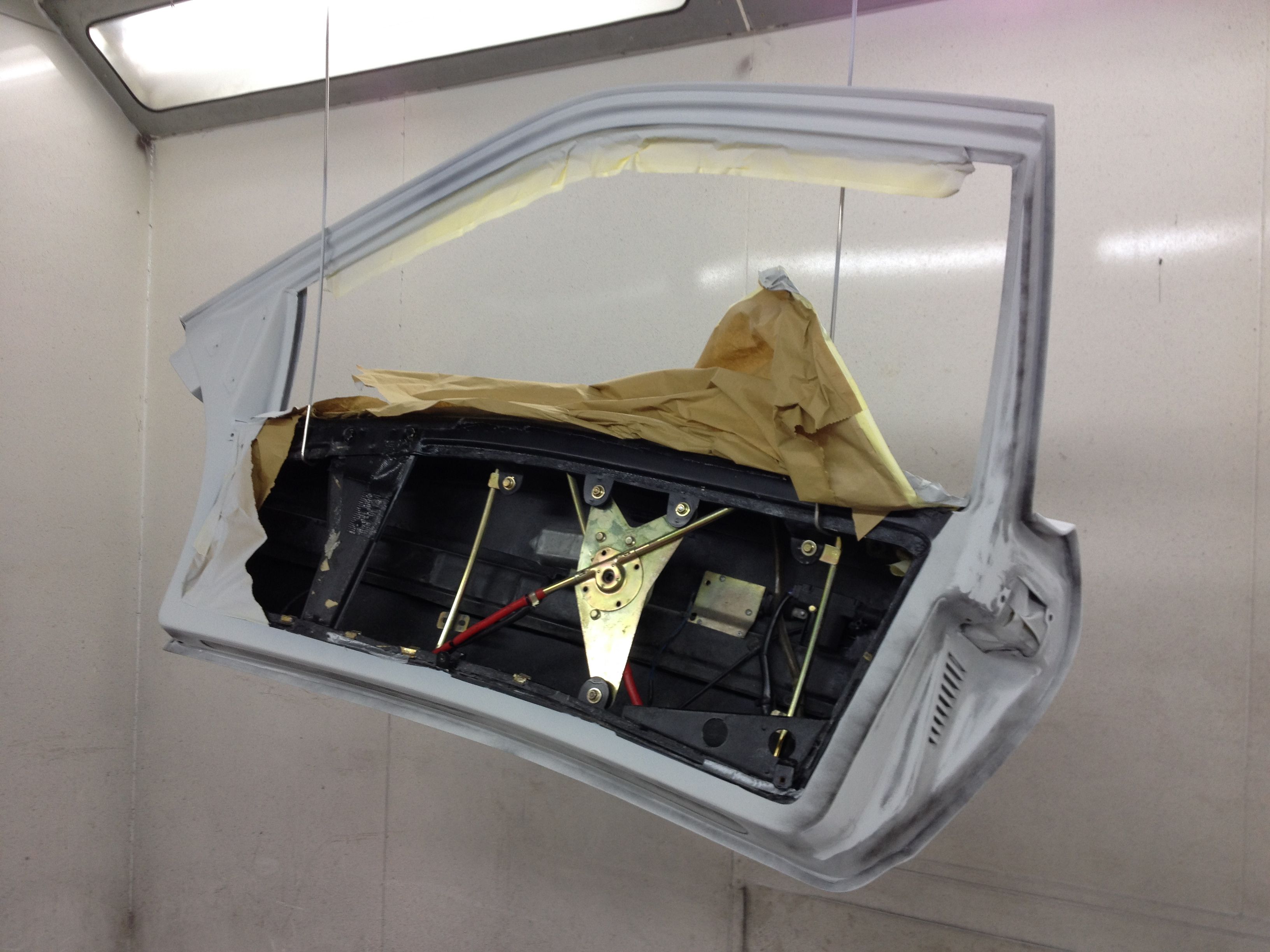

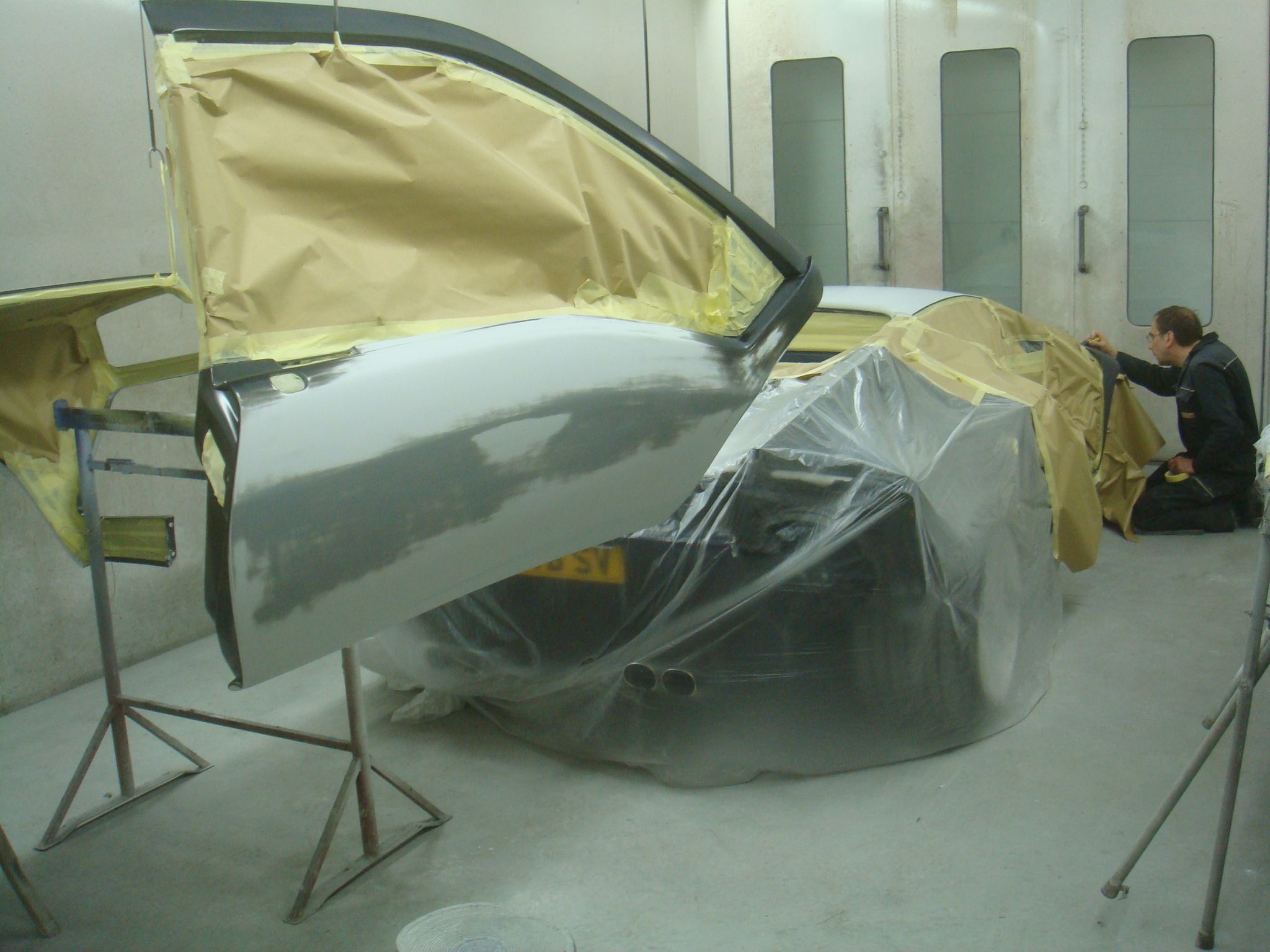

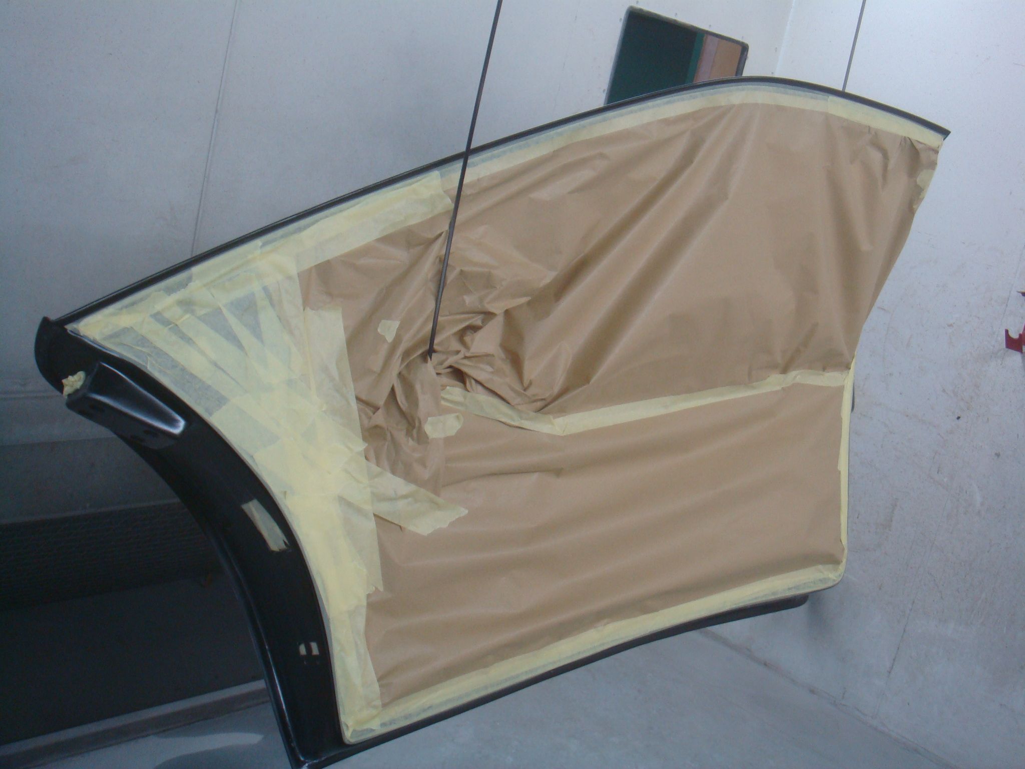

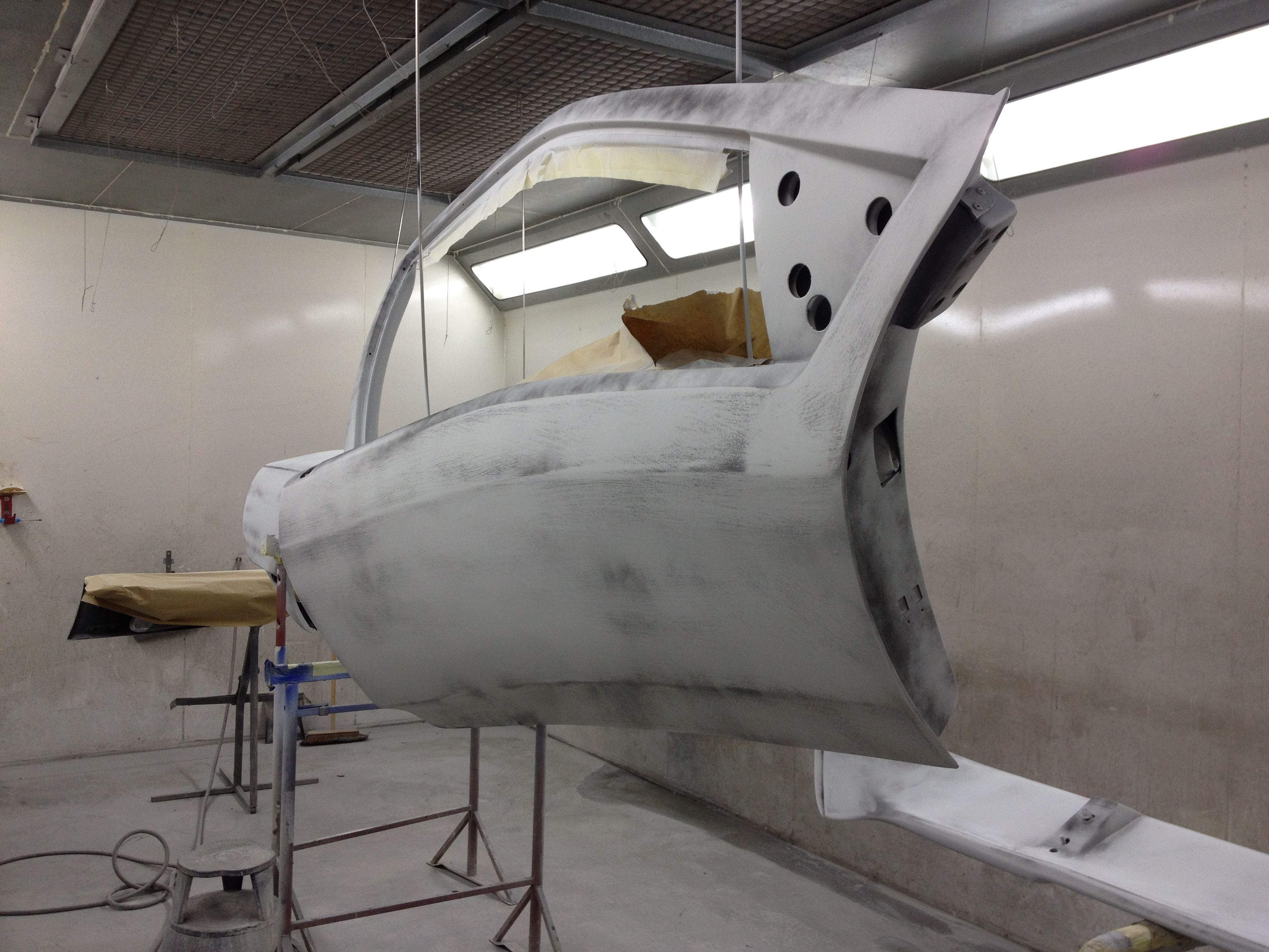

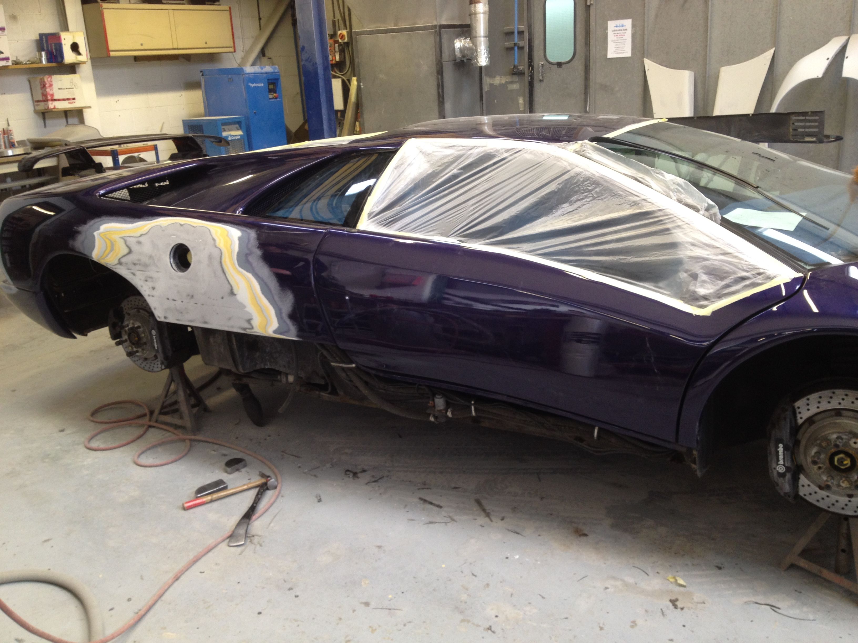

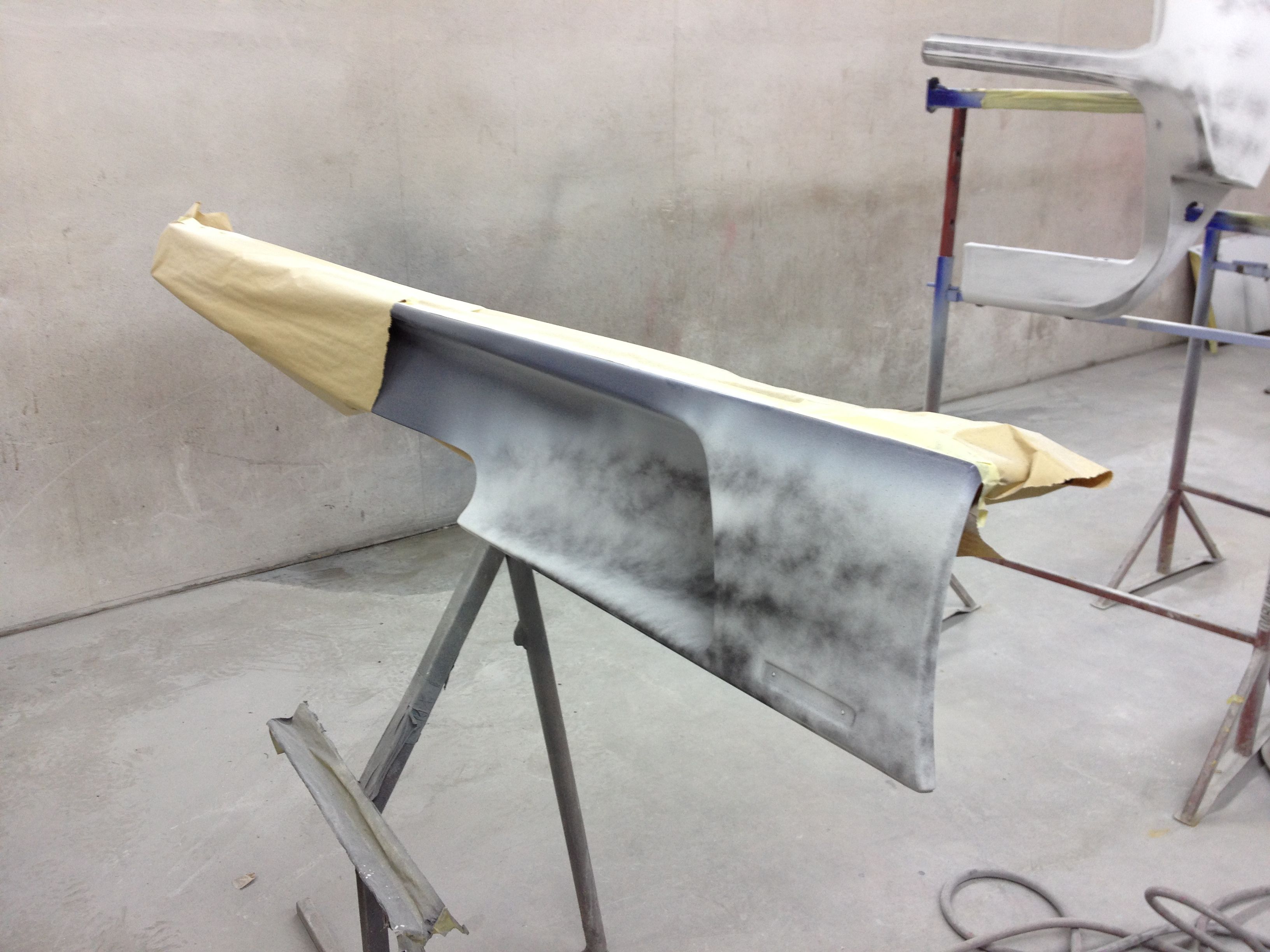

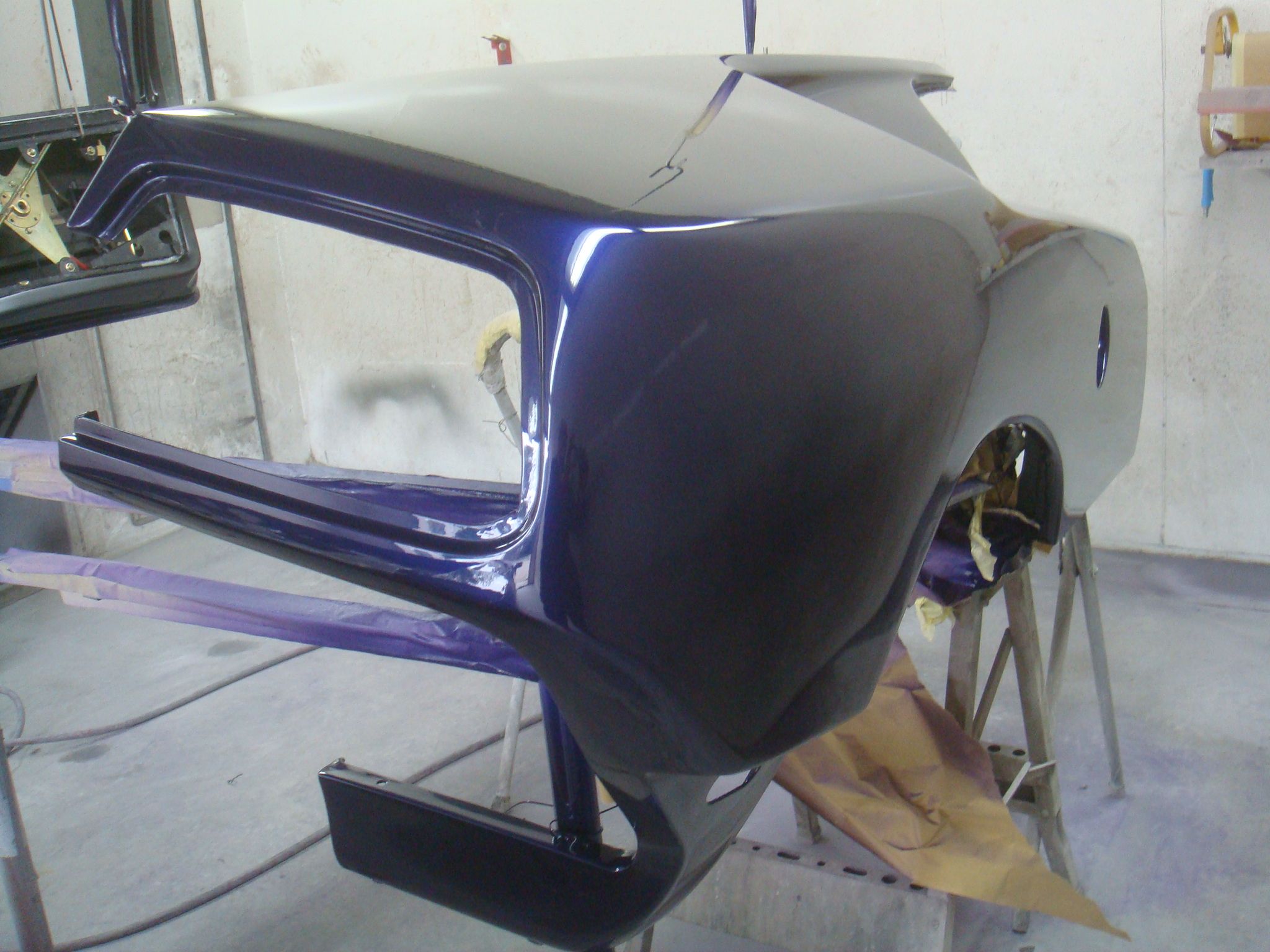

Davo456 Report post Posted October 17, 2014 After all the metalwork was sorted, it was time for paint first prep was with the panel fitted to the car, to ensure correct alignment then each panel was primed, and painted inside Quote Share this post Link to post Share on other sites More sharing options...

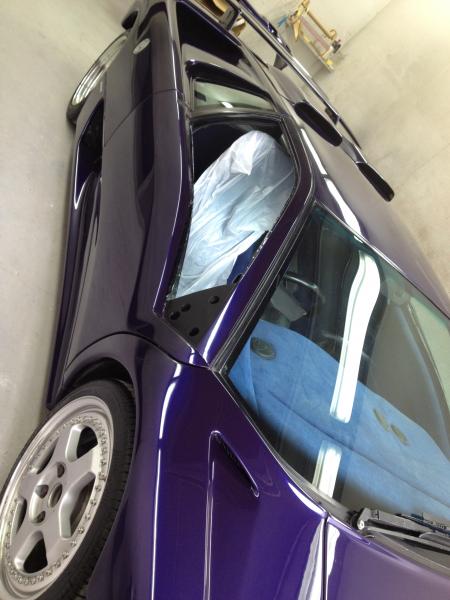

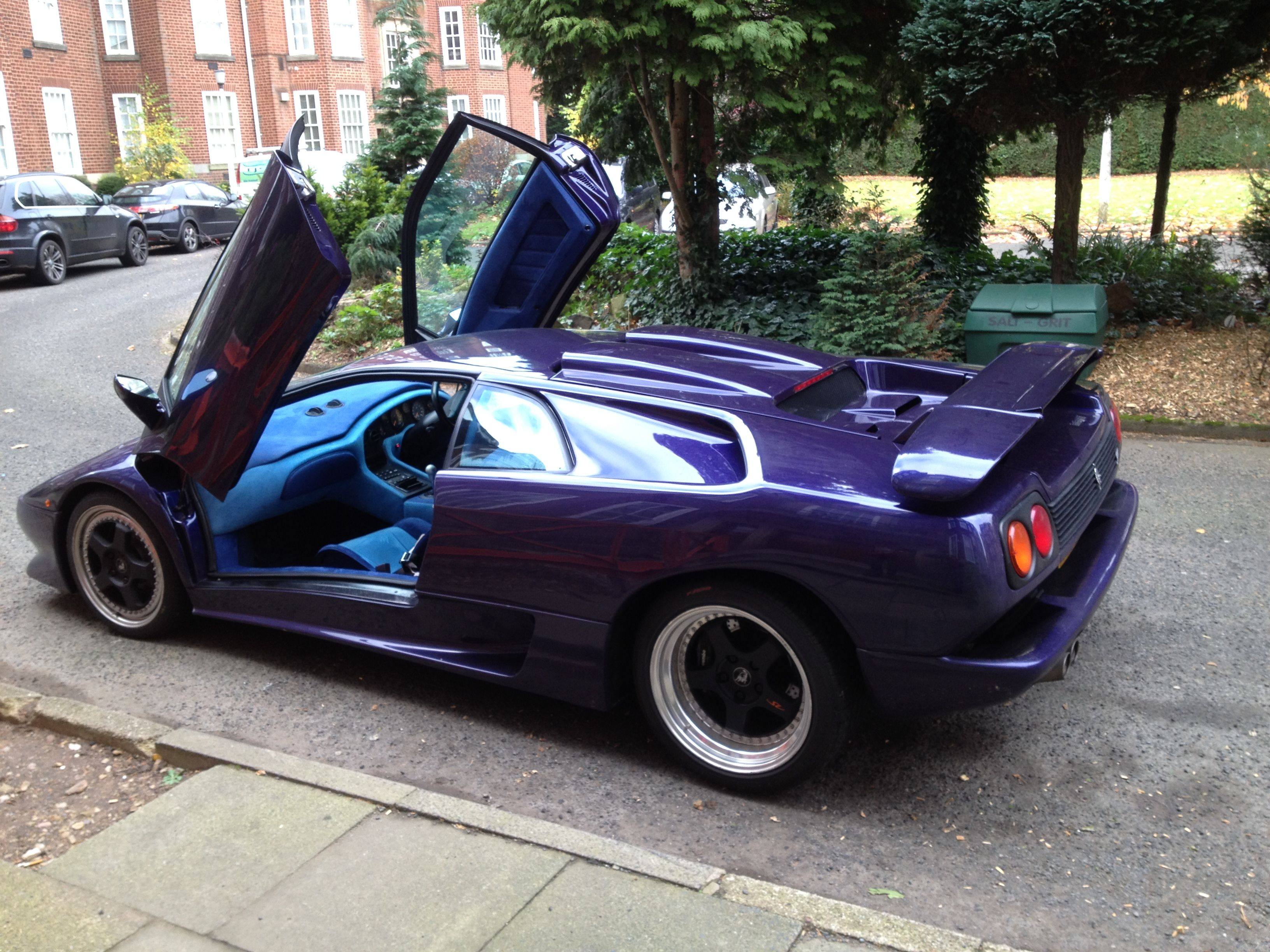

Davo456 Report post Posted October 17, 2014 The black sections of the door and rear wing were painted first finally colour was applied and the parts refitted Unfortunately I haven't got photos off all the work, but the wing mirror internals were replaced as the springs had stretched (thanks please check with our franchised lamborghini dealer sponsors.com for the repair kit) The rear fog light and reversing light were replaced (thanks Sudesh) And the wheels were painted with silver centres (as per the 2008 pictures, which I preferred to the 1998 replacement black wheels that were fitted previously) So the major rebuild was now complete Quote Share this post Link to post Share on other sites More sharing options...

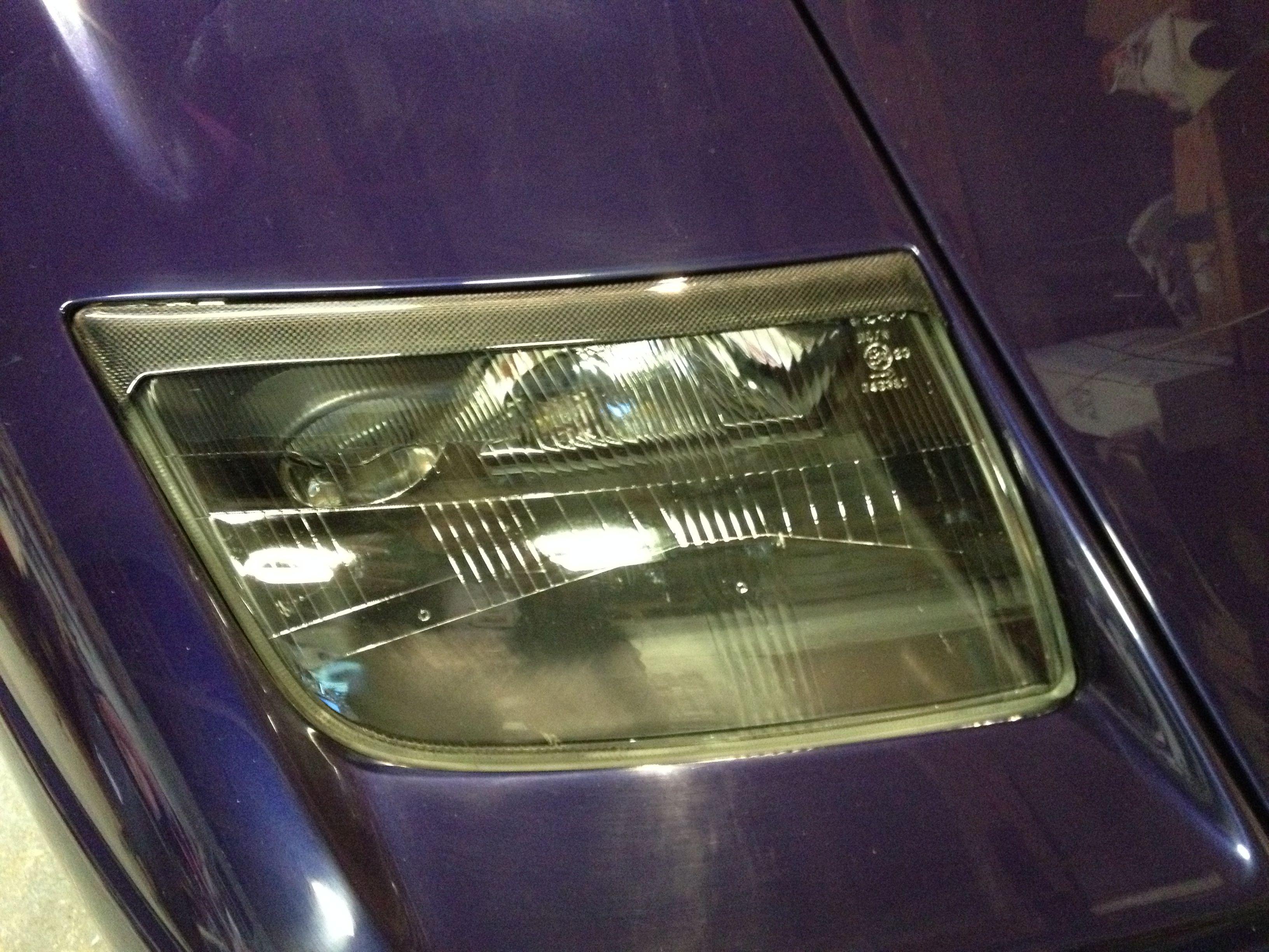

Davo456 Report post Posted October 17, 2014 next job was to add some of the carbon fibre light covers which were missing in 2008 (if ever fitted, as I've seen a lot of cars without them): Quote Share this post Link to post Share on other sites More sharing options...

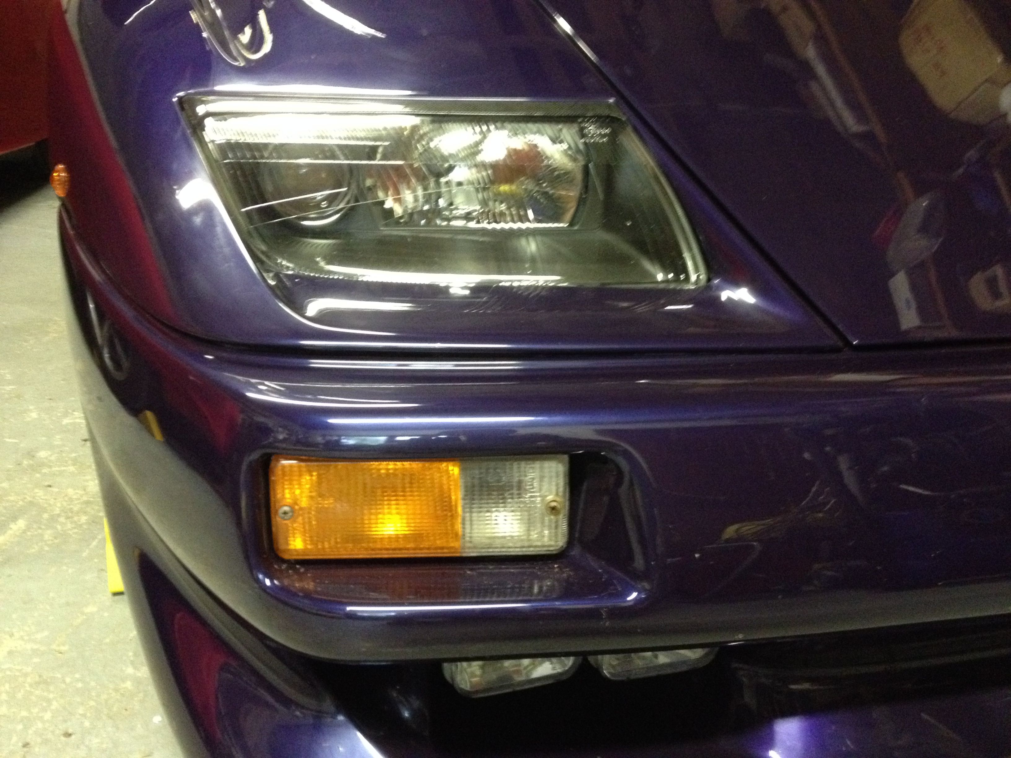

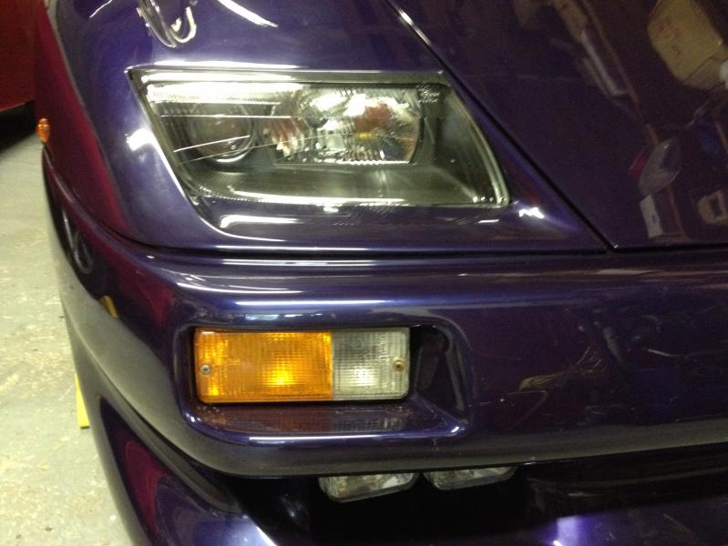

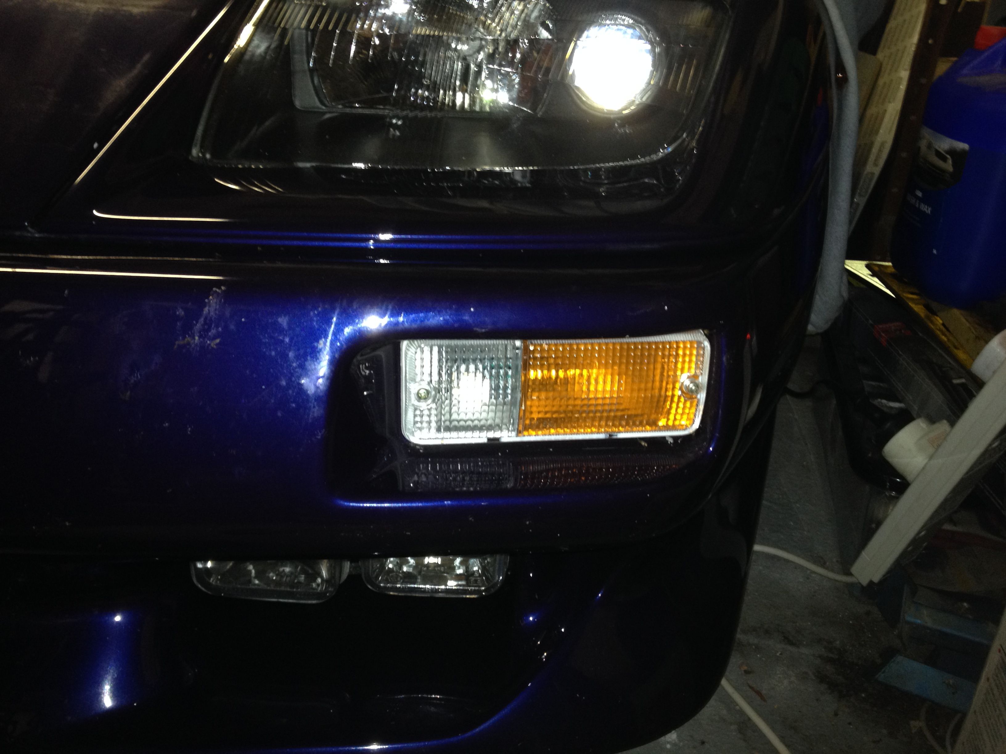

Davo456 Report post Posted October 17, 2014 Next in July 2014, I thought the front side lights and indicators looked rather tired, so thanks to my good friend Sudesh, we went from this... To this - with LED sidelight bulbs fitted Quote Share this post Link to post Share on other sites More sharing options...

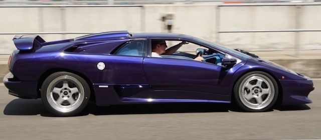

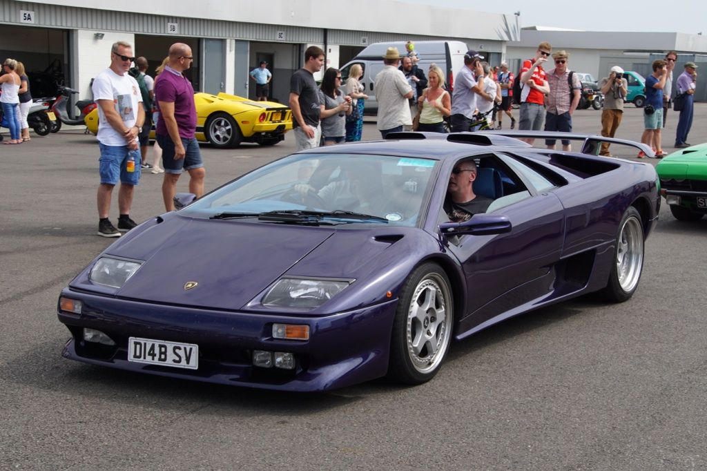

Davo456 Report post Posted October 17, 2014 So in late July 2014, I took it to the Silverstone Classic... photos courtesy of Flickr, as I was too busy driving :-) Quote Share this post Link to post Share on other sites More sharing options...

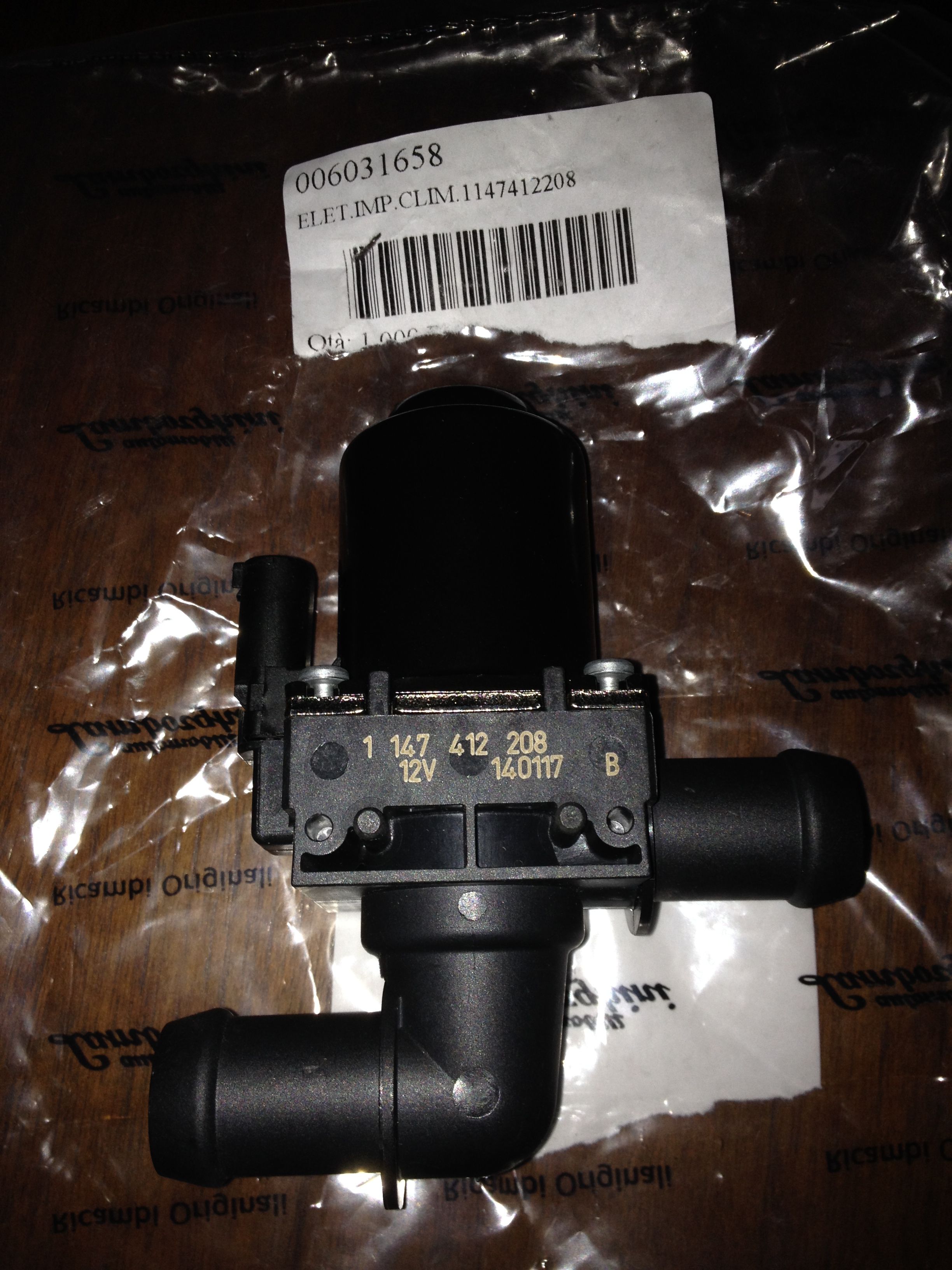

Davo456 Report post Posted October 17, 2014 On the Silverstone trip I found an issue with the cooling... the temperature would continue to rise in the cabin even when the controls were set to 17 degrees C After some initial investigation, and replacement of the one of the fans without success, I narrowed this down to the heater control valve which routes hot water to the passenger compartment - when the valve fails, it fails open. A replacement part was obtained from Lamborghini, and required changes to the wiring connectors! Maybe I should have bought the generic identical part from Amazon instead! However my main issue with fitting it, was finding it - in LHD drive cars its behind the passenger side dash - which in a RHD car is where the steering column is. In the RHD cars, it is actually in the door sill here... (pic from earlier rebuild - valve in middle of lower sill, underneath door) Here's the valve btw before fitment... Quote Share this post Link to post Share on other sites More sharing options...

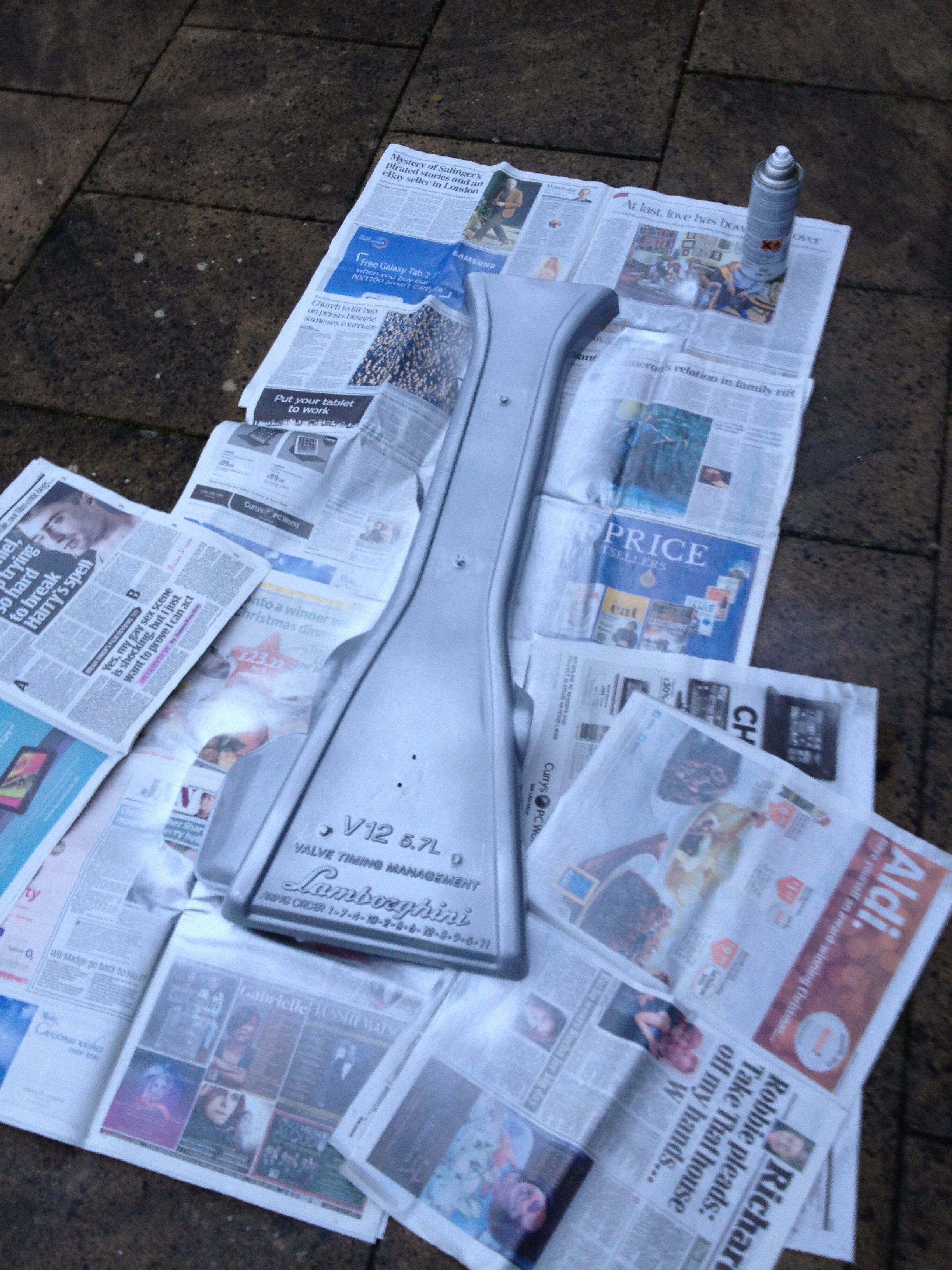

Davo456 Report post Posted October 17, 2014 Ok, so I missed this one out earlier... I have also repainted the engine cover from the middle of the V in the engine, back in January when the nights were dark and cold after being sat in the house for a week, my wife asked me to move it incase she snapped it - little did she realise this piece of carbon fibre is in excess of £1200+VAT from Lamborghini. Quote Share this post Link to post Share on other sites More sharing options...
