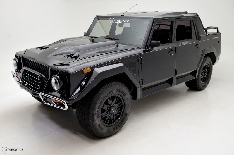

I can say without question that I think I probably have the BEST example of a LM 002 America on the market...for sure in the USA if not the world. It also has beand new P tires on it, worth their weight in gold....
One thing a lot of people forget, The Carb version cars had the Countach heads on the block. The 48 or so roughly American FI versions had the heads of the Diablo motor...IMO the FI American trucks are all around better looking and certainly with the FI more reliable....but that is my thoughts.
http://www.catsexotics.com/vehicle-details...-wa-id-11987392

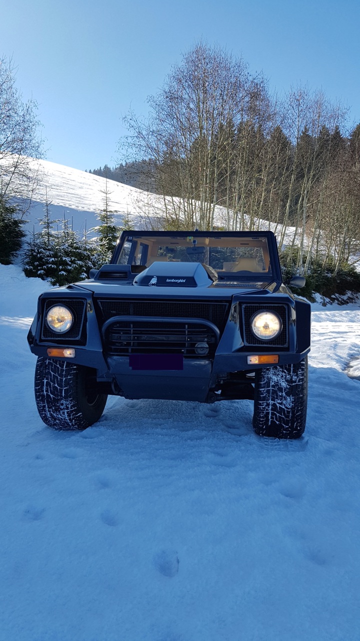

Took out the LM today after it was sitting idle in the garage for the past three months.
That is just beautiful!

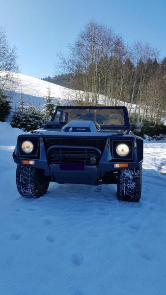

Very nice.
