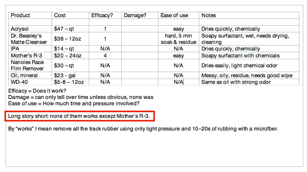

So I ordered:
Acrysol (liquid quart)
99.9% IPA (liquid quart)
Mother's R3
Nanolex Race Film Remover
Dr. Beasley's Matte Paint Cleanser
I'll report back the efficacy of each.
