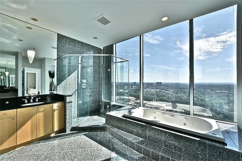

Sprite you can do a pretty crazy shower if you utilize the whole bathroom floor to provide the fall towards the drain ( I HATE step in showers!), you can have a very shallow drain and the fall can be very minimal, I will post some photos tomorrow for you.
Aquabocci have some great drainage solutions for that application
http://aquabocci.com/shopping-cart-blade.html
http://aquabocci.com/fileadmin/user_upload...web_version.pdf
The drain itself is very shallow so it doesn't require a lot of depth for installation, the rest of the plumbing should be in the walls so hopefully not too much of a drama.
If you can locate the existing drain, if you take the tub out you might be able to utilise that location, if it isn't suitable you might be able to chase it in the concrete (make sure the slab isn't post tensioned) a good contractor should be able to help you, once you find someone good, the only limitations will be your imagination and budget.
In relation to the TV I am sure you can place it behind an acrylic panel.
Good luck, make sure you post some photos of the transformation if you go ahead.
