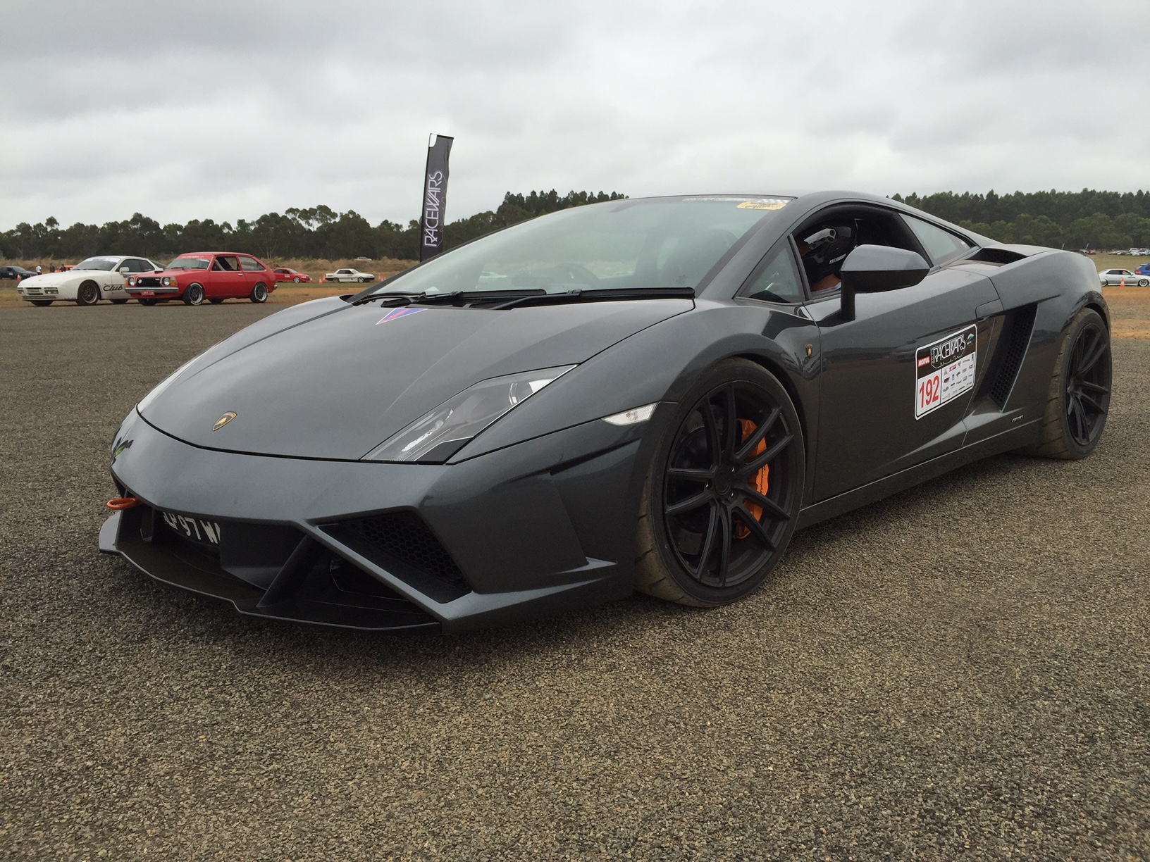

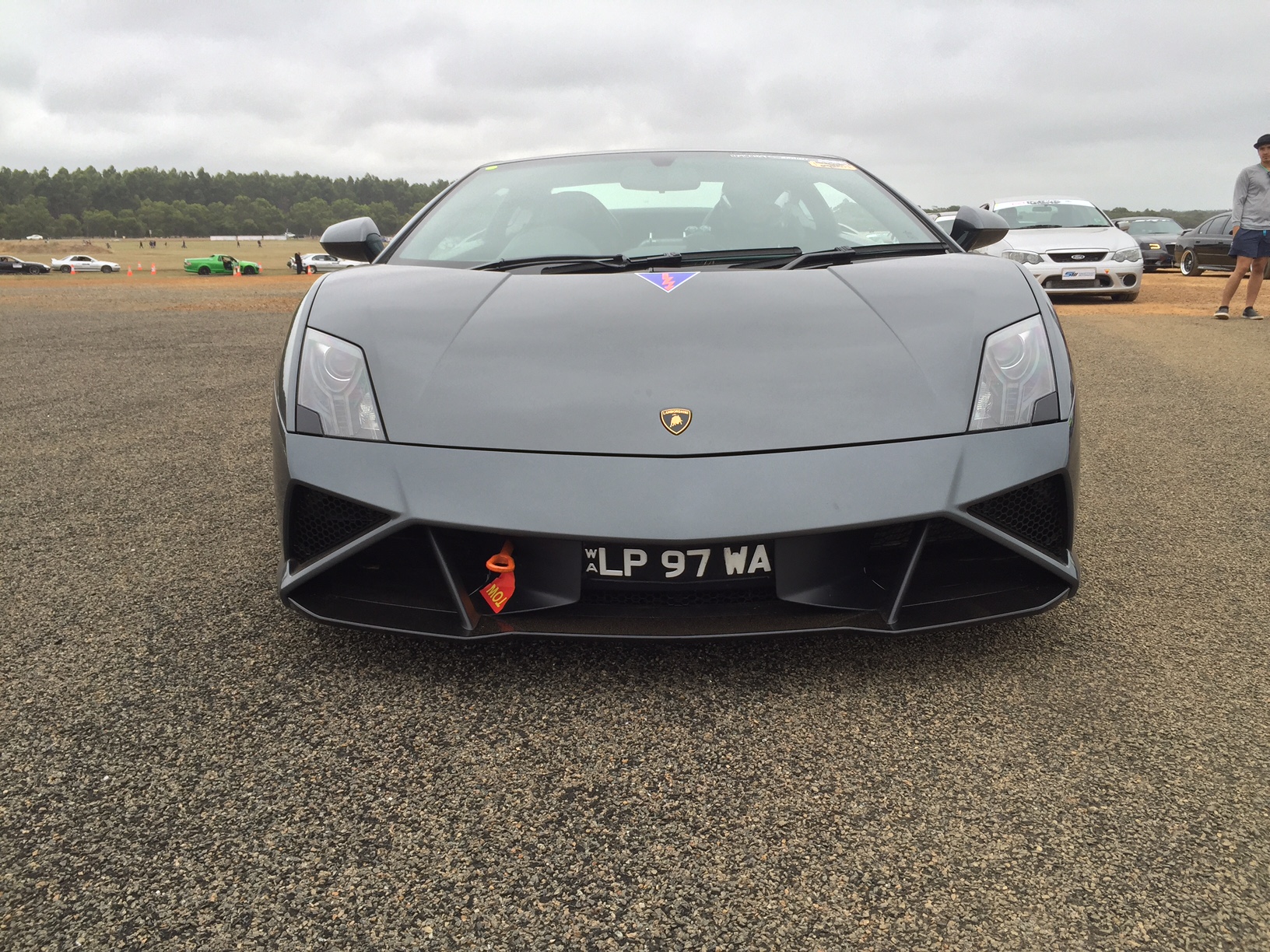

Lamboperth Report post Posted March 14, 2017 Couldn't tell you for sure. The fitment on both of ours was so bad that my body shop assumed both of our cars had been in front end wrecks because of how bad the geometry was. To get the vorsteiner on they added rivets to the fenders because, as they explained to me, it was a ton easier than trying to modify the bumper to fit in the OEM clips. That is the plan for my nose as well...mine needs brand new fiberglass all along the inside mounting area since the previous shop wallowed out every whole and pretty much chopped it up to the point of uselessness. The zip ties were a nice touch as well... Just a warning to anybody getting ANY brand front bumper...expect about 2 grand in fabrication/fitment/finishing costs. If your shop doesn't do that and just paints the bumper expecting it go bolt on you are in for a world of hurt. Hi Stoleit, love the look of your car. I was looking at fitting the revozsport engine cover, but have put a hold on it for now. I did fit the oem Lamborghini FLII bumper upgrade for 2014 LP560-4- pics attached. A perfect fit. The 'admirers' at Racewars 2017 800 and 1000 metre sprint seemed to like it! I have kept my front spoiler lip and struts gloss black for the squarda corse look as you have. cheers, john Quote Share this post Link to post Share on other sites More sharing options...
StoleIt Report post Posted March 17, 2017 Hi Stoleit, love the look of your car. I was looking at fitting the revozsport engine cover, but have put a hold on it for now. I did fit the oem Lamborghini FLII bumper upgrade for 2014 LP560-4- pics attached. A perfect fit. The 'admirers' at Racewars 2017 800 and 1000 metre sprint seemed to like it! I have kept my front spoiler lip and struts gloss black for the squarda corse look as you have. cheers, john Thanks! Yours looks great. Where did you get the front bumpers tow hook? Quote Share this post Link to post Share on other sites More sharing options...
StoleIt Report post Posted March 29, 2017 Home stretch! Rivets into the OEM frame to properly secure the LP cross brace. LP cross brace painted and bumper tabs transferred over from the original one. Wing tips are painted! Removed a line of masking tape...that sweet sweet paint-CF line. Wing mounts finally milled down enough (took two trips), painted, and getting installed onto the LP cross brace. Rear end is pretty much buttoned up...so time to re-fit the Renown Lp570 nose. Quote Share this post Link to post Share on other sites More sharing options...
Lamboperth Report post Posted April 1, 2017 Thanks! Yours looks great. Where did you get the front bumpers tow hook? Hi Stoleit, you can buy from lambo stuff. p/n 400803615. I just spray canned it fluorescent orange so stands out. For events, I also remove the tow hook cover completely by squeezing the diamond shape plastic that holds it in place as I have lost a couple of tow hook covers in sprints at 327 km/hr/203 mph. <a href="https://www.please check with our franchised lamborghini dealer sponsors.com/product.asp?prid=20799&Mode=add" target="_blank">https://www.please check with our franchised lamborghini dealer sponsors.com/product.asp?prid...99&Mode=add</a> I also had the gap between the bumper and bonnet reduced a little by adjustment. cheers, john Quote Share this post Link to post Share on other sites More sharing options...
