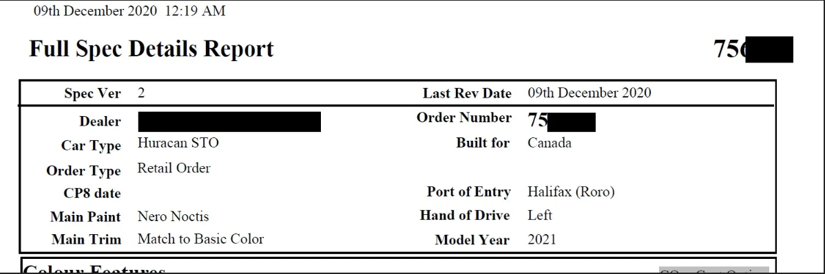

On 12/5/2020 at 11:57 PM, sl55 said:
Placed my order today, going black with red accents. Looking at July delivery.
Congrats!
