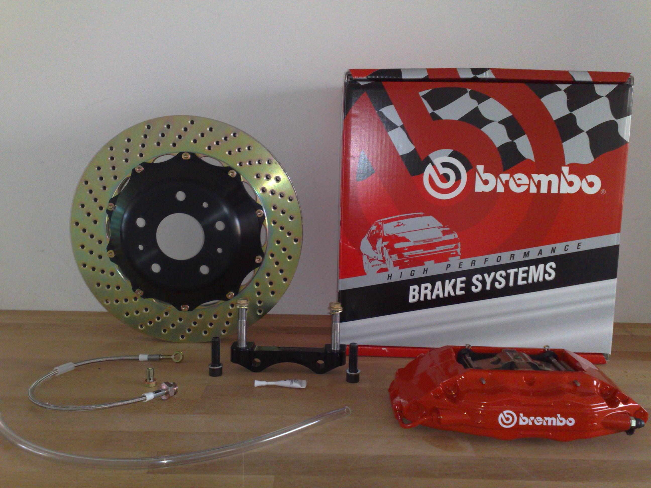

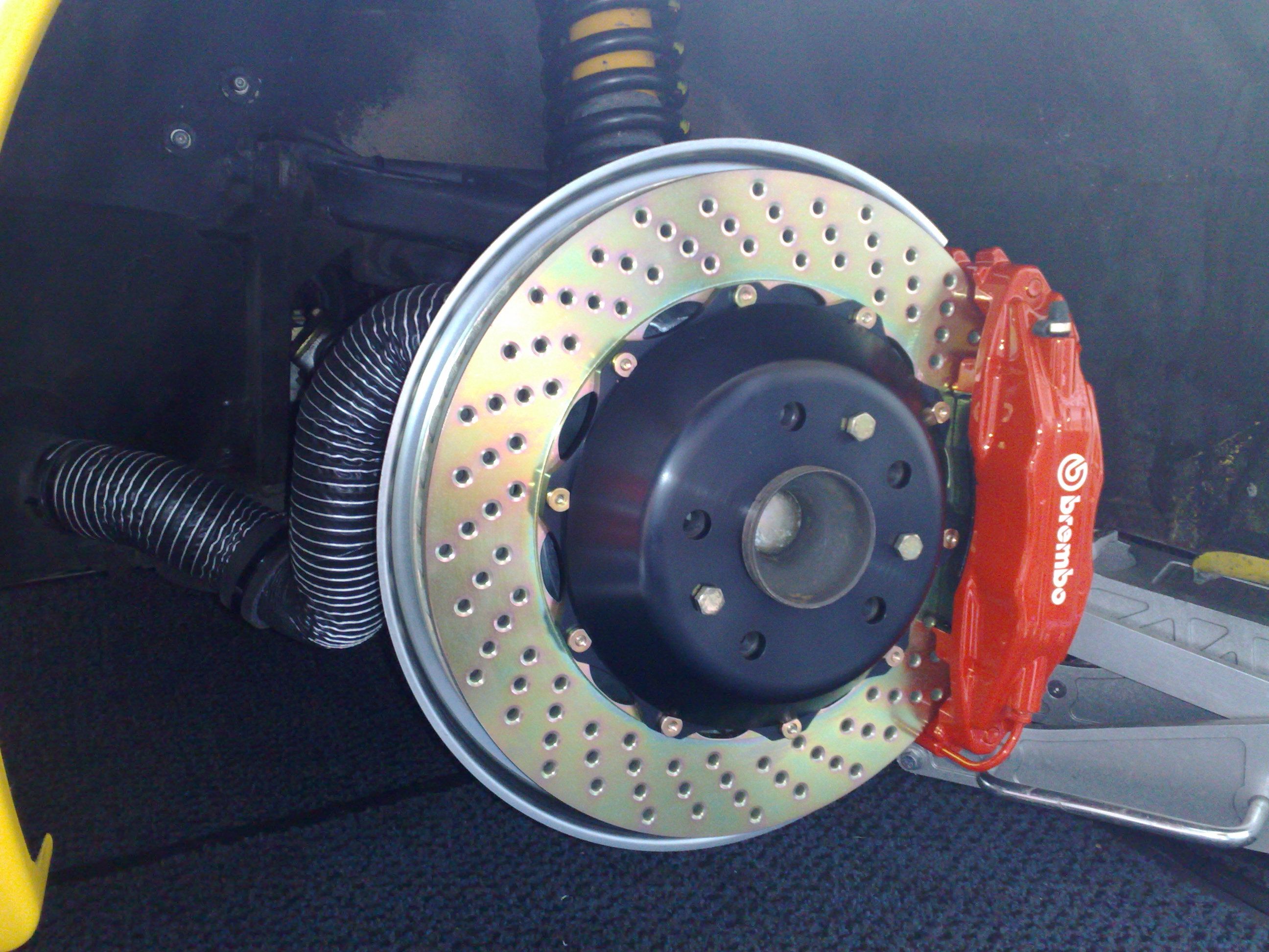

http://www.buybrakes.com/brembo/gt-apps-Lamborghini.html

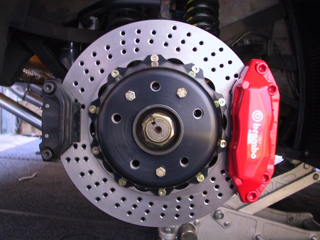

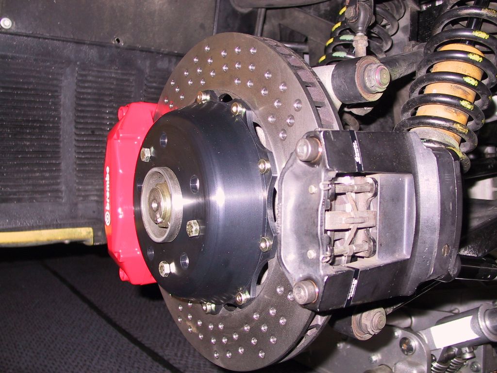

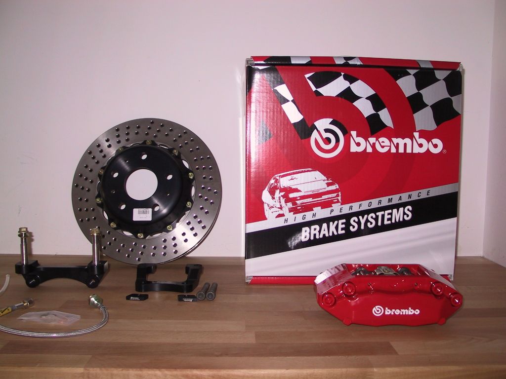

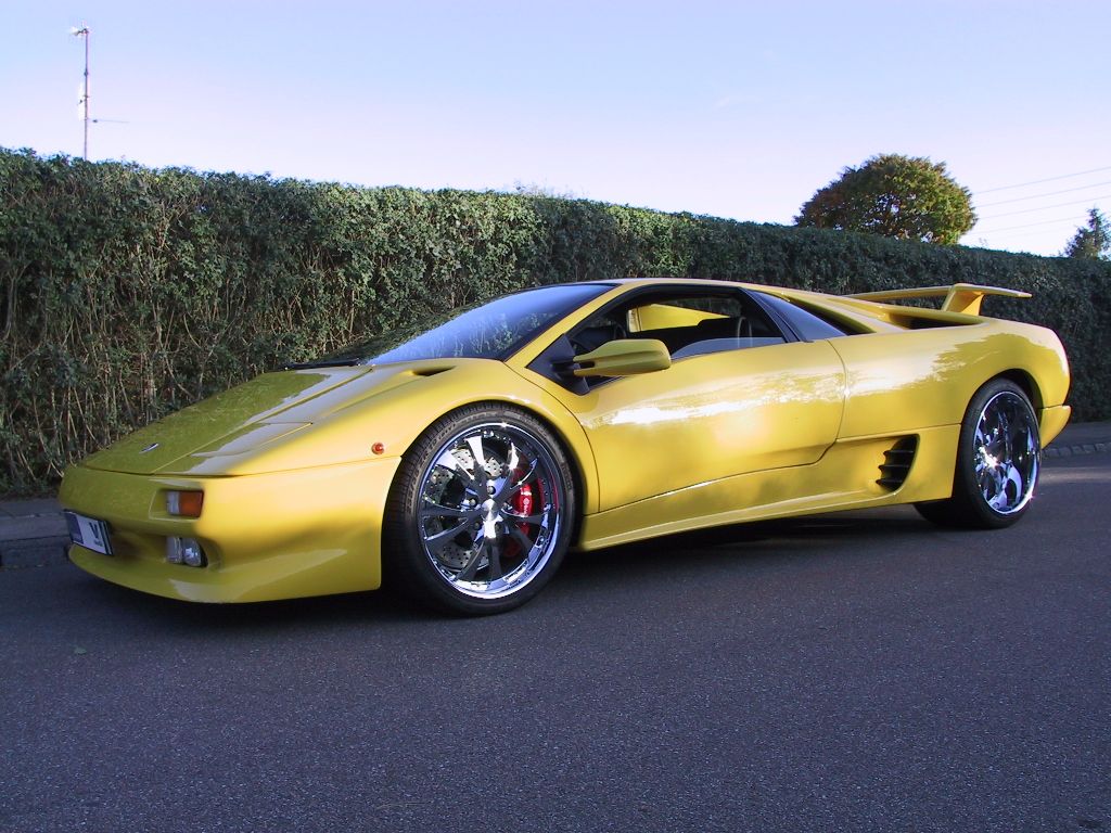

If you this you need 18" wheels:
Front 32x355mm
Rear 32x328mm

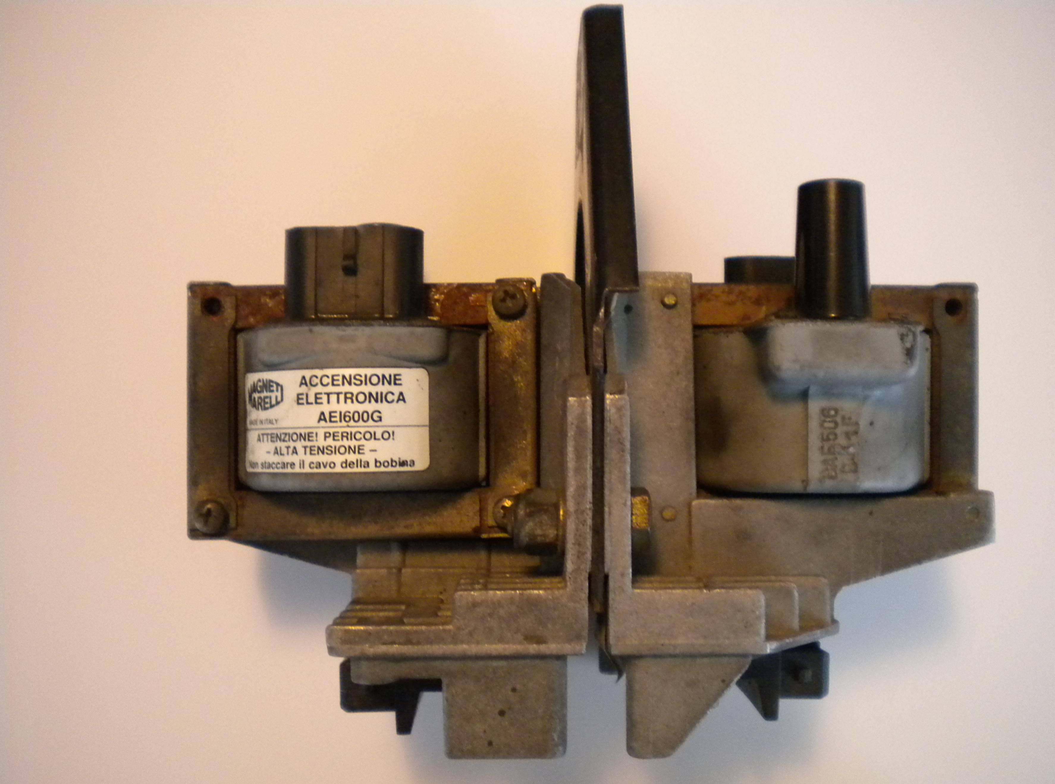

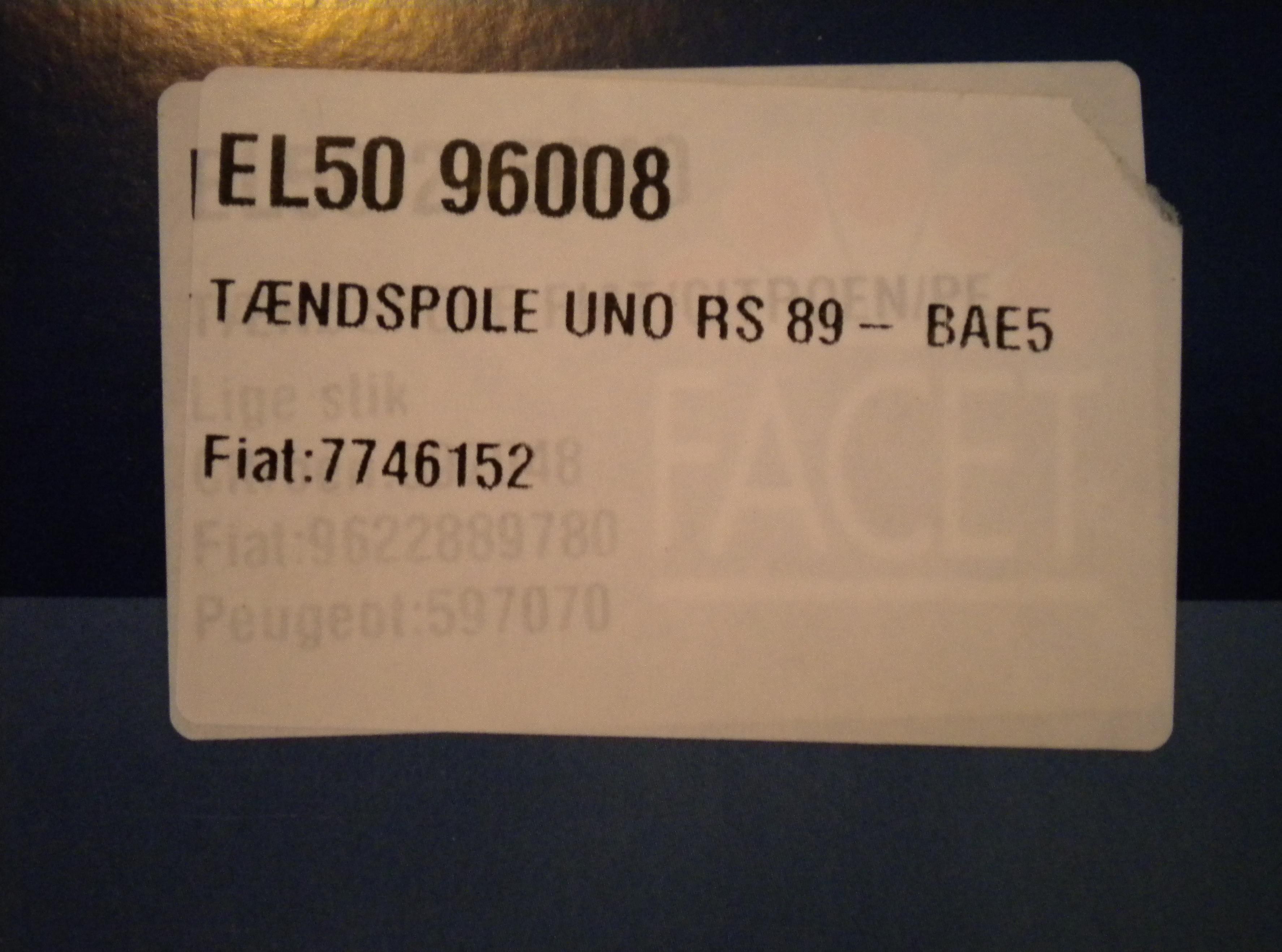

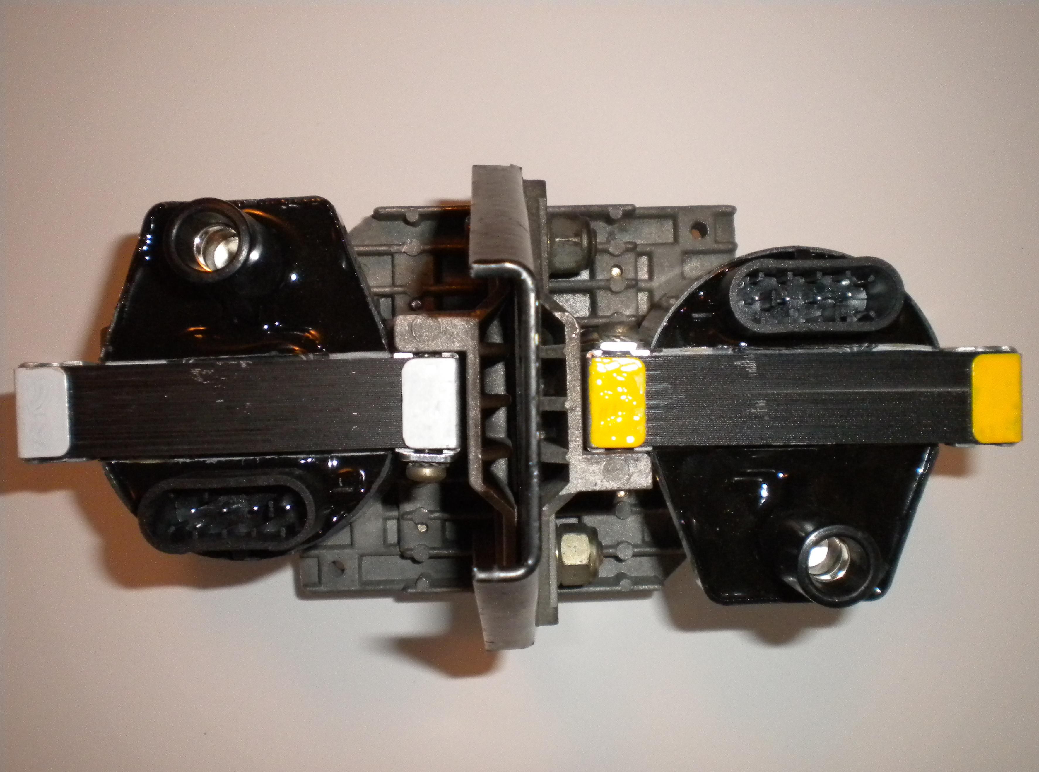

I would not use jag, it is not the same ohm, I think it 5,51 k ohm, and the one in the Diablo is 3,91k ohm. I had the same problem with one of my ignition coli.
I bought those two brand new for less than 100$ . They are exactly the same ohm. And the car drives fine with them.
I have a problem saing what car its from : Fiat Panda / uno

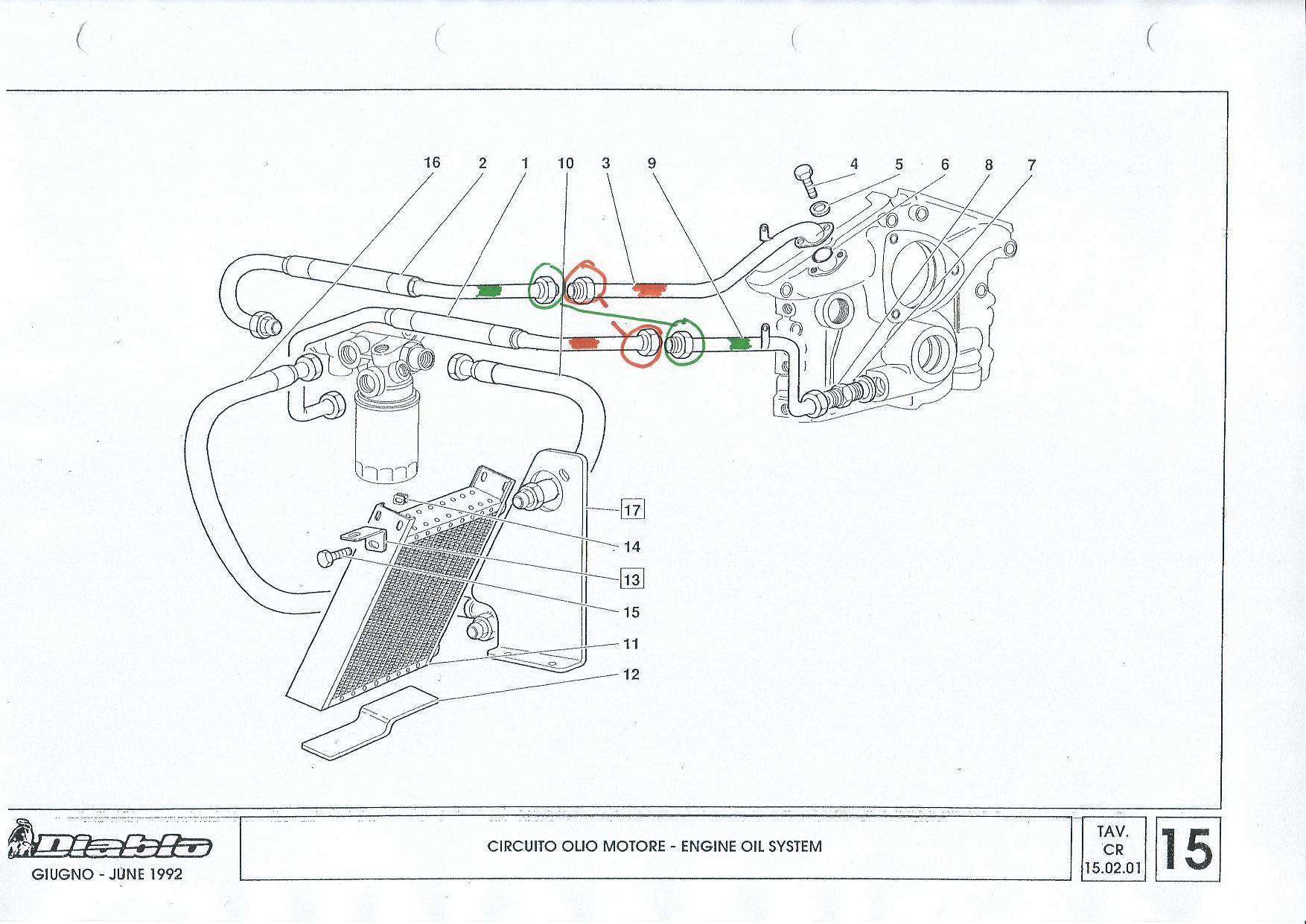

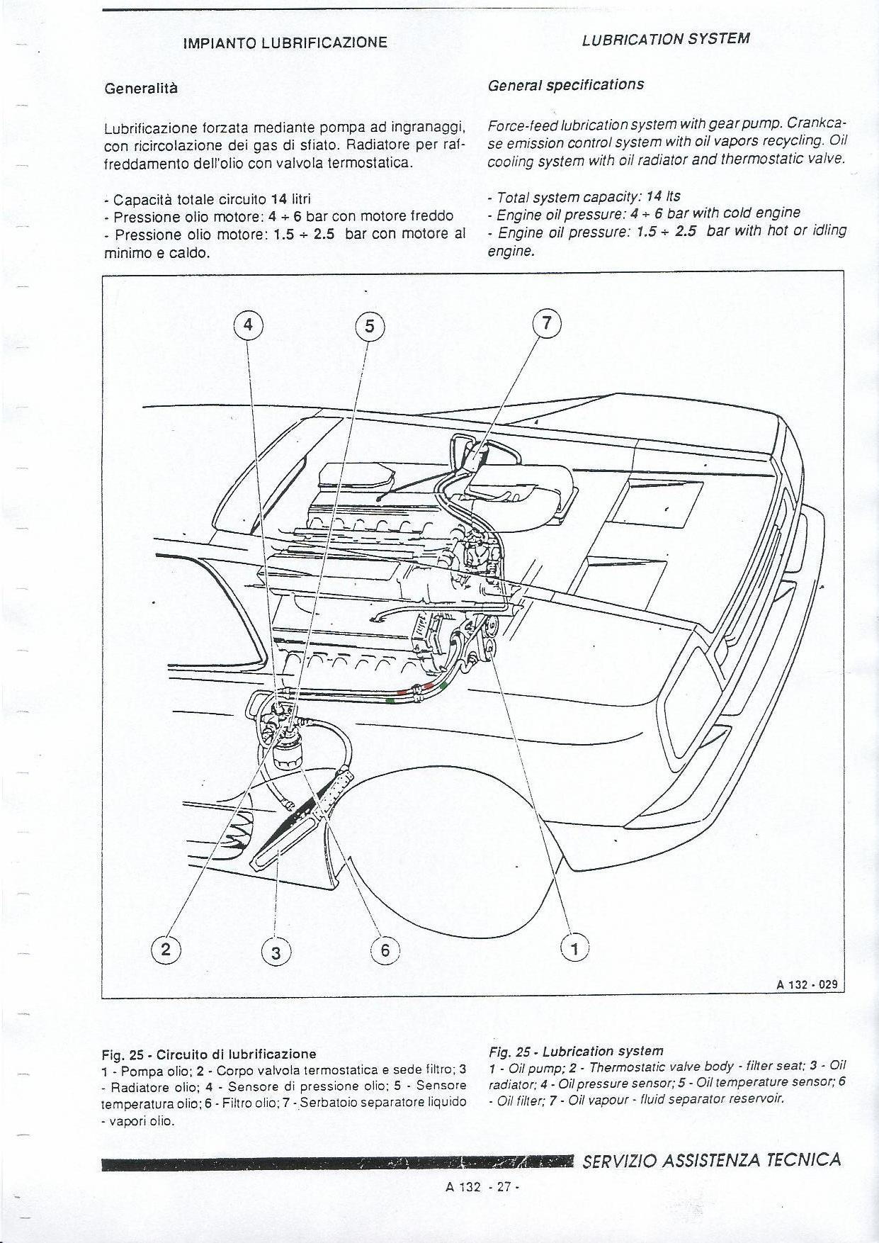

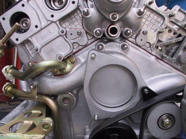

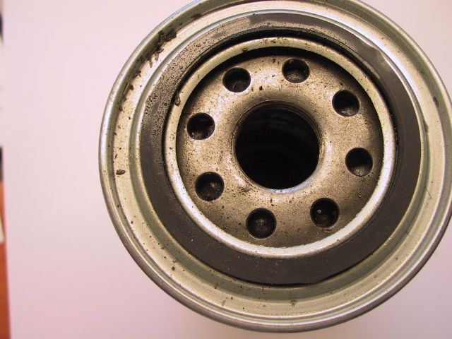

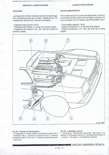

If you have a oil pressureproblem maybe it could be this:
Maybe your oilpipes is like on photo 1. The picture is from Lamborghini's sparepartsbook. But they have made a mistake. One of my friends visited the factory and talked to Valentino who said that of the record, Lamborghoni know about the mistake in the sparepartsbook, but they would not admit it because of the costs. So they clossed theire eyes for this giant problem. This is only a problem for the early Lambos with 2WD.
Photo 2 : this is the it should be:

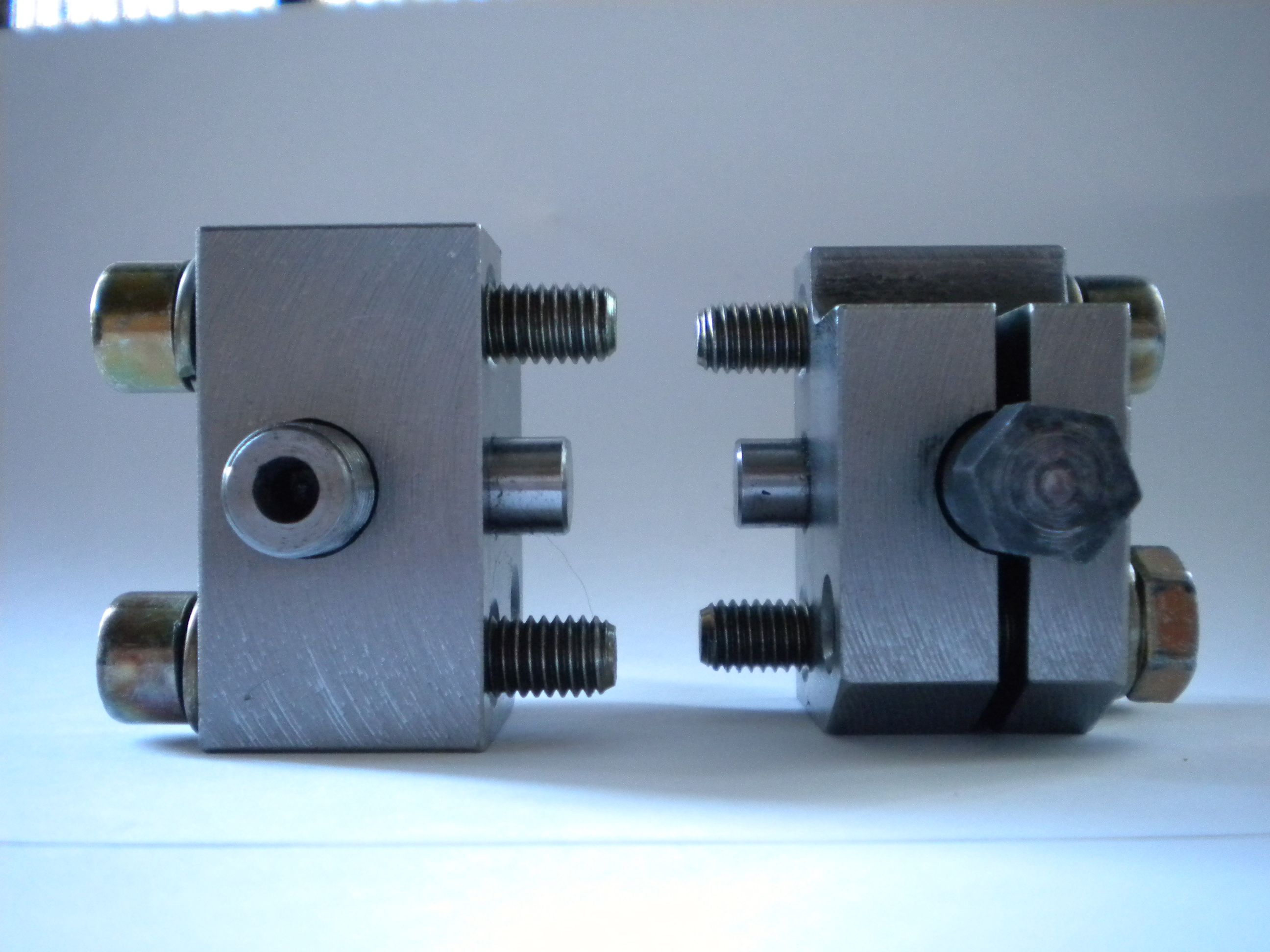

Photo 3: my oilfilter, how it looked after the oil went the wrong way through.

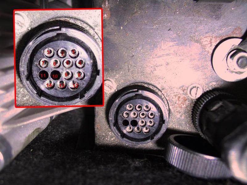

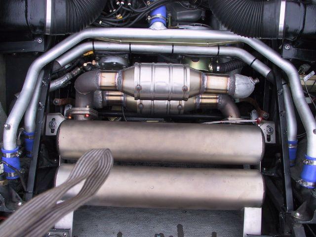

Same here, four bulbs was taken out, engine L & R. And catalyst L & R. I had to replace 2 catalytic, and then I pressed the gaspedel down, the throttle whas just opening a little over halfe.
Cstalyst L flashing three times then I start the engine, what does it means, where do I get kodelist for flashing light?

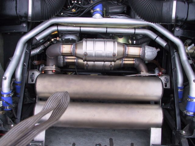

First class work, it loooks very good.
But I do have a Question : How does the car behave in fast turns, with all those extra kilos so far on the back.?
wow, thanks for that pic.
I do not deserve the credit, it sholud go to Adam "ab" who made the photo for me.

Need help with Diablo brakes
in Archived Content
I know, I'm sorry, it should have been : If you want those brakes, you need 18" wheels
