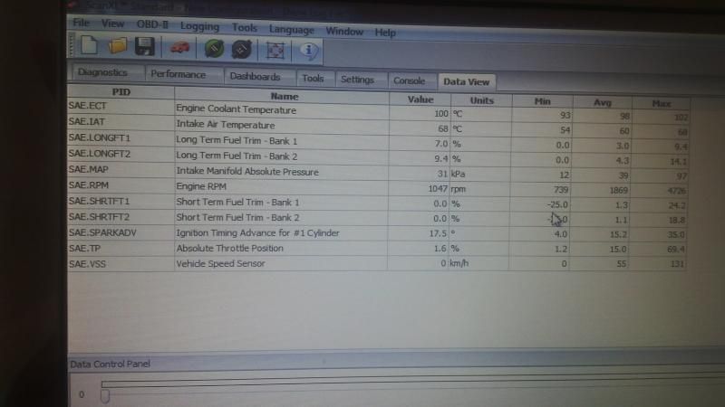

The check engine light flashing is not good. it is telling you that is is running or missing bad enough to do damage to your Catalytic Converter. Long trim fuel numbers is on the high side but I never look for a problem unless they are +10 or -10 (on normal cars) The short trim fuel is used to fine tune the fuel to keep the O2 sensor so they are able to go above and below 450 mill volts. Your car has a problem so the numbers for fuel trim is bound to be off. It sounds like you have a miss. Does the car buck or jerk at all? We really need the codes to see what cylinder is acting up.

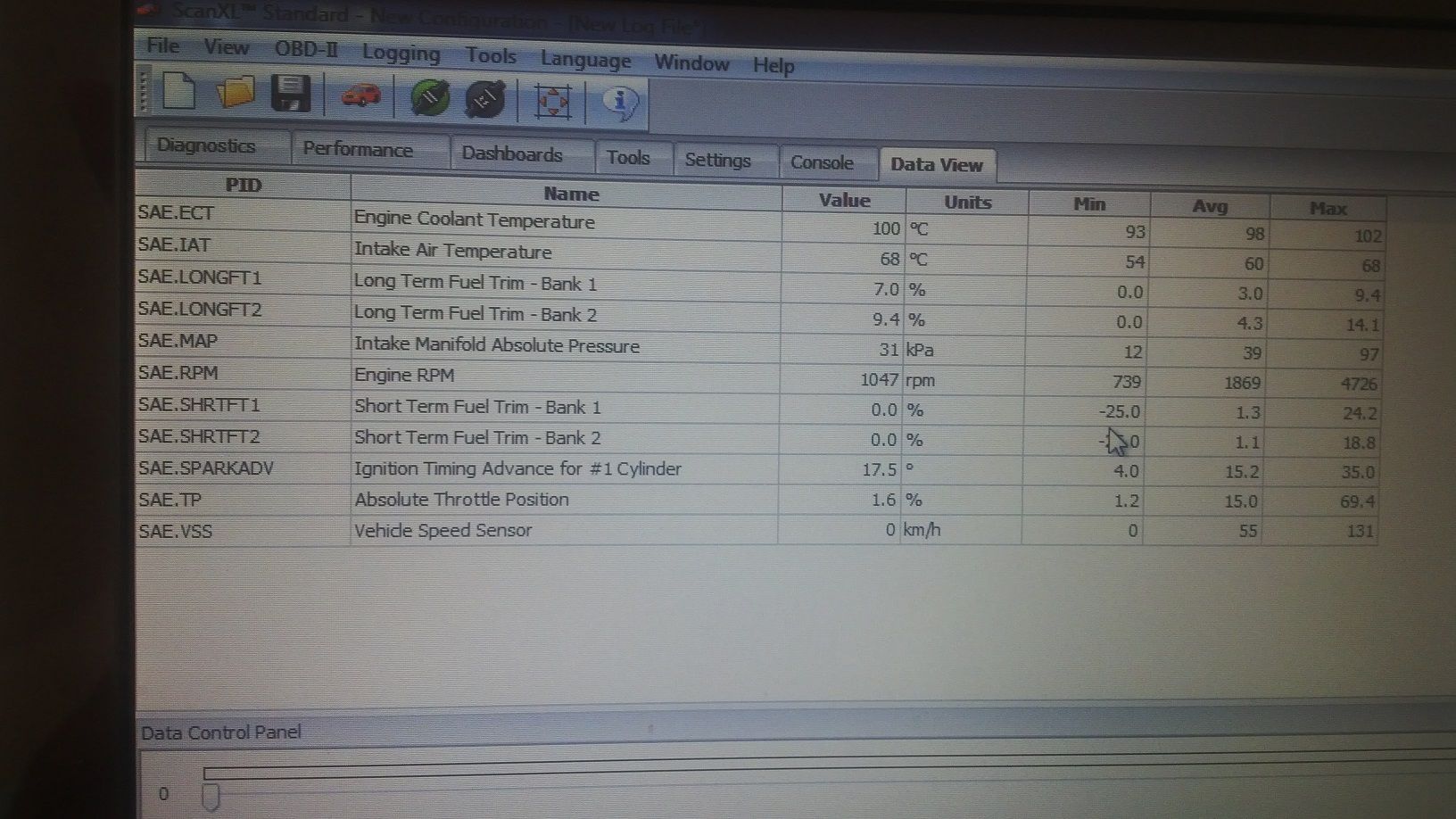

Thanks for the reply. In this instance, the light did not come at all (not once). The pic is at the end of a 30 min drive, during which there was no Engine Light, and the scanner said there are no pending codes/fault codes at all..
Also - is the coolant temp a point of concern? Or the intake temp (since the outside temp is only 40, shouldn't the intake be the same, or is it 'normal' for the intake temp to be higher (60 in this case) than the outside air temp)?
Thanks!!
Hello everyone
I've been driving the Diablo a bit, and have had the following issues come up:
1) L Engine Light - comes on at stops/low speeds, blinks while accelerating, and goes away at higher speeds... comes back/blinks at lower speeds, etc
I tried to get the codes with a scanner, but the light DID NOT come on the two times I drove with a scanner (and charged laptop)... the other 3-4 times, it has done the above, but I have been unable to pull codes as the laptop has had a dead battery!!
2) Coolant temp running hot - car shows 95+, OBDII scanner shows 205F (98C-102C) while driving!!
Intake air temp sensor shows - 55C-60C
Actual outside temp during this drive - 39C
Other info noticed in drive (during issue #2)
Engine timing advanced 15-20 under normal accelerating/cruising
Can anyone point out if I need to be concerned about the car running hot? Should the intake temp be that high (60) when the outside temp is only 39? The coolant temp is also 100 (205F) - is that a cause of concern?
Can anyone explain what the Fuel Trim figures (short term/long term for Bank 1/2) are?
