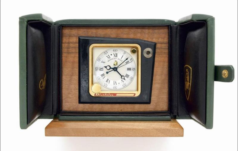

Looking for information on the Breguet clock option. Anyone out there know how to remove the Breguet clock from it's green leather case? How do you wind it? What is the 4th arm for on the clock face, is it a stopwatch?
Thanks in advance.

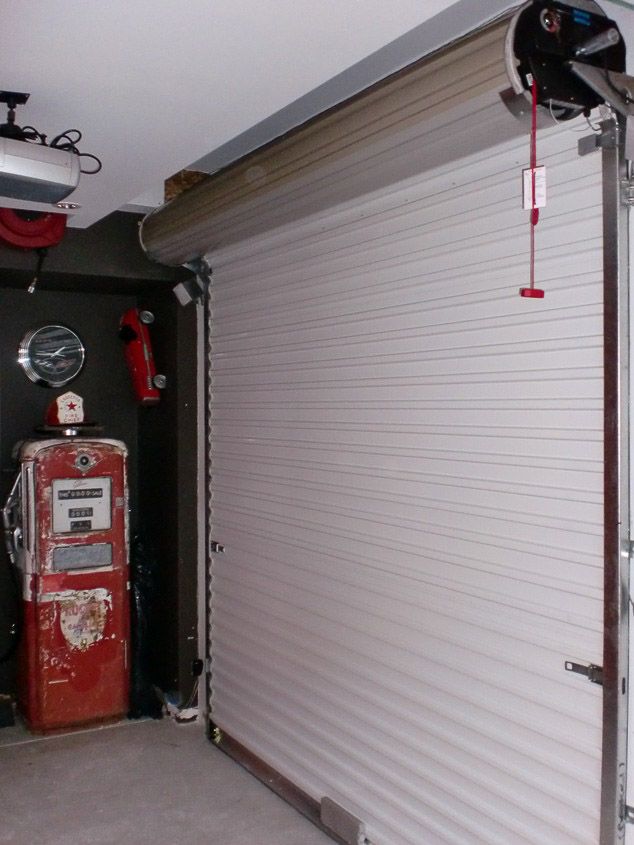

I'm in the process of building a garage/show space right now as well. I decided to go with a roll up door, instead of the standard track door. It's super quiet, made of steel, and insulated, which would be good for your Utah winters. I agree with the exhaust fan idea. I'm having mine wired so that when the big door opens, the fan will come on automatically for a preset length of time to clear the exhaust gases out. The fan size should be selected based on getting a certain number of air exchanges every hour, I think mine was 6 exchanges per hour. Don't forget to have a vent installed to allow make-up air back into the garage, to replace what is being blown out. I also had 4 Velux Solar powered opening skylights installed to let in natural light and to vent out hot air in the summer. They have solar powered blinds on them, if you want to block out the light, just push a button on the remote control. While my garage was in the framing stage, I had it wired for speakers and a home theater system. Not sure what your plan is for wall construction, but since we get cold winters here too, I had the walls framed 9.75" thick with a total of R40 insulation, also added a layer of Styrofoam to create a thermal break, then double layer of drywall for some extra sound proofing. Good luck with your project. Keep the forum updated with pics as you progress.

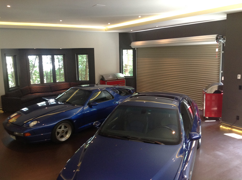

Indeed a great set up!! Where I live the weather gets into negative 20s at times, and these metal roll up doors can't be used for insulation. May not even meet building codes I'm afraid. Love the fact it free up the ceiling for a cleaner set up!
my next house, my garage will have the right set up. I'm in my first house that I've bought. Decent for a starter home.
The friend of mine who bought the roll-up door lives in Edmonton, Alberta, where it gets down to -40. He bought the insulated version of the roll up door and claims that it is better insulated than his standard insulated tracked door, he said that he thought it was rated at R27, with 26 gauge steel construction. It does meet all building codes in Canada, but their site states that they have sold them all over North America. For extreme cold I have seen insulated door blankets at Home Depot that can hang over the inside of the door when the door is not used to extend the R value.

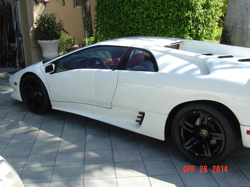

I have to admit I'm not a fan of the white intakes on the side and the vents at the rear, neither the color coded taillight surrounds ... it is different and I admire your courage for it, but I would just tint the entire taillight, surround included and make all the black parts shine in clear carbon fiber.
The blue accents on the white wheels are a nifty touch however, do like that.
