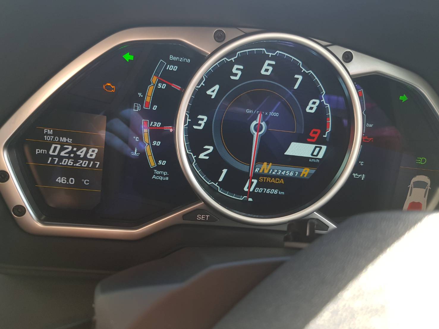

I am no expert but I think I am starting to have a clue where the issue comes from. As I was driving back, I hit a heavy traffic jam. It was around 30 minutes of stop & go and changing between N and 1 repeatedly. In the middle lane, the car decided to stop again. I put on the emergency lights on, and attempt to restart the engine - which trolls me with the "vroom" and going back to 0 RPM. After 8 tries, it just won't start. Someone helped me push the car into a safe place.
Here's a picture of the dashboard in which we can see:
- The car indicates an outside temperature of 46.0 C, which is a very hot temperature even for Bangkok
- The engine temperature is VERY high - in the red. Never happened in the evening though.
- The air conditioning was set to maximum, and still didn't cut it because of the hot weather
- I lifted the engine hood and felt the heat, so the gauge is probably right
I guess:
- Doing stop & go in the traffic for half an hour under a 46C temperature is probably overheating the engine
- Setting the air conditioning to max does probably the same effect
- The engine shutdown is probably a safety measure to prevent damage in case of excessive heat
One weird thing: When I was attempting to restart the engine after the first failure, the temperature gauge was jumping between the middle point and the red zone. No soft motion, just a "warp" motion. I also saw two different error messages appear on the dash during my 8 attempts to restart the car:
- ESC / ABS fault
- Rear wing defective (the wing was up)
- The speaker saying "low voltage, check power supply", although I'm pretty sure it came from my laser jammer's speaker
My hypothesis is that something is overheating the engine. I'll have it checked at a different place on Monday.
