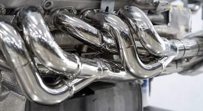

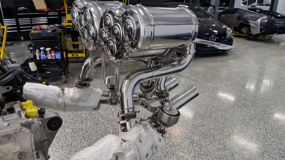

In my search for an exhaust for the LP640 and the numerous options out there, I was inspired by the Murcielago GT1 Car and it's Murcielago F1 Scream and wanted something similar.
My first preference was a set up from but Avante Garde Exotics, however I need something with valves and they didn't offer it. My Aventador has a Kressieg system which is 100% madness!! So naturally Kressieg was the way to go, however, after some convincing from the Capristo dealer here and online reviews regarding Capristo being a superior brand & quality... I decided to go with the full Capristo set up https://capristoexhaust.com/product/lamborghini-murcielago-lp640-complete-valved-exhaust-system/ , BMC Filters and ECU Tune.
My first impression - the system looks amazing, hard to beat. However, Kressiegs quality of welding blows Capristo away.

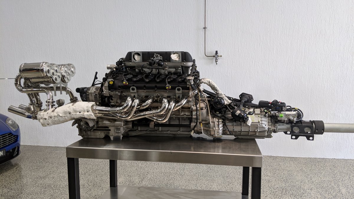

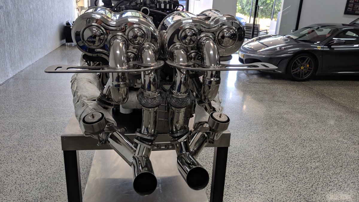

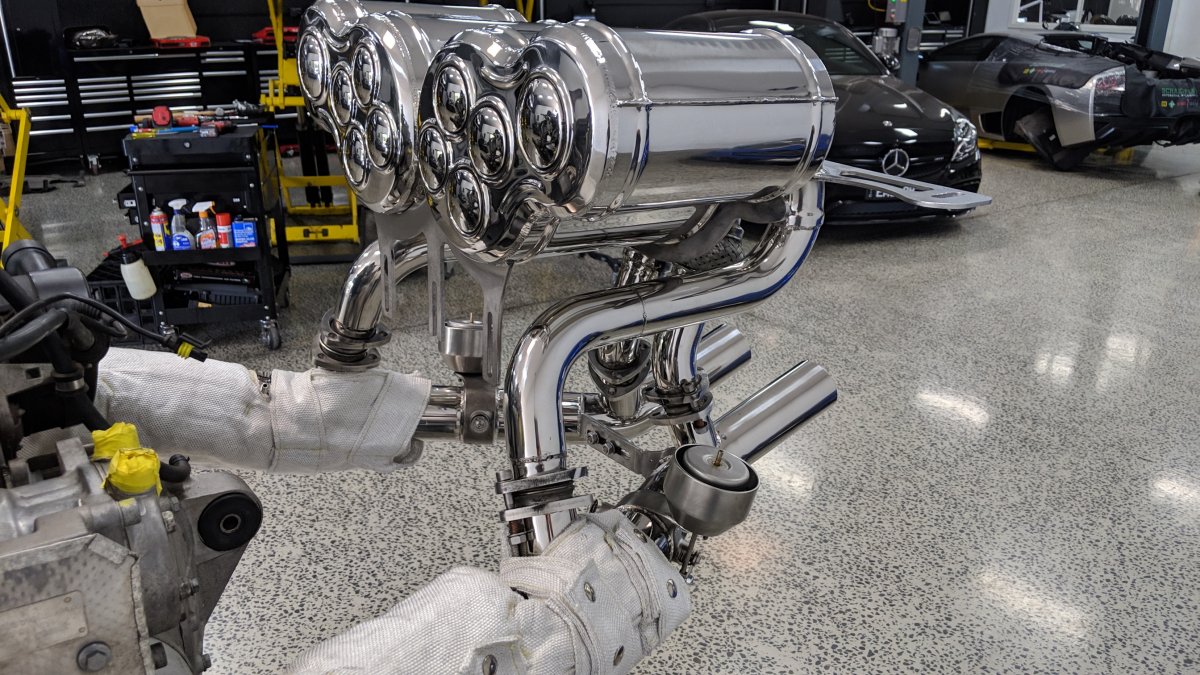

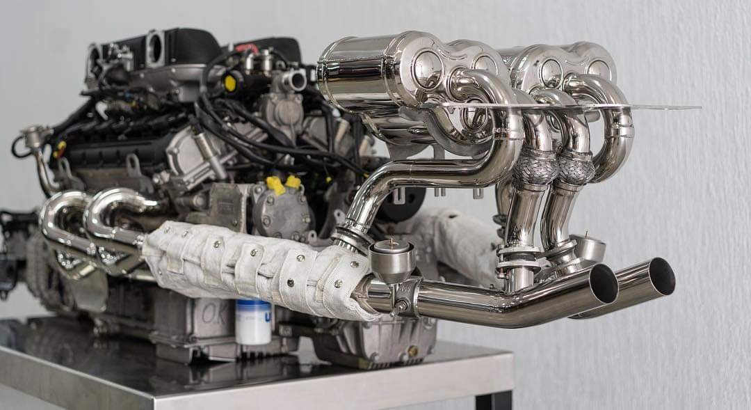

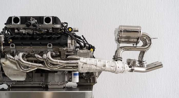

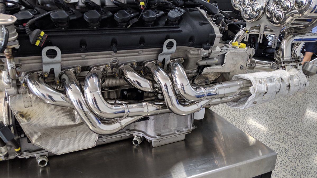

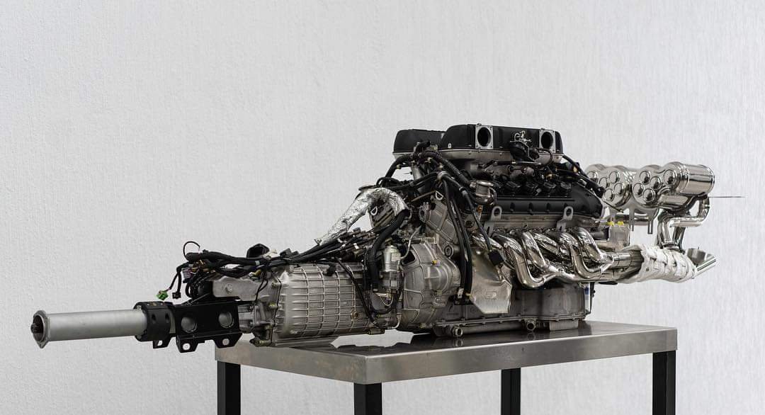

We pulled the entire motor out (see photo's attached)
Trial No 1 - Set up was a full system new headers, straight pipes full cat deletes, BMC filters & ECU tune.
Sound: With cat deletes, idle is very loud, raspy and take off can sound pretty average like an old 4 cylinder Japanese car if you dont clutch it right.. Almost as though the exhaust pressure is fighting against itself... maybe a cross pipe would help.
Once you're off though, from idle up to ~4000RPM the sound is just awesome, it's a controlled quality deep raspy echo.. However after that, full throttle it to redline and all it does is stabilise the sound.. no scream, more a bark. See Youtube links. 1) Taking off from lights > https://youtu.be/cDc8N7UjI3M 2) At 11 seconds you'll see the Murci drive past and hear the Capristo at 12-13 second mark > https://youtu.be/dGT_2W_Wudw - Note my White Aventador with the Kressieg is also in this clip - you can hear its howl that turns into a scream, before the car arrives in shot from the 5 second mark in the video.
Power wise, the car definitely increased in power particularly above ~3500rpm, however, below that felt about the same. We haven't dyno'd the car yet.
Trial No 2 - Following my complaints to the workshop, they recommended installing front cats, to help remove the 4 cylinder sound at take off and get that Murcielago scream top end. Impact - raspy 4 cylinder sound is gone, the sound upto 4000rpm is even better, deeper and cleaner, alot of the raspy rattles have gone. However, it's done nothing to the top end scream. Power is definitely up, all over the range particularly below 4000rpm.
Overall, I'm 50/50 about the system - below 4000RPM the sound is hard to beat, above that - it is a massive disappointment. The car doesn't have the howl of a Kressieg, in the Aventador, people hear you coming way before you arrive, the Capristo would be nice to have that low down howl and definitely missing the F1 scream. I've gone back to Capristo, looking for help from them to get that scream, just waiting to see if they can help.
If Capristo can't I'll either remove the cats back and replace with a new system - any tips appreciated, ideally something I can add valves to. otherwise, if there's any tips on modding the existing system, I'd appreciate those as well.
