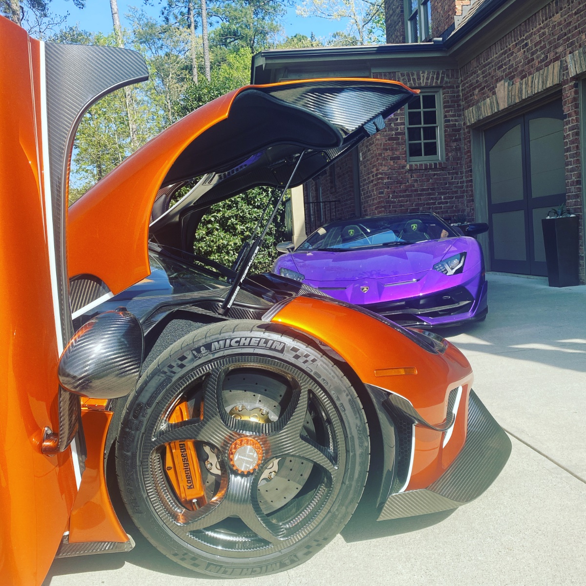

Beautiful cars. Is that your Koenigsegg, too?
No that's a friend's car.

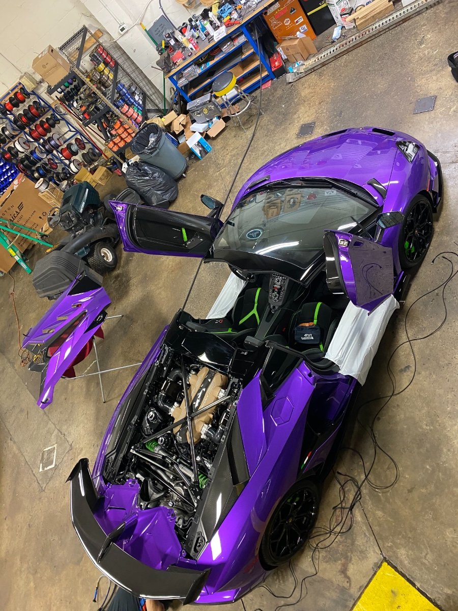

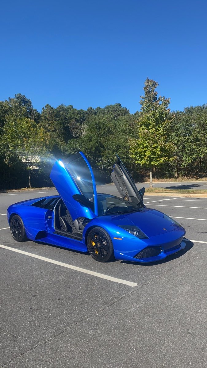

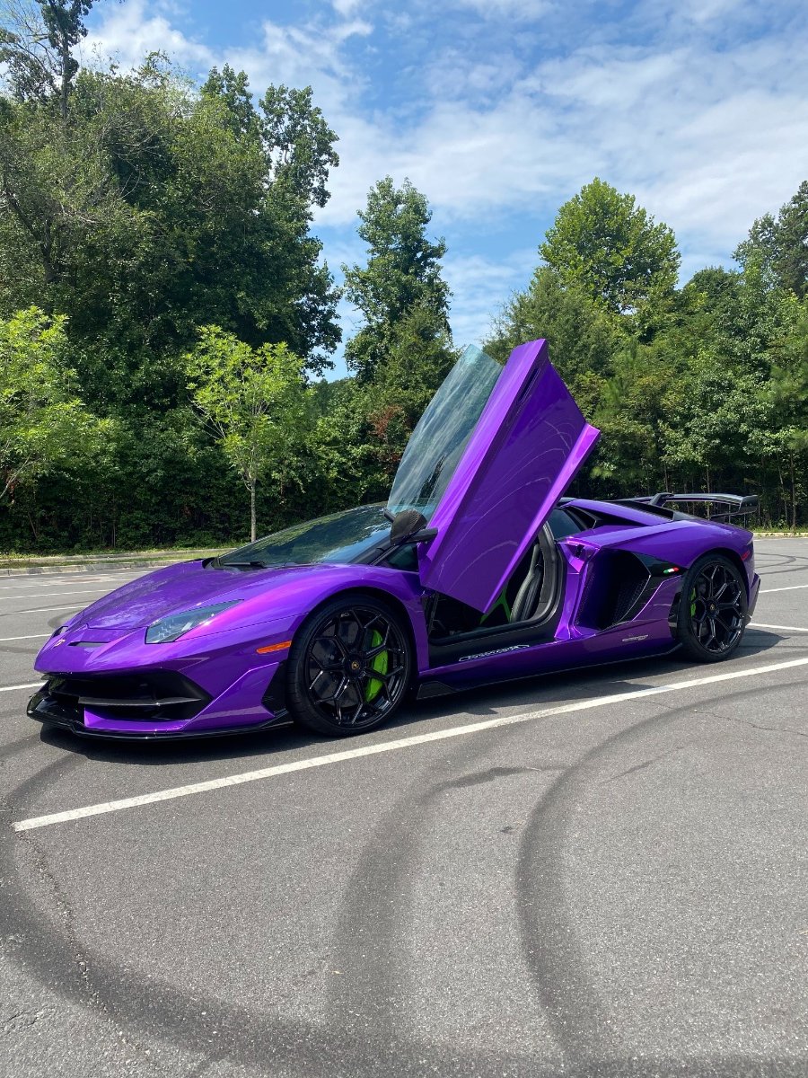

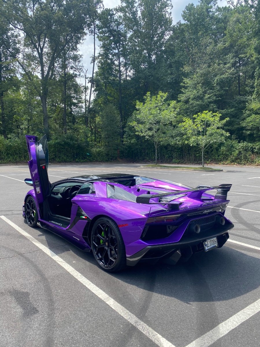

Just a few random pics of my Lambo's. Love both these cars. Just hit 2,500 miles on the SVJ Roadster and on the Murcielago LP640 I just did a complete major service (clutch, throwout bearing, coolant hoses, electrical shielding, e-gear reservoir, engine gaskets/seals, engine mounts and a bunch of other stuff)
Loving my SVJ. The car was always great but after getting the Coupon A service done (all new fluids) and putting 2,500 miles on it it has only gotten better. It seems completely dialed in now. The only thing I would change with the car is the shift mapping from 1-2 in auto mode. It shifts too early.
