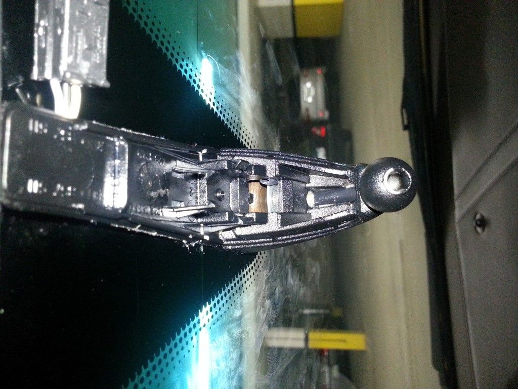

Got it off. Just required more muscle
Doesn't seem to rotate. I'm able to wiggle it slightly back and forth but not much....
