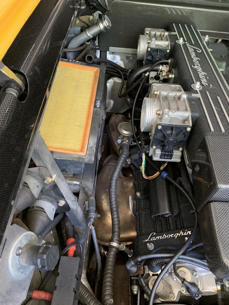

Had check engine light( emissions and misfire)
hesitation around 4000 RPM on WOT
decided to change spark plugs and COP
thx to all the help on LamboPower
multiple posts

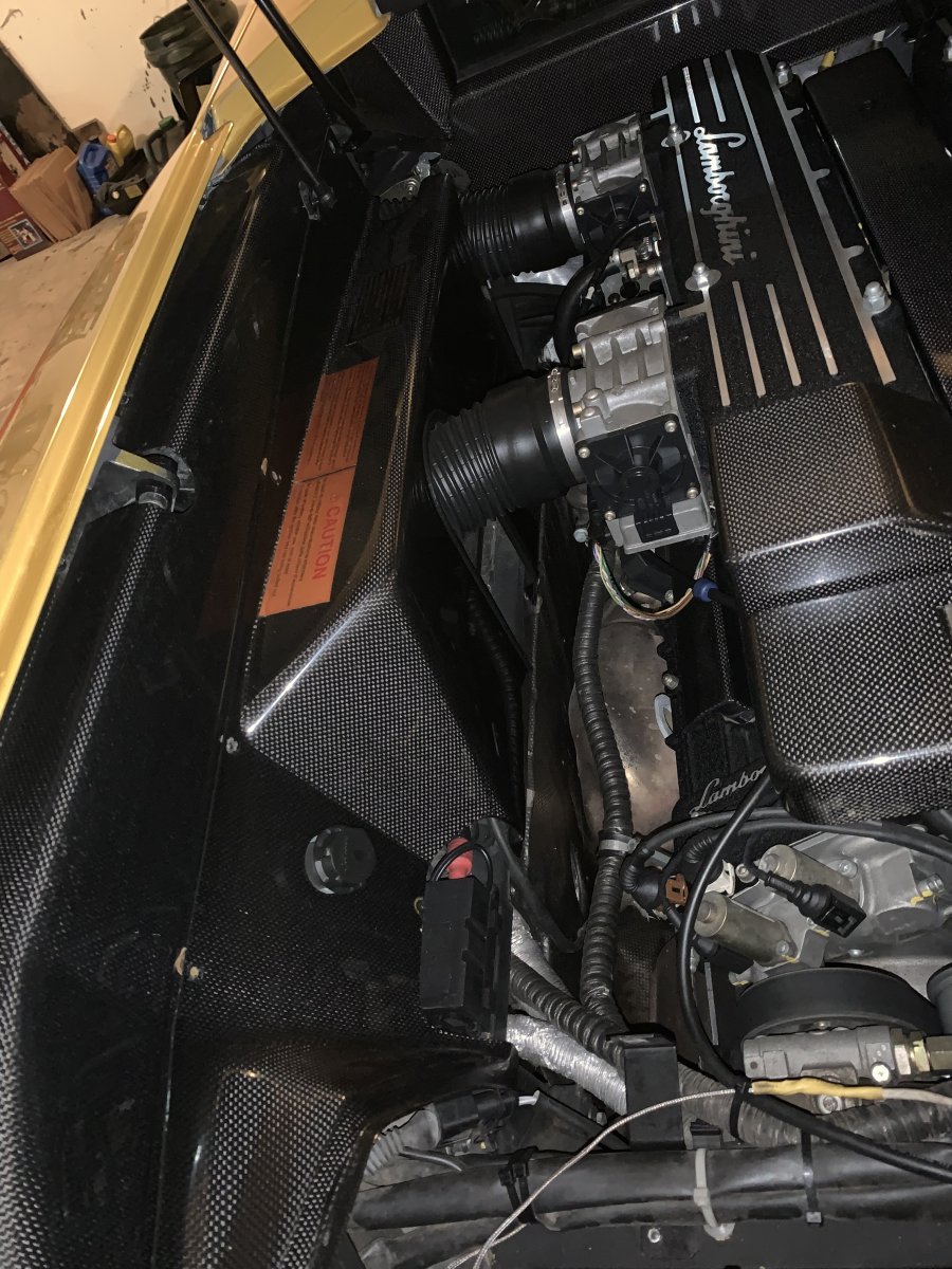

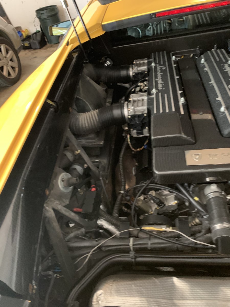

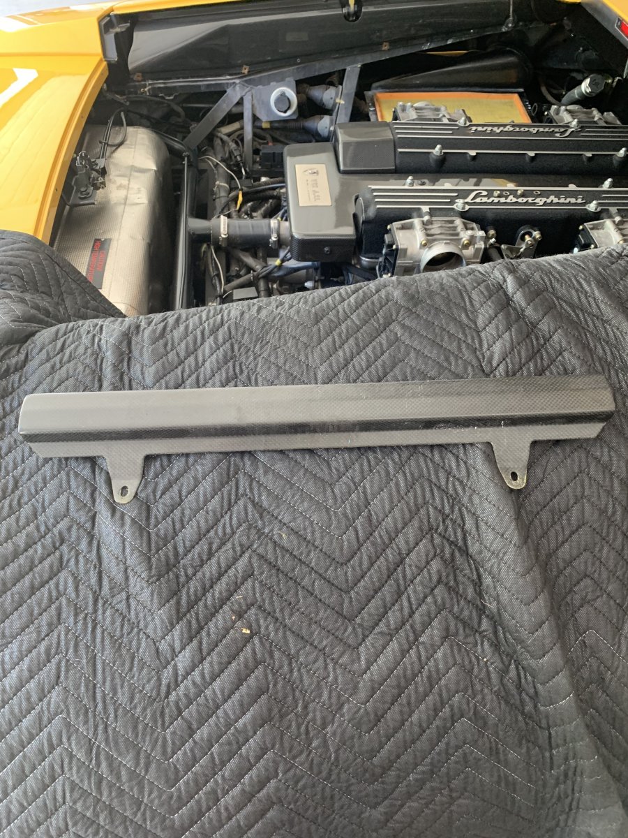

removed Exhaust Grate
removed side engine panels

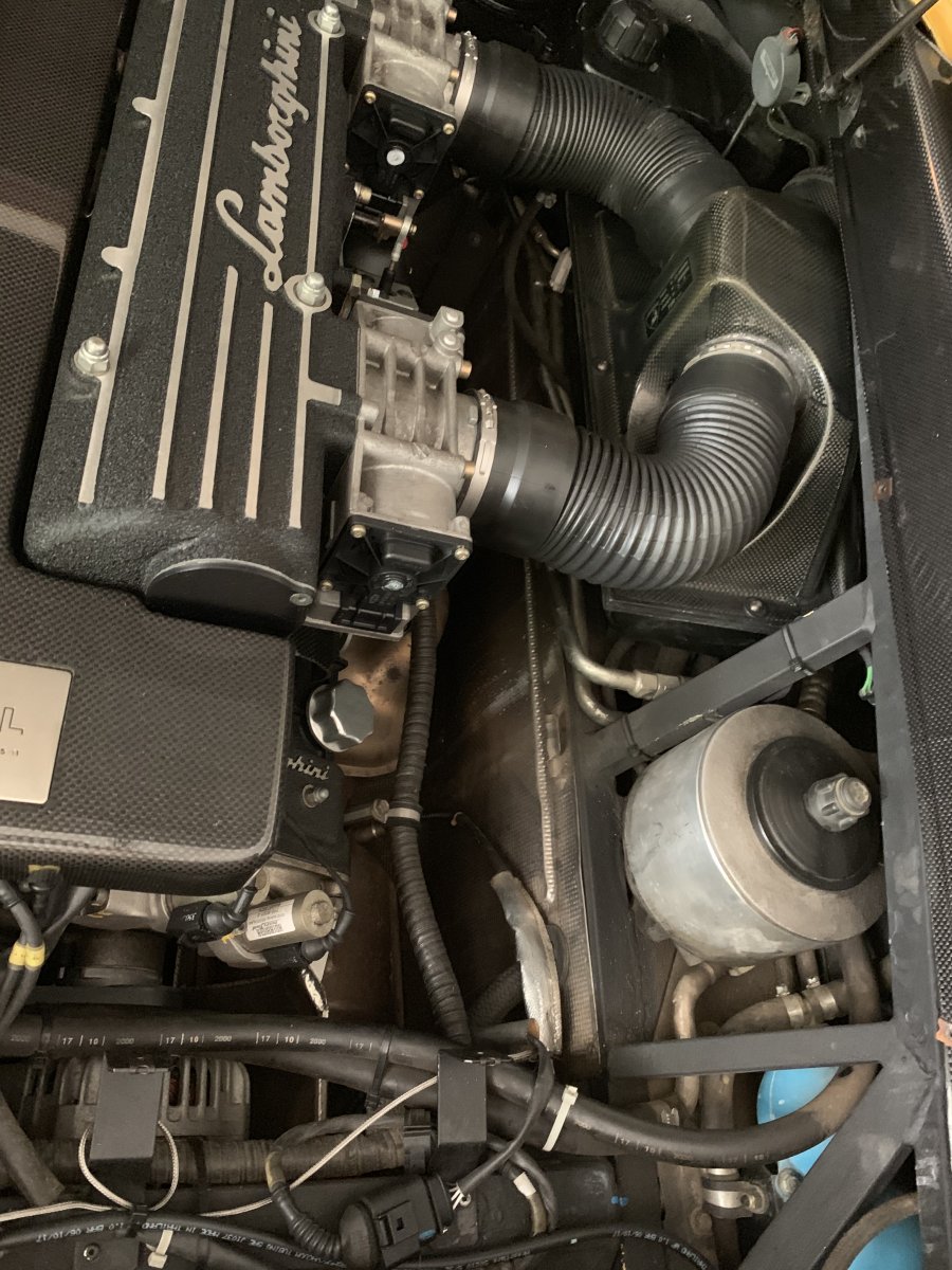

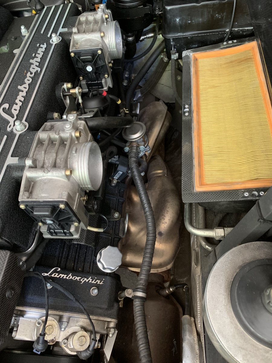

Still needed more room, removed air filter cover and hoses

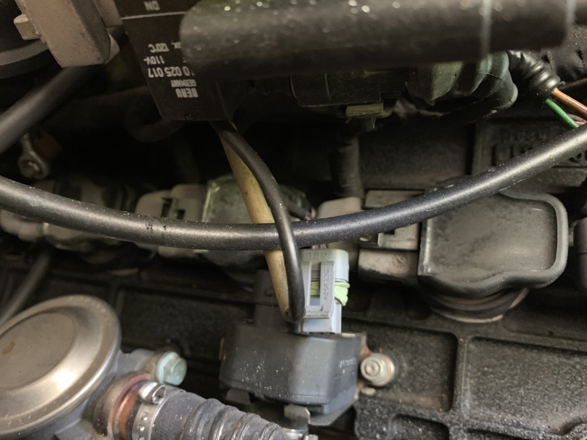

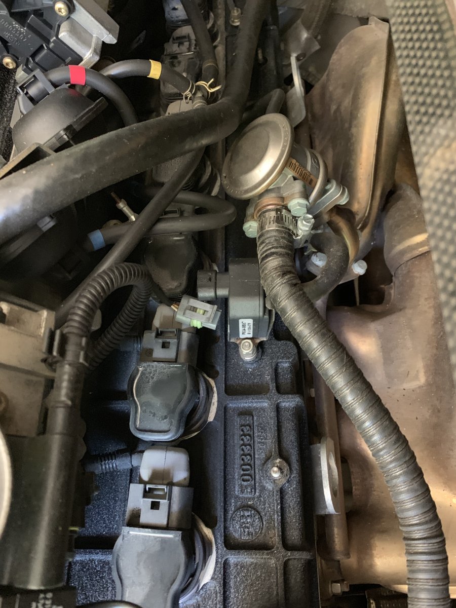

there is carbon fiber cover over the COP, just 2 nuts. Have to wiggle to remove as many hoses over top. One wire with socket runs over this near 4-5 plug and 9-10 plug.

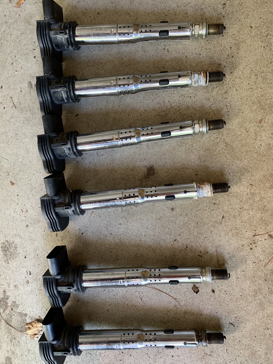

The COP are pretty easy to pull up. Used small screwdriver on tab to remove the connectors from COP.
sparkplugs just need an extension to reach.
simple but lots of hoses and wires in the way. Just take your time and don’t break anything.
last pic is 6-12 plugs and COP. COP very clean, some corrosion on some of the plugs.
