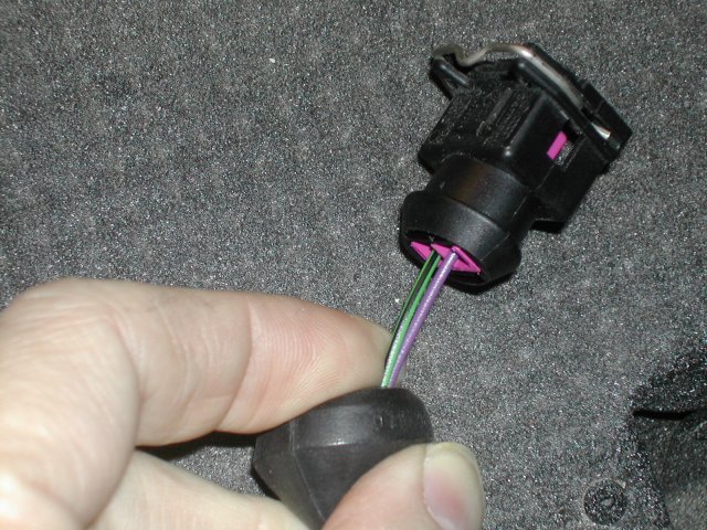

There's a chance the wire from the ECU is open circuit.  The most likely place is at the connector on the solenoid valve.  Pull the flexible boot back from the connector and verify that both wires are firmly connected to their pins (see first pic).  The green/black wire is the signal from the ECU, the purple wire is ground (I think).

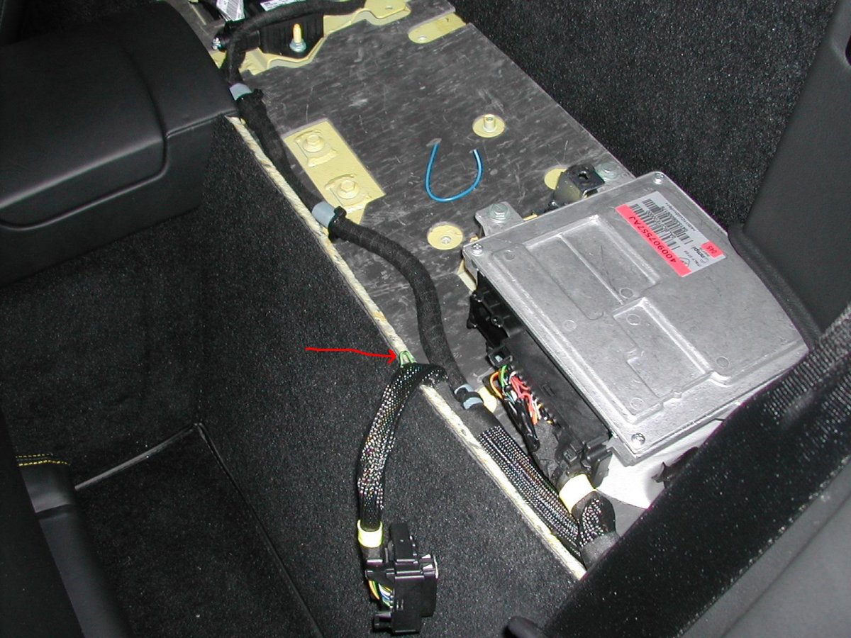

If there's no problem with the connector, the next step would be to see if there's signal at the output of the ECU.  The Gallardo has two ECU's; you want the one behind the left seat (the driver's seat for those of us in the US).  You can remove the connector backshell and probe the cable to locate the same green and black wire you found on the connector.  You can probe this with a voltmeter by poking the probe through the wire insulation (and then start the car).  If you don't see 12V here, you've got an ECU problem.  If you see 12V here, but not at the connector, then it's a break in the wire somewhere between the two.

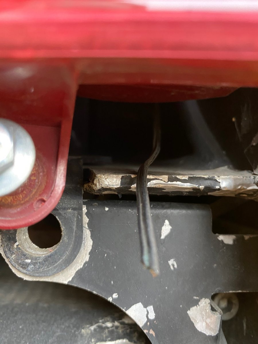

Hi! I think i found something. As mentioned earlier, i think that the 12VDC Signal does not reach the valve and that there was some manipulation going on. So i had a look under the driverside rear backlight and found a "random" disconnected cable. I think this was used before to get 12VDC from the lights (was not able to remove the whole light yet because i did not want do take off the wheel etc.) and i think that there maybe was a remote controlling unit for the valve installed and then removed later on before the purchase (?). So my thesis is that the cable to the solenoid was disconnected somewhere near that point just before it enters the bigger cable hose collecting different cables on the way to the ECU (sorry for my english... understandable? ).
I isolated the cable now correctly to avoid any damage.
Will keep you updated if i find the solution by myself or have it fixed by a professional dealership.
