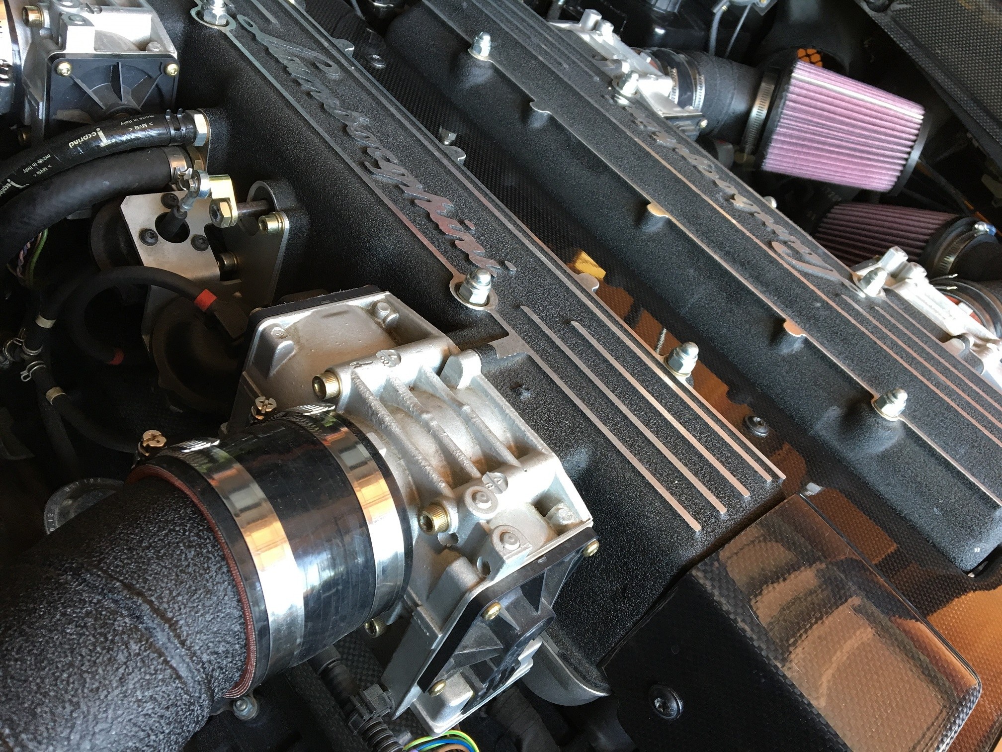

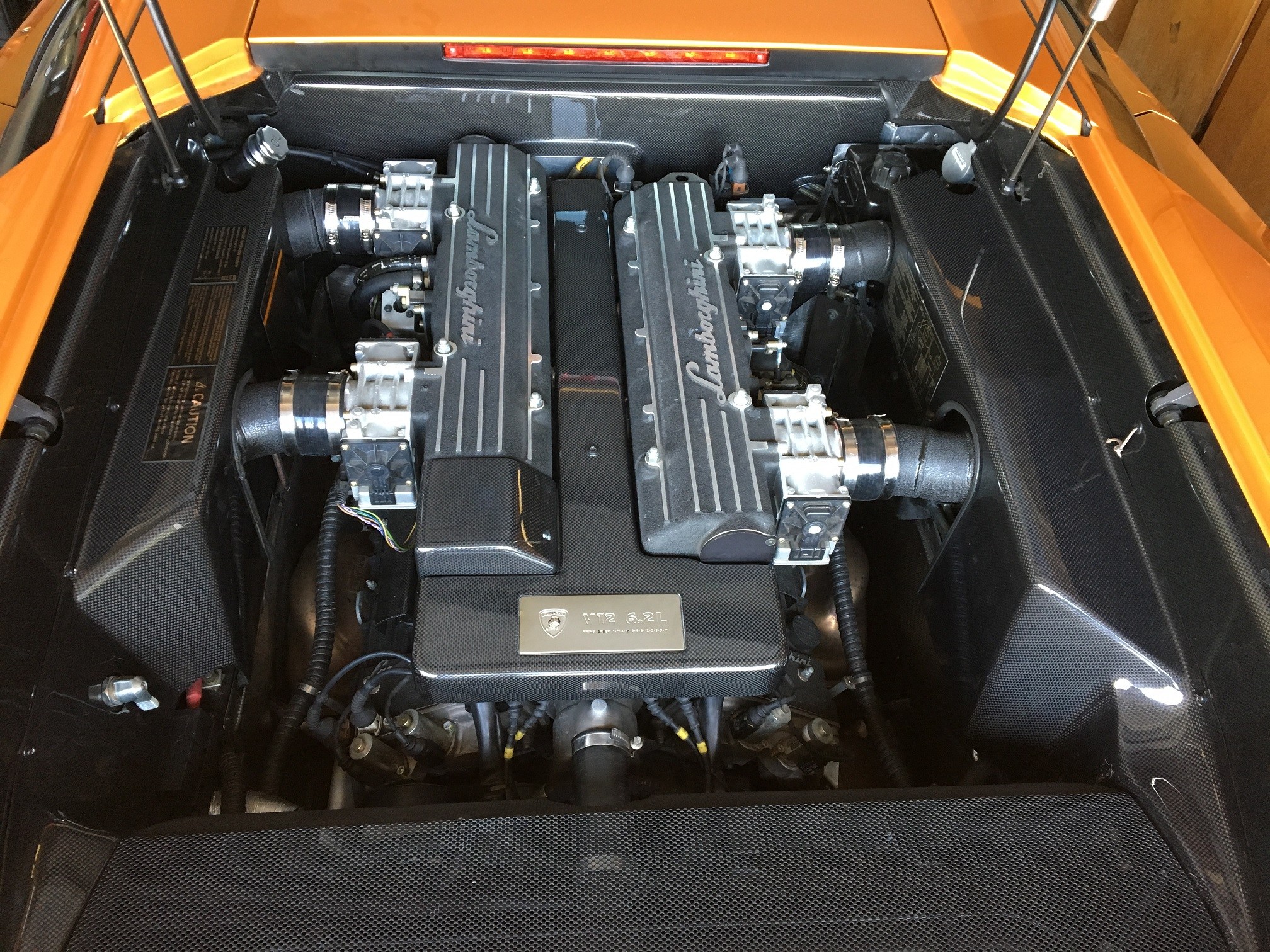

I just installed a set of wrinkle-finished, pie-cut pipes that can be used with stock airboxes or with cone filters. I installed them with cone filters. I love the way the wrinkle finish matches the plenum, looks stock.
My car previously had BMC high-flow filters. As for performance, I have a broken butt-dyno so I can't tell the difference but I am satisfied. Before, you could hear the air initially rush into the airbox that would eventually turn into something that was almost drone like. I always thought it was the exhaust drone but it's not. It was the airbox. Now, there's a much cleaner intake sound with these filters. I like. Thanks Nick!!
