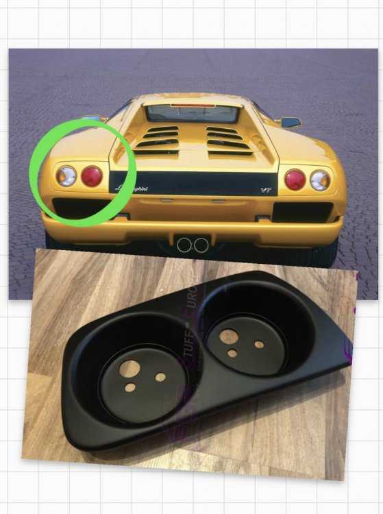

AlwaysPFK Report post Posted June 16, 2019 Anyone have experience replacing 2001 diablo tail light covers? Easy job? Remove entire rear of car? Does 1999 diablo cover fit 2001 6.0? Quote Share this post Link to post Share on other sites More sharing options...
falconsprint Report post Posted June 18, 2019 I've done it but forgotten the details. The basic problem is getting stuff out of the way so your hands can reach behind. I think I had to remove the fans to give my hand room to reach the nuts that hold covers in place. You also need to remove the center grill and it might help to have the muffler box if you yours if yours is stock or in the way. Quote Share this post Link to post Share on other sites More sharing options...
CCIE Report post Posted June 19, 2019 The 60 rear light covers are different then the pre 60 (including 99) cover/bezel The light actually hold the bezel in place so if you remove the light assembly the bezel will come out. Quote Share this post Link to post Share on other sites More sharing options...
Davo456 Report post Posted June 23, 2019 rear grills underneath come off with 2 cross head screws, this may help you gain access. removing the light covers, which allow you to see the 2 bolts that hold the bezels in place. 6.0 rear light covers are smaller than the 99 and previous models, including the GT/GTR too. Quote Share this post Link to post Share on other sites More sharing options...
