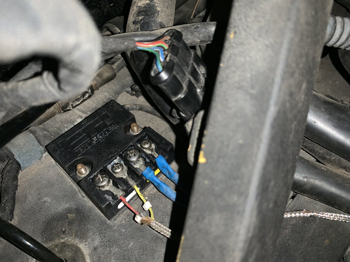

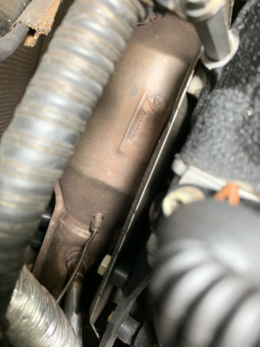

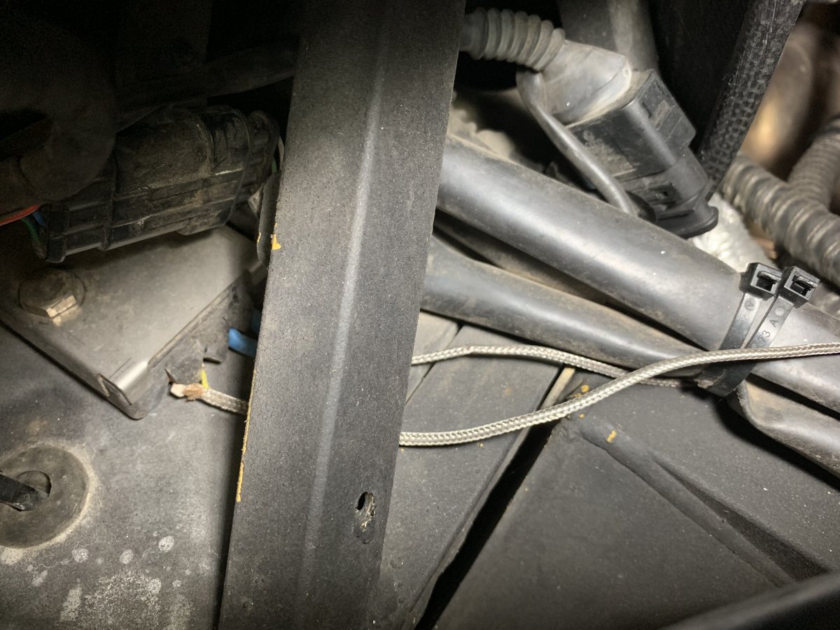

Been checking thermocouple and ECU block. Looks ok. I am going to post pics because don’t know what they are supposed to look like.
first pic thermocouple in cat
second pic thermocouple wire in ECU block
third pic ECU block with cover off
Tried cleaning connections and had my wife drive. She is really aggressive and drives it like she means it. Some hesitation around 4000 rpm. Threw codes p1306, p1405 along with p1426.
