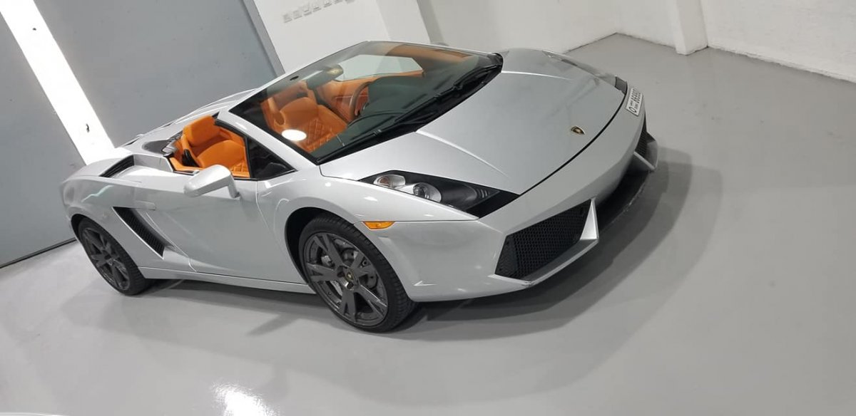

Hello Group, first time posting but need some help. My A/C went out in my 2008 Gallardo Spyder. We switched out the A/C Compressor and Drier with brand new ones, recharged the system and it still will not blow out any cold air. The air went out the same time my back-up camera stopped working.  Could this be a coincidence or are they possibly related. The car only has 9k miles on it and I am not sure why I am experiencing so many issues all of a sudden. Does anyone have any ideas at all??
