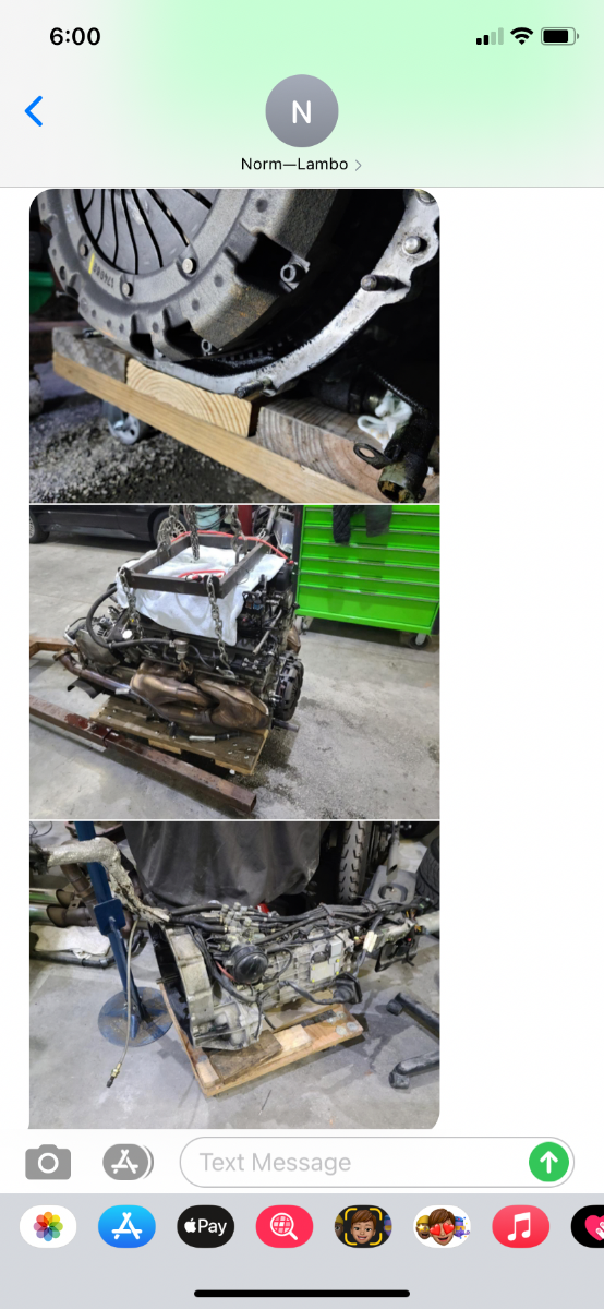

Engine out service on my 05 Murcielago Roadster (Egear). Need help
I’m looking replace the coolant line that runs down the middle toward top of motor. The original one from lambo isn’t a reinforced wall line. They say you replace when motor is out. Can someone please be kind to help where I can source one?
It also needs a new Throwout Bearing. Is the LP640 Throwout Bearing for Egear interchangeable with my 05 Murcie Egear? Where is the best place to buy? Dealer said it will take 3 weeks plus and it runs $4k
Thanks so much in advance. Grateful for your help
Get some motor mounts & rear driveshaft bearings from Glen while the motor is out.
Clean the oil sump screen & change plugs/ignition coils while the motor is out (mu
If you're debating high flow cats or deleting the primary cats, now is the time.
