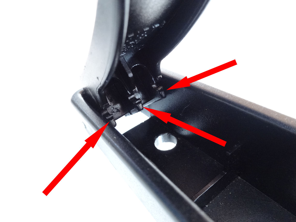

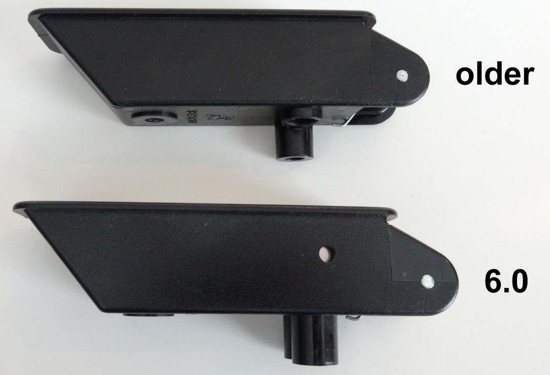

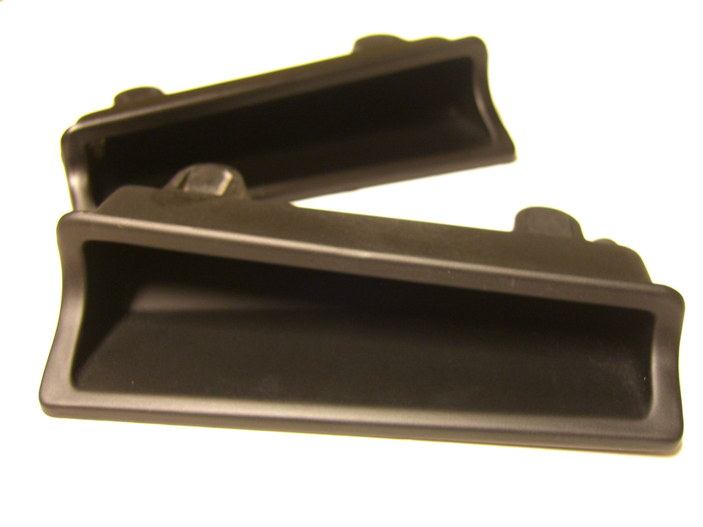

This is how I went about accessing the doors of the Diablo VT. In this job, I replaced the door pull cups (9421201 & 9421200) and the door/key push buttons (72005036). The door struts were replaced with Murcielago struts (410837987). I also replaced the interior door levers with Diablo 6.0 levers (400837185) since the first incarnation of the Diablo's door levers are plastic and get brittle with age. My original passenger side door lever cracked apart around its axle pin, prompting this job, but I learned that this is a common problem with these plastic levers. I have also heard of cracks in these parts through the central mounting screw. The 6.0 pulls have aluminum levers. Cracked key push buttons are also common.
The cracked pull lever
The replacement
The replacement Murcielago struts allow the doors to raise without effort, but the penalty is that the doors are more difficult to close and some owners have commented on the stress that might put on the ball joints and mounts. I'm willing to live with this because it's more awkward if not painful to be pulling the door up, and it just feels cheap to be standing outside this wonderful car pushing a door up. During this job I would later discover that one of the old ball joint mounts was stress-fractured anyway, so I replaced that too.

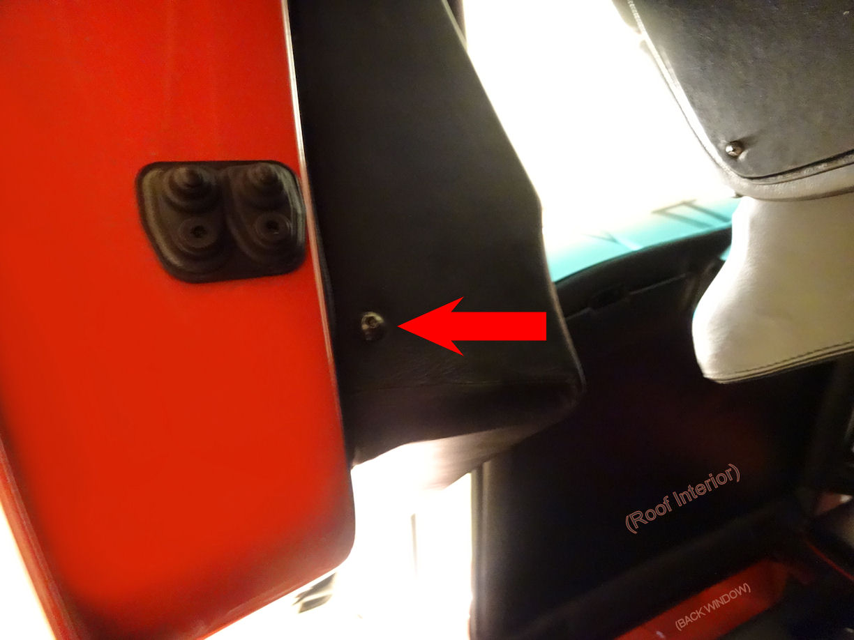

I can fit into the open door space fine, but I can see where some larger people might consider removing the steering wheel if working on the driver's side if freedom of movement is going to be a problem. This is a simple matter of removing the soft cover by "folding" it off its [3] edges and then removing the hex screws that secure the wheel.

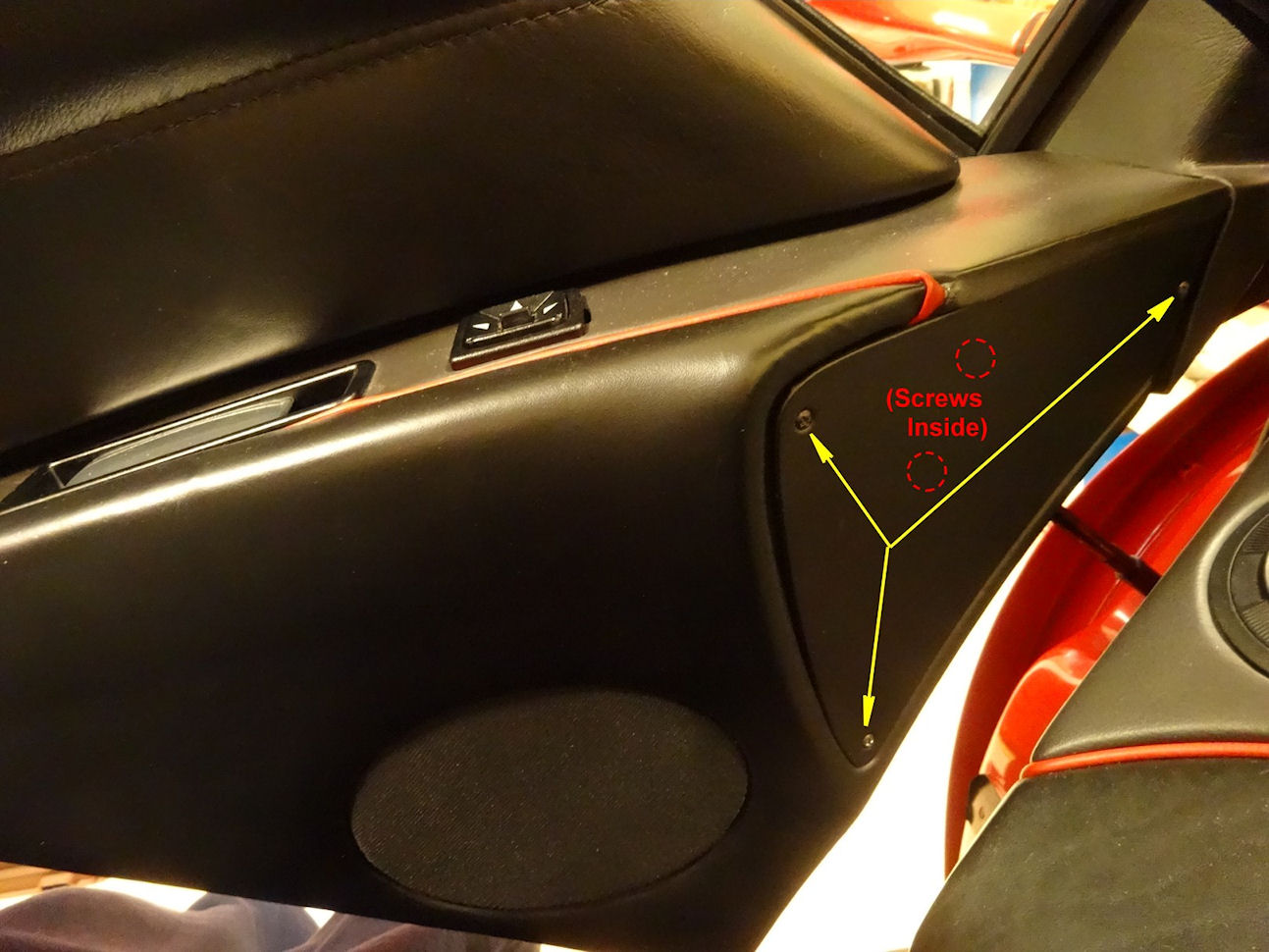

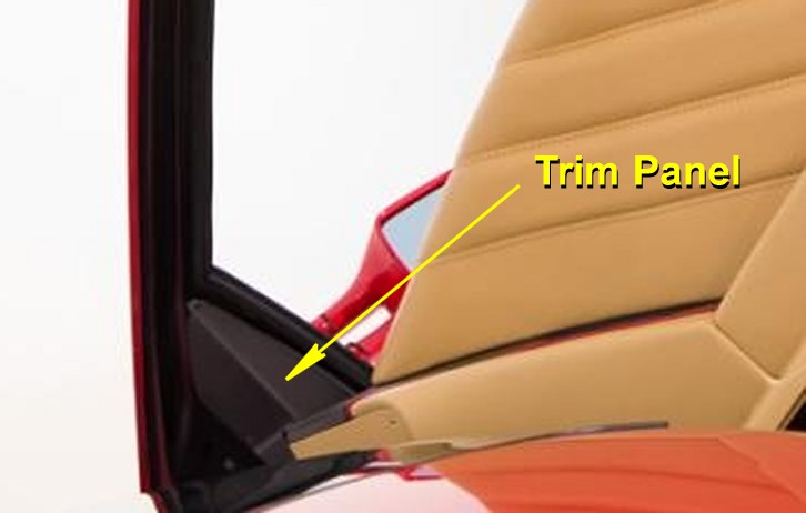

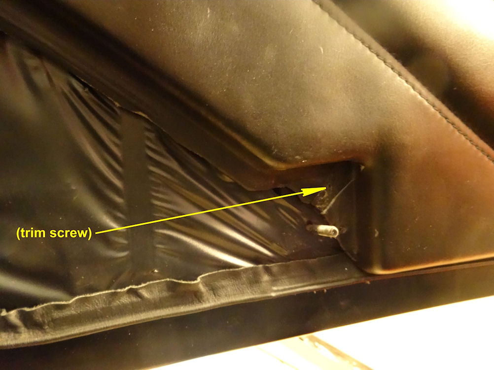

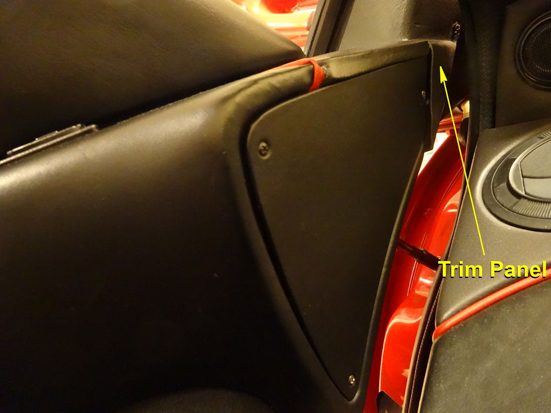

To get into the door, remove the forward trim plate. This the contoured plate found in the extreme forward corner of the door. You might need to move the door up or down to access all of the three little trim screws from either inside or outside the car, and there is one hiding on the underside of the plate as well. Then get into the forward cover plate. This is a flat metal plate, semi-triangular in shape, covered in leather and screwed into the door in three locations with trim screws.

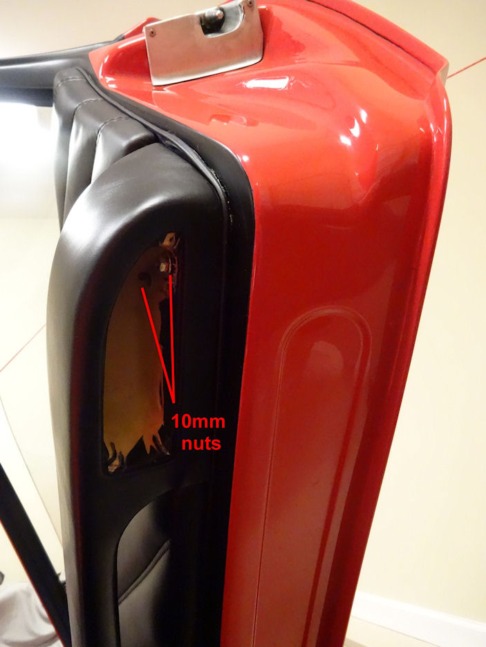

Remove two 10mm nuts from inside the speaker box section/cover that you just opened. Dashed lines in my images represent hidden objects or paths.
Remove forward screw from leading edge of speaker box section/cover. This is likely a 4mm M6 hex button-head screw.

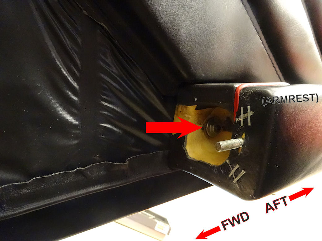

Remove the 10mm nut from inside speaker box section. This secures the speaker box to the armrest/handle. This serves to loosen the lowest part of the armrest first rather than loosening the aft end first. Removing the aft end first could allow the armrest to become damaged either by falling off, or by allowing the mounting studs to eat into the soft material of the mounting holes (or themselves becoming bent).

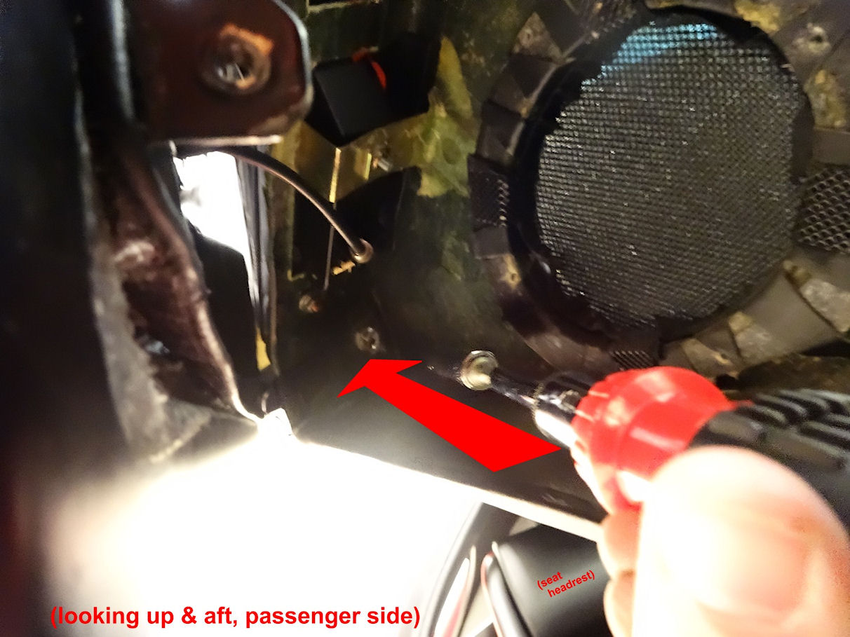

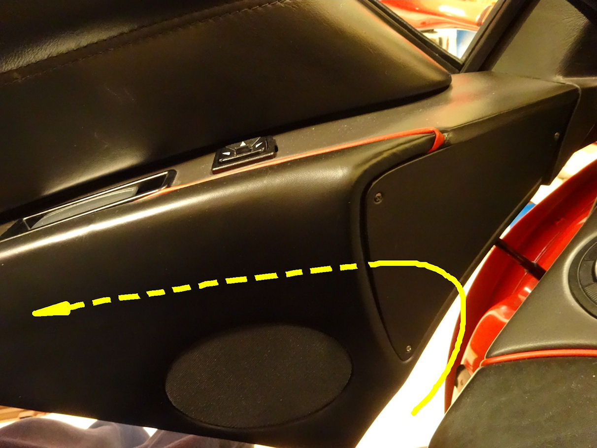

This can be done in one of two ways depending on the size of your arm. Either gingerly lift the speaker box just barely enough to get your hand and an extended socket into the space or maneuver your hand and socket through the triangular door access panel hatch that you just uncovered. The speaker box is still connected to the door via speaker wires, door latch pull (and mirror adjustment switch on the driver's side). You can either rest the speaker box, carefully wrapping it in a towel to protect the leather, or you can disconnect everything. Watch out for protruding hardware of the door panel that could damage
the leather.
Going in through the front of the speaker box, looking up and aft:
OR, go in through the panel

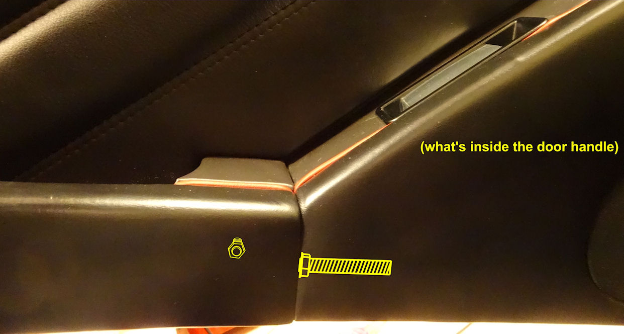

Remove the nut inside the armrest's newly exposed forward cavity first. Remove rear armrest cover plate (aft underside of armrest). This is a small metal plate, covered in leather, on the underside of the aft-most end of the armrest. Three trim screws secure it. Then remove the two 10mm nuts inside the cavity and remove the armrest/handle.

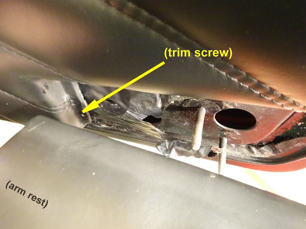

Remove the two trim screws holding main leather-covered panel, both at the lowest level of the panel, normally hidden by the armrest. The panel is now free to lift up ~1 inch to clear the tabs along the window sill so that the panel can come off cleanly.

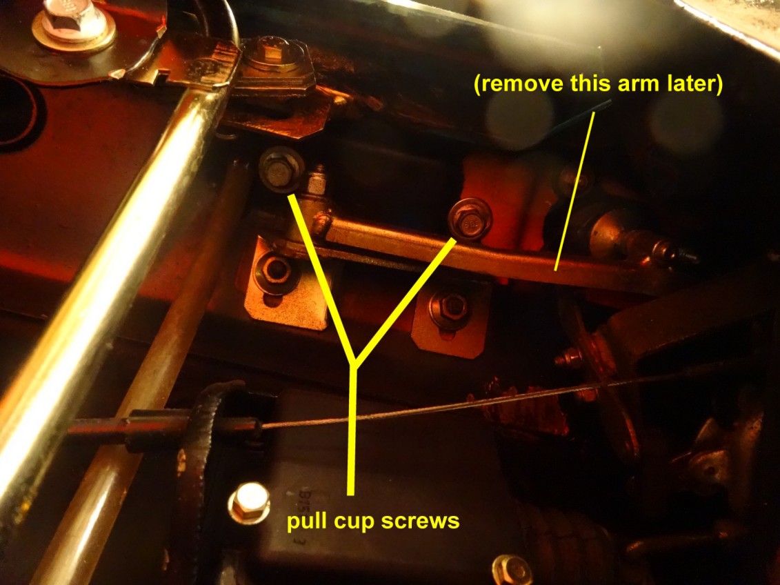

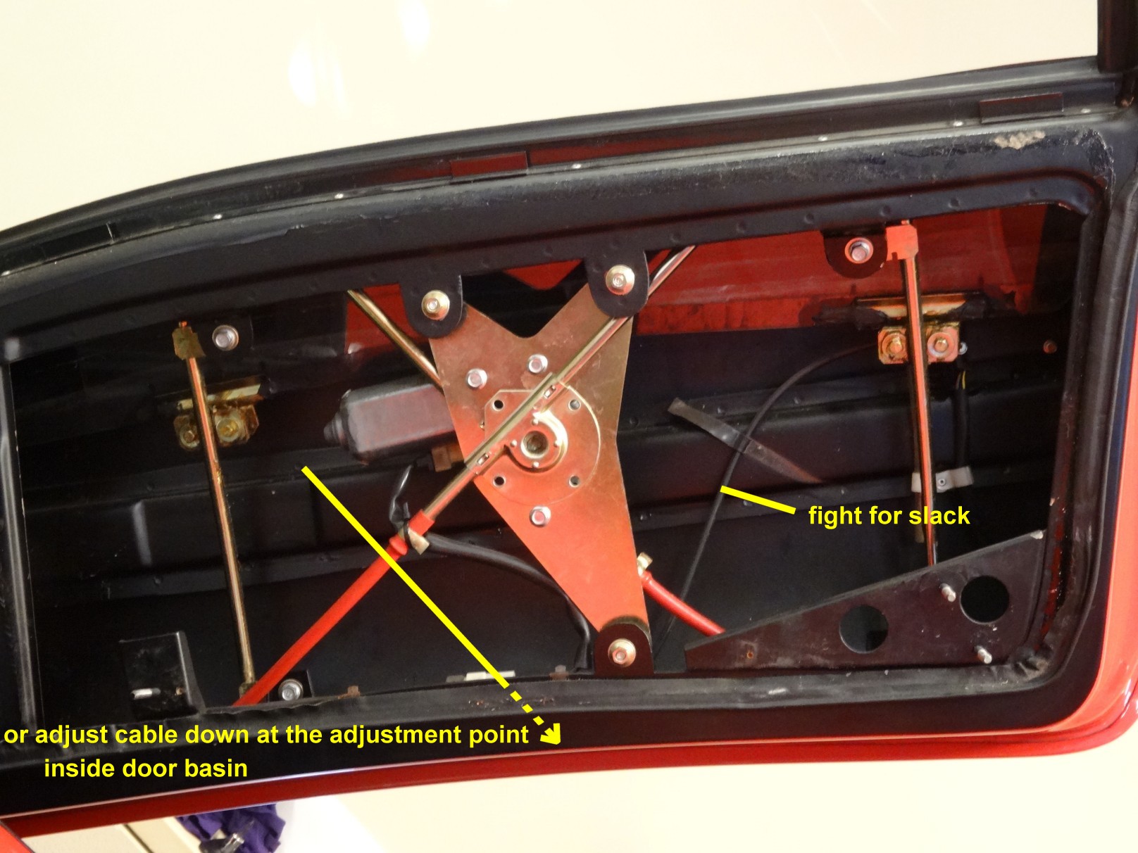

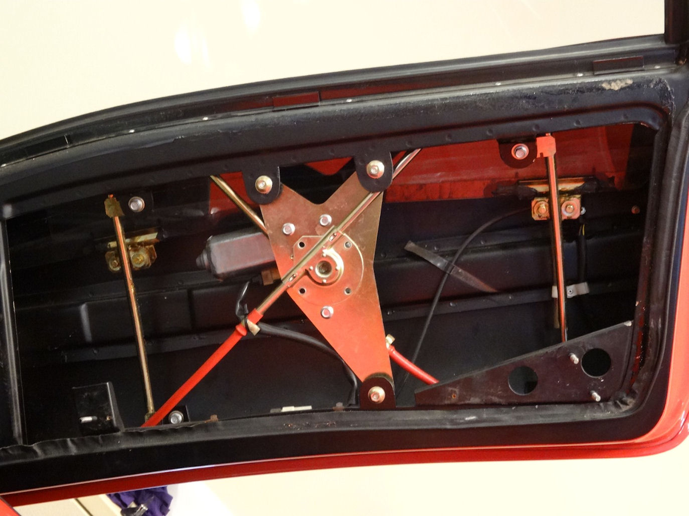

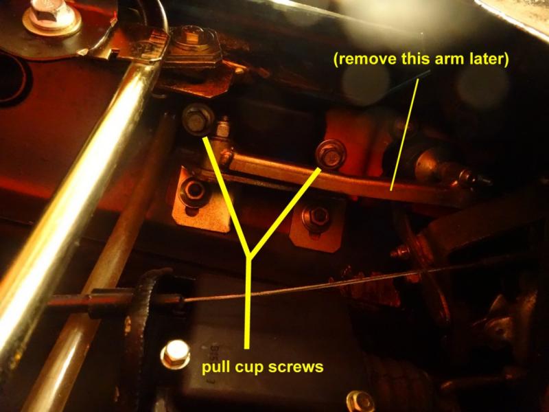

The entire interior of the door is now accessible. My preferred job priorities in order of best accessibility are 1) door pull cup, 2) push button, 3) door lever, and 4) door strut.
To access the door pull cup, use a 10mm socket and extension to remove the two screws holding it from the inside of the door. If the pull cup doesn't come out freely, you'll need to be very careful and patient, poking, prodding, wiggling, and coaxing the cup out of its slot. There is a light foam gasket around the pull cup that can likely be reused if you are careful. The weakest parts of the existing cup are the corners if you're trying to keep it intact. Repainting existing cups may be an option. Reinstall the 10mm nuts, done.

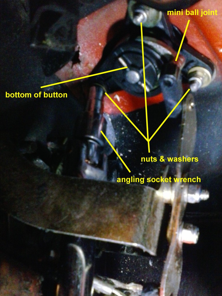

To access the key push button, open a can of patience and settle in for some pain and frustration. The above image mentions removing the arm that is near the pull cup, but this is only for accessing the push button more easily. Each door is slightly different from the other since the same parts are oriented differently to fit. For the passenger side, remove the push button lever/arm. This is the arm that is about 8-9 inches long and secured with a 5/16 nut at its pivot point. That gives you better access to the underside of the push button. There is also a small plastic arm that pops onto a ball joint as part of the locking mechanism. That comes off with whatever small prying tool you can find, but be gentle. There are three nuts in a triad that screw onto posts for the push button -- two forward and one aft. There are also washers to watch out for. The forward nuts are somewhat easy, but the aft nut is a bizatch. I resorted to using an angle socket handle for the 9/32 socket. At that, I could only get a fraction of a turn at a time if I was lucky, so it took a long time to get that done. Once those nuts are off, the push button is free to come out.

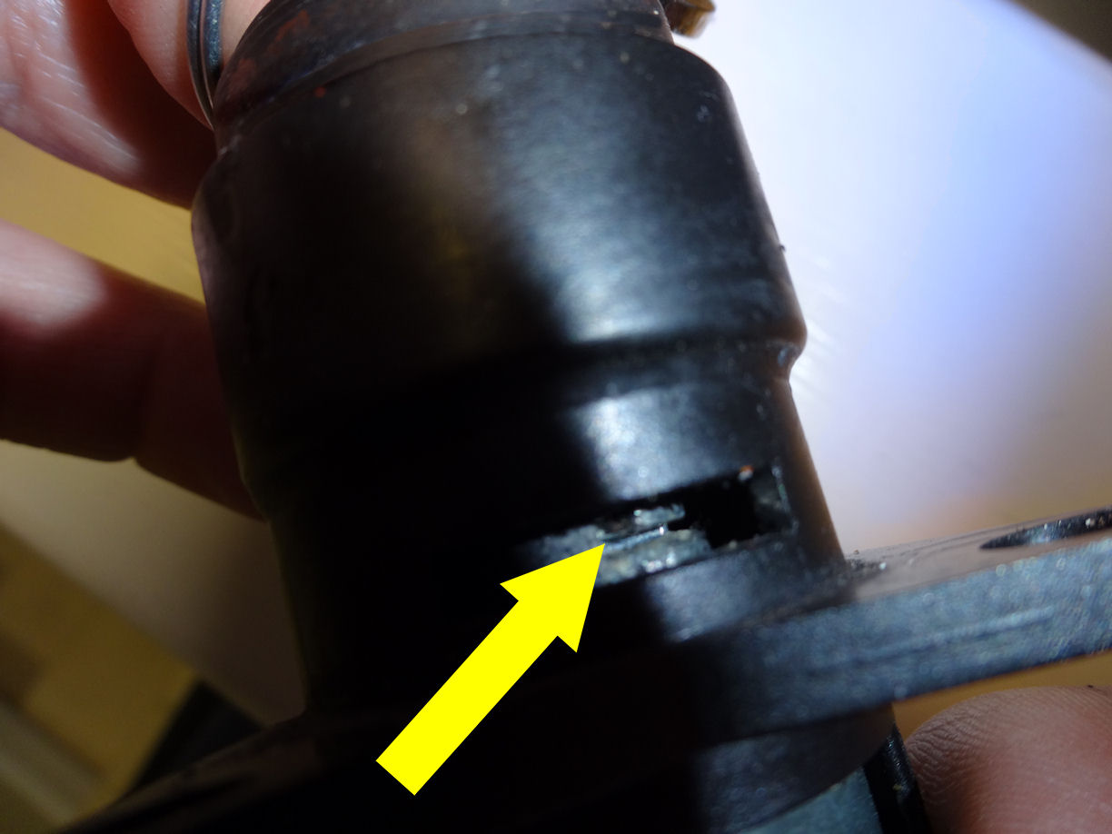

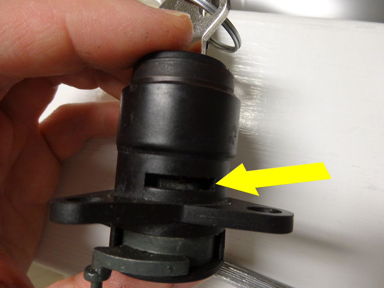

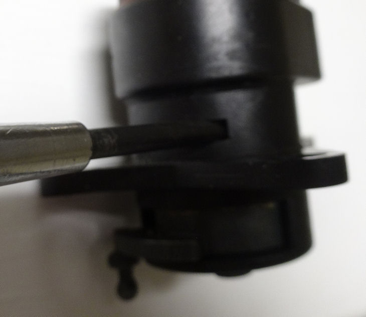

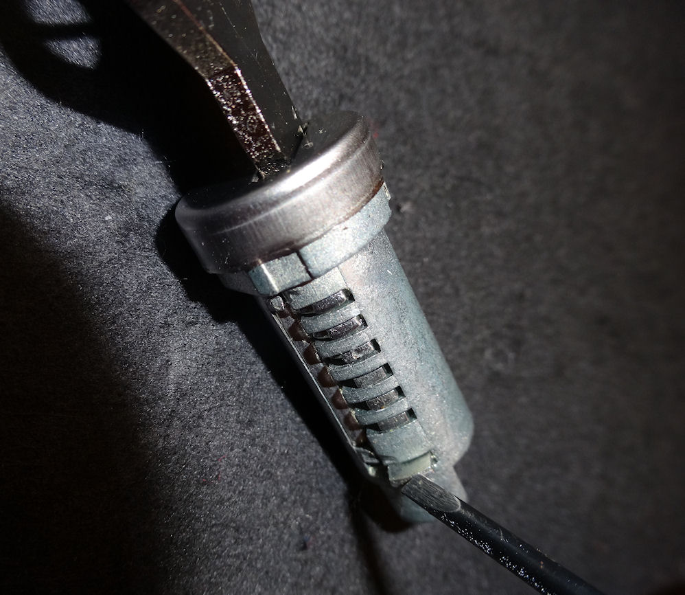

In order to extract the key locking cylinder, you will need the key and some type of small poker such as a mini flat screwdriver or a knife. Good light helps to see what you're poking at, but your goal is a small metal tab that pushes in and releases the cylinder from the button from the access port in the side of the assembly. Insert the key and turn/play with it while with pushing inward in this area, and viola, the cylinder slides out with ease. Clean that cylinder up. A touch of graphite powder can help re-lube its concealed parts, and reassemble.
After the new button is inserted from above into the door, half the battle is getting the washers and nuts threaded. The other half is actually getting them torqued down since they are nylon and won't twist by hand. It might be easier to get the forward two nuts on there pretty good and then attack the aft nut. It might take several tries to get it threaded since you're likely just doing it by feel via whatever dancing cockroach contortionist act you've just developed. Reassemble the arm, probably with some new grease in all the important places and pop the plastic arm back onto the ball. Test it out thoroughly to avoid ripping the door apart again.

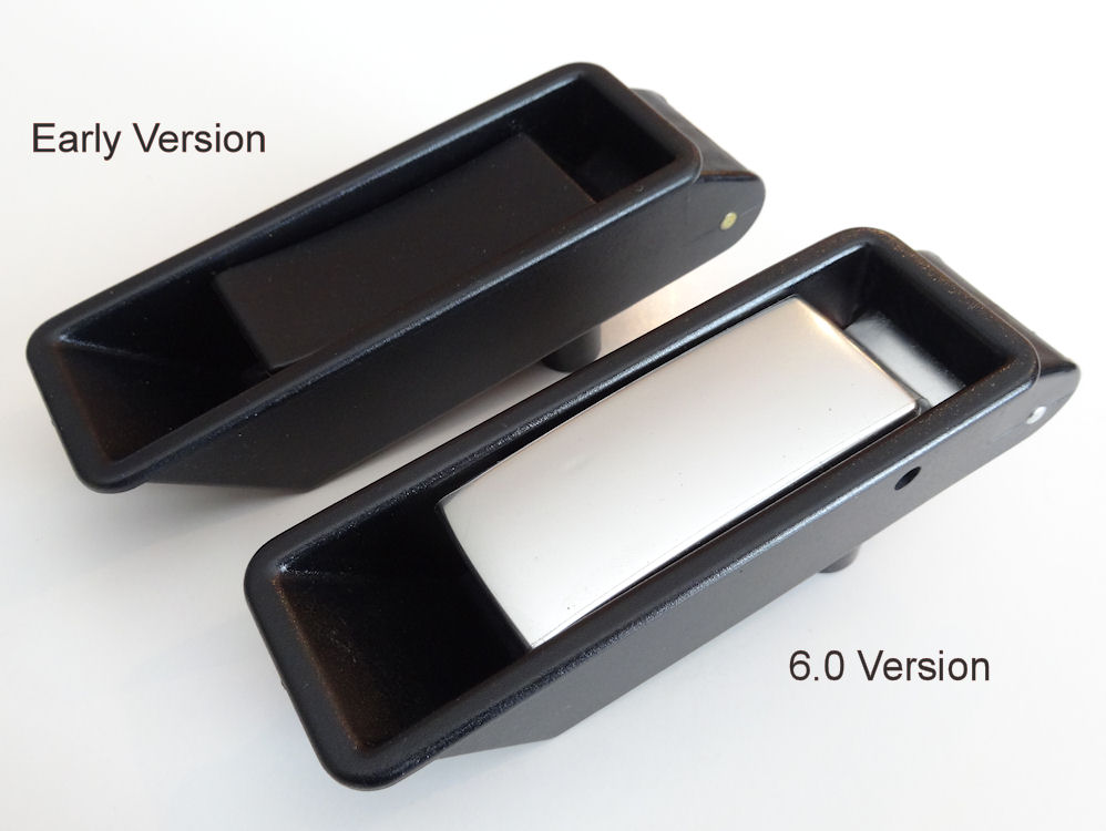

To replace the interior door lever, access the single screw under the lever that mounts the lever to the speaker box section. Plastic style handles demand that you pop the axle out, maybe with some needle-nose pliers. The risk is high of breaking something in that handle, so be careful if you want to keep it. A 6.0 lever is designed with holes that go all the way through the part so as to allow the axle to slide in and out. The lever itself will only allow the axle to enter from the side anyway. Once the old lever is out, bring the cable through the speaker box and fight for all the slack you can get. One tactic is to remove the cable from it's upper mount. You need the slack in order to have the axle attachment end slide up into position freely so that you can jockey the axle and cable to line up with each other. The handle itself will be at a mid-way open position to line up with the side holes to insert the axle. The rest is an art, not a science, so good luck getting it lined up....patience. Once that is secure and you remount the lever to speaker box, remount the cable if you had it detached. If it's too tight to pull back into position, you might consider loosening the tightening mechanism that is secured down in the basin of the door. It has nuts on both ends for you to play with, but again, test it thoroughly before committing to sealing the door panel closed.

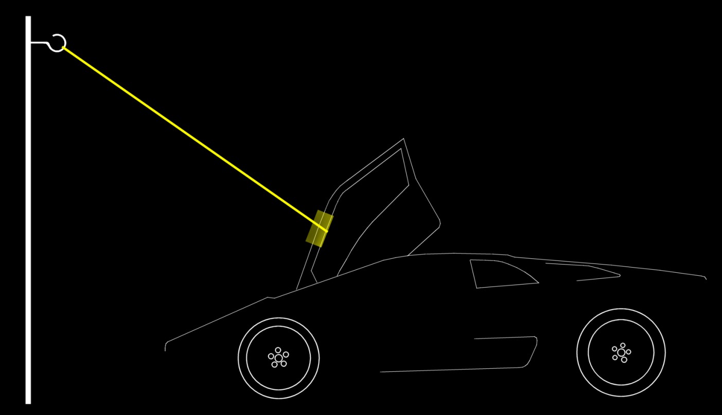

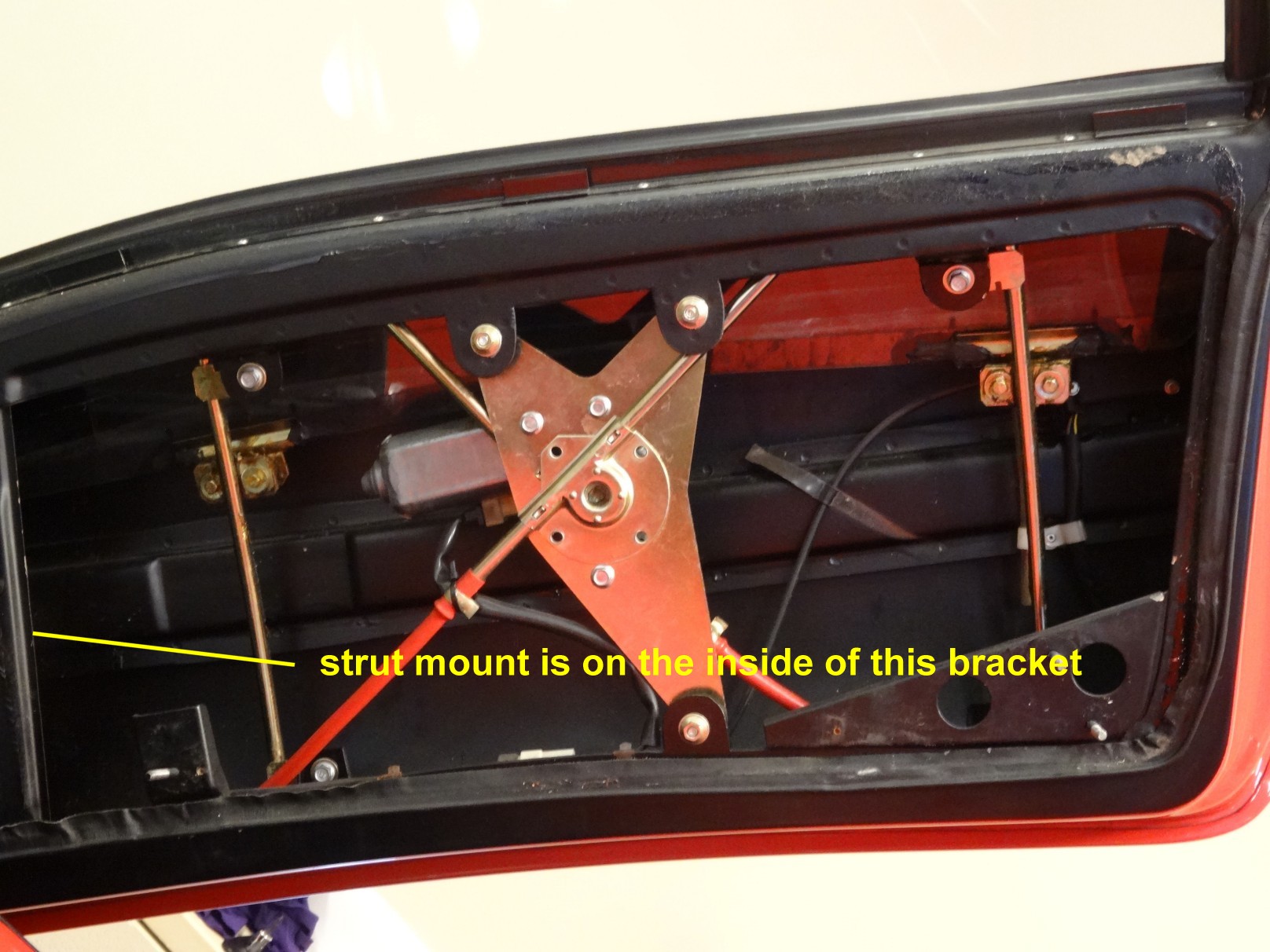

Replacing the door struts involves keeping the doors open, and for this, I installed some eye screws into the studs of my garage near the ceiling. I strung my rope through them and down to the door at an angle, where I wrapped the window frame in protective towels so that the rope wouldn't hurt anything. I have a 12-foot ceiling in my garage, which helped, but I'm sure it can be done in a shorter garage or from the ceiling. There will still be a little slack in the door when strut-less, and you might have to put your back up into the door at different stages to use that slack to briefly take the weight off the strut.
I removed the bottom strut by pulling the lock ring with some pliers and then using a flat wrench (or whatever U-shaped tool you can devise) to pry the strut off the ball. The other end of the strut resides inside the door's main structural bracket. Same methods apply to popping that off. Just be to detach the upper mount last so that the door's weight isn't crushing you or the strut, such that you can't easily get the bottom mount off without fighting the door. So...lower mount first, top mount second. To prepare the new struts, clean and re-grease the balls and mounts, and wrap some 1/2 inch heat shrink tubing from the hardware store around the necks of the mounts before you do the reinstall. Let the tubing dangle until you have everything installed and tightened as you like it, then grab the heat gun or hair dryer and shrink it in place as it was from the factory. Re-install the new strut however works best for you. Again, you might have to put your back into the door's slack on the rope to maneuver the strut into position.
**Safety Note: If for any other reason you are working in the door and need to remove that bracket, remember that it is what is holding up the door, so if you absentmindedly remove the bracket, the door will come crashing down on you if it's not secured. I didn't need to remove this bracket or get crushed by a door, but I'm just saying that because I can envision that happening to someone sooner or later.
