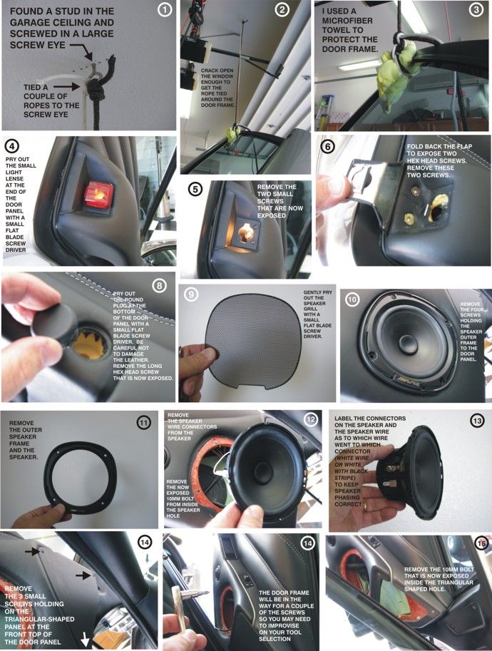

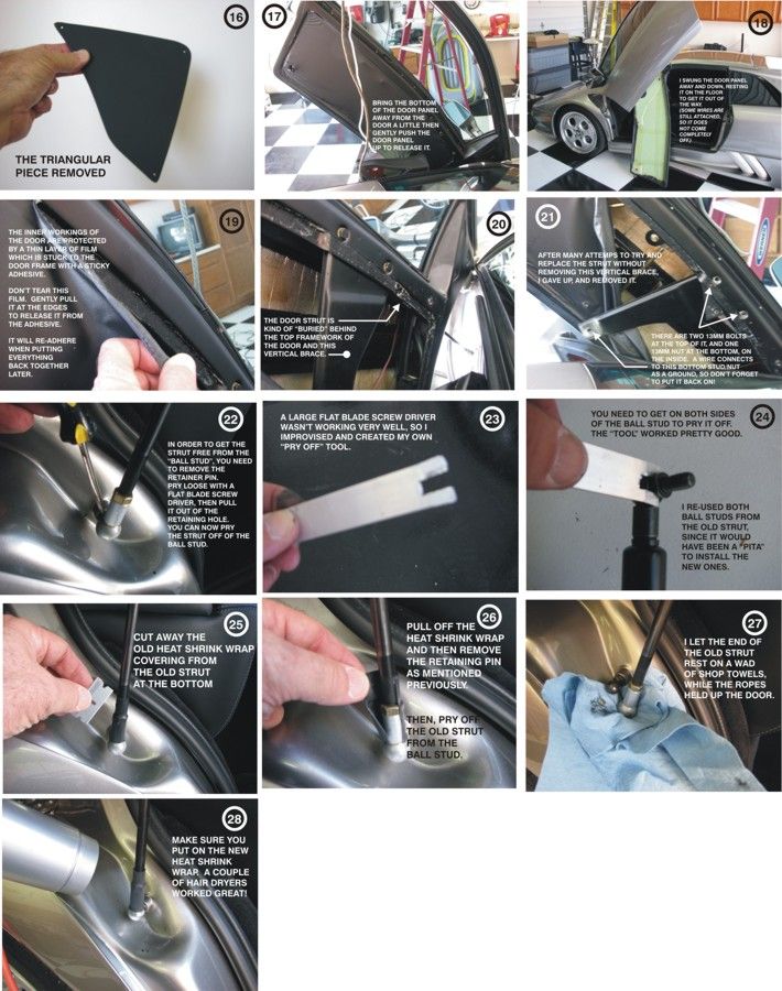

azlambo Report post Posted March 31, 2009 I am going to be installing new door struts in my '99 Diablo this weekend. Any tips from those who have done it before? Quote Share this post Link to post Share on other sites More sharing options...

azlambo Report post Posted March 31, 2009 Ya! Becarefull cause if you dont do it correctly it will take your arm or leg off! I figured as much. I was going to hold the door open with a rope coming down from the top of my garage when removing the existing struts, rather than having someone hold the door. If they hold it up too far, the front top part of the door frame could damage the front fender. Any other tips? Quote Share this post Link to post Share on other sites More sharing options...

azlambo Report post Posted April 1, 2009 Well, I did it myself. Here is page 1 of 2 on the procedure. I will post page 2 right after this post. I am thinking that I should have used the Murcie struts as some have suggested, since the new stock Diablo struts weren't much better than my old struts. For those of you that have tried the Murcie struts on your Diablo, what do you think? Do the doors go up by themselves? Are they hard to close? Quote Share this post Link to post Share on other sites More sharing options...
azlambo Report post Posted April 1, 2009 Page 2 of 2 of the procedure. Quote Share this post Link to post Share on other sites More sharing options...

azlambo Report post Posted April 5, 2009 okay Jeff, tell everyone what you did Well, I took the new Diablo struts off and put the Murcie struts on. This is how the Diablo doors should have worked in the first place! The Diablo struts have 950N of pressure. The Murcie struts have 1150N of pressure. About 20% more. It makes all the difference. Doors go up by themselves now. And closing them is a little harder, but nothing that is a problem. The Murcie struts are the exact same size, use the exact same ball studs, etc. A direct replacement. I will post videos of "before" and "after" later tonight, after I download the video files. Quote Share this post Link to post Share on other sites More sharing options...
