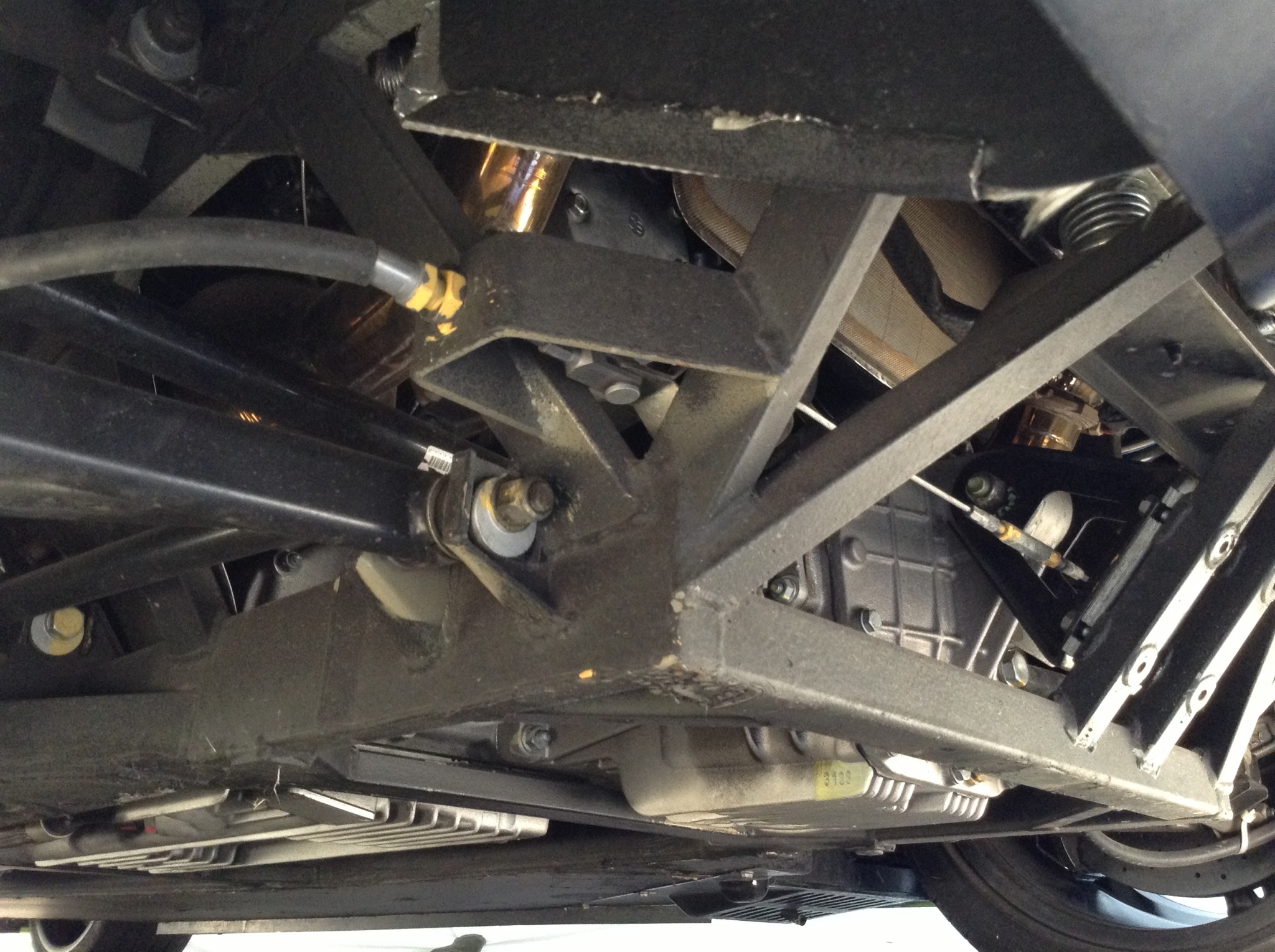

JanDaMan Report post Posted December 13, 2015 Now I think mine really crapped out. Before I put my tender on it, it read 11.80, which is way low. Then after 15 minutes of tender, it read 12.90. It charged way too fast which has always meant bad battery from my other experiences with batteries. I was just going to go to Newport Lambo and let them change it out, but the steepness of their driveway entrance scares me, and bedsides, my car may not start up at all now anyway. So in case I decide to do it myself, can anyone help with these questions below? 1. Before I jack the car up, should I turn the kill switch to off at the rear in the engine bay to change the battery? 2. In the photo shown, is the proper place to jack the car up on that long frame piece near the rear of the car? I was initially thinking to jack farther under the car, but maybe at the end is ok? Once up, it looks like the jack stands can go on each side of the jack area toward the outsides of the frame. 3. Not sure how heavy the stock wheel & tire may be, but if pretty heavy, I may put my second jack under the tire to help support when I get the wheel off, so it doesn't drop down, unless the wife helps lift it, ha ha. 4. I suppose it is self explanatory in removing the wheel well panel once I get the wheel off, and the battery too once I get in there unless there is something else to know. 5. As far as the battery itself, anyone know the brand and the battery number so that I get the battery with the proper size and terminals correct? Would like to get that ready before starting the process rather than later. 6. I presume at some point in the process the alarm will go off, but if it is only as loud as the usual chirp, then I won't have a heart attack and just disarm with the key fob. 7. What should the wheel torque be once I get the wheel back on? 8. I presume that would be it, unless there may be something else to do before starting the car? Quote Share this post Link to post Share on other sites More sharing options...
Mondi Report post Posted December 13, 2015 1) yes, flip the kill switch 2) yes, put it right in the middle of that frame 3) wheel and tire aren't heavy ~50 pounds. 4) it's a no brainer 5) forgot the size sorry 6) alarm won't go off since there won't be any power running to the car 7) 110 lbs Quote Share this post Link to post Share on other sites More sharing options...

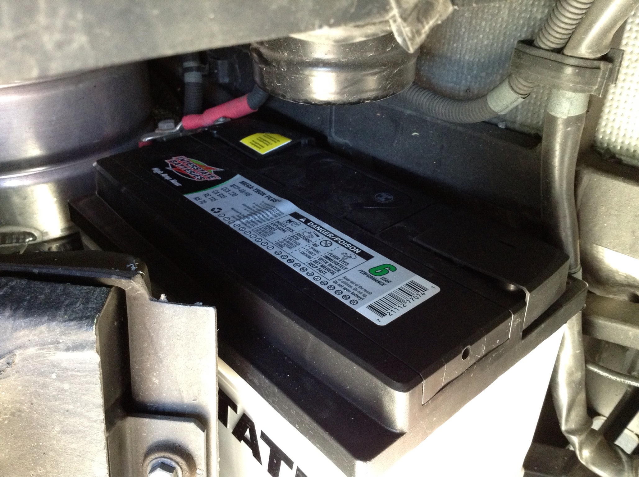

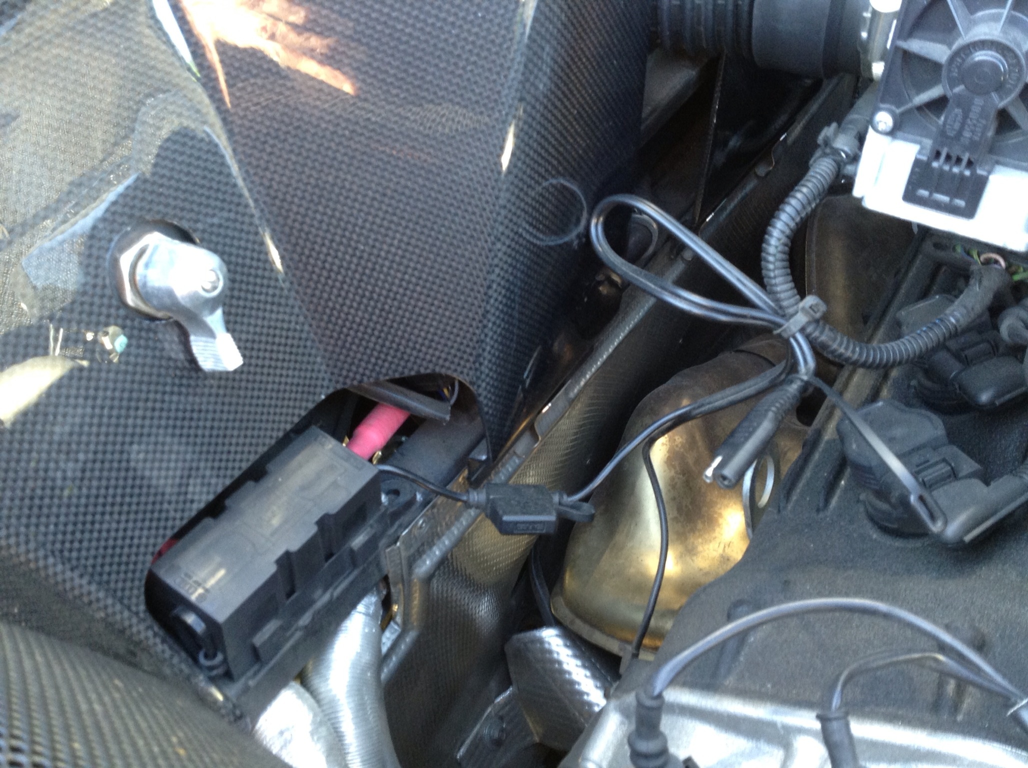

JanDaMan Report post Posted December 19, 2015 Well, I got my barttery duty done. When I got behind the wheel panel, I found I had an interstate dated 11/13, so I am not sure if the battery was bad or not. But figured now that I am in there, I am changing it out anyway as I really don't want to repeat the job. My Dell crapped out too, so I only have limited photos for now, from the iPad. My innards in that battery area did look a bit different than posted above. Mine has an end bracket on the tray that slides under the battery, held by two bolts underside. Anyway: Paid $300 for the battery from the Lambo dealer and could have been much cheaper elsewhere, but what the heck, I was in a hurry to get it done. What a freakin Markup! My replacement was an Interstate MTP48/H6, and fits exact. So, now I know the battery size for mine anyway is group48. Only 730 CCA, but they said that way more than the car specs call for. I like more, but maybe next time. Battery specs and measurements here: http://www.interstatebatteries.com/Product...onths+-+770+CCA My car already had some type of trickle charge box and cord in the engine bay. Not sure what that box is for. Dealer said some come with that set up and some not. So I fished the wire through the side wheel well instead of the engine bay like the posted photos above with an extension needed to reach. I also noticed that wire connection to the battery was a bit rusty, which maybe was my issue too, o I cleaned everything up real good, and got some terminal gel from autozone. Basically took me about 6 hours, including getting the battery. But I was being careful, and now that I did it, it should be faster next time. Had to get a small hex bit too, as my plastic wheel well panels were held by hex screws. I also took time to be sure I didn't scrape the inside of the wheel, as I swear there is only about 1/4 inch between the inside wheel and brake caliper, at least with CCB anyway. I slipped a small towel on top of the brake caliper and put a few planks of wood under the tire so it would not fall once unbolted, and then guided it out. Quite acquard with that huge wheel and tire otherwise, so that sure helped. Attached are a few photos. Plus just a tip when buying a car, it's a good idea to check some basics when you get it home. When I went to unbolt that wheel, the toque was so light, I only took about 20 lb on the wrench to undo the wheel bolts. On course that made me check all other wheels and they were 110 lbs. Quote Share this post Link to post Share on other sites More sharing options...

JanDaMan Report post Posted December 19, 2015 Nice work! Good you didn't short the wrench on any metal Also its a pain getting it over the rear caliber hey? You are right there! The battery needed to be lifted "up" over the CCB and caliper to get it out. I tried to slide it under at first but it didn't seem to fit that way, then needed to go backward and put it back on the tray before trying again. Not easy for 60 year old fart, now doing some heavy Motrin. Quote Share this post Link to post Share on other sites More sharing options...
