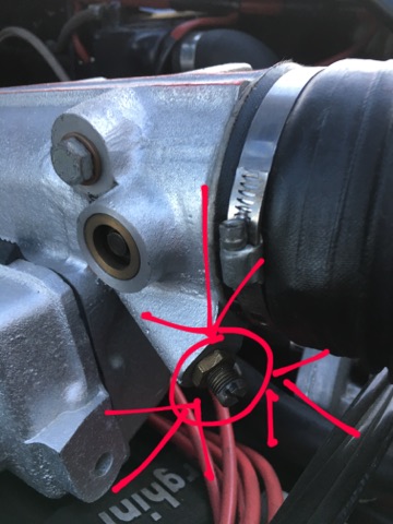

Roman Report post Posted June 28, 2017 It's these things, right? Quote Share this post Link to post Share on other sites More sharing options...
Allan-Herbie Report post Posted June 28, 2017 It's these things, right? Its the screws on the throttle body Quote Share this post Link to post Share on other sites More sharing options...
Roman Report post Posted June 28, 2017 What do the things in my photo do? Quote Share this post Link to post Share on other sites More sharing options...
Redlambo Report post Posted June 28, 2017 What do the things in my photo do? Erik your highlight photo is deceiving as someone may thing you are referencing three different items. Especially when you ask "What do the things in my photo do?" The pivot point of the throttle body butterfly shaft The hose clamp and the air intake duck tube. When in essence I believe you have drawn an arrow pointing to the actual idle adjustment screw. As others have stated, break loose the jam nut and turn the idle screw clockwise on both throttle bodies an equal amount. I would start with an 1/8 of a turn on both and see what that does. Best of luck, Vic Quote Share this post Link to post Share on other sites More sharing options...
THIRDGEN Report post Posted June 28, 2017 Erik your highlight photo is deceiving as someone may thing you are referencing three different items. Especially when you ask "What do the things in my photo do?" The pivot point of the throttle body butterfly shaft The hose clamp and the air intake duck tube. When in essence I believe you have drawn an arrow pointing to the actual idle adjustment screw. As others have stated, break loose the jam nut and turn the idle screw clockwise on both throttle bodies an equal amount. I would start with an 1/8 of a turn on both and see what that does. Best of luck, Vic Quote Share this post Link to post Share on other sites More sharing options...

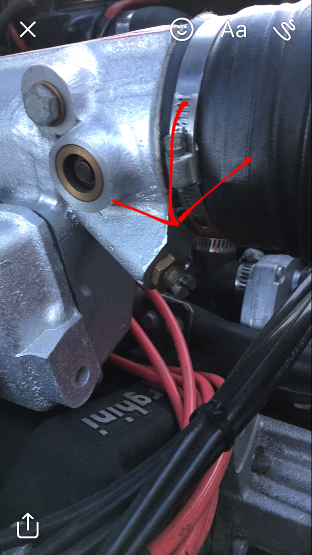

Roman Report post Posted June 28, 2017 Erik your highlight photo is deceiving as someone may thing you are referencing three different items. Especially when you ask "What do the things in my photo do?" The pivot point of the throttle body butterfly shaft The hose clamp and the air intake duck tube. When in essence I believe you have drawn an arrow pointing to the actual idle adjustment screw. As others have stated, break loose the jam nut and turn the idle screw clockwise on both throttle bodies an equal amount. I would start with an 1/8 of a turn on both and see what that does. Best of luck, Vic Ok better picture... we on the same page? This adjusts the idle right? Quote Share this post Link to post Share on other sites More sharing options...

Redlambo Report post Posted June 29, 2017 Ok better picture... we on the same page? This adjusts the idle right? Yes. Quote Share this post Link to post Share on other sites More sharing options...
