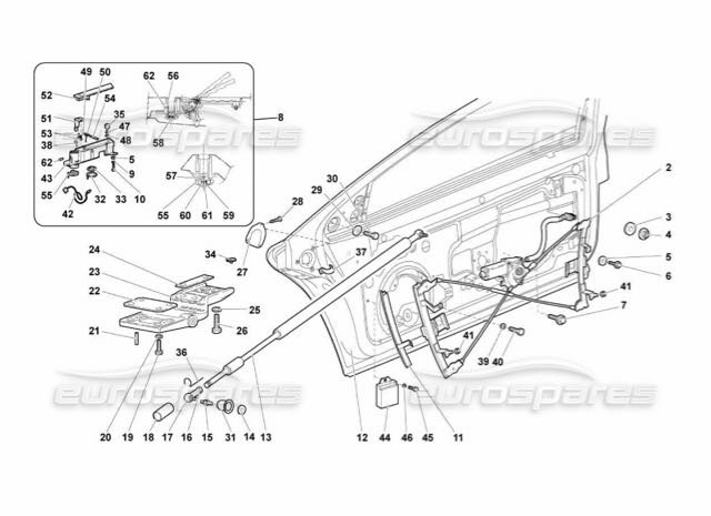

darth sidious Report post Posted September 24, 2018 Whiteout et alia, I'm now confused. I know you know a lot about these cars. Your post suggests that the window has slipped out of its tracks. Would that be consistent with the clicking sound I hear when I press the window switch? If so would that mean I could open up the door and re-engage the window glass? I sure hope so. Those bloody mechanisms are £800 ( $1100) over here. I am not sure which grommet you are referring to. Do you know the part number? I have attached the eurospares diagram where I usually get parts. I am resigned to having to remove the door card and take it from there. I thought I might replace the strut whist the card was off. I have heard that this can be done more easily without having to replace the ball joint. I suppose I should grease the ball. What type of grease? It seems that every Murcielago I come across the struts have lost efficiency. Replacing with OEM that will eventually deteriorate in the same way doesn't seem sensible. Is there a better non OEM strut that can be recommended? I will check the wing mirror fixings for tightness. Are there any other jobs I should do with the door card off? All advice is appreciated. Quote Share this post Link to post Share on other sites
