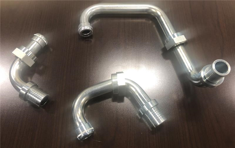

camaro97 Report post Posted January 14, 2021 It has taken A LONG time and a lot of effort to get to this point. Here are brand new fittings: carbon steel with zinc finish Assemblies will be sent to Driven Exotics (next week) to do a test fitment on my car. Once the prototype is good to go, I will have 10 of each hose made as part of my agreement with the OEM manufacturer. I am still waiting on a final cost from the manufacturer, but they will be less than OEM cost and be made with teflon/SS instead of rubber/SS. Better than OEM, for lower cost. If anyone is interested in a set, please let me know. As an update from the Lambo Dealer, I still have my special order in for 001535966 for 5 months now and was told last week that Lamborghini is still "chasing the supplier". I was told 001535965 has been discontinued completely. Once I have the new hoses on my car, I will likely cancel the special order. Quote Share this post Link to post Share on other sites More sharing options...

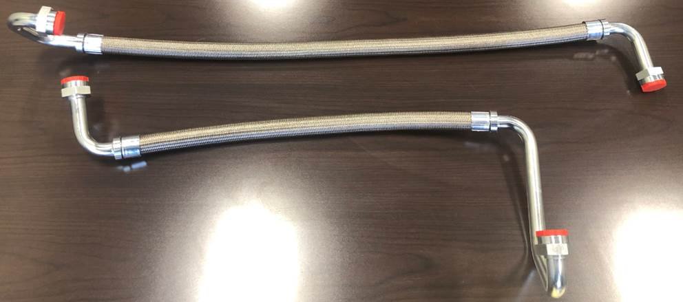

camaro97 Report post Posted January 18, 2021 Hose assemblies before crimping to do test fitment Quote Share this post Link to post Share on other sites More sharing options...

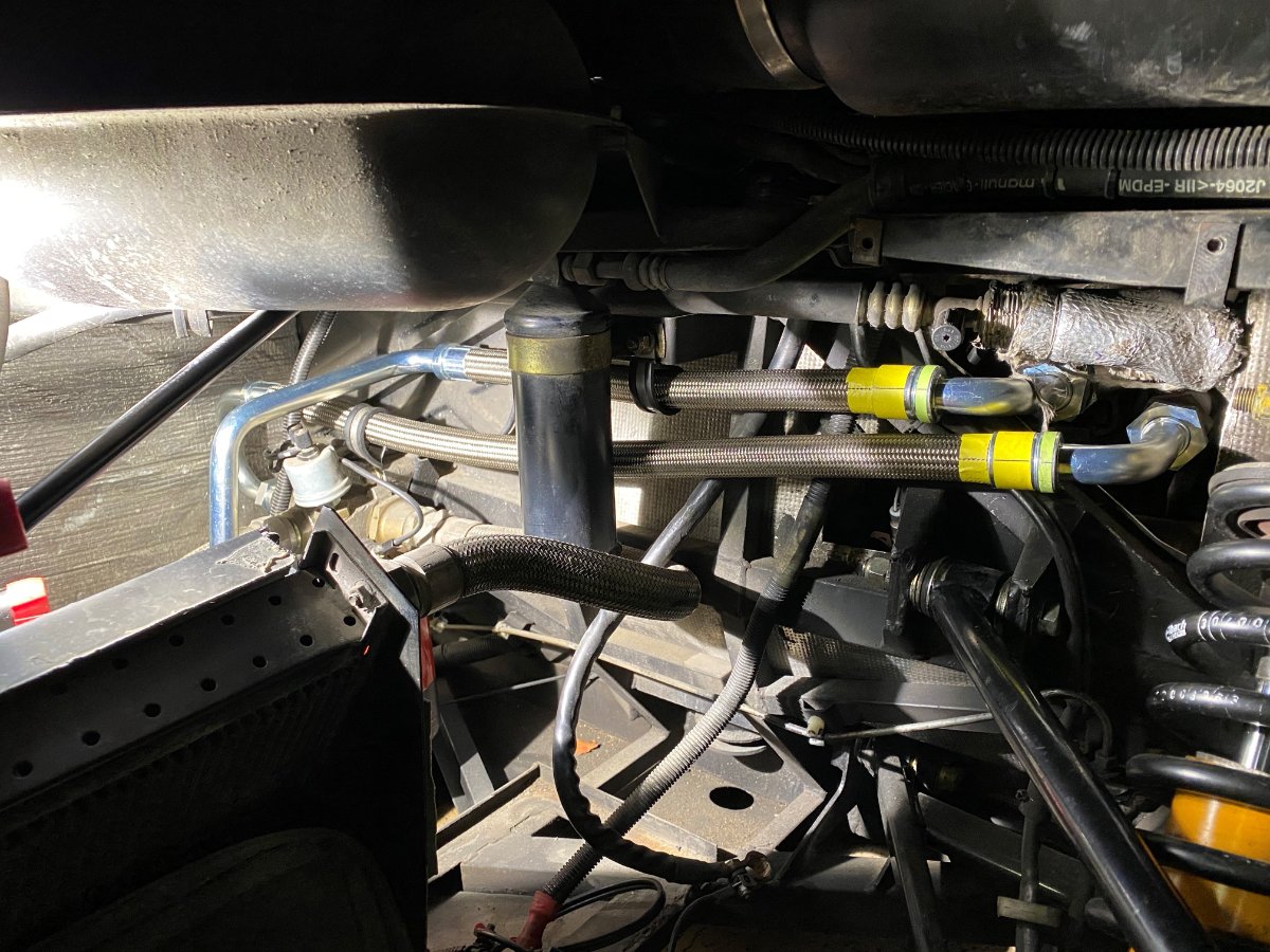

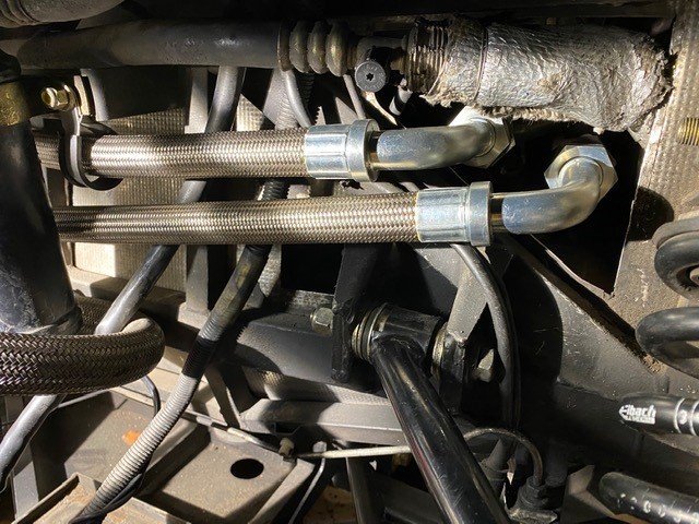

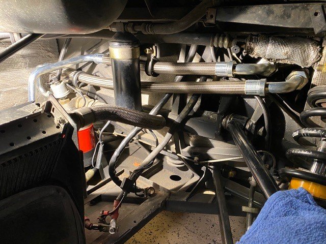

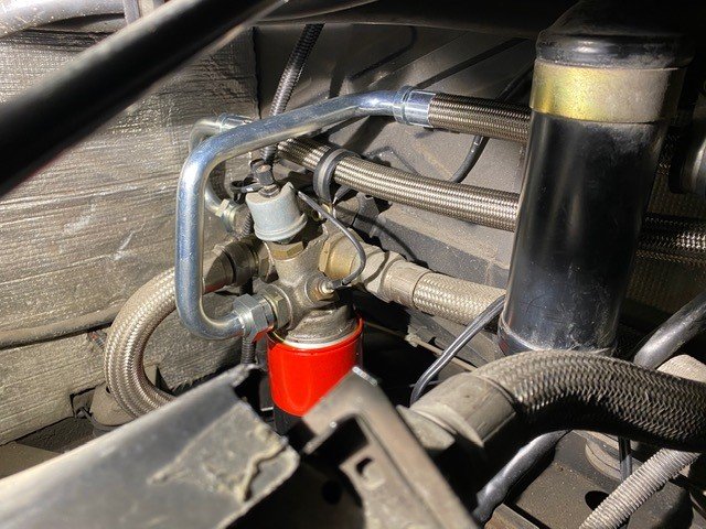

camaro97 Report post Posted January 27, 2021 Here are the prototype hoses undergoing final test fitment on my car. These hoses are really nice quality! The bad news is that they were a bit more challenging to manufacture as these fittings did not appear to be standard. Thus, they will be a bit more expensive than I was hoping. I will post more details and specs once things get finalized. Quote Share this post Link to post Share on other sites More sharing options...

camaro97 Report post Posted December 20, 2021 Thank you @del mar2 for the reply. The original OEM lamborghini cost was $750 for the two hoses. Steve @ drivenexotics.com placed the order for me (April 2020) only to find out days later Lamborghini parts had discontinued both parts. I went through the rebuild process myself (via guidance from Steve) gently cutting off the hoses without damaging the metal barbs, then had the fittings cleaned and zinc coated, and then finally crimped. There was also the risk that anytime during the process something could go wrong, and it did (see early posts in this thread). I lost all that investment (time and $550). Steve charges about $1500 (cannot find email with original amount) to rebuild your existing hoses. The last set of hoses I found available for purchase were on ebay for $3000 used which means I would still have to pay to rebuild. I have a spreadsheet with all my costs. At the end of the day, I have to sell 20 total hoses just to break even. I will never make any profit for the foreseeable future. Does that help explain the pricing? Quote Share this post Link to post Share on other sites More sharing options...
camaro97 Report post Posted December 20, 2021 Additionally, the original hoses used rubber. These hoses use Teflon. The cost of the Teflon hose is quite a bit more than the rubber hose and definitely inflates the cost. These hoses are a vital part of the engine and their failure typically results in a car burnt to the ground. The quality of these hoses exceeds the OEM hoses. These hoses were handled, test fitted, inspected, etc by one of the best mechanics in the world and manufactured by one of the leading hose suppliers in the world. Quote Share this post Link to post Share on other sites More sharing options...

camaro97 Report post Posted April 12, 2023 Hello Everyone! I have had these new hoses on my car for close to 2 years now. My car is back at Driven Exotics for service. Steve checked the hoses and is very pleased ... no leaks, no binding, no twisting, no anything. If you would like a set of hoses, please reach out. It has been a bit, so I would need to get updated pricing as I suspect pricing has increased from manufacturer. Quote Share this post Link to post Share on other sites More sharing options...
