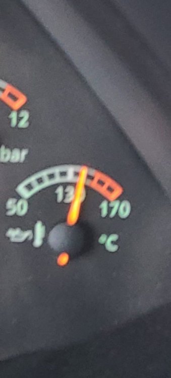

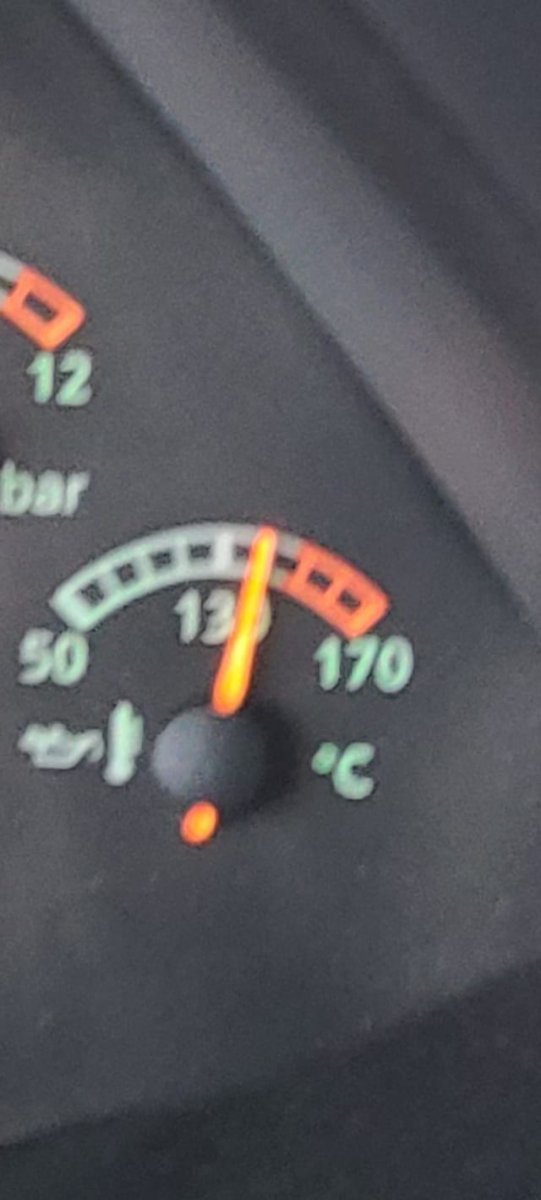

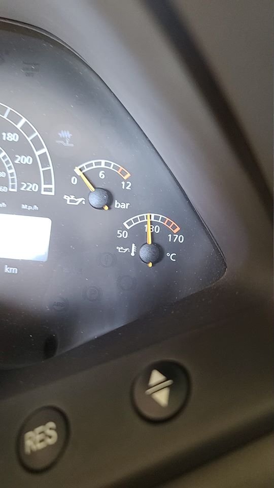

Well, the problem seems to be a sticking gauge or the temp sensor is bad.   Found the gauge sitting like this after a week of the car sitting.
You might be able to get the oil temp reading with a Bluetooth OBD II reader and see if it's the gauge or sensor that has a problem. Guessing gage since it should reset when the car is powered off.
