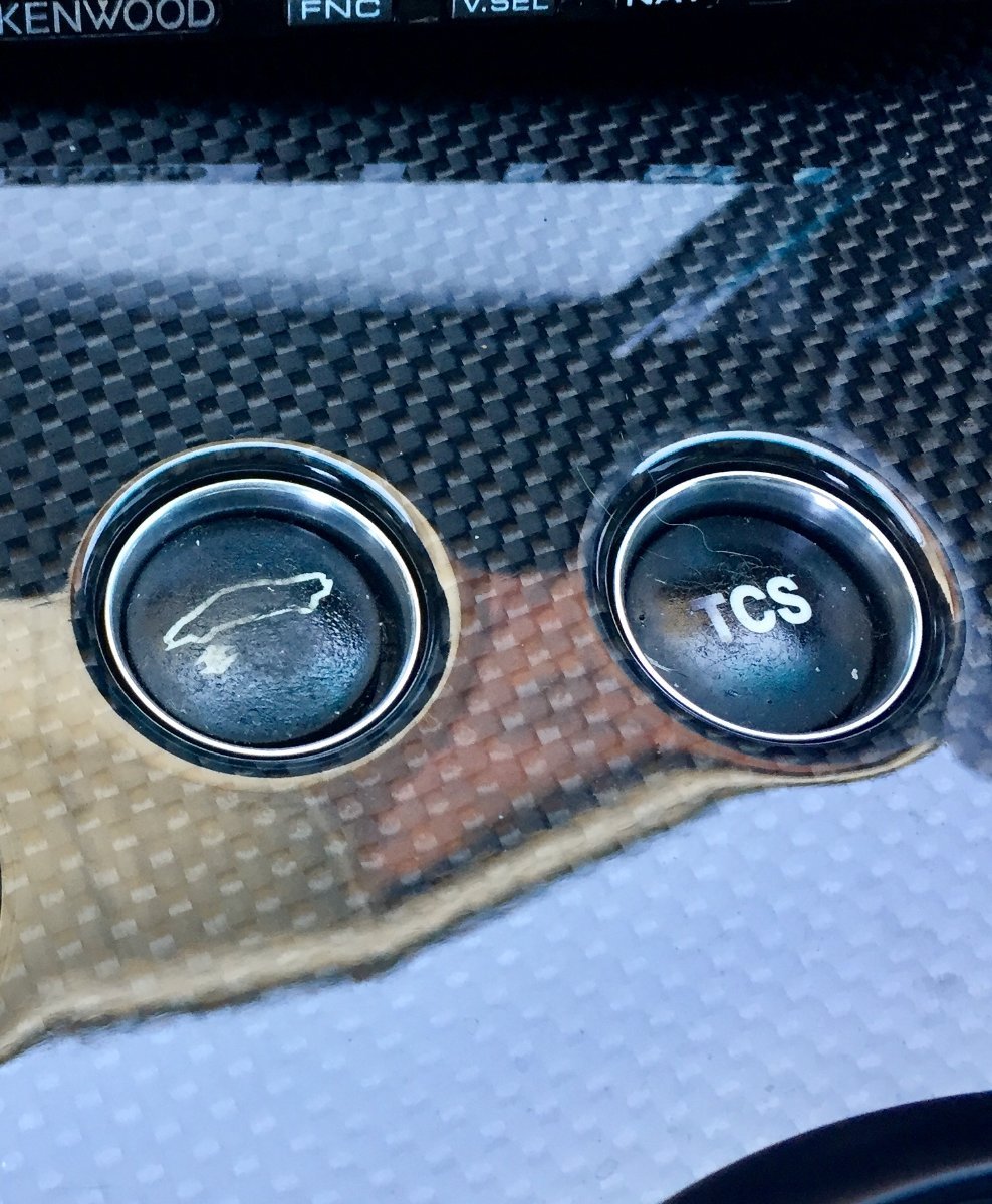

JanDaMan Report post Posted June 24, 2022 Been working on my sticky buttons based on suggestions to use Nurtogena make up wipes. Tried on my wifes sticky umbrella handle first figuring sticky is sticky no matter where it is. Coming along pretty good so far. Quote Share this post Link to post Share on other sites More sharing options...

JanDaMan Report post Posted June 30, 2022 On 6/27/2022 at 9:43 AM, DoctaM3 said: Impressive. I have other things that are like that--I guess I am going to have to try this. Those now look almost new! Take your time with it since it isn't an immediate removal of the sticky from the buttons especially at the hard to get edges. One button took me about 15 minutes, then the make up wipe kind of dries out too along the way so you have to open a few packs. I understand maybe ammonia, rubbing alcohol, goof-off and other things may be quicker but my assumption is that make up remover pads used on the face would be gentler and I wasn't sure about any paint on the buttons possibly removing with harsher stuff of if the carbon fiber surface would be affected if I got anything on it. Being careful with toothpick wraped with the wipe on the far edges helped too. I saw the Nutrogena suggestions here: https://www.youtube.com/watch?v=pIEkbgI_fQI Quote Share this post Link to post Share on other sites More sharing options...

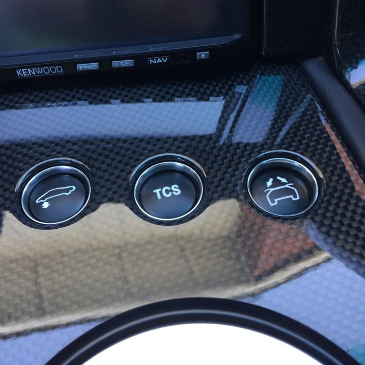

JanDaMan Report post Posted July 2, 2022 Buttons all done, at least for the ones that looked bad and the rest look ok I suppose until later down the road. Only downside I can see with cleaning off the soft touch sticky stuff is that the soft touch has a little mat haze to it so unless you clean all the buttons that are in close proximity the buttons will look a little different. See below where I cleaned my R button and left the others alone for now (photo transfers upside down, not sure why). Quote Share this post Link to post Share on other sites More sharing options...
