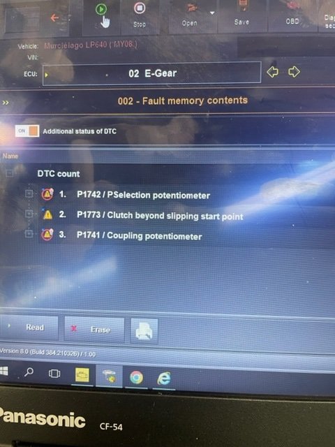

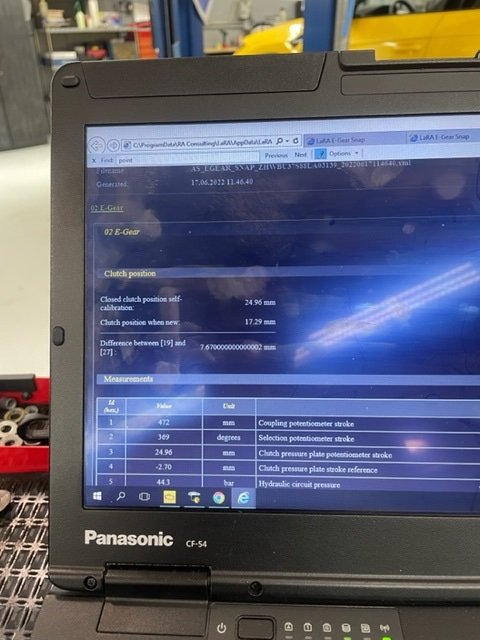

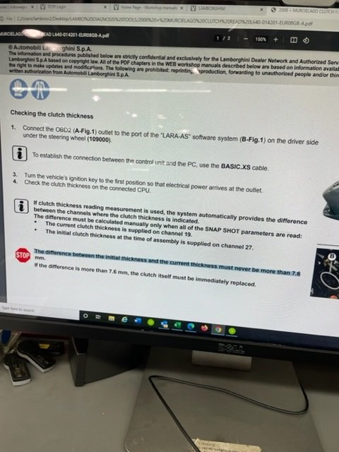

Jeff DiBart Report post Posted July 1 Hi guys. I am hoping this community of Lambo enthusiasts can combine our collective knowledge to help me solve an issue with my 2008 Murcielago LP640 (e-gear). Here's the deal (and sorry it's a novel)... The car has around 20k miles on it. I was due for my NY state inspection, and I decided that rather than taking it to the independent exotic shop I usually use (who doesn't have a Lambo computer), I'd instead take it to the dealer so that I could have them connect to the computer and check the remaining clutch life. Was a half hour drive there. Car drove perfectly normal same as it has for the past 3 years I have owned it. Stopped for gas on the way, restarted fine, drove to dealer with no issues. Car was awesome as always. Dealer calls me 2 days later and tells me the clutch is done with 7.67mm after subtracting original and current, as shown here on photos the tech took: OK... I knew the clutch was probably getting there, although generally I have had no issues. Once in a blue moon it would randomly switch back to neutral when I put it in first, but NOT flashing N indicating an e-gear issue. I always just chalked it up to the slightly clunky Murcie e-gear. But I knew it was about time for a clutch. So fine, the clutch is done. HOWEVER, then he told me, "But when I first got in it after you dropped it off, when I went to start it the starter didn't crank the first few times." I asked him if he undid the immobilizer. "Yes. Then, when I went to put it in gear, it pops right back to flashing N. For either first gear or R. I have to hold the paddle to force it to go in gear." (Now guys, this has NEVER happened to me. And now mysteriously after a perfect 30 min drive to the dealer that had no issues and felt just like every drive in the last 3 years, it coincidentally fails the second the tech gets in? I'm thinking WTF...) So now they tell me that the potentiometers for the e-gear position sensors (front-to-back, side-to-side so it knows what position the shift rods are in) are also shot. He shows me this: Then he says, "Unfortunately, the potentiometers are not a standalone part; they are part of the actuator. A new actuator is $11,000." Now I'm freaking. The clutch job just went up by about 50%. So... I have read threads on here and other forums that say, "Unfortunately, yes, it's an engine out to replace the potentiometers. It's a cheap part, but engine out to replace. In the Gallardo you can reach them without dropping the engine." I realize the engine needs to come out (for the clutch anyway), but I'm trying to figure out if I can replace these "cheap" potentiometers without replacing the actuator ($11k). BTW, I don't think this is battery voltage-related. I keep it on a C-Tek tender, and in some of the photos the tech sent me the Lambo computer says "battery voltage 13.881v" or something. And the e-gear does prime when you open the door. I'm also wondering... is there a chance he hooked up the computer and somehow cleared the e-gear learned slip position settings (PIS), etc. and that's why these potentiometers are now erroring? Anyway... let's assume I need the potentiometers. I don't see anything in the e-gear section of the shop manual about potentiometers that can be replaced. I can't find any e-gear related potentiometers on the parts diagram on bullstuff.com. Has anybody encountered anything like this? Can you maybe point me to the part numbers of the potentiometers? Or ANYTHING that can help? Or did you indeed need to replace the actuator? Or maybe if the just runs the self-learn procedure those potentiometers will stop erroring? Thanks everyone for any advice you can provide! -Jeff Quote Share this post Link to post Share on other sites More sharing options...

jefflambo Report post Posted July 7 The potentiometers are not part of the actuator. They can be replaced. They due go bad, I have replaced them many times. Part number for potentiometers is 086927321A Thats from Bull Stuf a little over 1K. Good luck with your repair I hope this info helps. I worked on Lambos for over 20 years at 2 dealers before I retired due to a injury. Quote Share this post Link to post Share on other sites More sharing options...
jefflambo Report post Posted July 7 They show the part in stock and for just under 1k at Scuderia parts. Quote Share this post Link to post Share on other sites More sharing options...
Jeff DiBart Report post Posted July 8 Yup, thanks @jefflambo. I am on it. Part ordered. Dealer is either clueless or trying to get over on me. Neither works for me. Thanks for helping! Quote Share this post Link to post Share on other sites More sharing options...
