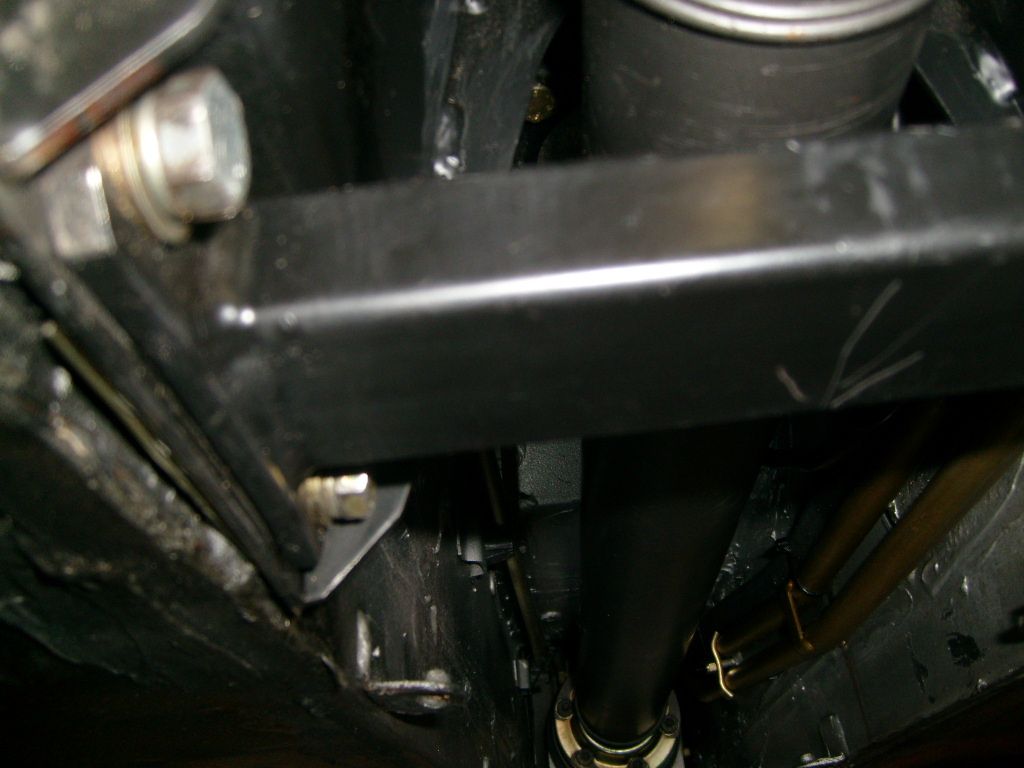

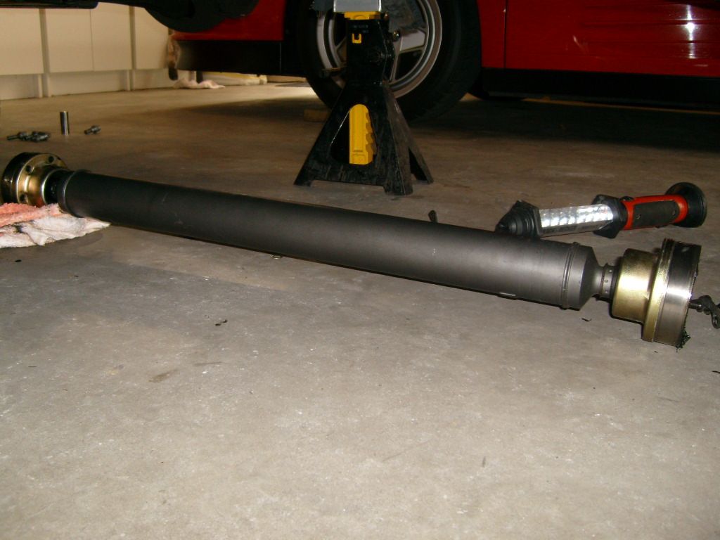

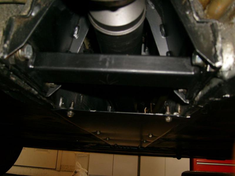

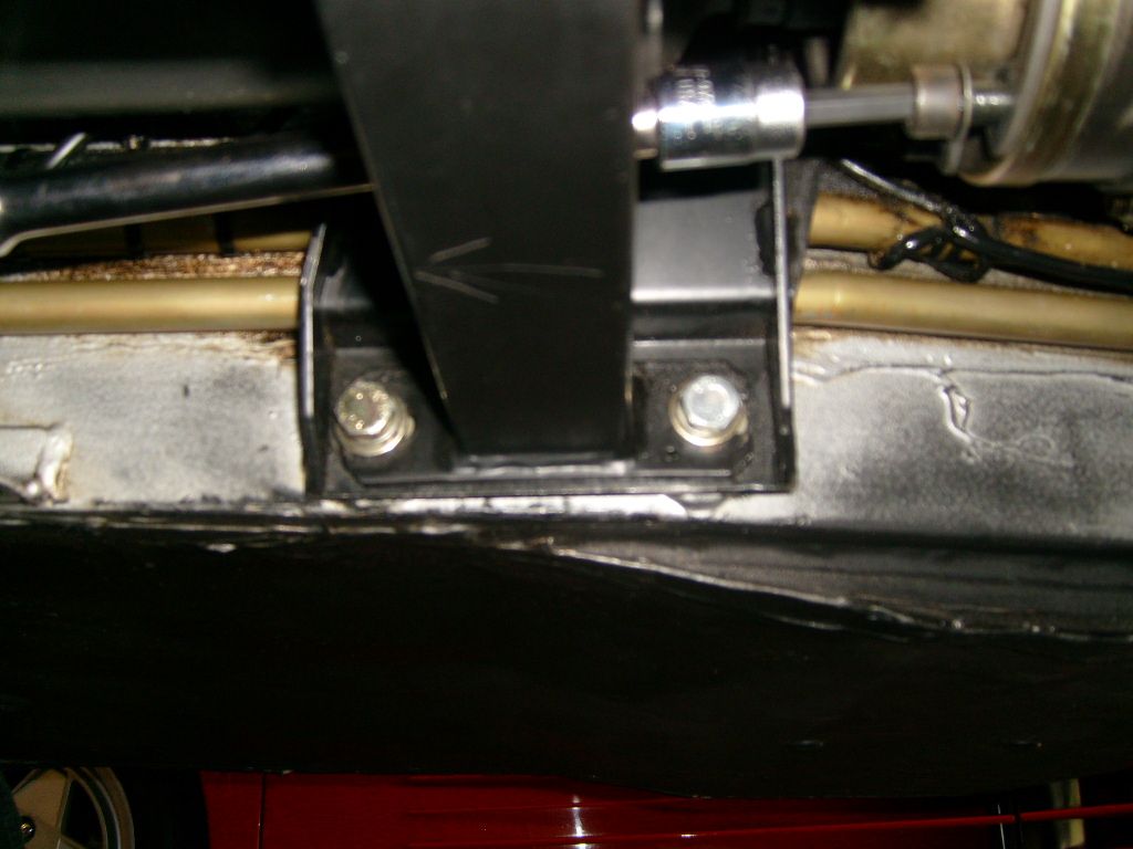

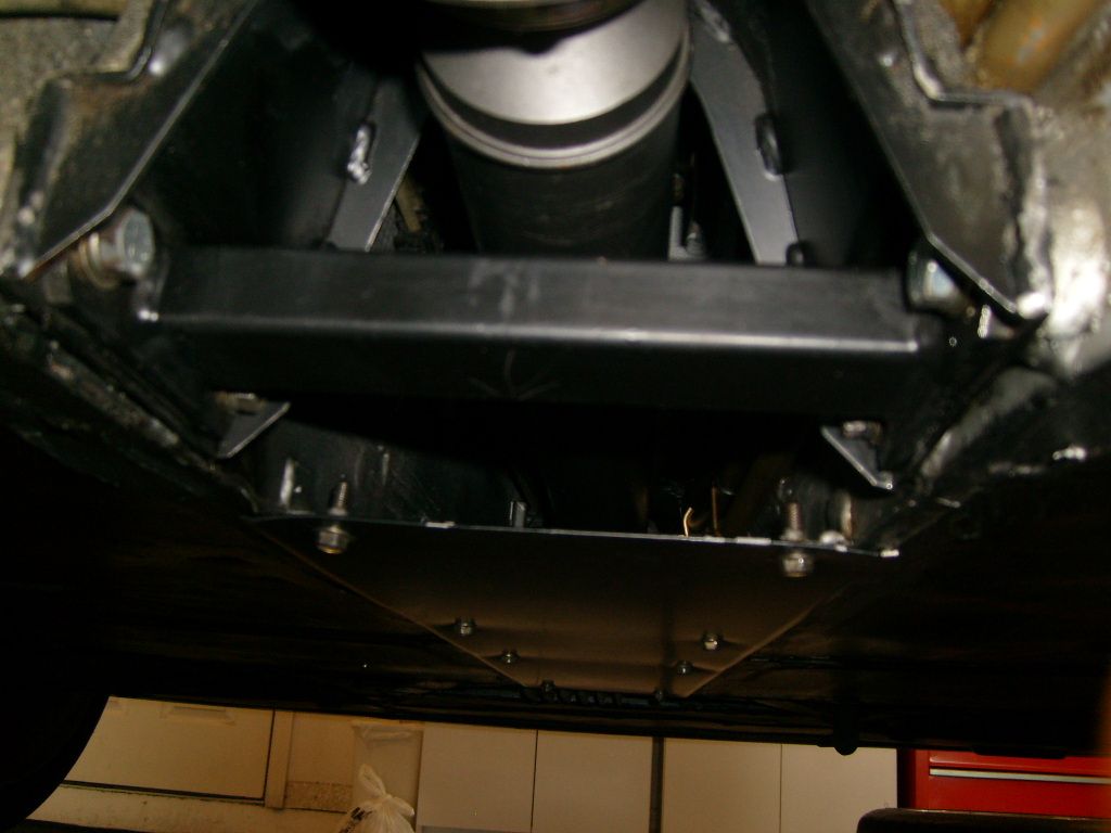

Shamile Report post Posted March 5, 2008 Undo the Allen bolts.... Remove the bracket holding the center engine mount and lower drive shaft. With the engine mount bracket, the cross brace can be removed while not taking all the bolts out of the mount brace. Remove the front 2 bolts, loosen the 2 rear, flip down the cross brace and remove. By doing it this way, you do not move the motor mount bracket and preserve any alignment that may have been there......one less problem to encounter Drive shaft down and out....DIFF NEXT ! All for now... Shamile Quote Share this post Link to post Share on other sites More sharing options...

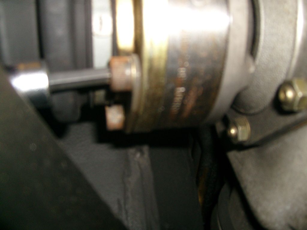

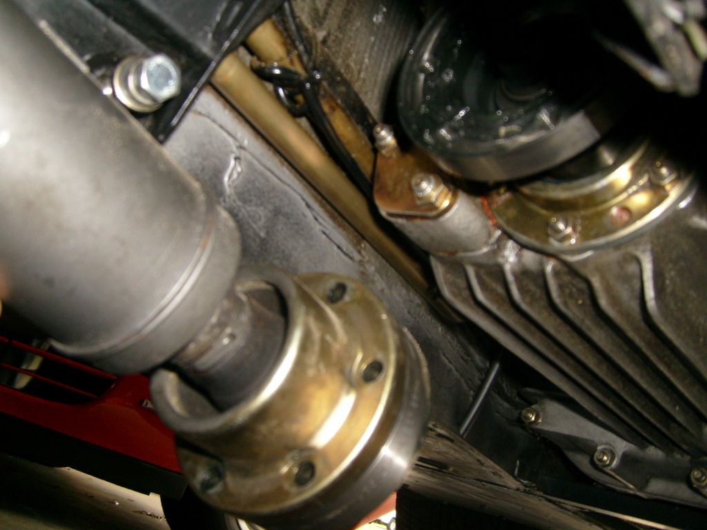

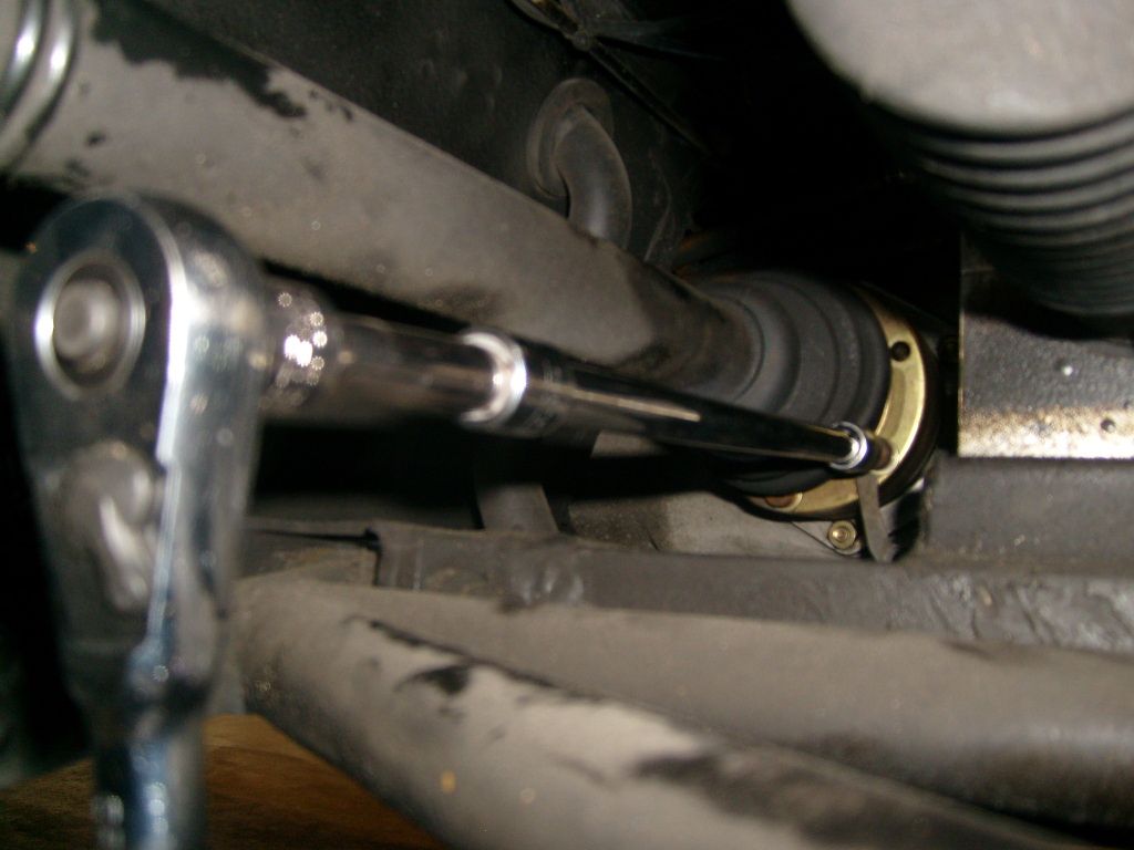

Shamile Report post Posted March 6, 2008 Some more fun today. started on the front diff. Pix 1 Undo the front CV joints Pix 2 A good set extensions is handy. Pix 3. A little trick. How do you open the CV joint without the wheels turning? ( Drive shaft already removed ) Take off one wheel and block the other one on the car. Nothing grippier than rubber to rubber. Shamile Quote Share this post Link to post Share on other sites More sharing options...

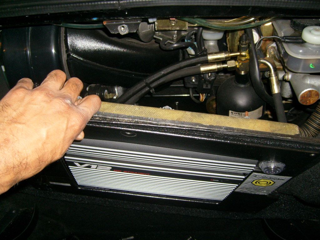

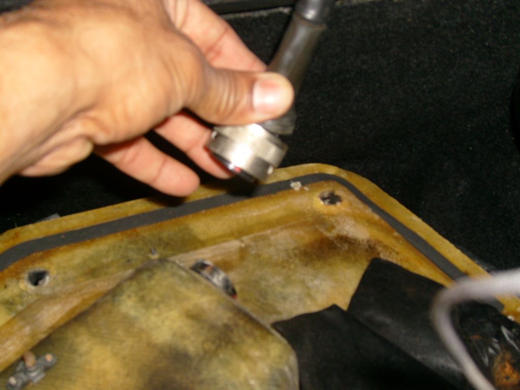

Shamile Report post Posted March 6, 2008 To get to the diff bolts, you have to remove the front panel in the trunk. Quote Share this post Link to post Share on other sites More sharing options...
