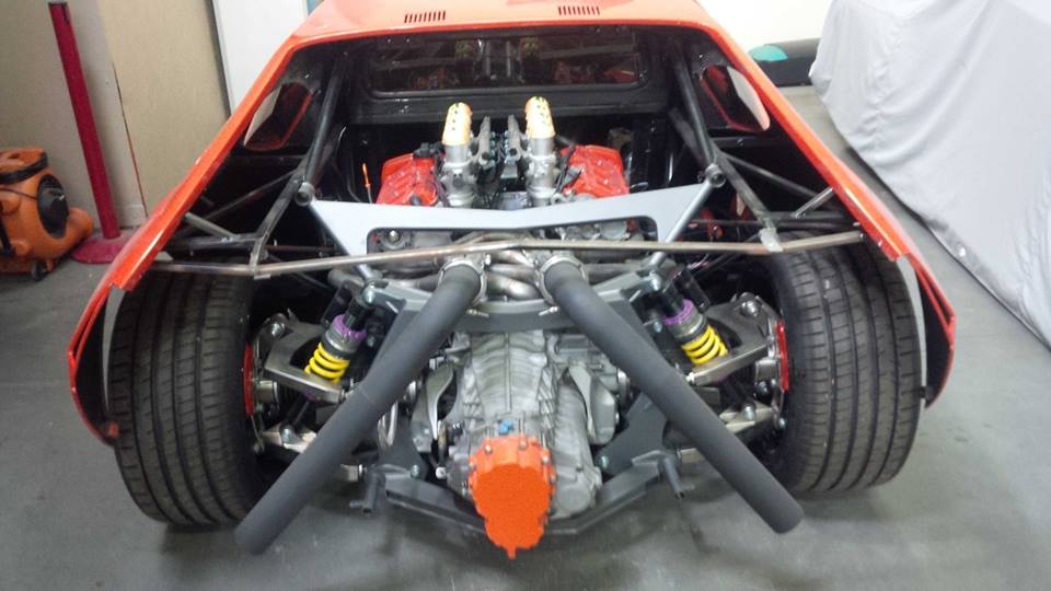

THANKS! Its hard being stalled on the project, but we will get her done in time. BTW we are about to hit 700,000 fans on Face Book the little Bull that could I guess. LOL
When the motor jumped time on the first fire up it was due to the builder not correctly putting the belt in and not properly locking it down. FORTUNATELY he was so bad that when it jumped time it stopped before any valves were taken out. Compression check has one bank advanced too far and one bank retarded. So we decided to lock down the belt order the proper tools for doing the timing but needed to check if our thoughts were correct before we pulled the motor and the heads. I(f we were right cool if not the damage would have already been done so no harm in setting the time as best we could and do a compression check then a test fire. We were correct and the motor fired right up. Next we time and tune!

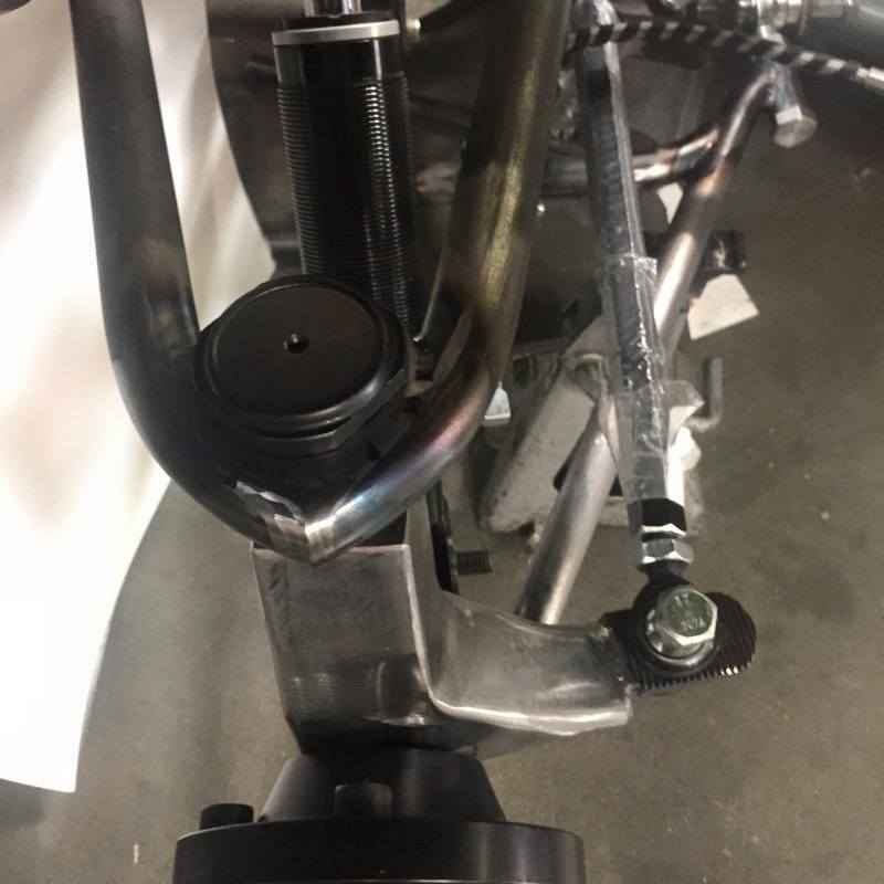

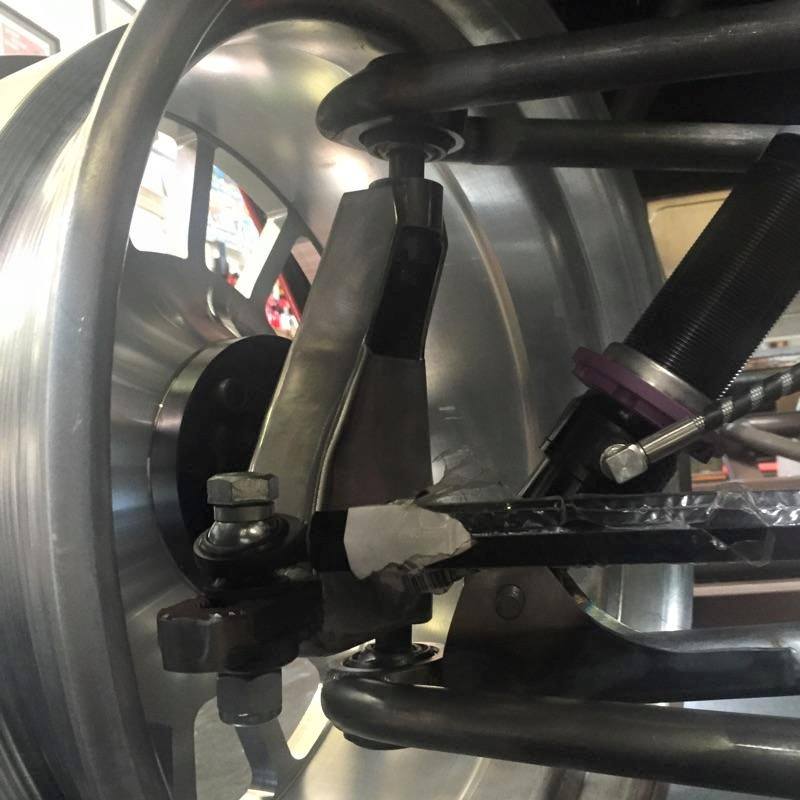

Danny Huseman's racing has will be un-doing the entire front end of the Lp420 SVM Urraco. And installing a proper front suspension.
Ted's Rod Shop is bidding out re-re-doing the front and rear bumpers and going to a better headlight solution.
ABD Racing Werks is prepping the motor.
In other words most things Alan Lee designed will be chucked...
Work is contracted away we go once more..

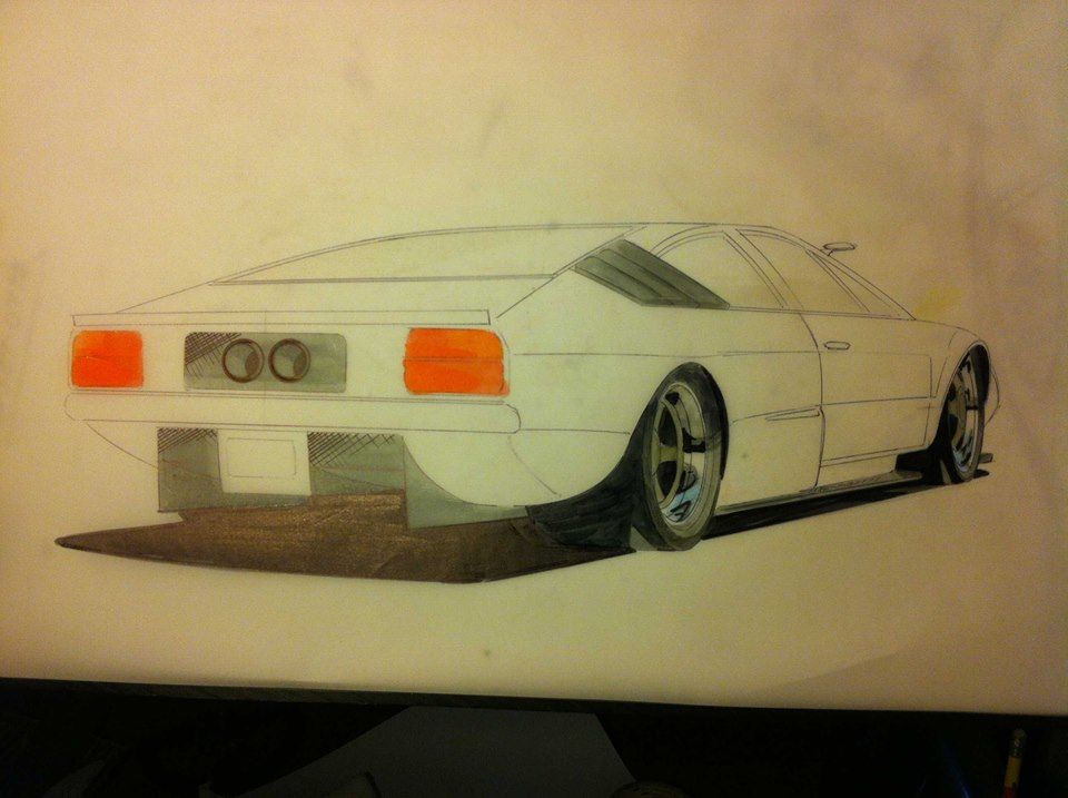

UPDATE:
Frank Killam (BMW Design Works)
and an up and coming designer from Pasadena Collage of Design, "Gaston" are taking what was done to the car by Alan Lee, and fixing it..
First to go round butt.. Urraco tail lights have been secured.
Next to go the ugly chin
Then the Miura headlights back to pop ups.
Cleaning up the lines.

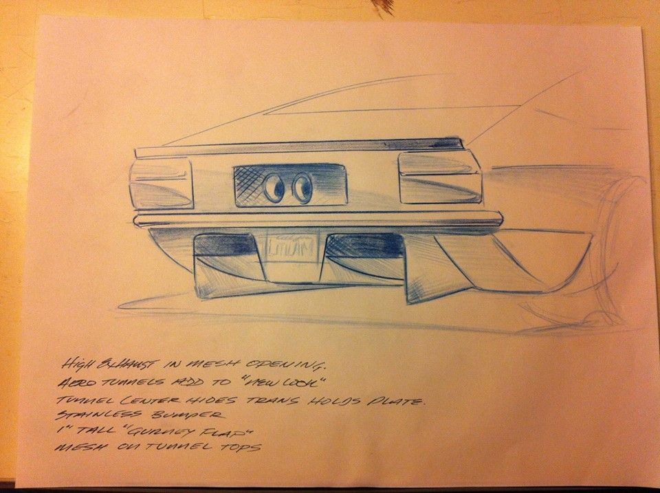

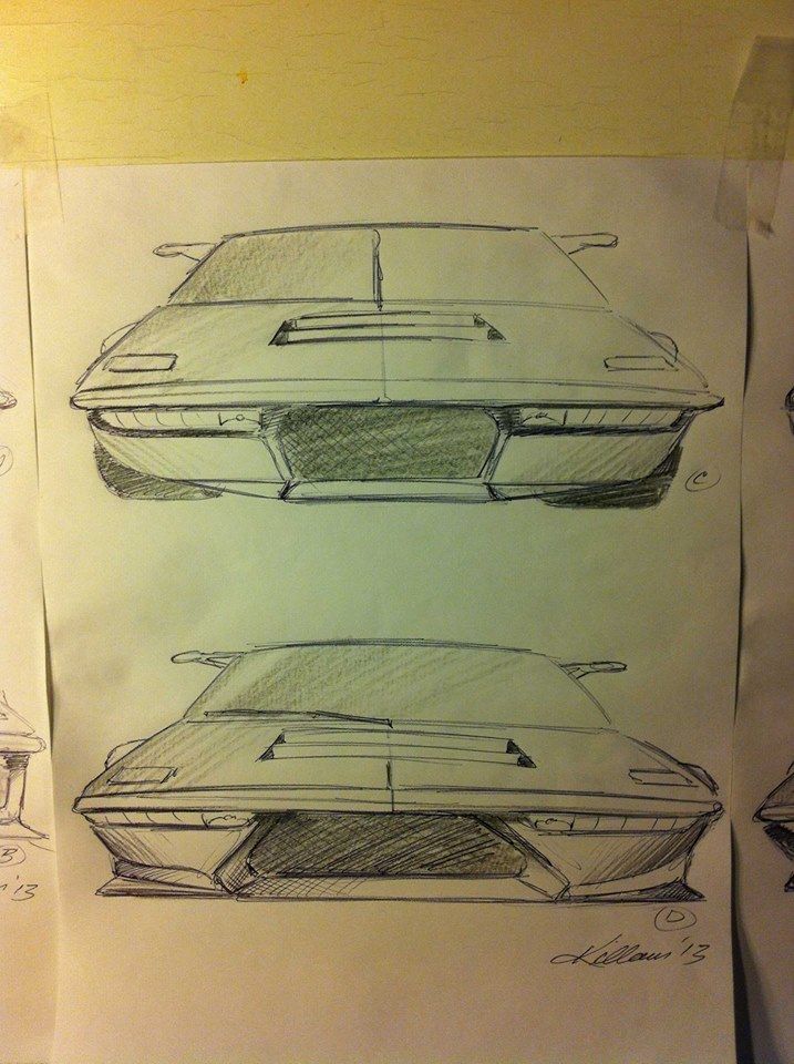

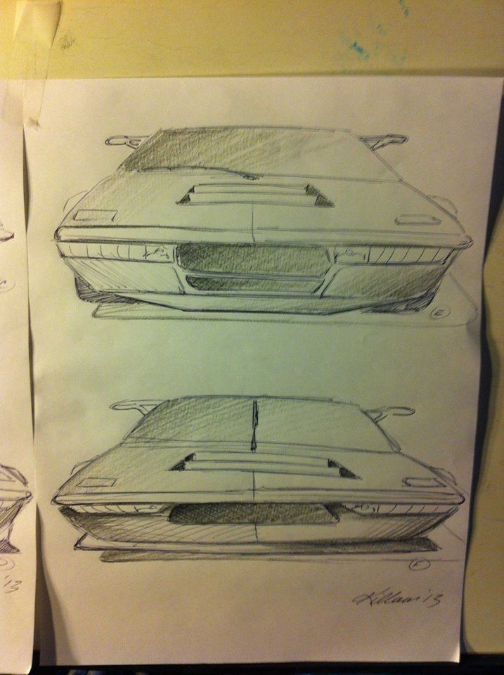

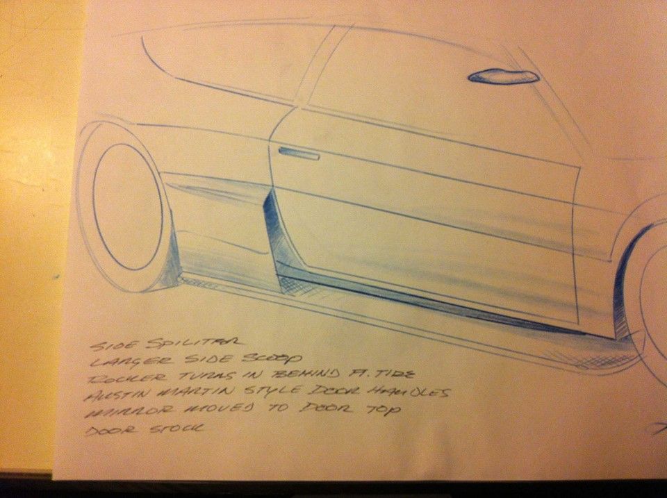

I will post the artwork soon..
New Trans on the way (Alan built the one in the car we have zero trust in it)
Work has re-started..
  • 2 weeks later...
Now we're talking. All good except the flying mirrors. What would really set it off imo would be a set of huge staggered bravo inspired wheels.
No flying mirrors..

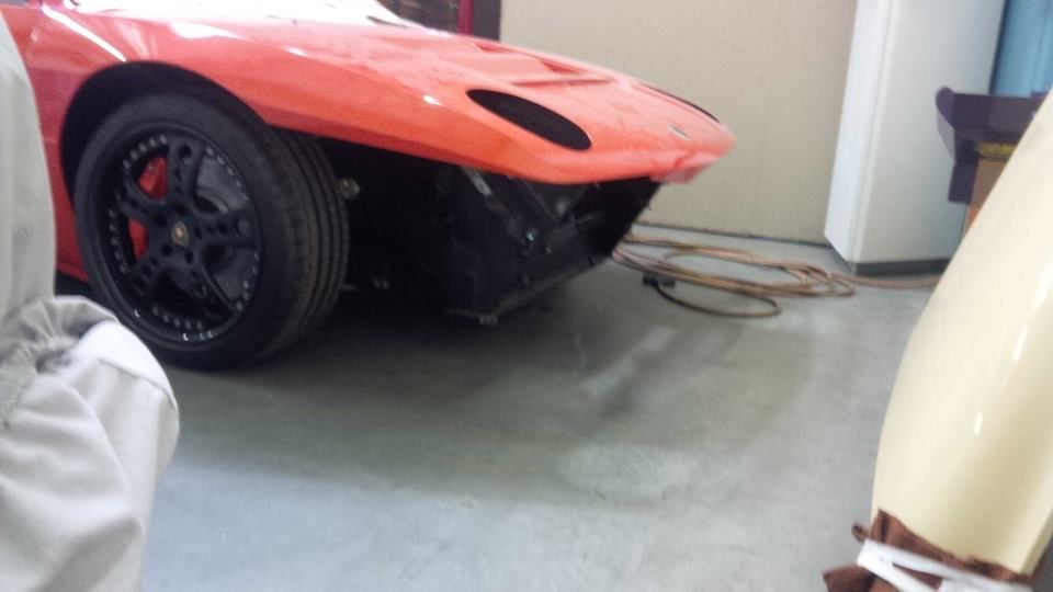

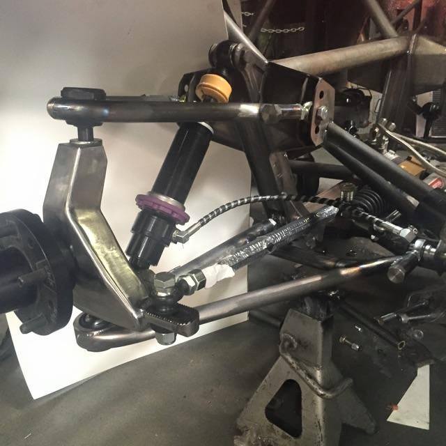

Front and rear clips removed, headlights removed, getting ready for the re-re-build. One thing we are making the entire front clip removable so we can build the new front suspension properly.
Those drawings are excellent. The reason: he used a frickin hand and pencil!!!!!
That design is fantastic and very much like it came from the design dept at Lamborghini....decades ago.

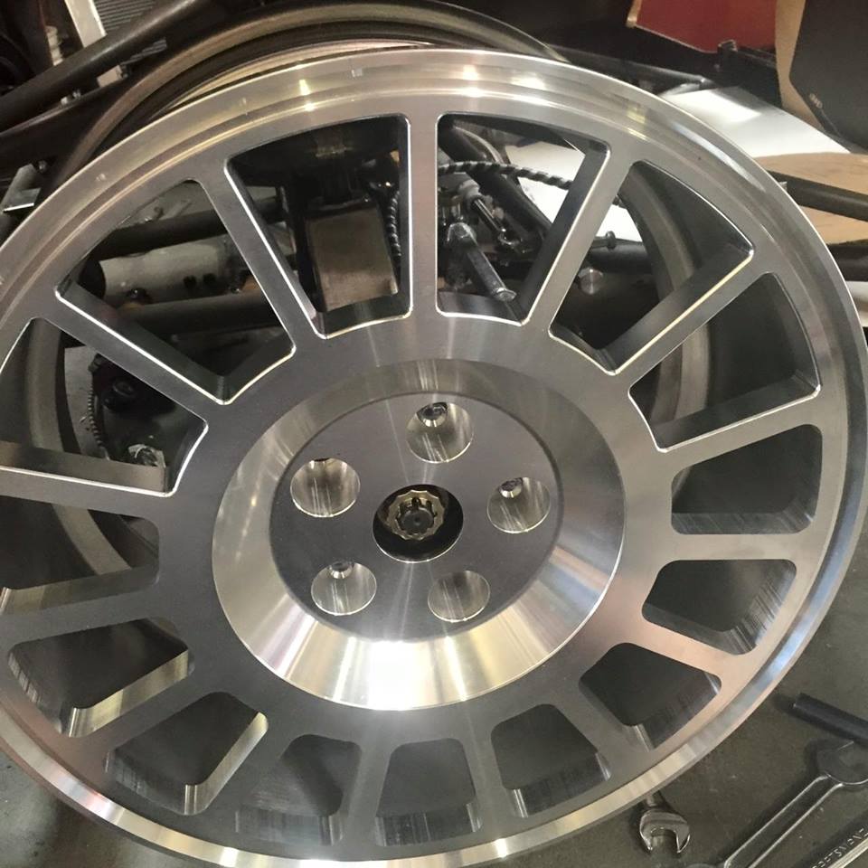

5) OMF custom rims are almost done.

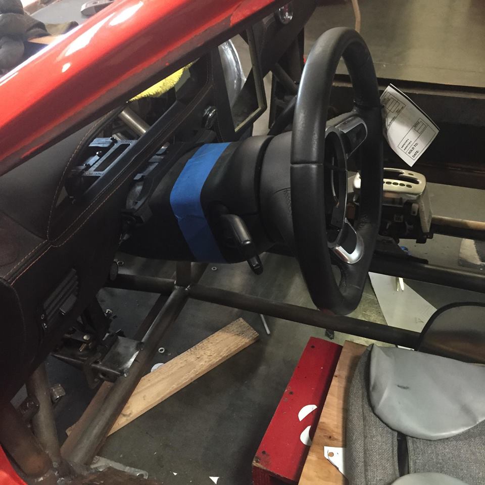

I am looking for a Gallardo Key fob case. We went with an Audi R8 steering column same column in Gallardo was 7 times the price.. But now need to change out the key fob case to a Lambo case.

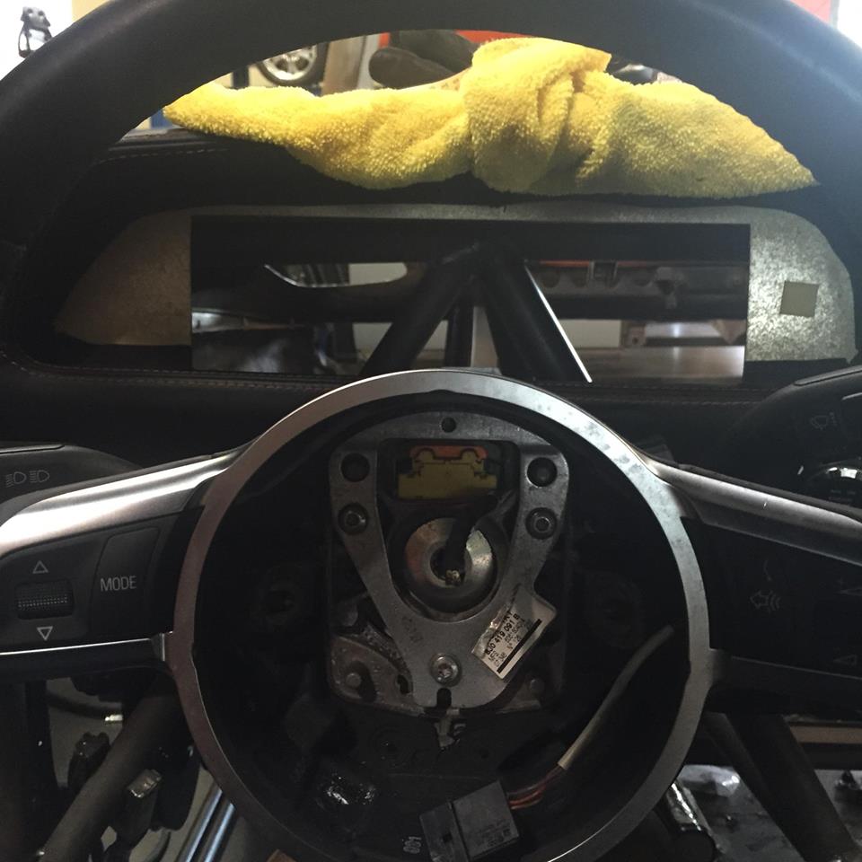

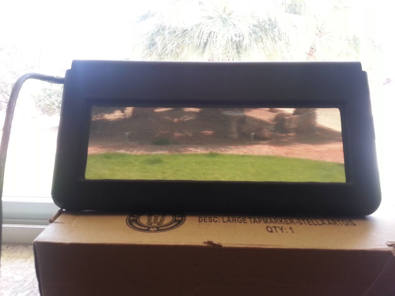

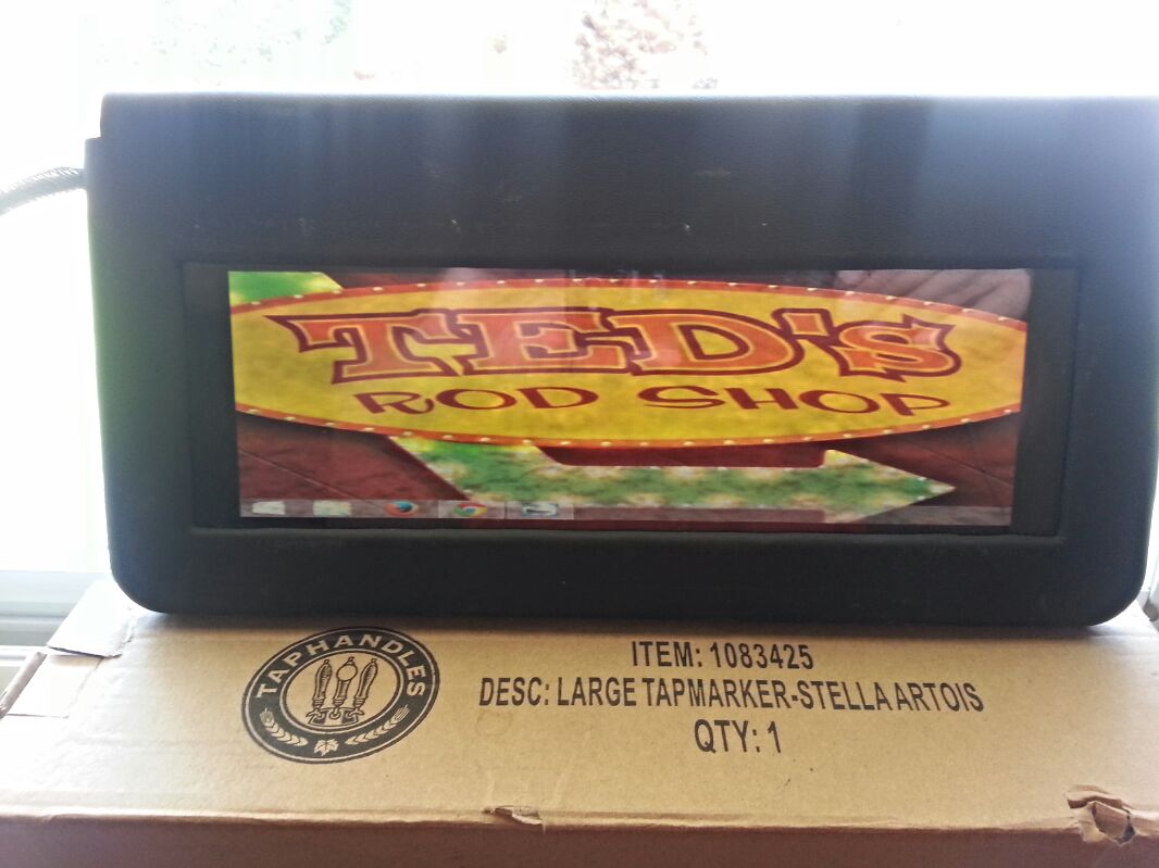

Ok heads up (pun intended) here is my home made poor mans non oem heads up color display. Transparent LCD color display built into my sun visor. Before you laugh think about the flir Pathfinder IR camera for night driving. Or Other apps I can pop up there and not look away from the road.
https://www.facebook.com/Lamborghini...type=2&theater

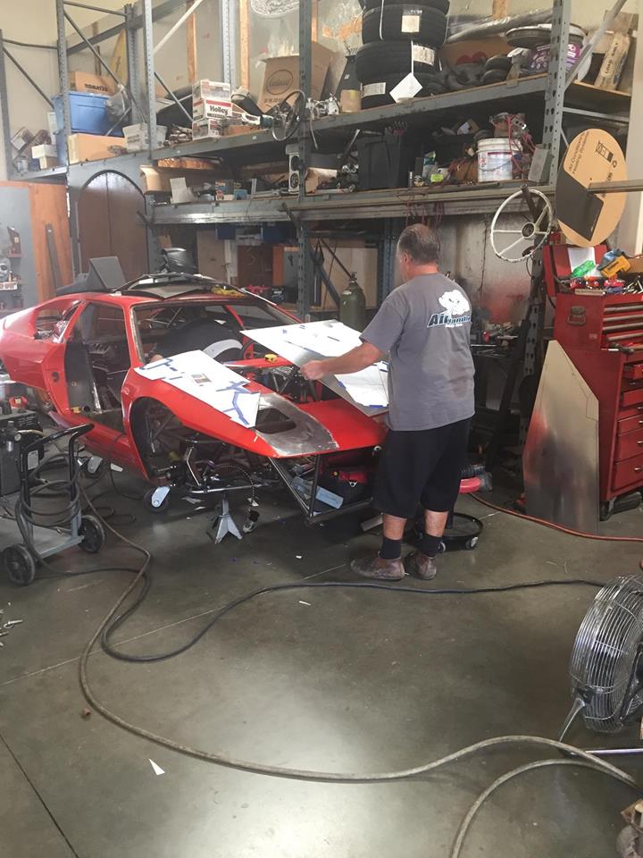

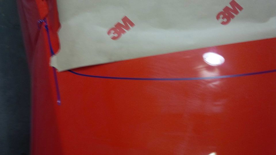

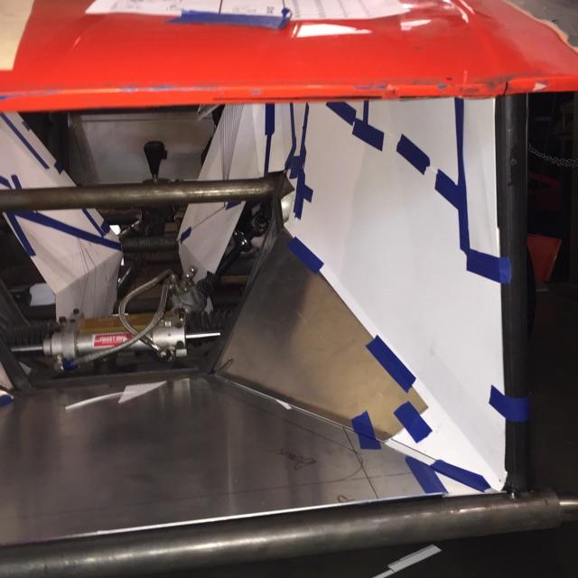

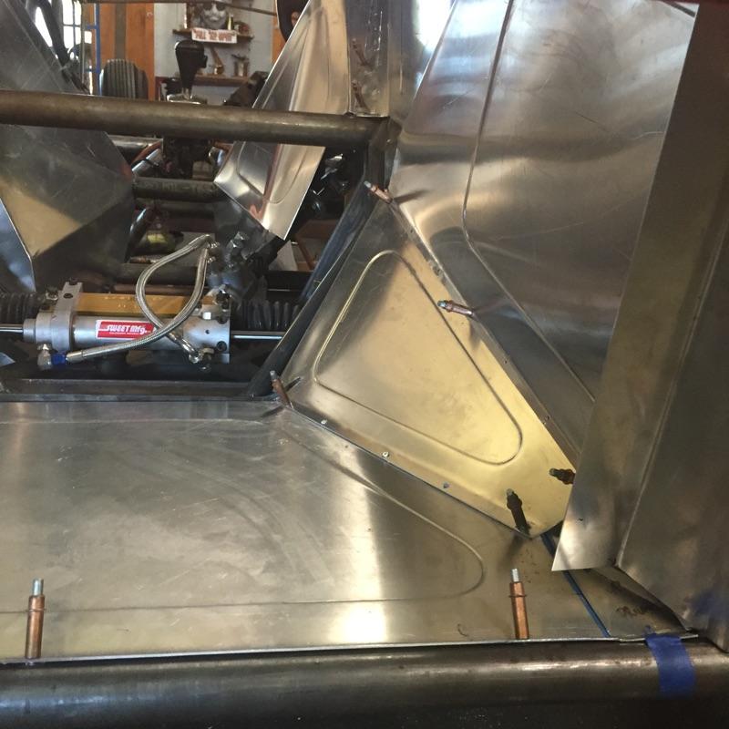

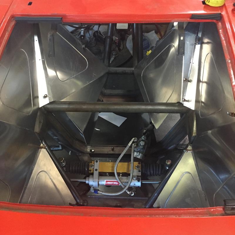

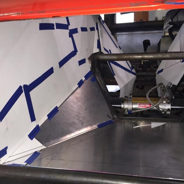

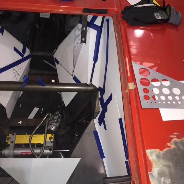

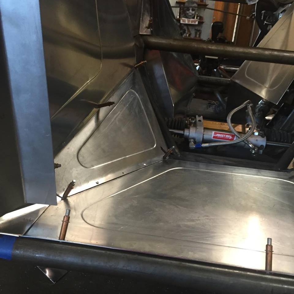

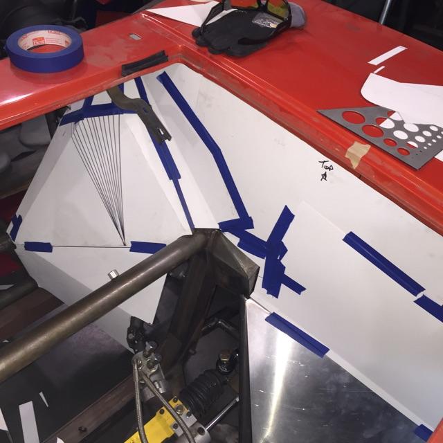

And Eric at Teds is fast closing in the Urraco sheet metal now that the front suspension is done. The paper templates for the fab are in. Let the welding continue..

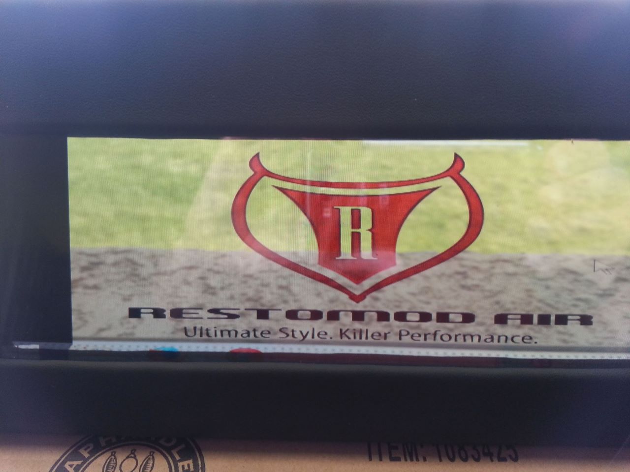

Here is a couple of good shots showing the transparent nature of the display.
My front yard you can see how well the display cuts the glare.. NOT enhanced photos.

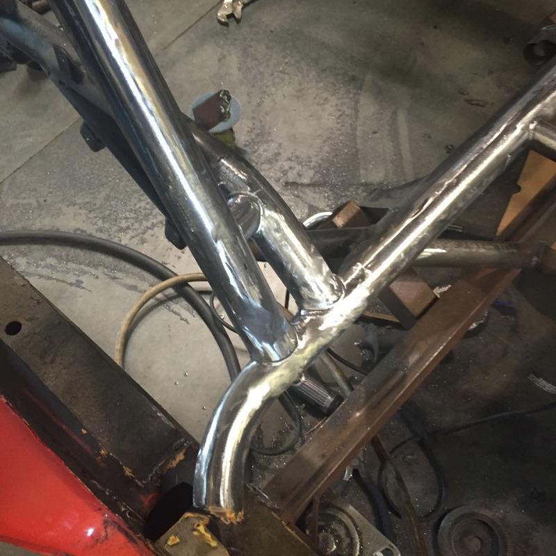

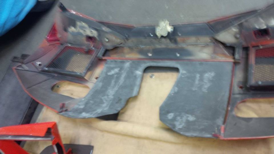

Ted's Rod Shop found some more bad work by the first builder. He had SLICED the main roll bar almost in half with a grinder and filled it with seam sealer rather than fixing it.
The rear firewall welding was a joke so was the welding under the tons of seam sealer goo.. So it all had to get fixed. Also the "trunk" is getting lined in metal.
