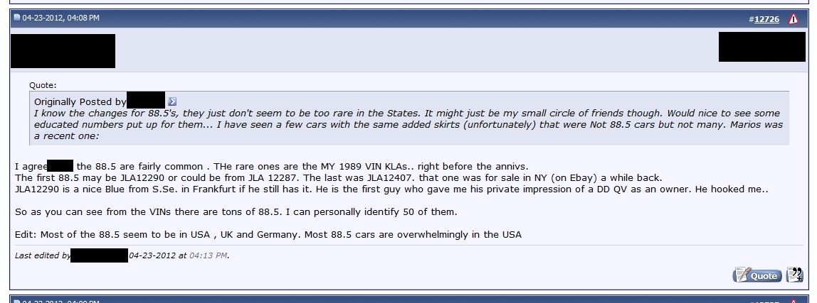

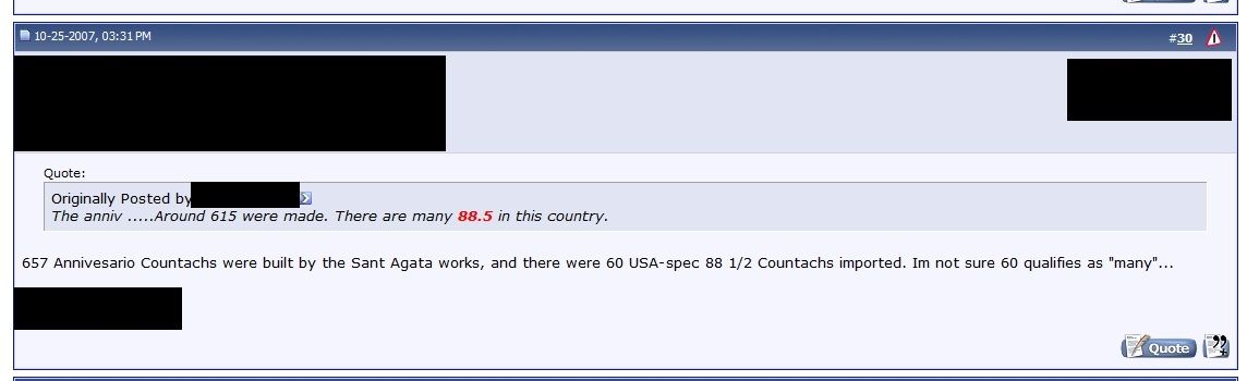

islandguy Report post Posted March 23, 2014 i was told 55 or 75.. but that number came from Sackey years ago. ( i know how much weight you will put on that!!!!) You might be referring to these Ken. I snapped these screenshots years ago. I hope this is not a no no... Quote Share this post Link to post Share on other sites More sharing options...
ken qv Report post Posted March 24, 2014 Yes!!! Thank You.. i believe the "quote" in the first one is actually ME talking to someone about it. So that discussion came back with a number of "60" and i don't think that was ever really challenged. i think it would be interesting to know for sure. Quote Share this post Link to post Share on other sites More sharing options...
emilio Report post Posted March 24, 2014 so 60 US spec 88.5 ? and very likely other 60 or more DD... not a lot of these around Quote Share this post Link to post Share on other sites More sharing options...
CountachQV Report post Posted March 24, 2014 so 60 US spec 88.5 ? and very likely other 60 or more DD... not a lot of these around hummm. the first post could be mine.... I vaguely recall that I attempted to count the 88.5 from the potential first 88.5 vin known / last non 88.5 QV known up to to last QV known / first anniv vin. this is how I kind of figured it out. that assumes that by 1988 they had the vins on the QV straighten out from the early years. I can revisit these figure again. Quote Share this post Link to post Share on other sites More sharing options...

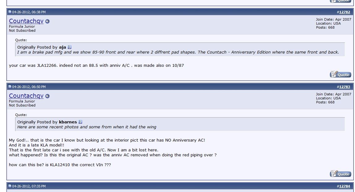

islandguy Report post Posted March 28, 2014 Catching up on this thread. Yes, that was Ken & QV. Here’s another one. Because I spent years looking specifically for an 88.5 I collected a lot of data. Quote Share this post Link to post Share on other sites More sharing options...
