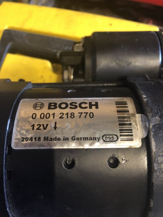

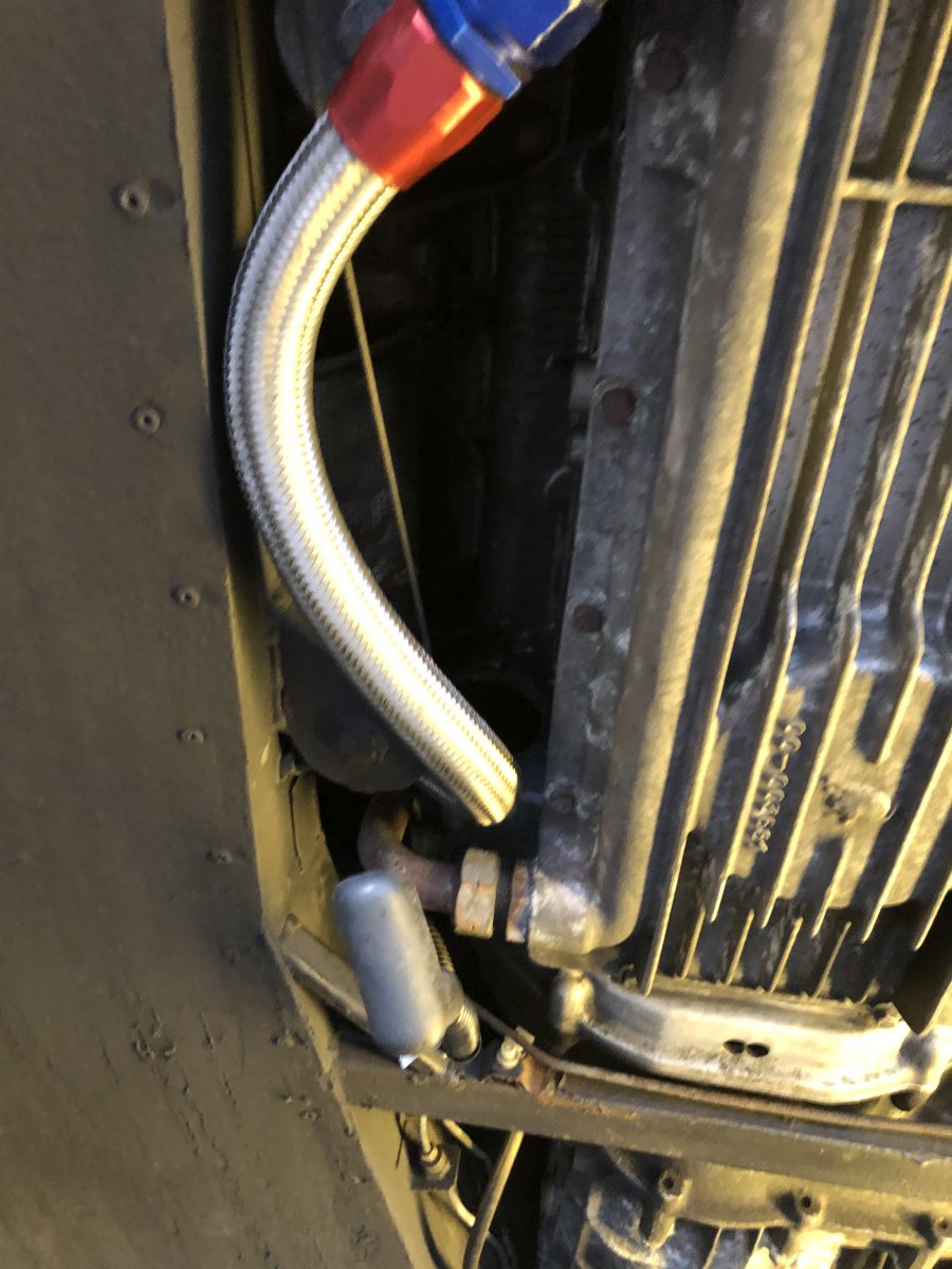

Was bored yesterday morning so I took the starter motor out. It was easier than changing the oil !
the car lives on a 4 post lift so I can sit on a chair and reach the starter motor. Getting the wheel off was the hardest part- it is just fiddly finding a jacking point on a 4 post lift.
battery shows 12.68 and the car hadn’t been out for a couple of weeks.
i didn’t remove anything, big oil line is still in place handbrake cable is still there. The front but 19mm spanner, the top nut 17mm socket. I could get about 2 clicks on the ratchet but that was Just enough to be able to ind the nut. I would have struggled without the inspection camera though. I reckon under an hour once I had finished p****ing about with the wheel.
Hopefully the repair shop can have a look at it next week.
thanks for all the suggestions and LW for his thread on removing the starter, will report back on the outcome.
