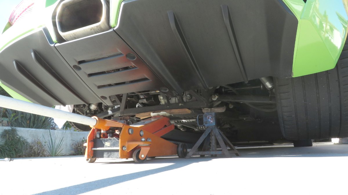

I have always used the middle of the frame at the back, with the handle down i can slide the jack straight underneath the exhausts and jack it up. I can only get the half movement out of the handle but that is enough. Then put the axle stands on the corners of the frame, they are reinforced in that area.

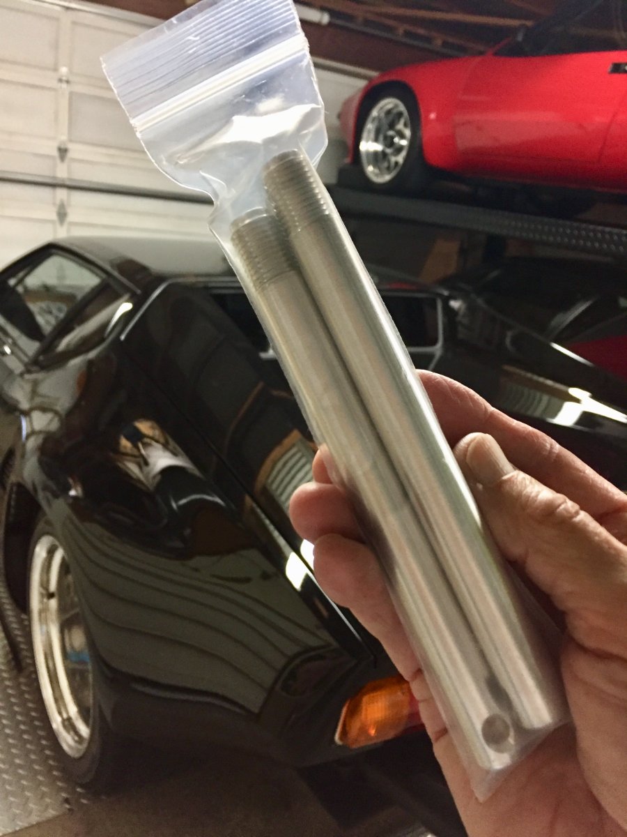

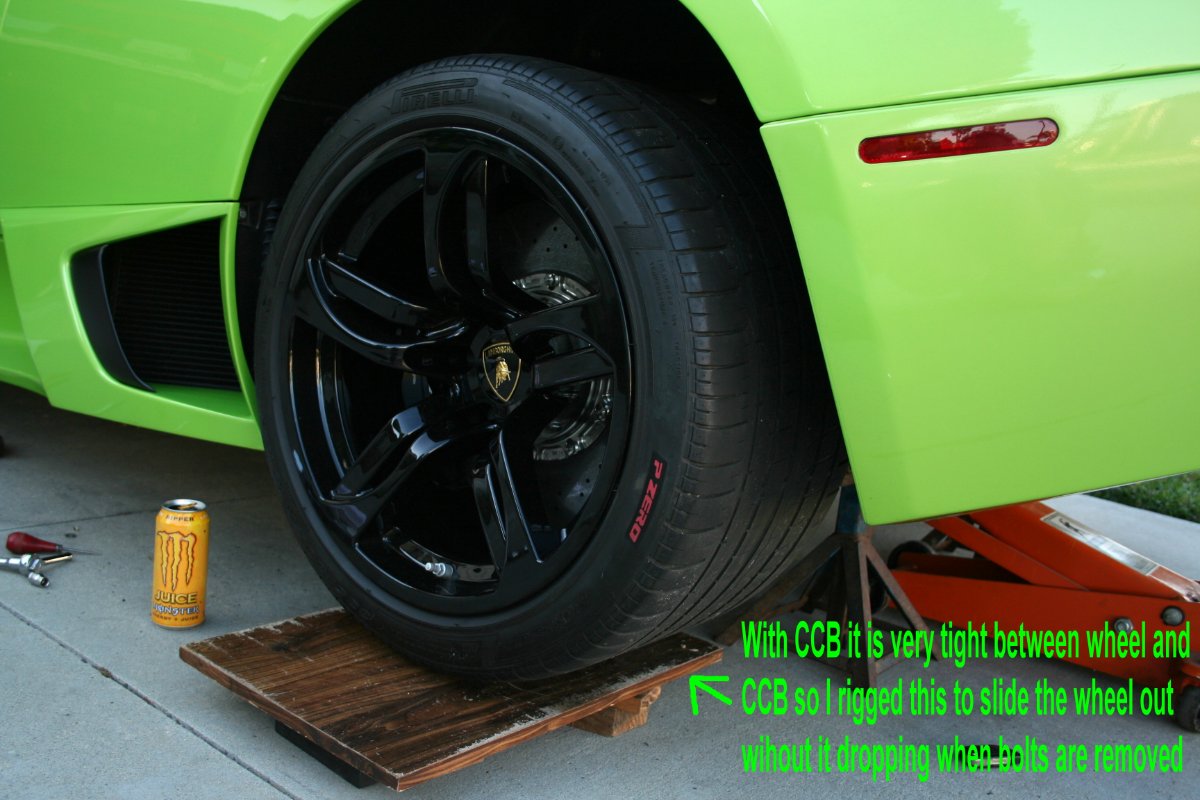

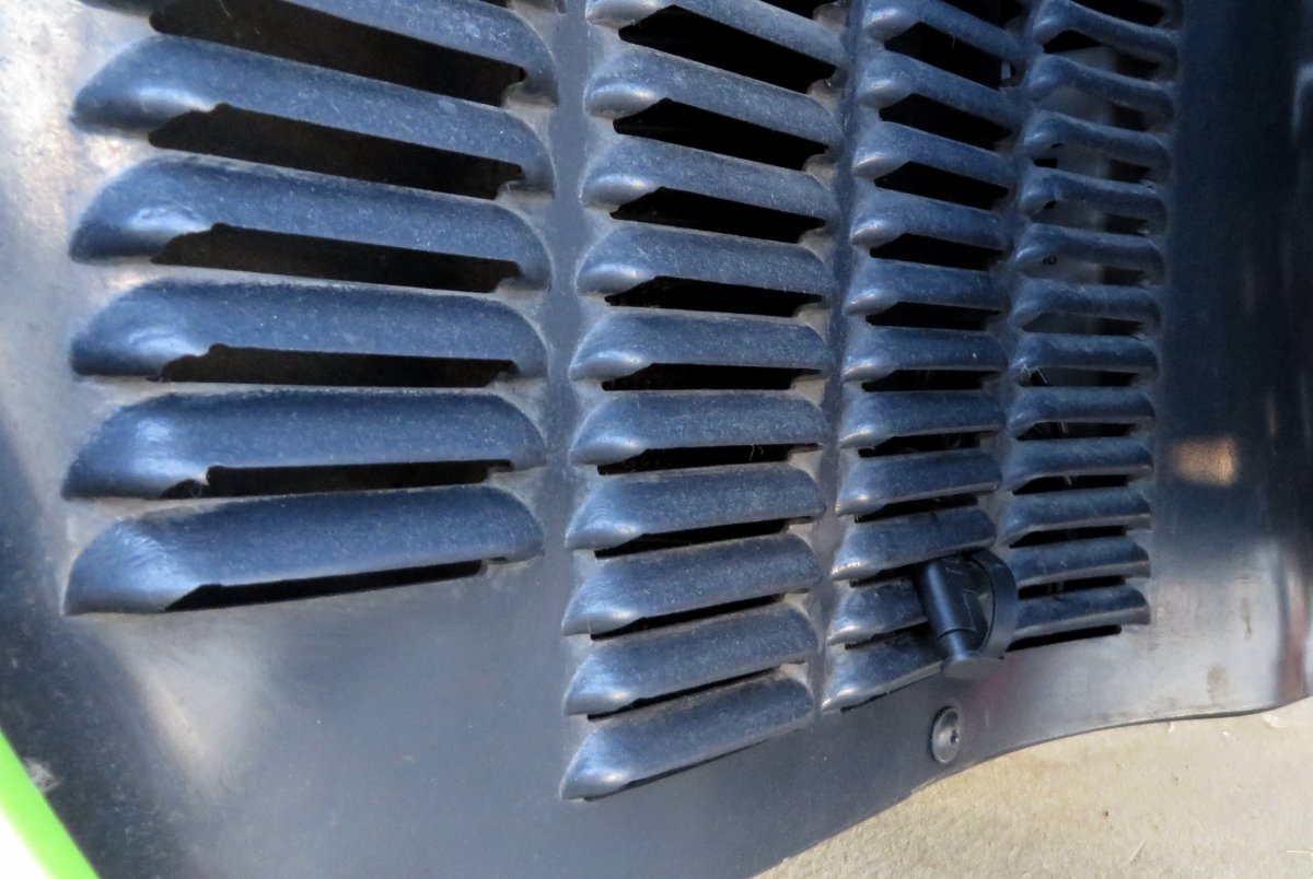

Here is where I jacked and supported mine. I rose the front of the car before jacking, because with the front being so low I wasn't sure if it would hit or not. I would also suggest the long stud guides to go into at least a couple of the wheel bolt holes before removing the wheel, otherwise you may scratch the inner wheel (especially true with CCB, I have approx 1/4 inch clearance on mine). The long studs help because of the weight too. As shown in the photo my first change was without the long studs using a board to support the wheel. Plus if you like a trickle charger port in the wheel well area you could do that too.

The dealer uses similar tools and your wood solution is clever but very height specific.
Yup you got that right, I was pretty much rookie on my first Murci battery change so I got 4 of these ready for next time.  Just make sure you get the thread correct. Nice video you posted too, of course they are useful in removing the wheel as well...but I am sure that's understood.
