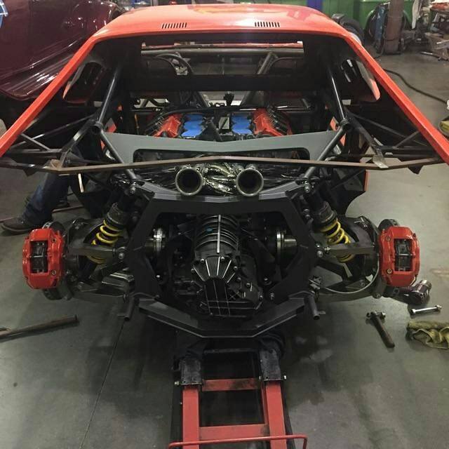

Twicebaked Report post Posted July 8, 2015 Ted's Rod Shop is really flying on the build loads of new photos on https://instagram.com/lp420svm/ Seat mounts are in so now the floor goes on. Motor is ready to put back in. Suspensions are done Wheels and tires are set to go They had to make new seat mounts and safety belt mounts, the ones the first builder made were not in any way shape or form safe. Steering is in, we used a Audi / Gallardo / VW steering column that works as it should! The rack is a an adjustable power steering set up for racing. No issues there. Restomod Air unit is on the way! Have a L@@K https://instagram.com/lp420svm/ Quote Share this post Link to post Share on other sites More sharing options...

Twicebaked Report post Posted September 4, 2015 Update; Loads of new photos on https://instagram.com/lp420svm/ Eric and his team pulled the plug on making SEMA they just want it perfect. However, they are still jamming along at quite a pace I must say. Floors are in! Rims are 90% done Basic alignment done Shifter cable in Air con evap unit in Zada-Tech dash in Steering done Radiator in Frame all redone! Seat mounts in! Harness belt placement done Brake lines done Bumpers made Left to do... Seal in cockpit and belly pan Firewalls Final motor install (takes like 15 minutes) Drive by wire hooked up Pop up headlights Doors and windows Gas tank fab / plumbing Seat upholstery Carpet Dash fitment Final motor / trans wiring Cooling plumbing Sound deadening Wiring Body: Finish up new front end Louvers (will be clear molded) Make new rear clip So there is a mountain of work, could have made SEMA but I think eric is correct lets plan on May 2016 for first public outing. We plan on shaking it down before then / working the bugs out. New plan of debut; 2016 Silver State Classic enter in the Grand Sport Class where we will attempt to set the LP420 SVM as the fastest Urraco ever. Tech speed 165 MPH which is 16 mph faster than any Urraco to date. Apply for hot rod class at The Quail Motorsports gathering in August for debut No matter what the Stampede 2016 & Concorso September enter Silver State again this time in the Super Sport Class Tech Speed 180mph Vandenburg!!!!!! SEMA... Quote Share this post Link to post Share on other sites More sharing options...
Surpassing_The_Heavens Report post Posted September 22, 2015 The updated Urraco wheels look nice, especially the polished look to them. I was going to ask if they were custom made, but with a second look they definitely don't look stock. The front and rear offset is keen too. Are the headers equal length? Do you have anymore photos of them? The routing looks funny. Almost like some of the exhaust is dumping from the middle of the V. Ohh, and I'm really keen on the trans case's contrast between the case and ribbs/supports. Black and polished is cool. I think old cars need more polish of shiny metal, it's what helps give that old car feel. Why is the interior being fabbed instead of using the pre-existing interior? I think I'm missing something. Quote Share this post Link to post Share on other sites More sharing options...
Twicebaked Report post Posted September 23, 2015 Thank you for the kind words, Rims are made one off custom by OMF Performance Products in Corona California. They will be finished to look like cast alloy rims of the original Compangolno rims. Headers are equal length "bundle of snakes crossover headers" We have tones of photos off the build and headers I will post some. Danny Huseman did the headers and intake he is an automotive engineer by training and a race team car fabricator by trade. His design and welding are works of art. Interior was all burned up it needed to be all redone. BUT we decided to bring the car to the here and now not 40 years ago. The seats will be heated and air cooled but covered to look like the original. The original dash and gauges went to Japan to help bring a car back to life. BY the way.. This last weekend I successfully raced in the Silver State Classic in the 120 / tech speed 140 mile an hour class. took Second Place. So in MAY 2016 we hope to have the Urraco ready for the 150 / 164 tech speed mile an hour class. Will try and hit the trap at 162 MPH making this the fastest Urraco ever. Quote Share this post Link to post Share on other sites More sharing options...
