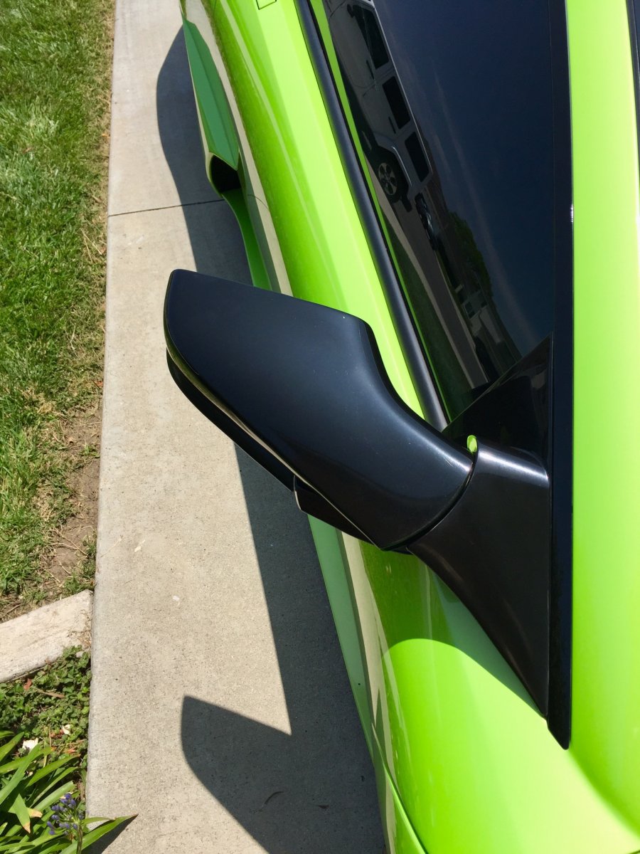

Seems my day finally arrived where the passenger mirror no longer moves. Months of slight coaxing while working the switch was working pretty well, but as you can see now stuck in the middle position. It doesn’t even make a grunt/gear noise anymore, although driver side works fine so I figure no fuse blew. If I could just get it to open all the way then I would just leave it like that in the fully open position but no luck...ugh!
Mine are stuck in the open position but they stick out so much vey are very vulnerable so I think I will make the repair soon.
Good idea to fix it. I am taking mine in tomorrow for rebuild on the passenger side. Seems there are some downsides with the brass gear unit and the plastic too, so just doing plastic. I figure if it lasted 10 years already then I may get 10 more out of a rebuild.  You are right, they stick out way too far to keep extended all the time. I already accidentally bumped into my drivers side mirror by leaving them out, but seems ok.
