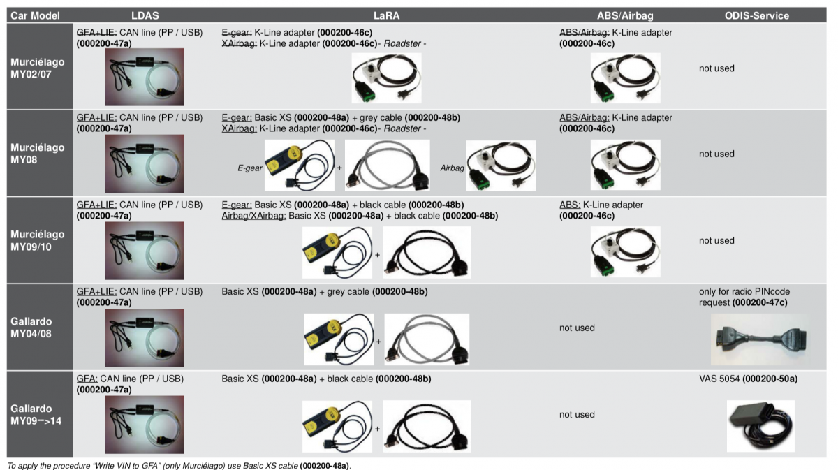

So that will only work on LP murcielagos? From this diagram it seems pre LP Murcis (and possibly 07 LP640?) need a K-Line adapter instead?
All OBDII
Murcielago 2002 - 2006 Coupe and Roadster
Murcielago 2007 - 2009 LP640 Coupe and Roadster
Murcielago 2008 Revention
Murcielago 2010 LP640
Murcielago 2010 LP670 SV
Different Cable
Gallardo 2004 - 2008 Coupe and Spyder
9 hours ago, Old Guy Garage said:
All OBDII
Different Cable

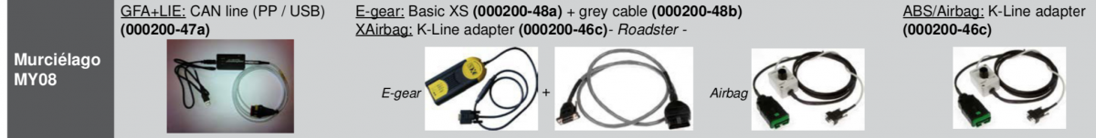

That doesn't seem to match what I posted above. Note the black/grey cable. For example 08 Murci and 04-08 Gallardo are Grey Cable, while 09/10 Murci and 0-14 Gallardo are black cable and 02-07 need K-Line adapter. From which I understand has a switch that toggles between airbag and abs and should be set on airbag setting for e-gear operations.
The only ones I can have duplicated are as I posted above in my previous post, no others.  I understand that the same Murci cable 00200-48B works across the entire platform, if not then 08 MY and up on Murci. If others could chime in, perhaps we can get a definitive answer. I will test in on a pre 07 in the next 3-4 weeks.
To use Lare you need cables as I list.
First Gen Gallardo's Basic XS and Grey cable.
Second Gen Gallardo's Basic XS and Black cable.
04-07 Murci ABS/AIR BAG Kline cable.
08 Murci Basic XS and Grey cable.
09-10 Murci Basic XS and Black cable.
First Gen Gallardo's use Lara and LDAS for diagnostics.
Gen 2 Gallardo's  use Lara only.
02/03 Murci use LDAS and AIR BAG and ABS software.
04-10  Murci use LDAS, LARA, AIR BAG and ABS software.
As far as different software I will list.
LDAS which uses a LDAS cable and dose not plug into OBD port.
LARA which dose plug into OBD port.
AIR BAG program which plugs into OBD port.
ABS program which plugs into OBD port.
ODIS is used on Aventador, Huracan and Urus and is used to get radio codes for both Gen 1 & 2 Gallardo's, it uses a different cable (5054 head cable) that plugs into OBD port. Note Gen 1 Gallardo's will also need the OBD adaptor plug you see in one of the pics above for radio code.

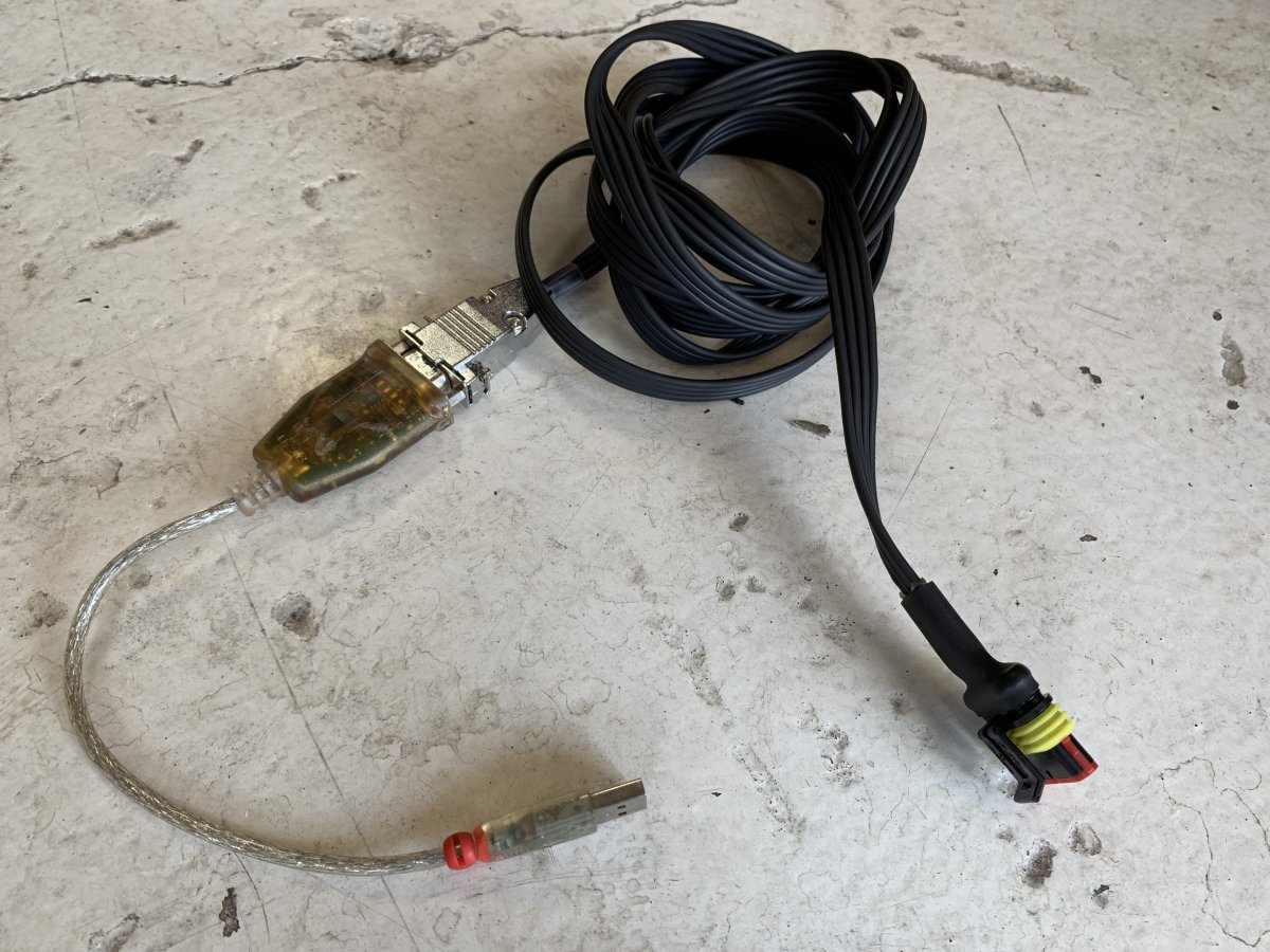

Is this the cable for LDAS that connects to the connector in the fuse panel area in the passenger footwell? Or does it connect somewhere else?
That software works.
Answered my own question on the cable above, it works with LDAS to talk to ECU’s.

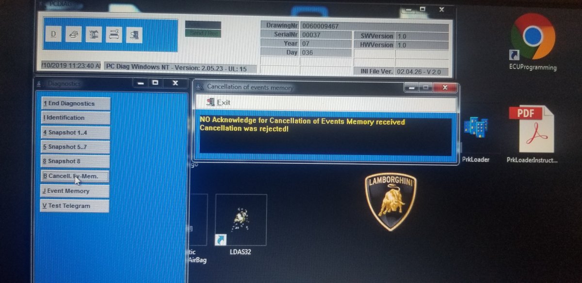

Another question for JeffLambo: What’s the procedure to clear the airbag code with the Airbag software? We are talking to the airbag module, but can’t find the instructions on how you use the software to clear the light. That software seems pretty cryptic.
