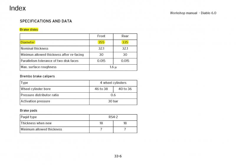

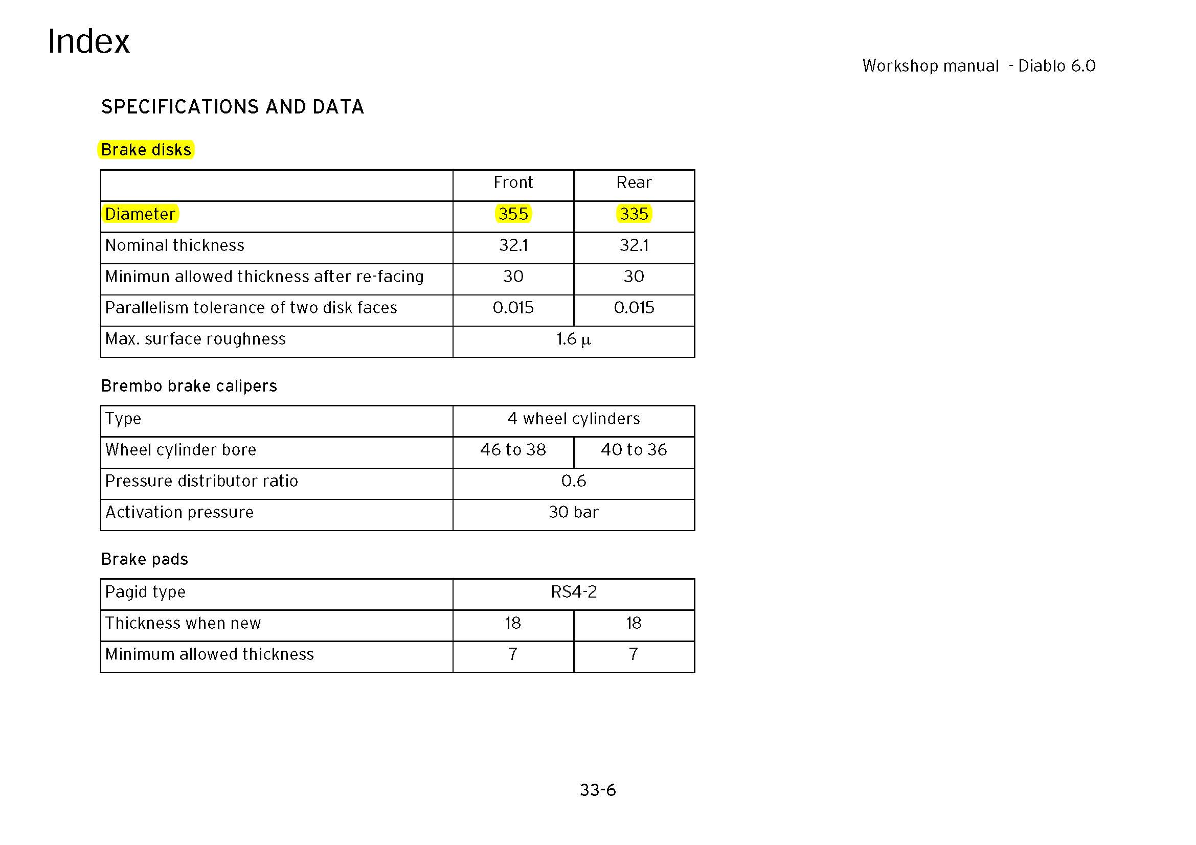

I have seen conflicting information regarding the brakes on the 6.0..namely:
-Whether they are different then late SV
-Whether they are 365mm or 355mm

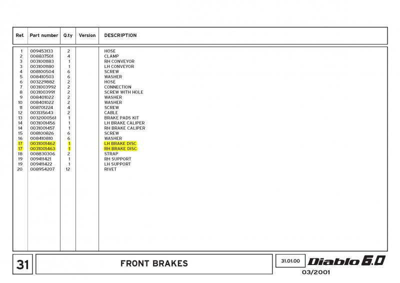

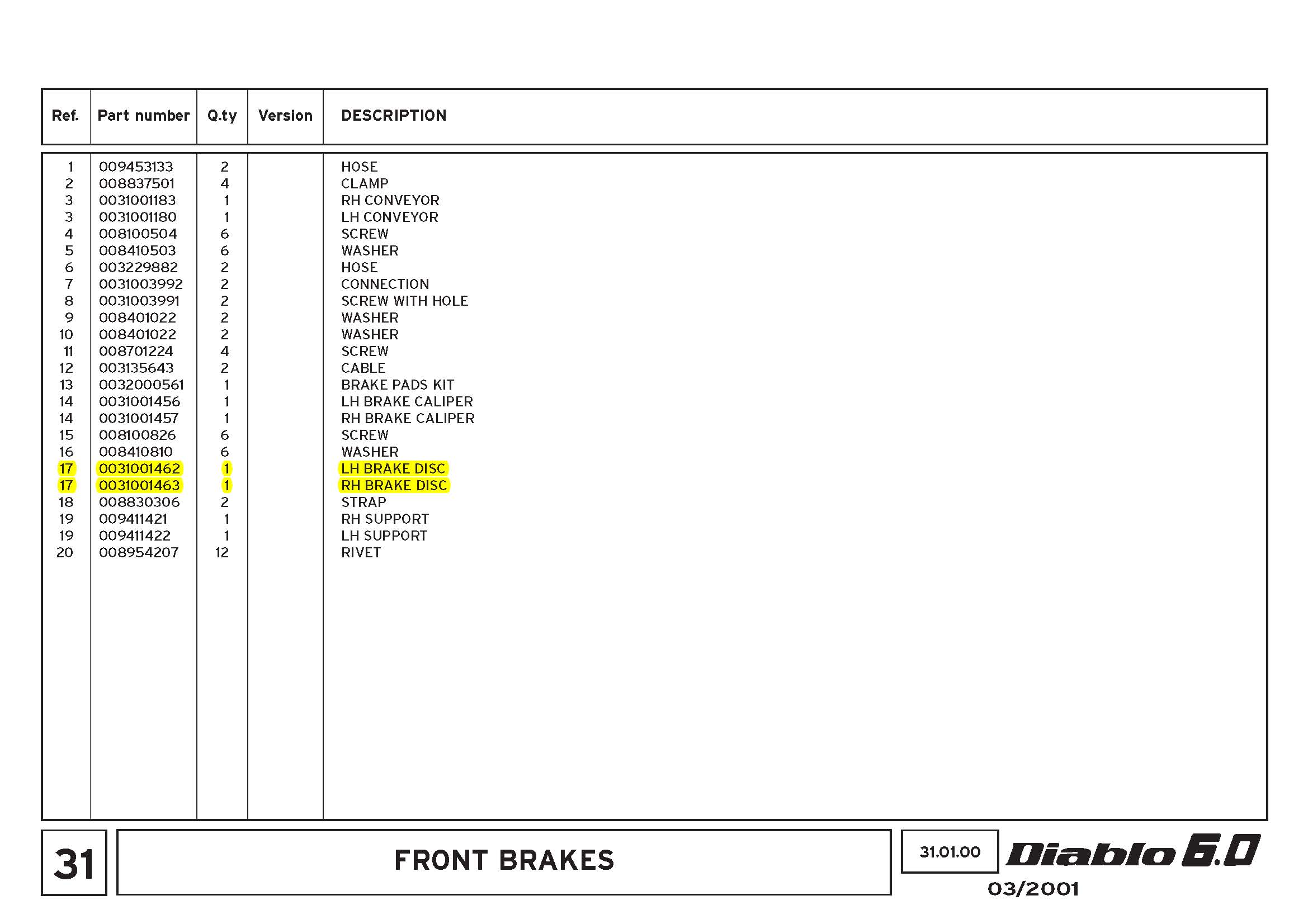

Digging through the parts manual (0031016759), it seems that:
The PN matches both the late SV, GT, and early Murci
- No direct mention of the size, so I am likely going to measure myself when I get a hold of a set.
The size is important as if they are 355, they likely can be replaced directly from Brembo using their aftermarket GT kit parts for a fraction of the cost.

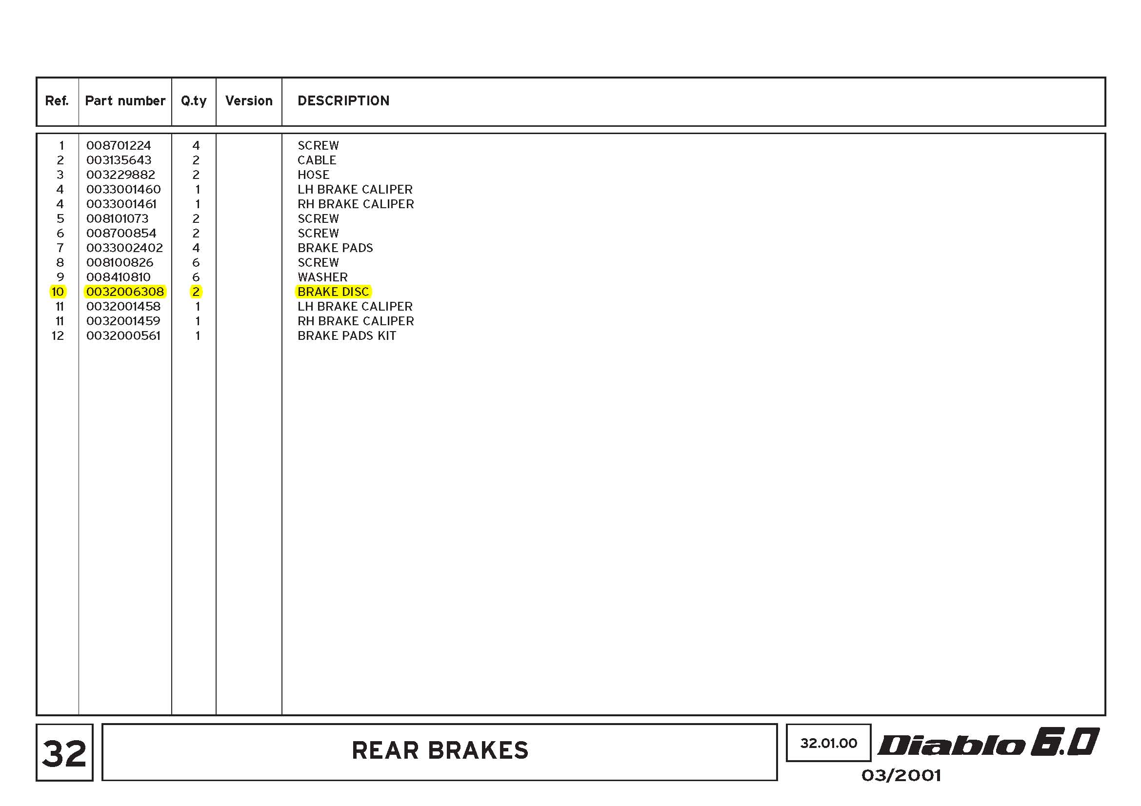

Checking PNs, it seems the rear brakes ALSO cross over with the same set of cars for EURO cars (late SV, GT, and early Murci...0032016285)...but US cars the PN is 0032006308....hmm
Also, does anyone have the generic Brembo PN for the front/rear brake pads? Thanks
They are 355mm, same as the early Murci.

Are they 355x32mm or 355x34mm? I think their aftermarket GT kits only came in 32mm for that size.

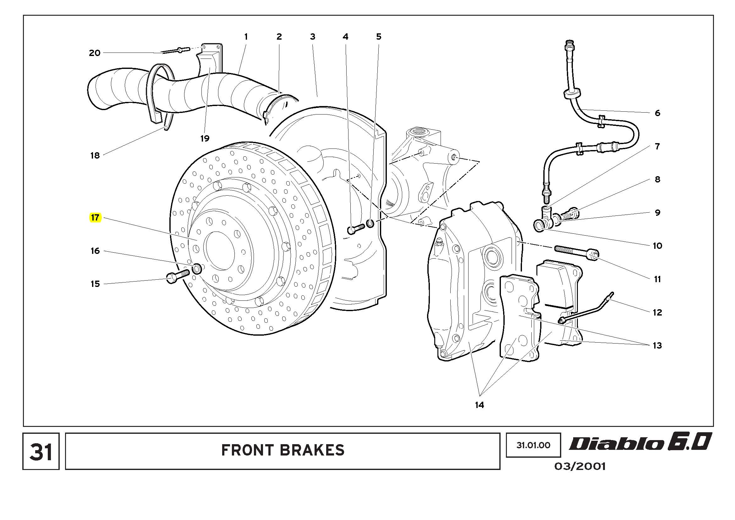

I have a std 6.0 ... which appears to have the 355mm front rotors. These come in two pieces, floating disc and the hat. All I want to do is replace the floating discs - surely it can't be hard to find a replacement hat to fit these. Isn't that what they were originally designed for?

Also - does anyone have the exact part number for a 6.0 Brembo 355mm floating rotor?.

What I'm trying to find out is the Brembo part number for the replacement rotors. I don't want to change the hats, they're fine ...
These were designed to just replace the discs ... so surely that should be quite easy. I see lots of 355x32mm discs ... but don't know if they will fit.
Are these brembo rotor discs used on any other car? Surely we can just order the discs if we have the part number.

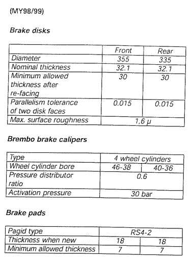

sorry a little late to this..
MY98/99 car disc info.. (same as 6.0 above)
