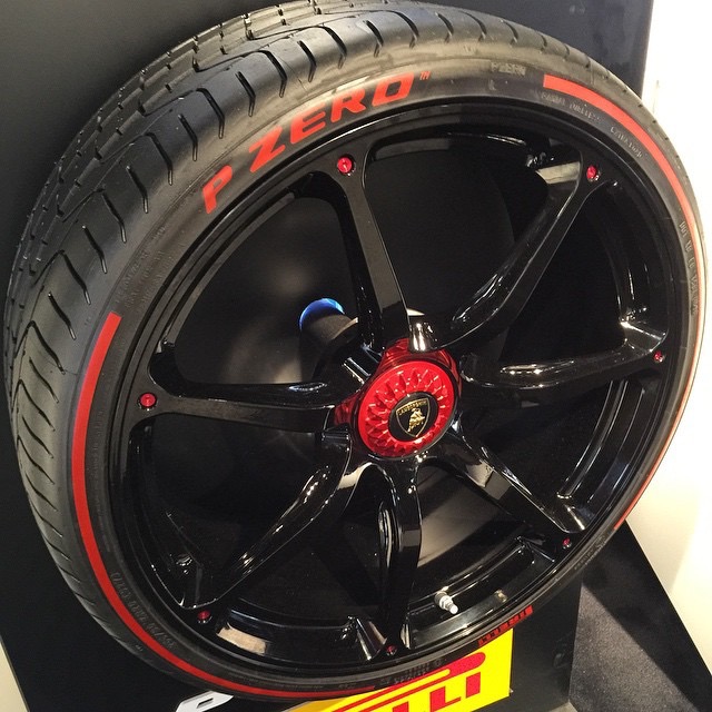

LamboCARS Report post Posted July 1, 2015 The 7 Razze wheel looks just like the wheels on the Veneno but without the outer ring: Quote Share this post Link to post Share on other sites More sharing options...
