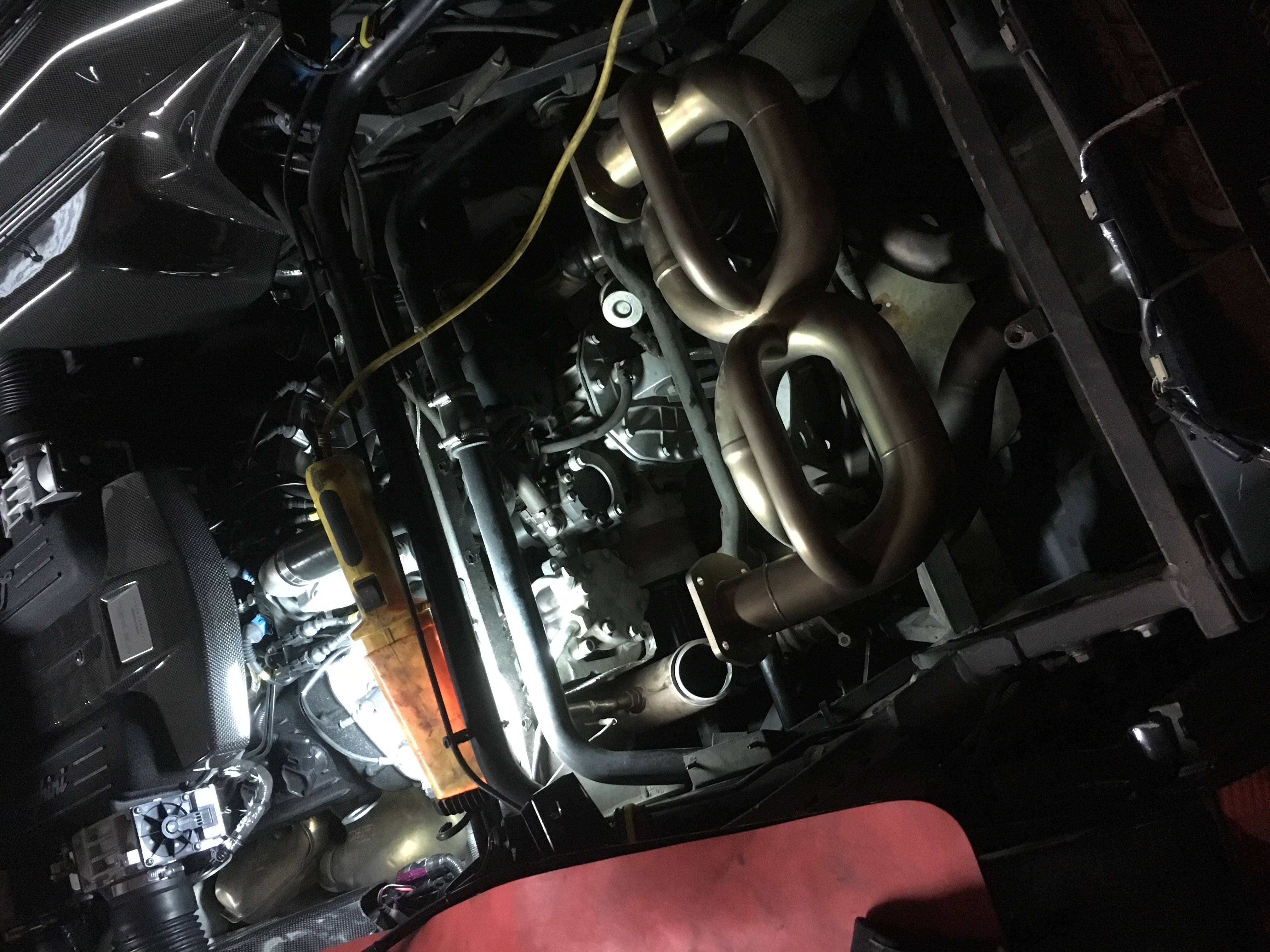

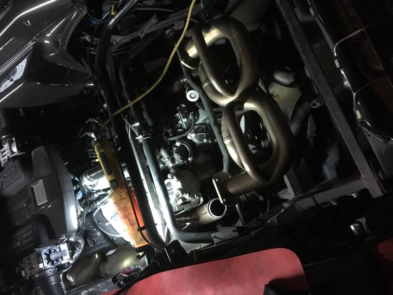

So I received my secondary cat deletes today from Fabspeed. Started my little project at 10:00 pm. Let's see how long it takes to get these kitties out. I just hope I don't regret scrapping the primaries later because it's a pain in the butt to do it again. Here's my progress so far 1.5 hrs and 3 beers into my mission. My goal is to wake up my wife by 2:00 am.
12:12 am, woke up the wife. Sounds waaaay nicer at idle. I had straight pipes on my 04 and it's definitely not as loud. Will really floor it tomorrow and see what she does. Btw, Fabspeed fitment and hardware is top notch!

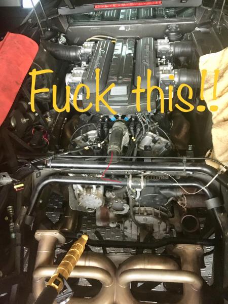

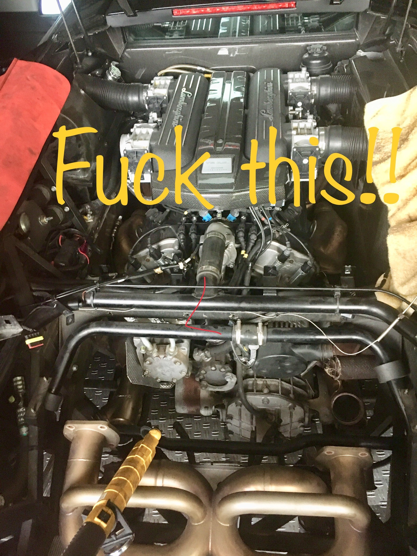

So it’s 2:00 am and I’m finally finished installing the primary deletes. My helpful advice is wait until you need an engine out clutch job or something. Holy crap that sucked. I ended up cutting the cats in pieces with a plasma cutter to get them out. Not sure how it works on the early murci, but on the lo640 it was an absolute pain in the ass! I turned it on briefly and on start up it so worth the headache. Tomorrow I’ll do some road testing
