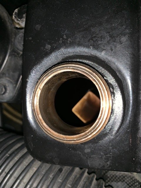

My 08 Murci LP640 has been running hot since I bought it in January. I'm seeing coolant temps of 100-105ish. My oil temp is normal at 120-130. I had dealership replace the coolant and it made no difference. Accessory drive belt was also replaced as it was original and due for a change also. I also replaced the expansion tank cap even though there didn't seem to be an issue with it. I've ordered a new thermostat but it won't be here for another 2 weeks. I was concerned I possibly had a combustion leak so I performed a chemical check for co2 in the coolant system and it came back clear and also sent in an oil sample for analysis and there is no coolant in the oil, so at least that was good. I noticed some sediment on top of the expansion tank fill level mark. I'm wondering if anyone else has had this issue and how they fixed it? At this point I'm thinking either the thermostat is bad or my cooling system/radiators needs to be thoroughly flushed/cleaned. Blasting the heat in the car brings it back down to normal temp ~90c.
I can't really see the sediment in those pics. Can you describe that sediment a little more? Do you think someone could have added a stop leak product? If so, depending on what they added, and how much, they could have semi-clogged one or both of the radiators. Don't put it past someone selling a used car to drop some of that in instead of fixing a small leak.

I just meant the brown stuff on top of the metal tab, not sure if that's normal. I've read that G12 + Redline Water Wetter can create some sort of brown build up so that was one thing I was thinking. I'm at 19,500 miles. Fans seem strong and nothing blocking the radiators.
