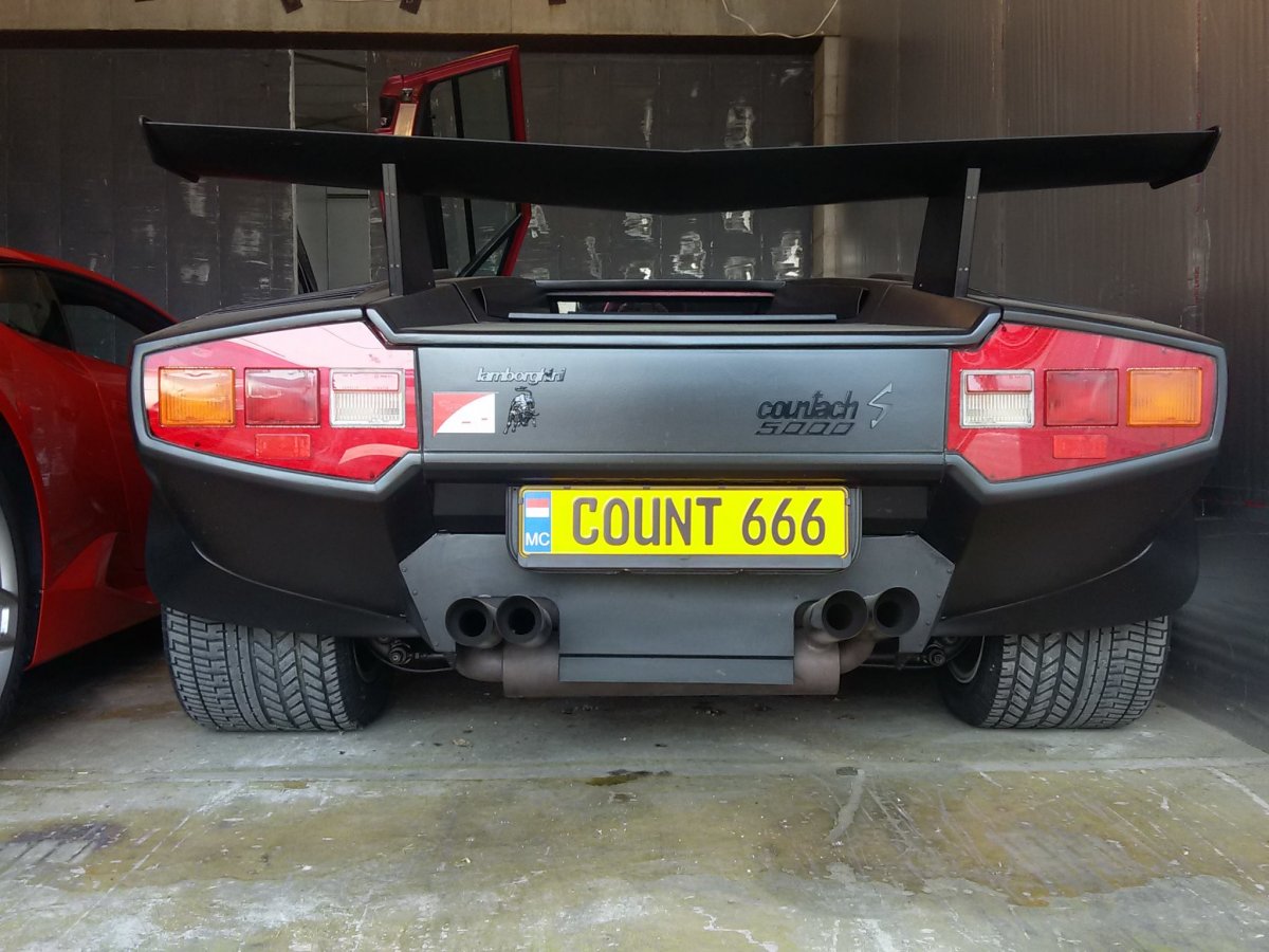

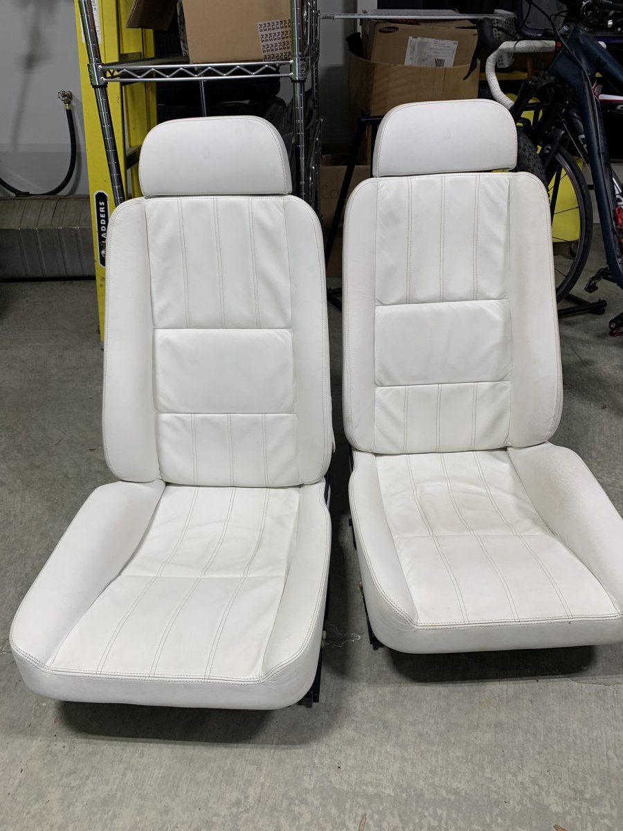

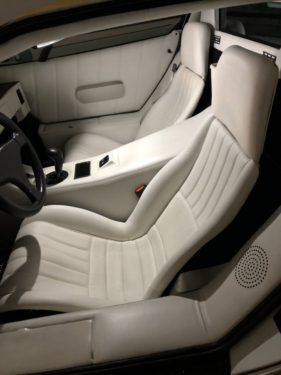

Please talk a bit about the seats in your 25th Ryan.
They are race seats if I remember correctly ?
I thought they were more comfortable than the factory seats.
On a side note, I saw his QV prior to it’s purchase. I thought it was a very  honest (unmolested) car.  During his ownership Rhyno has show a lot of love ($$$) to this QV to make it a great car.
The picture of the seats on the ground are the factory power seats that come in almost all 25th cars. They are very narrow in the hips and shoulders and very uncomfortable even though they have power adjustments.
The second picture is of the optional sport seats. I have heard they only made about 50 sets so they are very rare and hard to find. I don’t remember if I weighted them or not but they are vastly lighter then the power seats. They only have a manual forward and back function (no tilting). They are not as comfortable as the banana QV seats because they have less padding but they are 10x more comfortable than the power 25th seats. I’m 5’7” and weight 165 pounds and the sport seats fit me very well, they hug my body in all the right spots. You could be 6’ and 200 pounds and you would still fit well in them.
12097 you can let the OP know what you thought of them as you did get to sit in them for a short amount of time.
