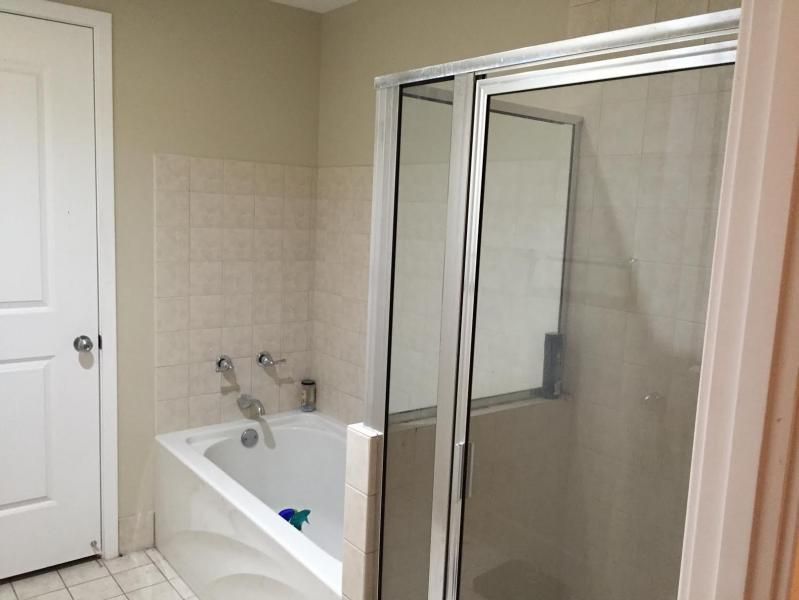

sprite Report post Posted October 14, 2014 I'm thinking I want to get rid of the tub and make the whole space the shower. Something with dual shower heads, steam a little bench and possibly a TV built into the wall, but not really sure how to even go about it? Do I need a plumber, a contractor or architect? I've never done any remodeling so no idea about the scope of what I want to do and how to go about it. Quote Share this post Link to post Share on other sites More sharing options...
Assman Report post Posted October 14, 2014 You need a general contractor. He will subcontract all the work like the plumbing, electrical, etc. Quote Share this post Link to post Share on other sites More sharing options...

emanon Report post Posted October 15, 2014 Is this a house or condo? You have access to the space above the ceiling? Your biggest unknown is plumbing feeds, multi-head showers need big pipes. Or like fortis, a fire hose. Other than that it's a cake job for a decent plumber and tile guy. GC is a little overkill imo, but it's insurance in that one guy is responsible for it not being a clusterfuck. On the remodel scale, this is an advanced DIY job, don't overthink it. Quote Share this post Link to post Share on other sites More sharing options...

sprite Report post Posted October 15, 2014 Is this a house or condo? You have access to the space above the ceiling? Your biggest unknown is plumbing feeds, multi-head showers need big pipes. Or like fortis, a fire hose. Other than that it's a cake job for a decent plumber and tile guy. GC is a little overkill imo, but it's insurance in that one guy is responsible for it not being a clusterfuck. On the remodel scale, this is an advanced DIY job, don't overthink it. It's a condo, so I'm guessing that will complicate things. It's just something I'm considering, but not sure if it's worth the hassle, might just try to grab a penthouse or move to a newer building instead of starting to remodel. I just don't like the shower cause it's small and I never use the bathtub (I also have a bathtub/shower combo in the guest bathroom, so I don't see a need for one in the main bath). I think the ceilings have around a foot of space that I have access to where the AC ducts and sprinklers run. Quote Share this post Link to post Share on other sites More sharing options...
emanon Report post Posted October 15, 2014 It's a condo, so I'm guessing that will complicate things. It's just something I'm considering, but not sure if it's worth the hassle, might just try to grab a penthouse or move to a newer building instead of starting to remodel. I just don't like the shower cause it's small and I never use the bathtub (I also have a bathtub/shower combo in the guest bathroom, so I don't see a need for one in the main bath). I think the ceilings have around a foot of space that I have access to where the AC ducts and sprinklers run. This is one of those things that will undoubtedly add value, but the "while we're in there" could turn into a $35k bathroom. Steam generators are cool but pretty spendy and take up a decent amount of space. Moisture control will be a big (expensive) headache. I do like the linear slot/trench drain idea eddie mentioned, they look super clean. If you need one you can drive a truck over i'm your man Quote Share this post Link to post Share on other sites More sharing options...
capt_chaos Report post Posted October 15, 2014 With it being a condo you will have problems if you go for the "curbless shower" or as we call them wet room floor because you have to feature the water runaway and that would mean strengthening the floor and/or raising it. Tricky in a condo. You could go for a larger built in shower with tray etc and that will be the path of least resistance, adding in a TV will be the challenge. Quote Share this post Link to post Share on other sites More sharing options...
sprite Report post Posted October 16, 2014 With it being a condo you will have problems if you go for the "curbless shower" or as we call them wet room floor because you have to feature the water runaway and that would mean strengthening the floor and/or raising it. Tricky in a condo. You could go for a larger built in shower with tray etc and that will be the path of least resistance, adding in a TV will be the challenge. Thanks. I think if I do anything that will be the way to go. Quote Share this post Link to post Share on other sites More sharing options...
