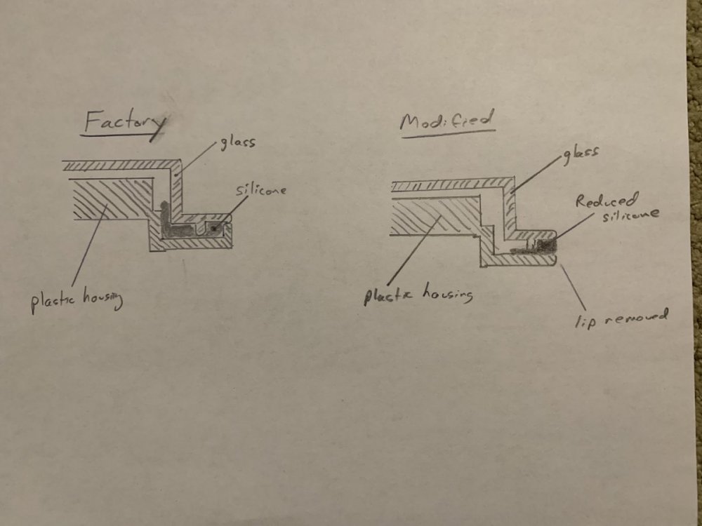

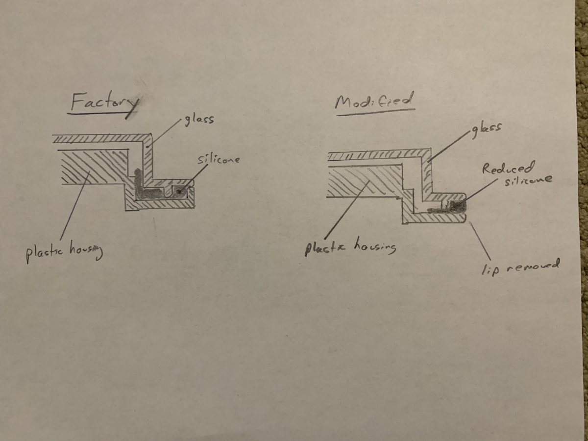

Here's a drawing of the before and after cross sections.
You can see how hard it is to get a blade around the original design, which is why I cut the lip off.  And you just don't need that much silicone to hold this glass down. Even if you didn't glue the glass down at all, it couldn't go anywhere once installed in the car. It sits on top of the plastic housing with nowhere to go but up, and when installed, the body of the car is keeping it from being able to go up.
I am confident there's no way the glass will come loose with the amount of silicone I used to attach it back on, but with the modifications, it will be very easy to cut it open in the future.

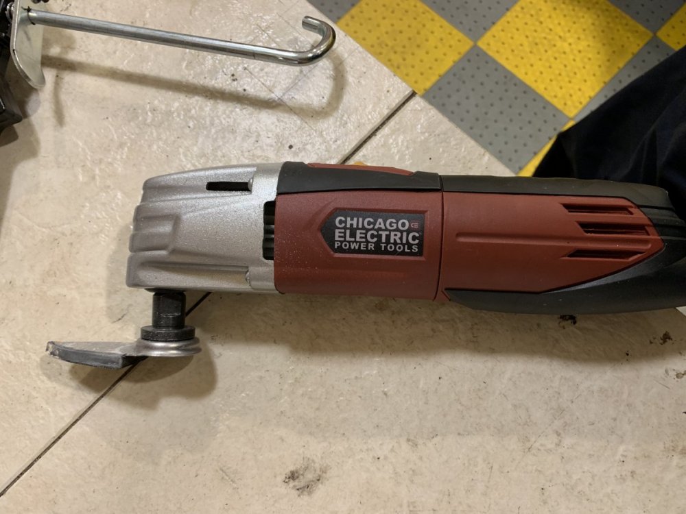

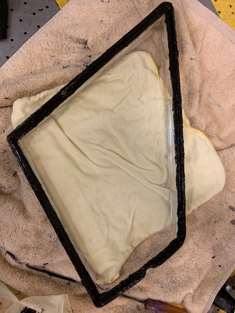

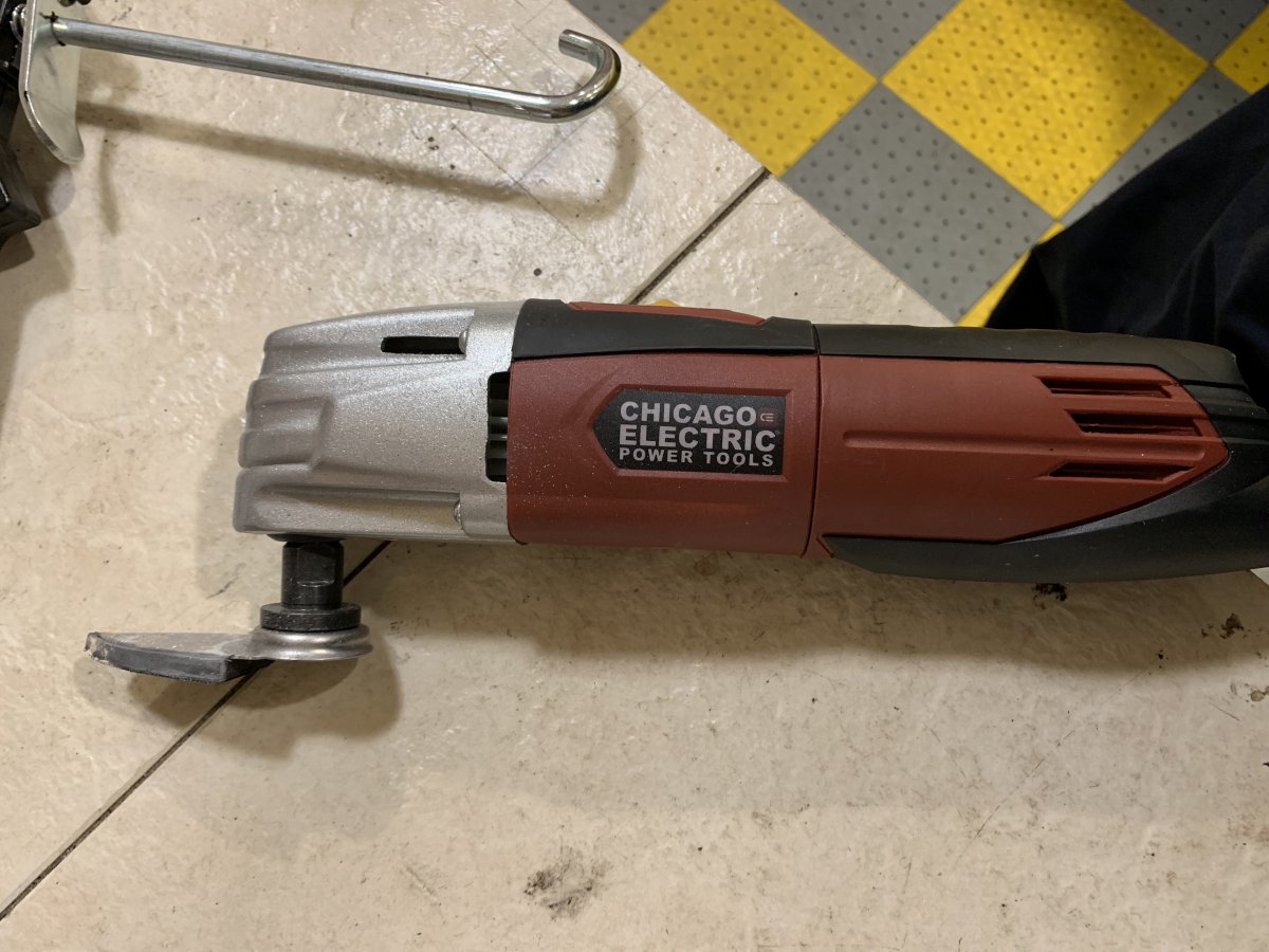

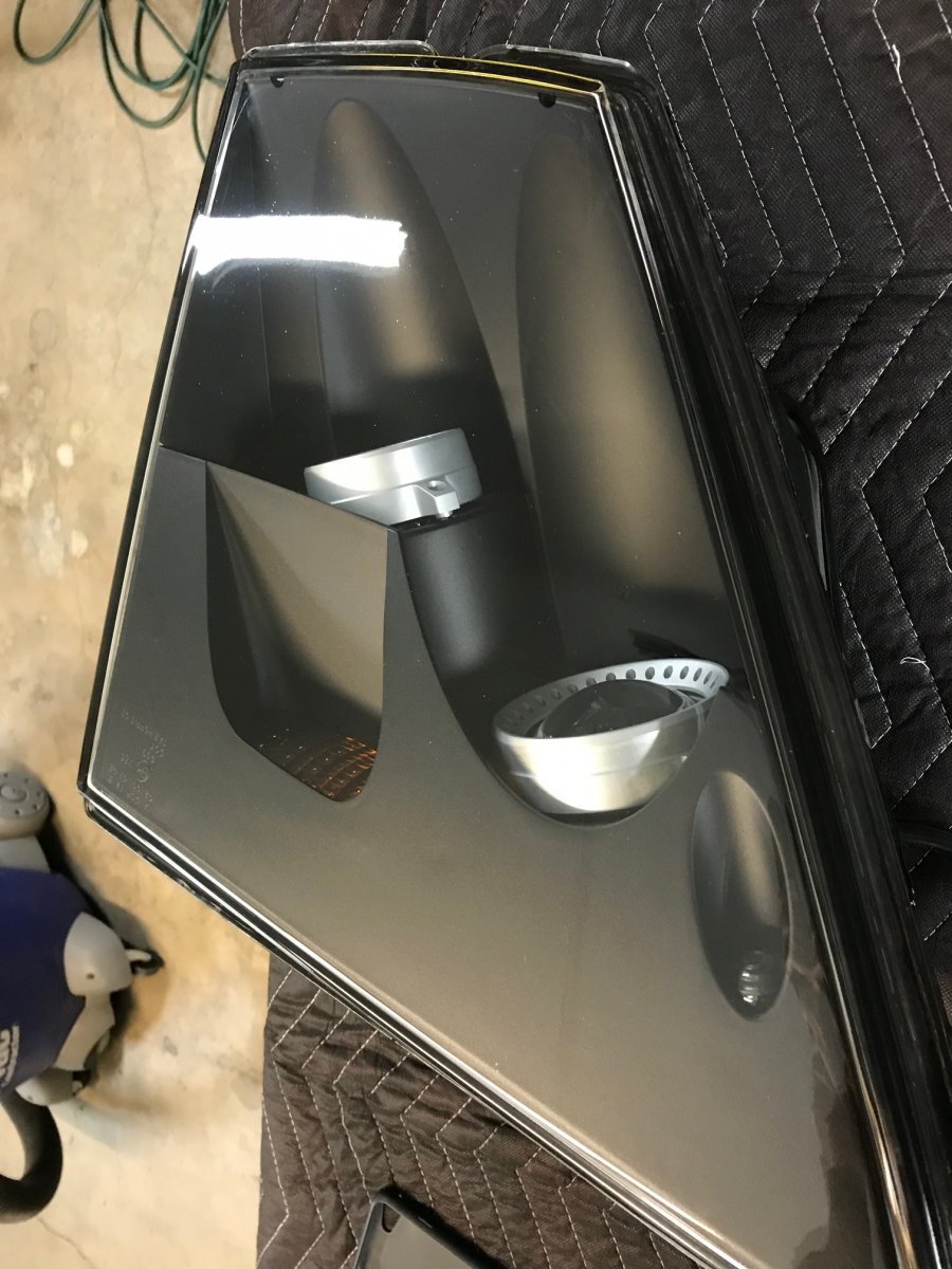

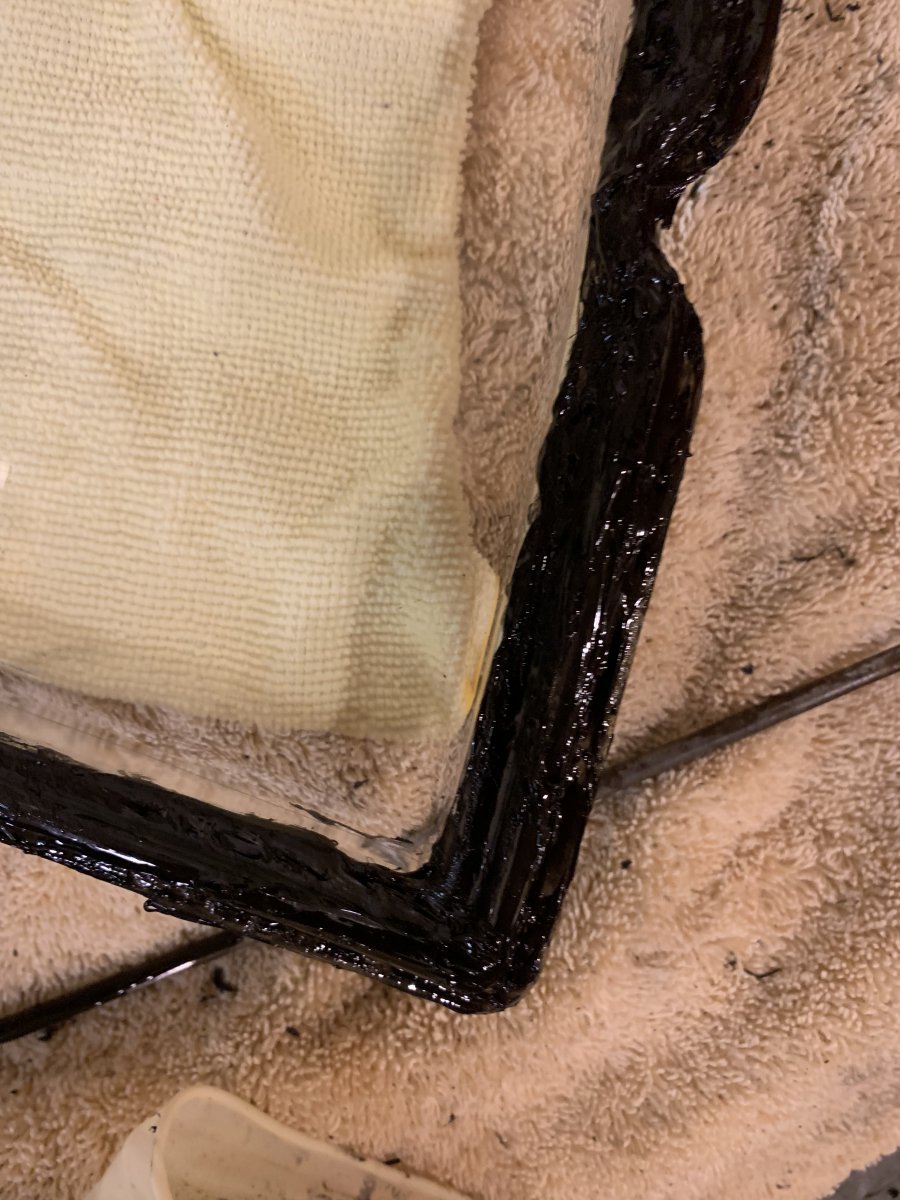

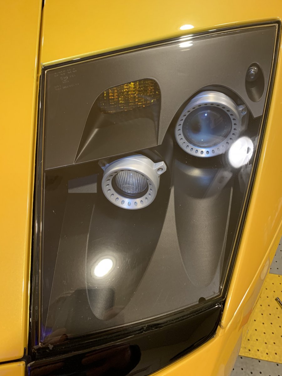

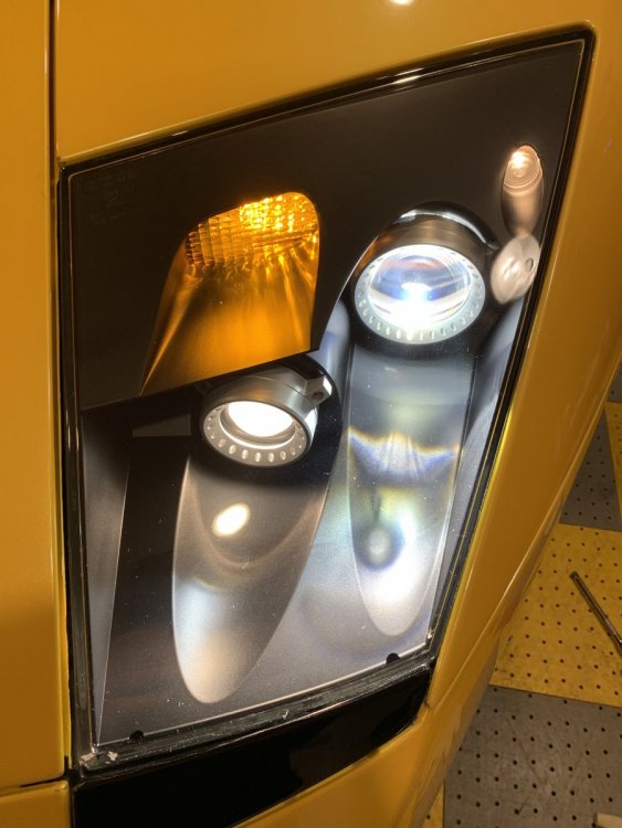

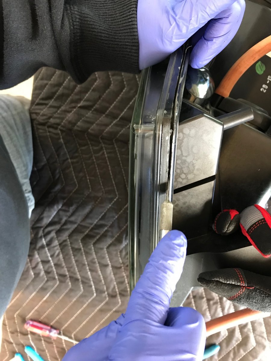

I just completed the opening and cleaning of the headlights and very pleased with the results.
First, I want to thank Stimpy for the tutorials.  It made the job a lot easier.  I really appreciate the thoroughness.

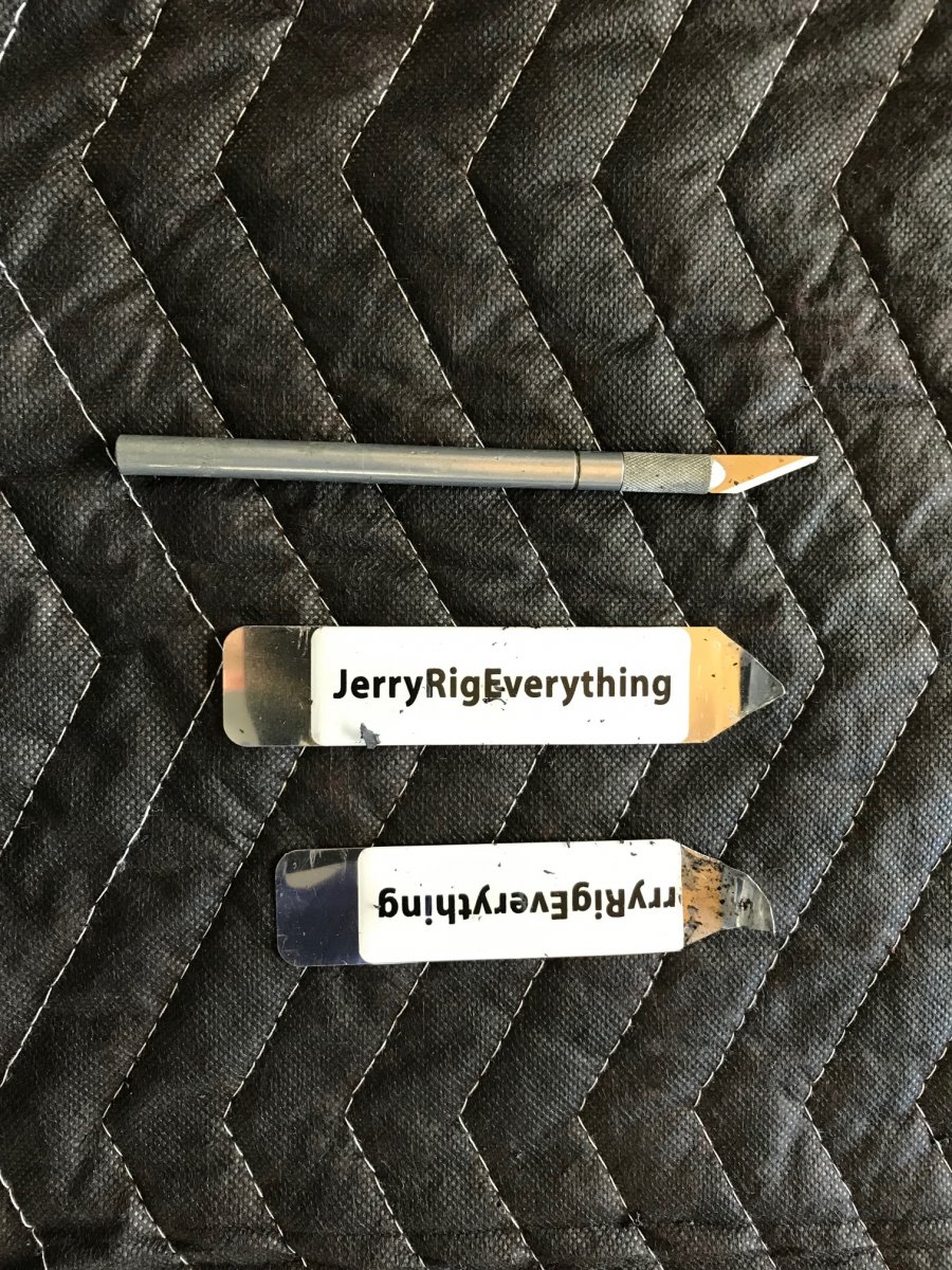

The tools I used were Dremel, an Xacto knife, 1 spudger that is trimmed short and wide, and 1 spudger that is trimmed long and narrow, 8 wide tip flat head screwdrivers.  I also had the trim plier but didn’t need to use it.

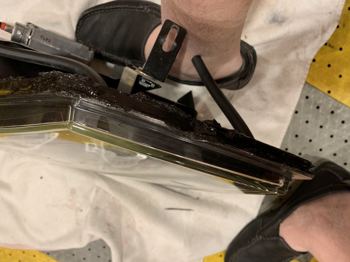

Before cutting the plastic off the housing, I tried to remove the factory urethane by inserting different type of tools, but it was impossible to get very far.  Therefore, I went ahead with the plastic cutting.  The most worrisome part for me was the cutting off the plastic.  It was difficult because I couldn’t see how deep and low to make the first cut since there is no color variation between the layers.  Even though Stimpy said that the glass is very thick and durable, I was extra careful not to damage it and went very slowly.  I cut bit by bit to expose 1 corner.  The first layer is the plastic.  The second layer is the urethane.  After that, it is the glass.  The overall thickness that I had to cut through was 5/32” to get to the glass.  Also, I started the cut at ¾ down on the plastic rim with the glass facing up.  BTW, Stimpy is absolutely right that the glass is very tough and wouldn’t get damaged.  After the first corner was exposed, it was easy to cut the rest since now I could see through the cross sections and knew what I had to deal with.
After removing the plastic surround, I used the Xacto knife to cut through the factory urethane on the top edge of the remaining plastic.  Then I used the wide spudger to make the next cut.  Finally, I used the narrow and long spudger to make the final cut.  If you use the narrow spudger right away, it would deform and not cut through all the layers.  That was why I went step-by-step.  By using these 3 different cutting tools, I did not have to recut the spudgers.  They lasted through the entire process.
After the cutting of the urethane, the glass became loose.  I then inserted the screwdrivers as shims and the glass lifted off.
The cleaning and reassemble process were easy, and the results are new looking lights.

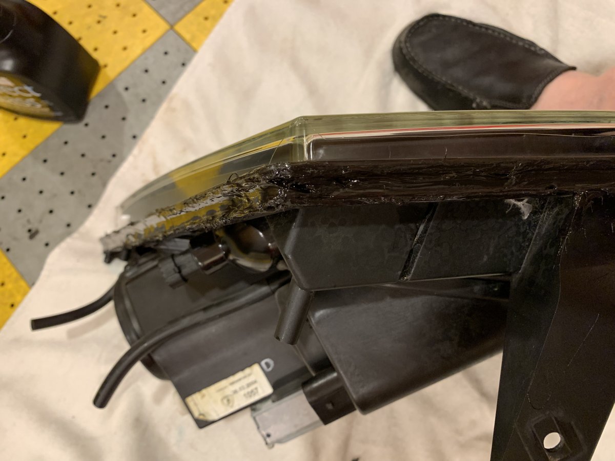

Notes:  1 of the light had way more urethane that oozed all the way up the housing and difficult to cut through than the other.
After the repair, if you didn’t know what the lights look like originally, you would think that the lights came from the factory without the plastic edge if you ran a good silicone line in the channel.
Even though the original adhesive was urethane, it is better to use silicone to do the resealing.  Silicone is strong enough yet allows for easier removal next time.  I tested its bonding strength after drying by putting a suction cup on the glass and lifting up the entire light assembly.  It held on well without any issue for 10 minutes.
Be prepared to withstand physical pain when using the spudgers.  I even drew some blood when it slipped and cut through my glove.
Be extra patient.  You will need an entire day to do this project plus drying time.
