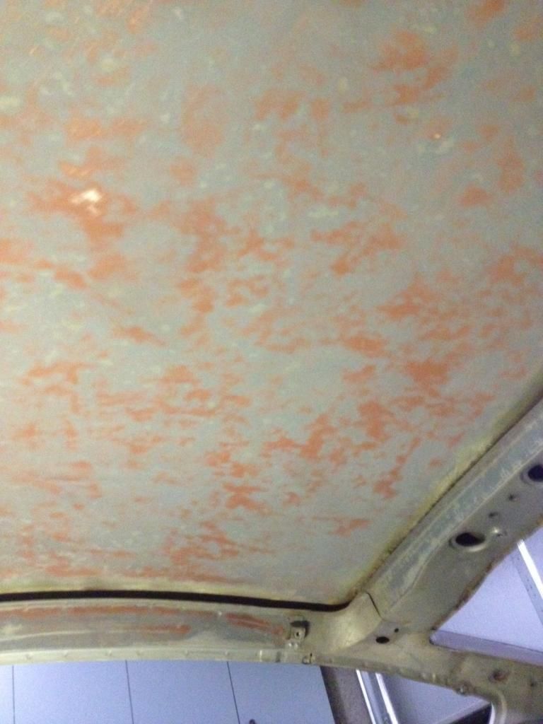

so much of the old school interior was simply held on with spray adhesive and vinyl. this makes for a headache trying to scrub all this crap off… here's a shot of the roof panel from the inside:
240D25CF-2D28-402A-A45E-FD4ECE8B7E5C_zps
