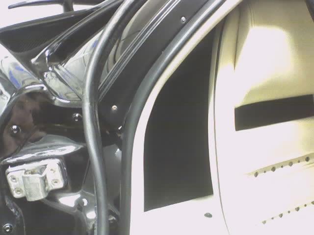

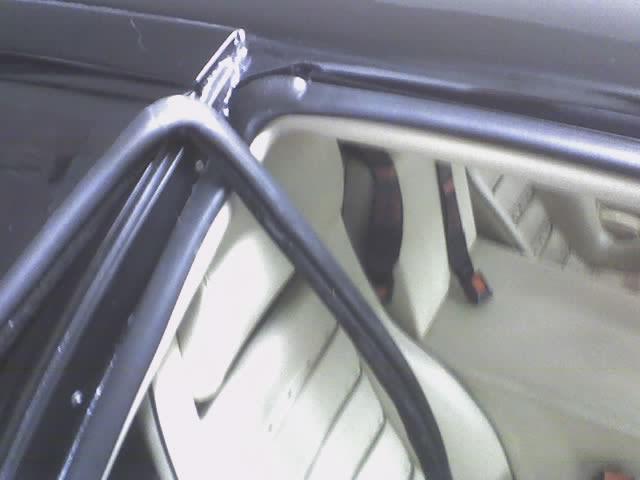

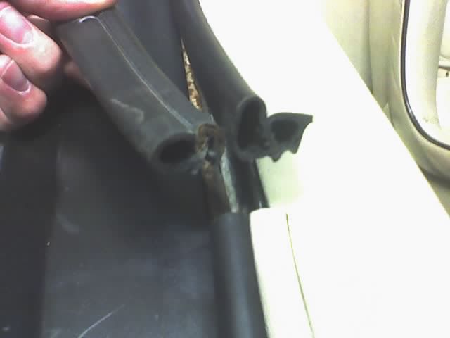

My 91 Diablo is black with snowcorn interior. For the door weatherstrips (the ones that run the entire circumference of the door opening) I used some Toyota weatherstrips. Pn#s 62311-48050-A0 and 62312-48050-A0. They required minimal trimming and are a close interior color match for snowcorn (beige). They are only $67 per door.

No kidding?! Can you put up some pics?
Not the best pictures, but you can see how similar they are. The obvious difference is the Toyota weatherstrip has a colored strip running down the side of it. It does make for a nice contrast.
