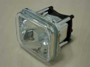

Any reference to the 4 front fog lights? Or anyone know of something similar?
A previous owner replaced those on my car with small projector type, but Id like the old style back.
Thanks, but that's why I asked for a cross reference or something similar $1000 for lights is just madness!

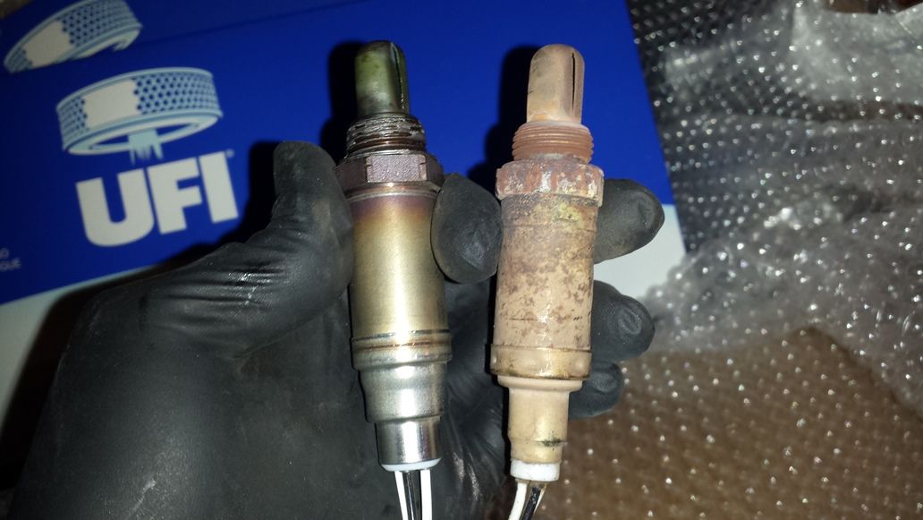

02 Sensors on an 01 6.0 - Bosch # 0258003032
I spent some time searching for Bosch 0.258.003032 and everything seems to now point toward Bosch 13032 ... including THIS thread.
Thanks to Glen at http://www.exoticwholesaleparts.com/ for hooking me up with an amazing deal!
Here is what came out of my Diablo 6.0 and the replacement Bosch 13032.

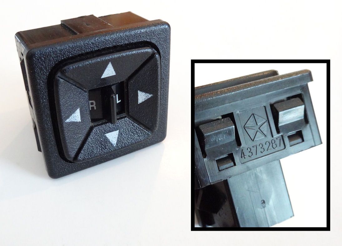

Good find! I am just finishing up the Murcie struts on my 91 and actually popped those out but didn't notice the Chrysler sign.
