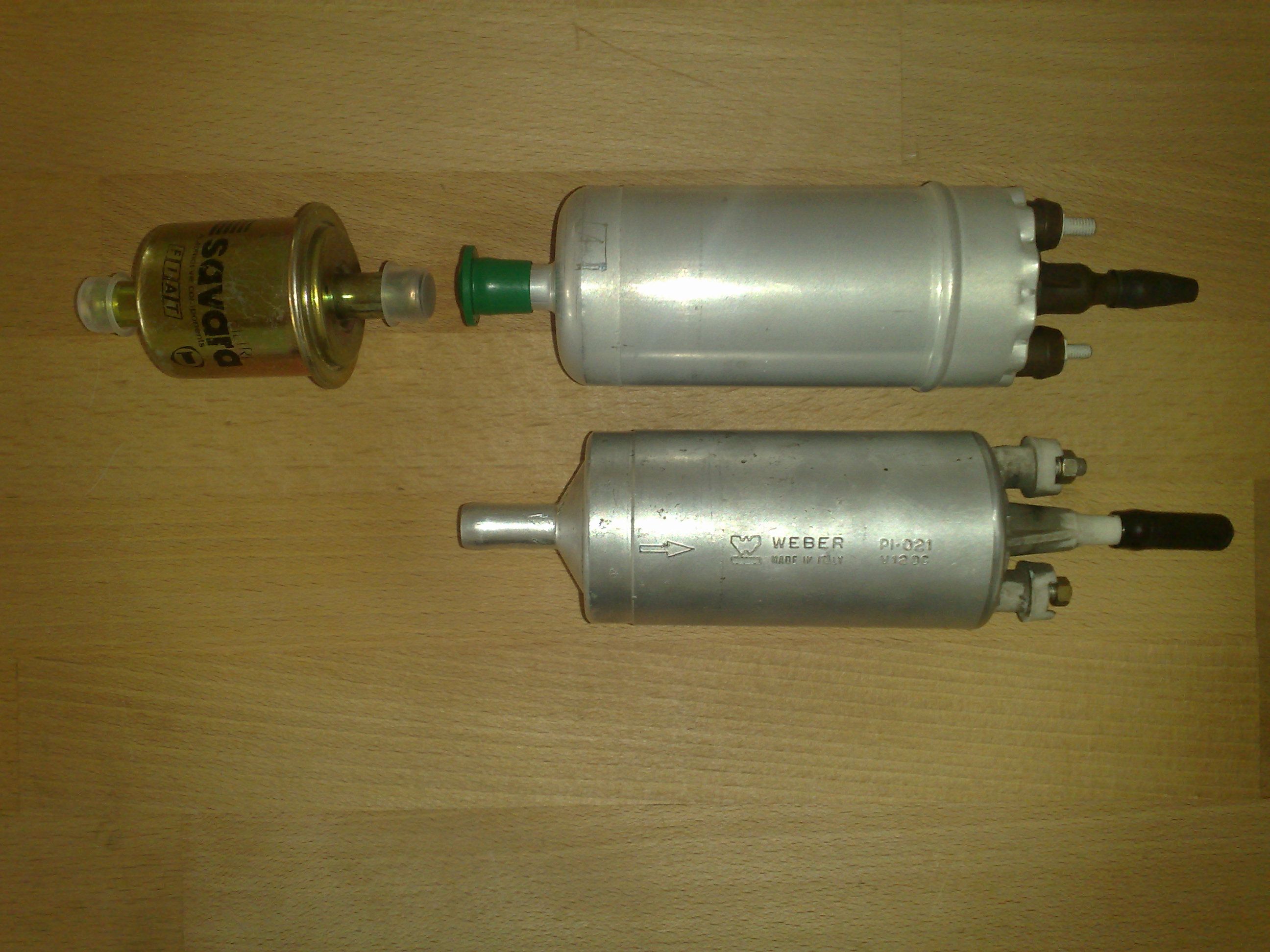

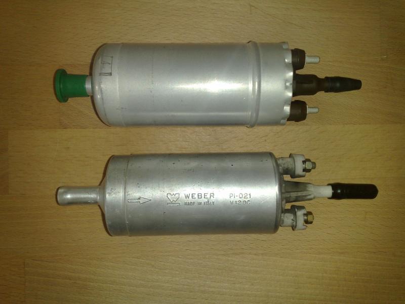

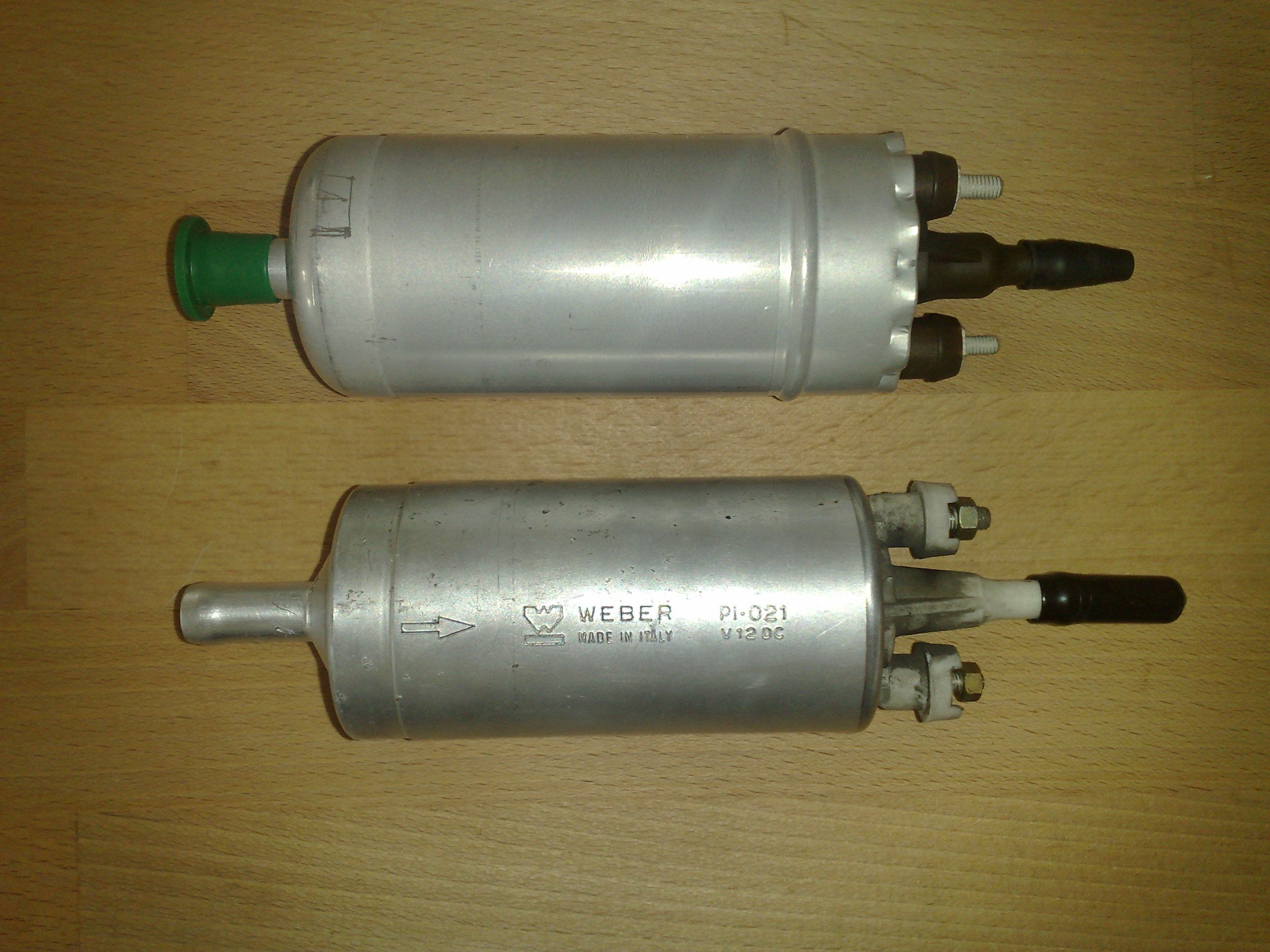

Fuel pump early Diablo: Weber PI-021 /
Bosch 580 464 070. BMW M5. E 28 3,4. 130 liters / hour ( 3 bar ) ( 43 psi ) One pump op to 210kw. 97$
Price 1 piece: Weber fuel pump 517$
Price 1 piece: Bosch fuel pump 97$
This is Europe price. I have not isstalled the fuel pump yet, so i will return when I have some facts

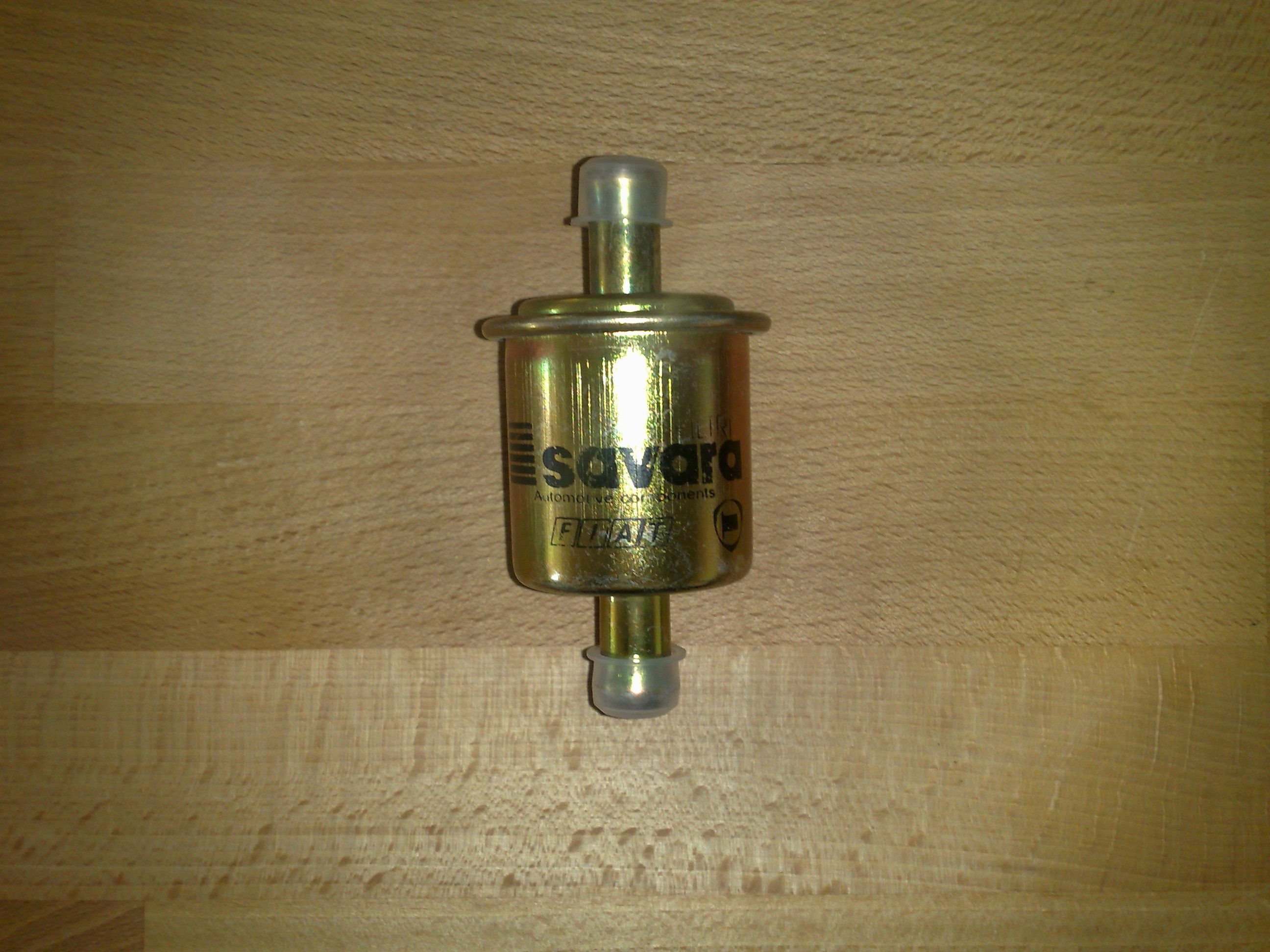

Fuel filter before fuel pump: "SAVARA Fiat 9.31.981.00. (7563164)
This is one of to I bought from Lamborghini at 28$ Maybe you can get it for less $ some where else.

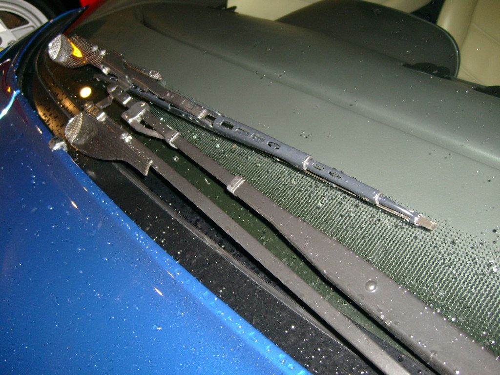

Wiper blades for Diablo
From Discount/Advance Autoparts
Trico Teflon blades
TRICO # 15-200 Refill #17-200
This is for a 20" blade....2" longer that OEM. It fits perfectly and does not sweep off the windshield. It will give you an extra inch of sweep at the bottom of the windshield above the dash.....great for fog on outside glass
TRICO # 15-130
13" blade....no refill.
This blade comes with an adapter. You pull off the plastic blade holder on the wiper arm. You then push and snap in the Trico adapter and then fit the blade as normal. It looks quite similar to the OEM plastic and since it's under the spoiler you don't see anything different....even from the inside of the car.
I've being trying to find blades that will match and fit FOREVER....no luck.
These blades match each other and with the teflon edge.....no chatter whatsoever. There is absolutely no blade noise on the sweep.
Very happy with the blades and local source
...and they match!
Shamile
Did the Bosch pumps work out?
