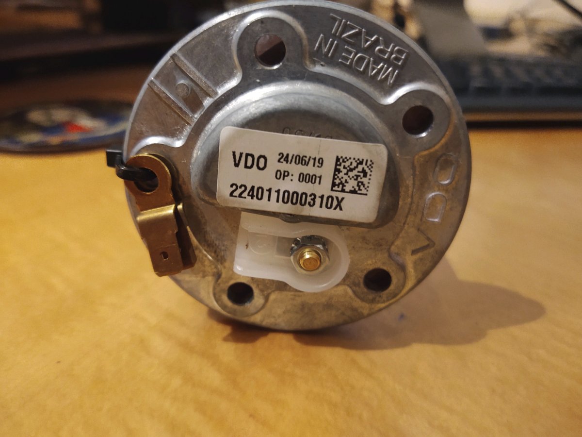

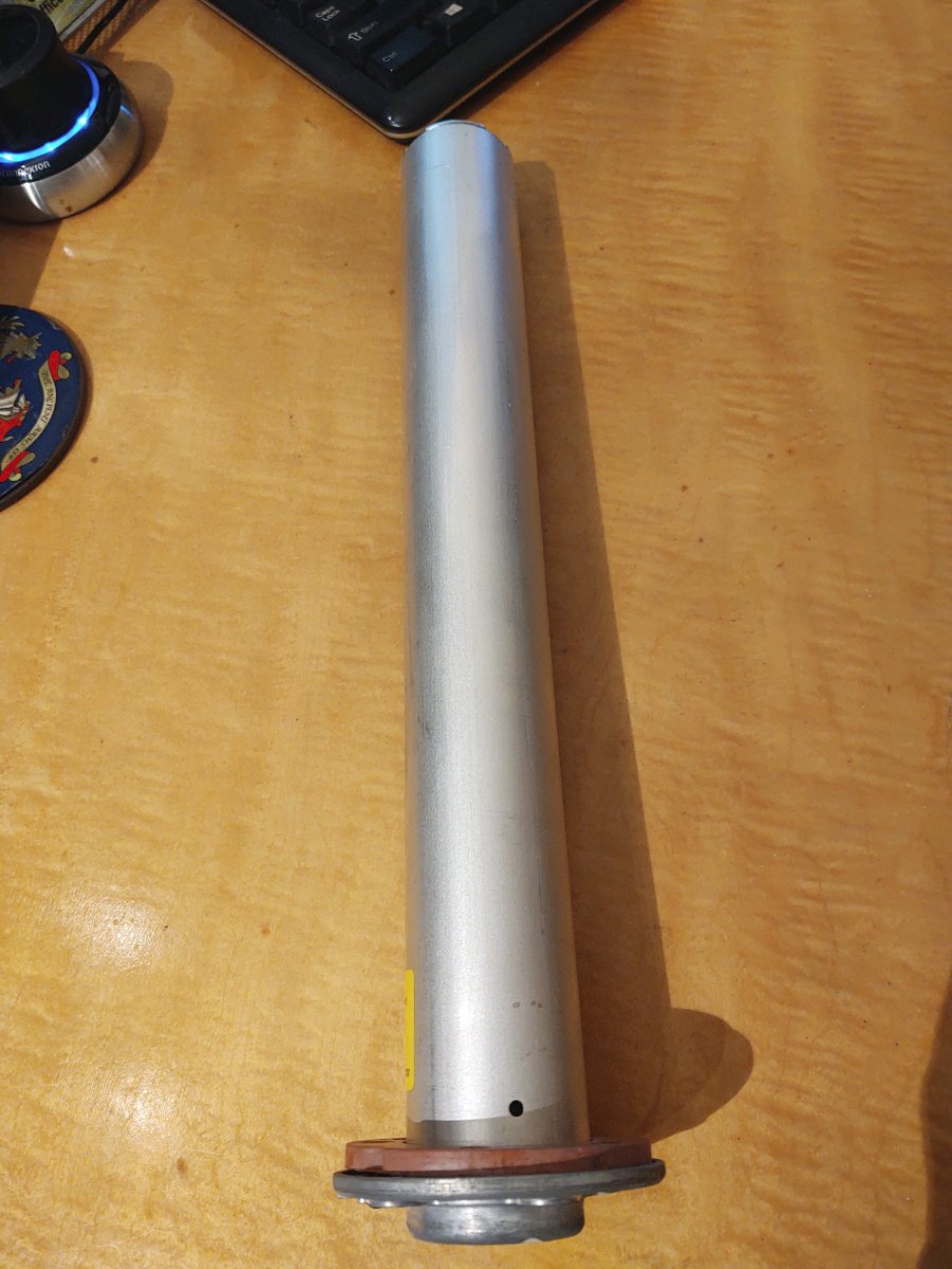

Fuel Level Sending Unit for a 98 Diablo SV-  for those with with fuel sender issues the factory unit costs $548. I was unable to find the equivalent unit  as there are no marking on the gauge so I bought a replacement from the factory.  To save others from spending way too much for this,  you can order one from ETB Instruments for $67. Here is the website: https://www.etbinstruments.com/index.php?route=product/product&product_id=86
The model# is VDO 224011000310X .  The last digits represent the length which is 310mm.  I believe all models use the same one. The ohm reading is 3.5 ohms full and 84 ohms empty. I am providing this as it doesn't appear in any Lamborghini repair manual.
To replace, you need to remove the coolant reservoir and rear tire. That tank needs to be slid out towards the rear about 6" as there is a diagonal cross strut directly over the fuel sender.
